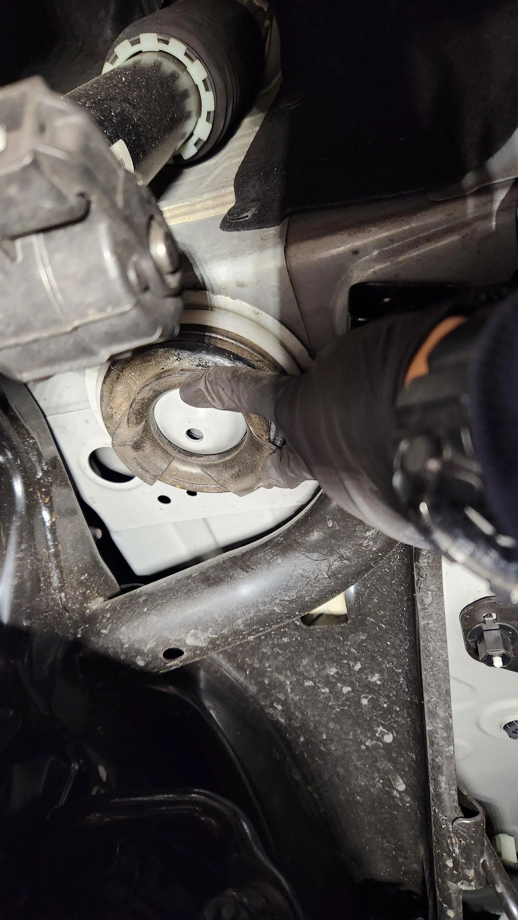

Curious where you got the spring shim from?

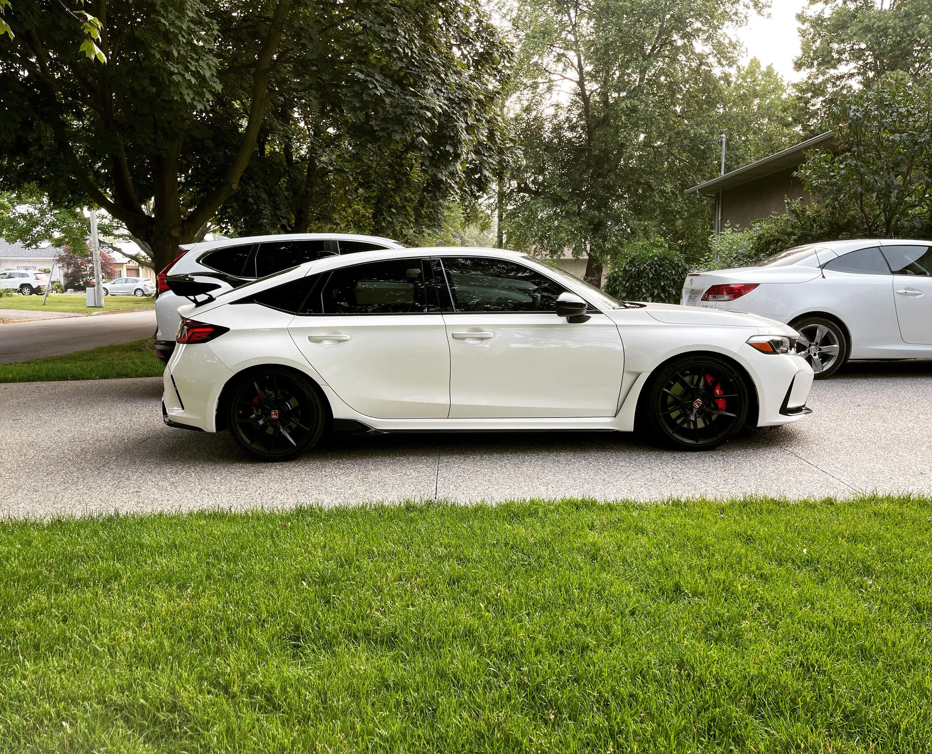

I think my Spoon springs are a more even drop then Eibach. The front is even with the rear, which is clear from the side profile. Like I mentioned, there is more wheel gap with stock springs in the front then the rear. So, it makes sense that it looks like the rear is dropped more in the rear when there is no gap in the rear, and a small gap in the front when lowered on Spoon springs. Just my take and opinion.
Is this the FL5 specific Spoon springs?
Do you have more photos of you car lowered? Do you have a Samsung phone you took the photos with? The green grass is intense lol.
These are FL5 specific springs. I don’t have any additional photos as it was recently lowered. I will snap a few in the next couple of days, and send them your way.
iPhone photos, just my wife’s expensive habit of feeding the grass a lot of water.
I'm working with a friend's fab shop to have them made. I'm still yet to finalize the design as I'm not 100% happy with they way they sit against the vehicle's body. With these shims I can even fine tune the car's corner weight balance by tweaking the shim thickness.
Thats pretty awesome! You could have a potential market to fine tune things. Keep us posted..
