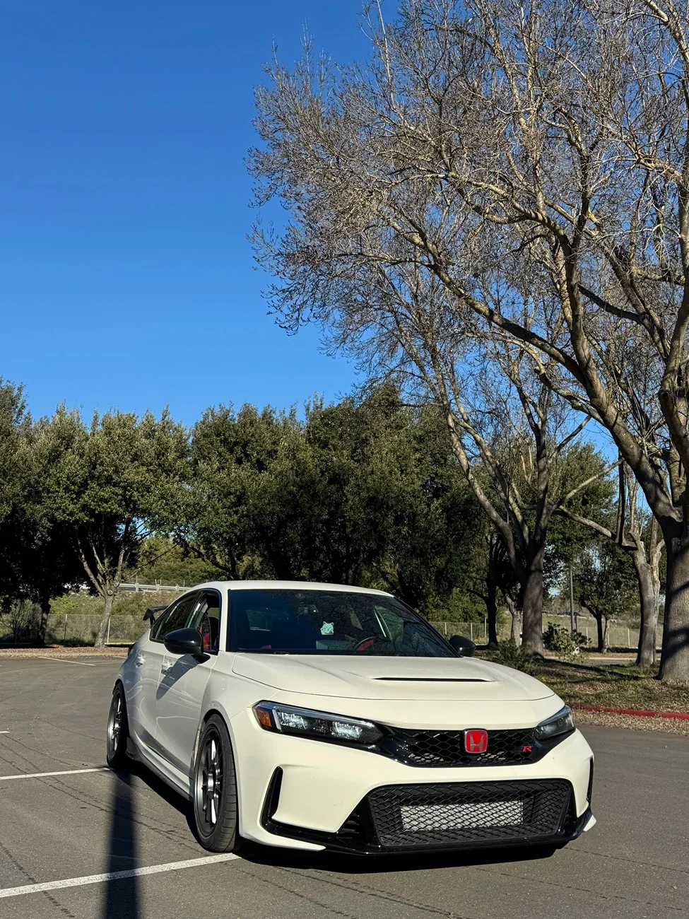

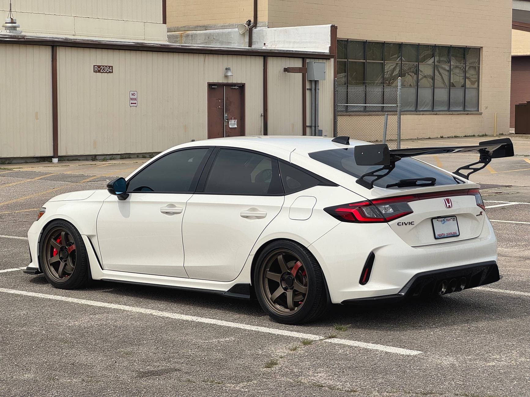

Few months later on sportline now on 265/35/18
The extra sidewall helps add a bit of comfort
11th Gen Honda Civic Eibach Pro Kit and/or Sportline Experiences IMG_6317
11th Gen Honda Civic Eibach Pro Kit and/or Sportline Experiences IMG_6357

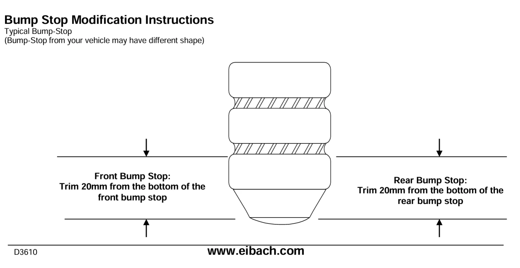

Ordered the pro version and wanted to confirm that I don't need to cut the bump stops or whatever. they're called?
You do need to cut the bump stops, the installation instructions state so explicitly and even have a diagram.

Hmm but that instruction states that's for the FK8 with part number E10-40-036-03-22. FL5 is E10-40-043-03-22. But I'll check the instructions that come in the box. You might be right since there's probably not much change to the suspension geometry between the two.
