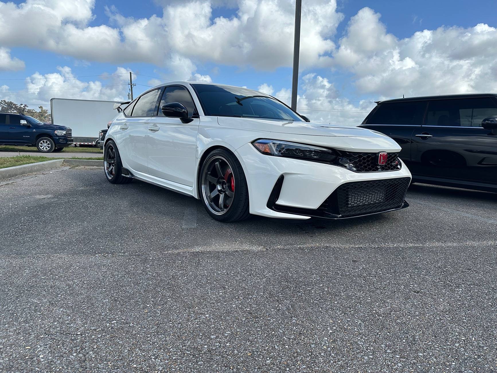

I already had my 18” wheels before installing my springs. Even with beefy 275/35’s, I didn’t like the horrendous wheel gap it had with OEM springs, so I decided to take the more aggressive approach and get Eibach’s Sportlines over their Pro Kit. No regrets, especially since I’m not rubbing at all.
No doubt the sport lines look better, but my back is very happy with the pro kit lol.

Despite the stiffer spring rates over the Pro kit, ride quality is still comfortable imo. I actually have the ITS ADS module on hand too, but haven’t installed it yet, since downsizing to 18’s and 35 sidewall already does a good job in increasing the comfort. Swapping the module should make it even more comfortable, but it’s possible that it could be “too soft” haha.

I've debated the ITS module, but once I put the 18s on they feel like they added a "bounce" to the ride that wasn't there before so I switch back and forth between comfort and sport suspension settings. Maybe it's a trait specific to the yokohama v601 ??‍♂
how is the ride? Also what intake is that?

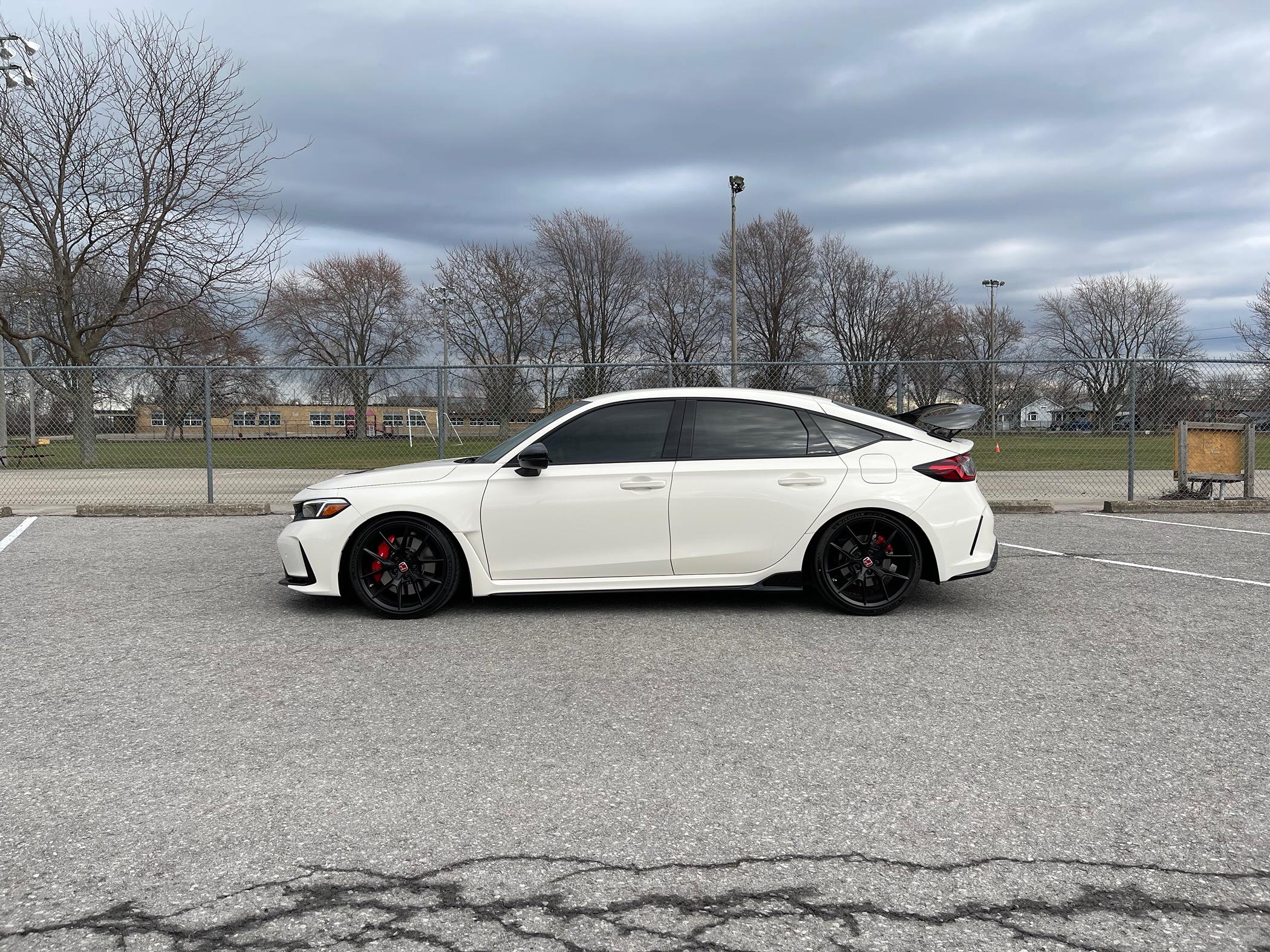

First ride this year in the CTR. Have one side picture with the Pro-Kit. I’m assuming it’s fully settled, but it has only been driven 20kms. I will give it some more time.
That looks low. How is the ride?

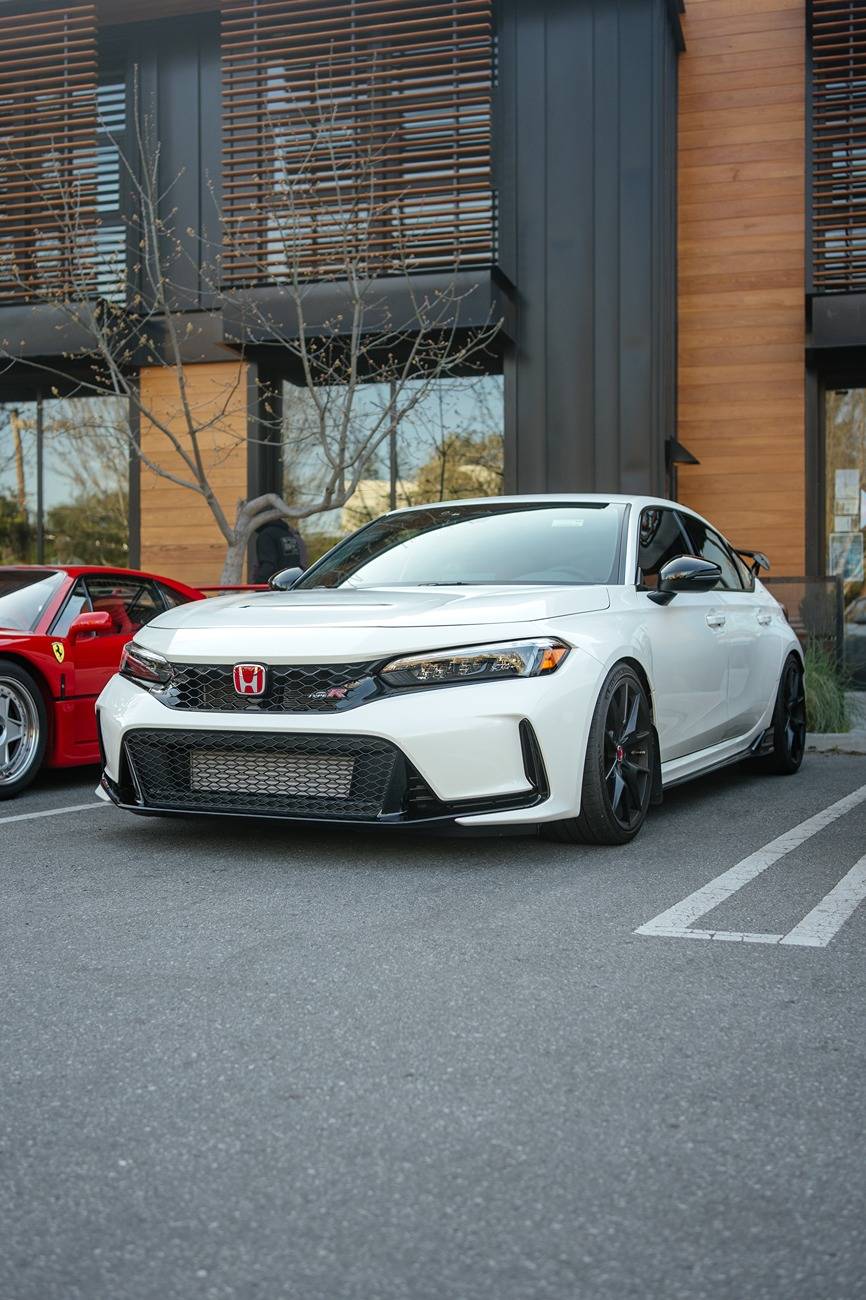

Your Type R looks fantastic. Love the drop and wheels. I’m going to order the Pro-Kit springs. Like how the drop looks!
nice, what is your offset? Have a pro kit as well that I havent installed. THanks

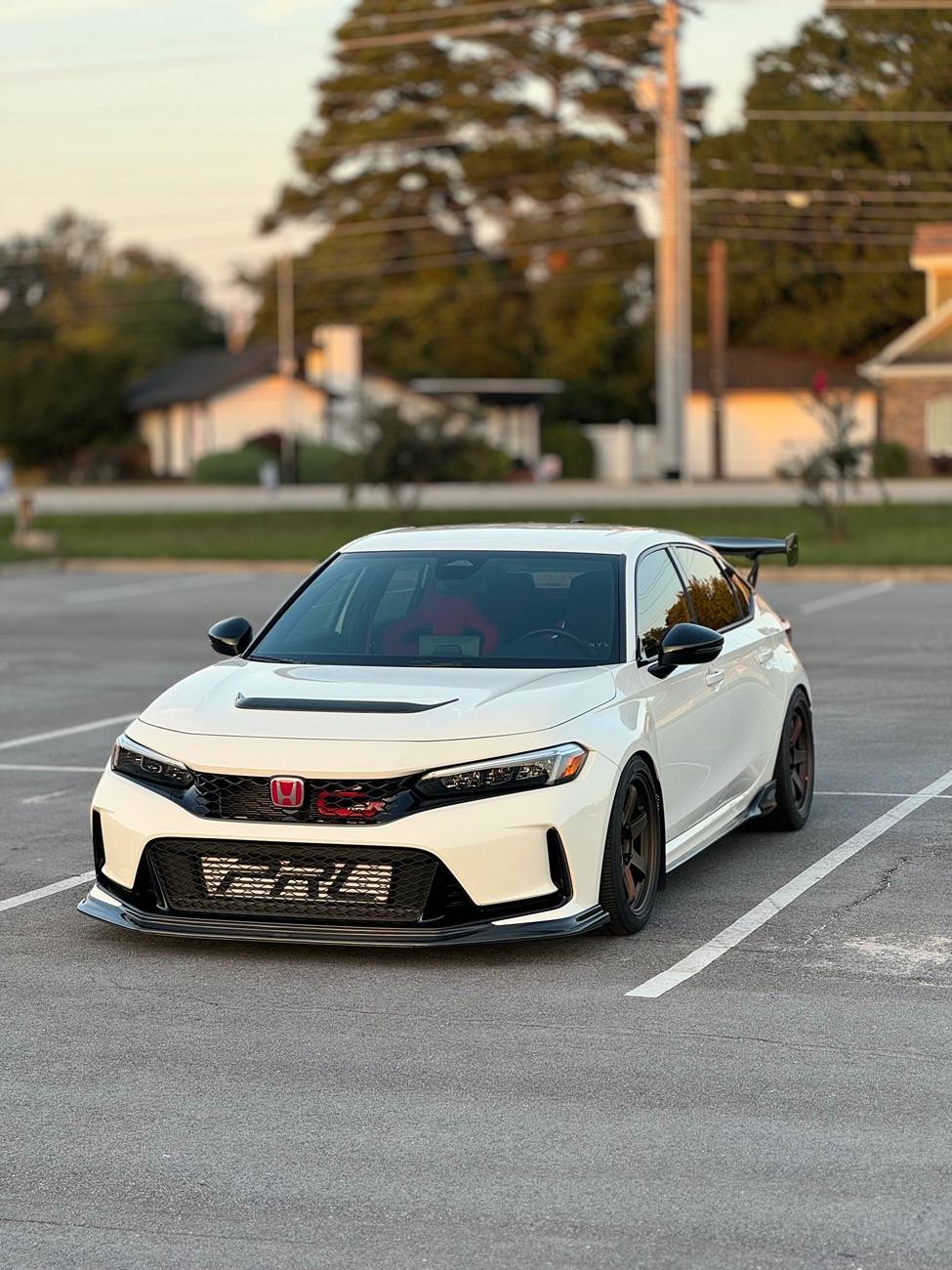

Currently running Eibach’s Sportline kit with no problems. TE37 SL’s running the “Golden” spec 18x9.5 +45 for a clean, flush fitment with Falken Azenis 275/35 tires. Also running aftermarket rear Camber and Toe arms to dial in the suspension and get the alignment back into factory specs.
Looks amazing! Do you have any
side shots?
