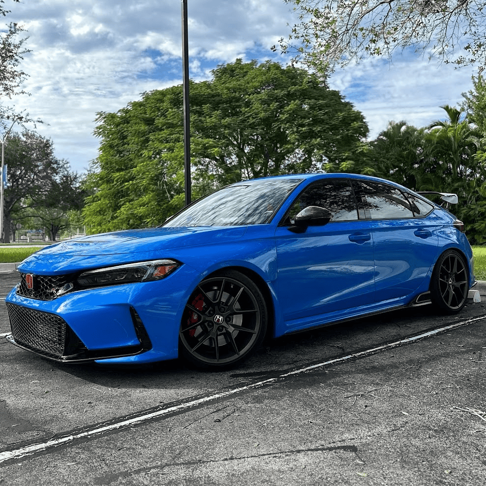

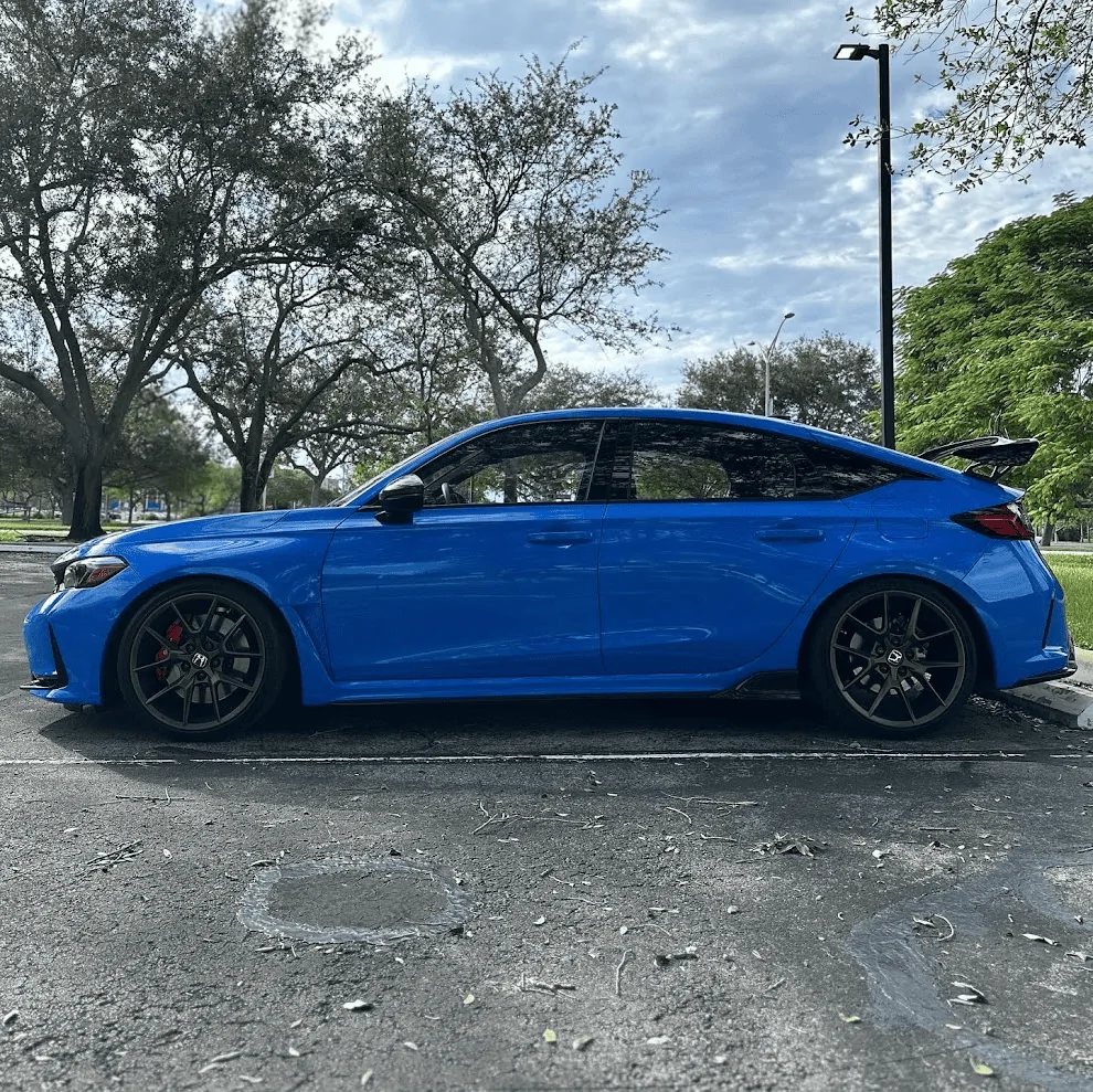

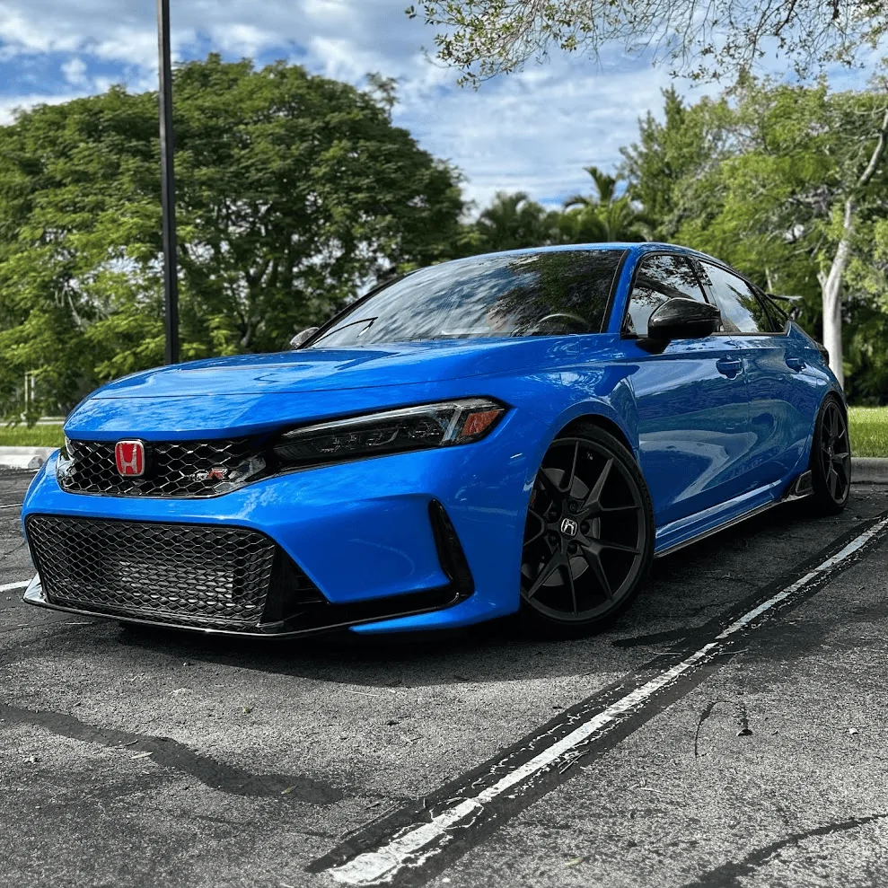

Im running Eibach sportline, car rides like stock, turn is is significantly sharper. No rubbing whatsoever, running 15mm spacers in this setup.

Nope! Has been great, only thing I would say is that with this setup, throwing a lip on would be a bit of a gamble lol. Aside from that, no issues, couple of autocross days and no issues.

I’m digging this look so much. Have you measured the drop on the sportlines? Is it leveled or the fronts are lower than the rears? Thanks

I haven't personally measured the "true" drop but based on the specs for the springs, 1.2" F and 0.9"R, it does create a positive rake, which i like personally.
The fitment does look great, note, I am on 15mm spacers.
