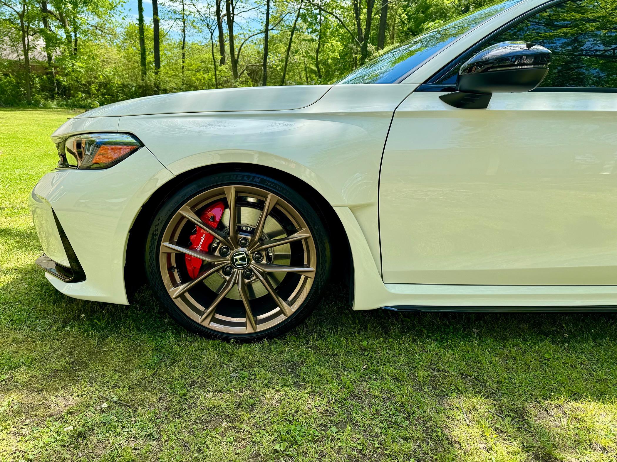

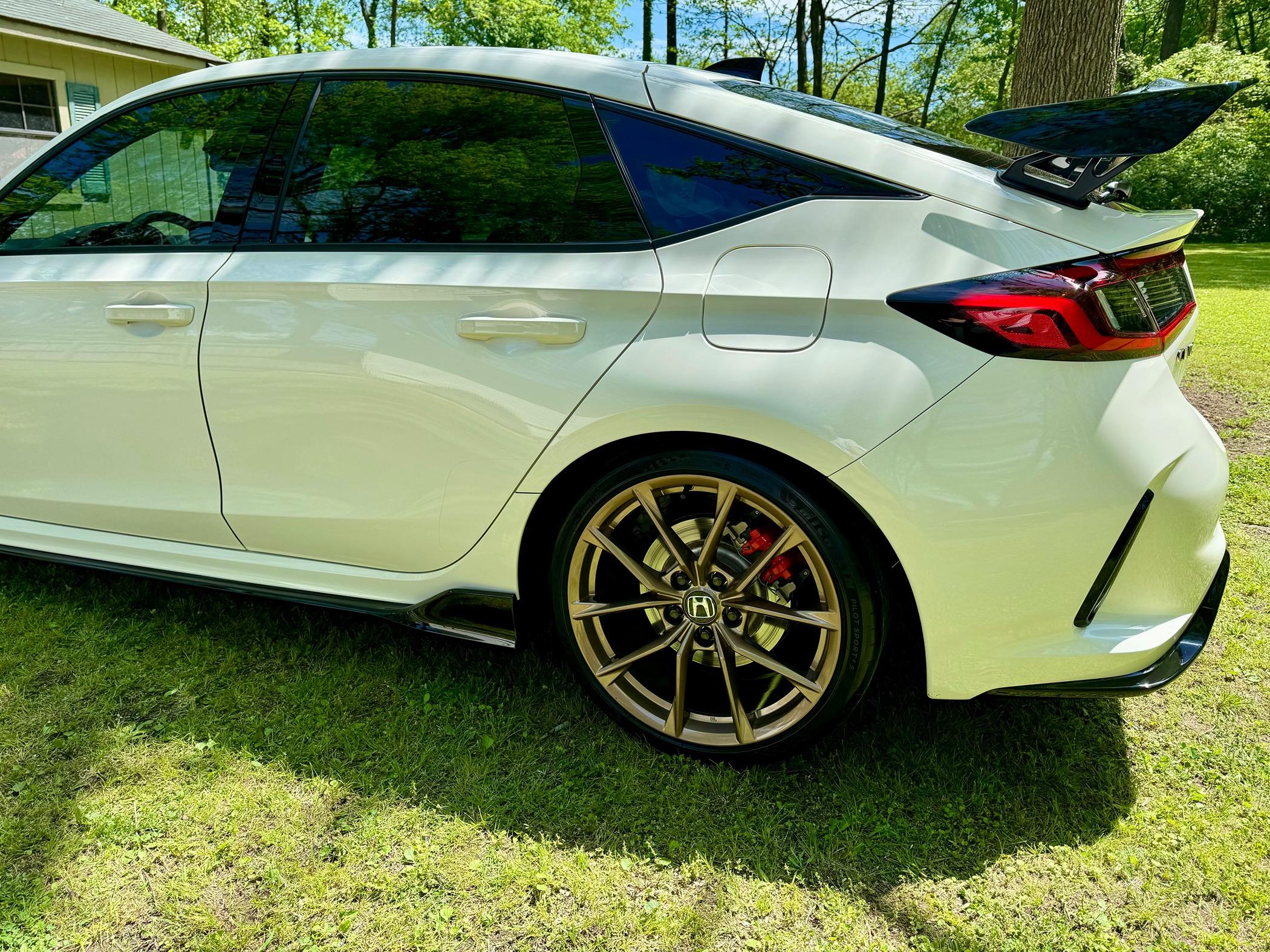

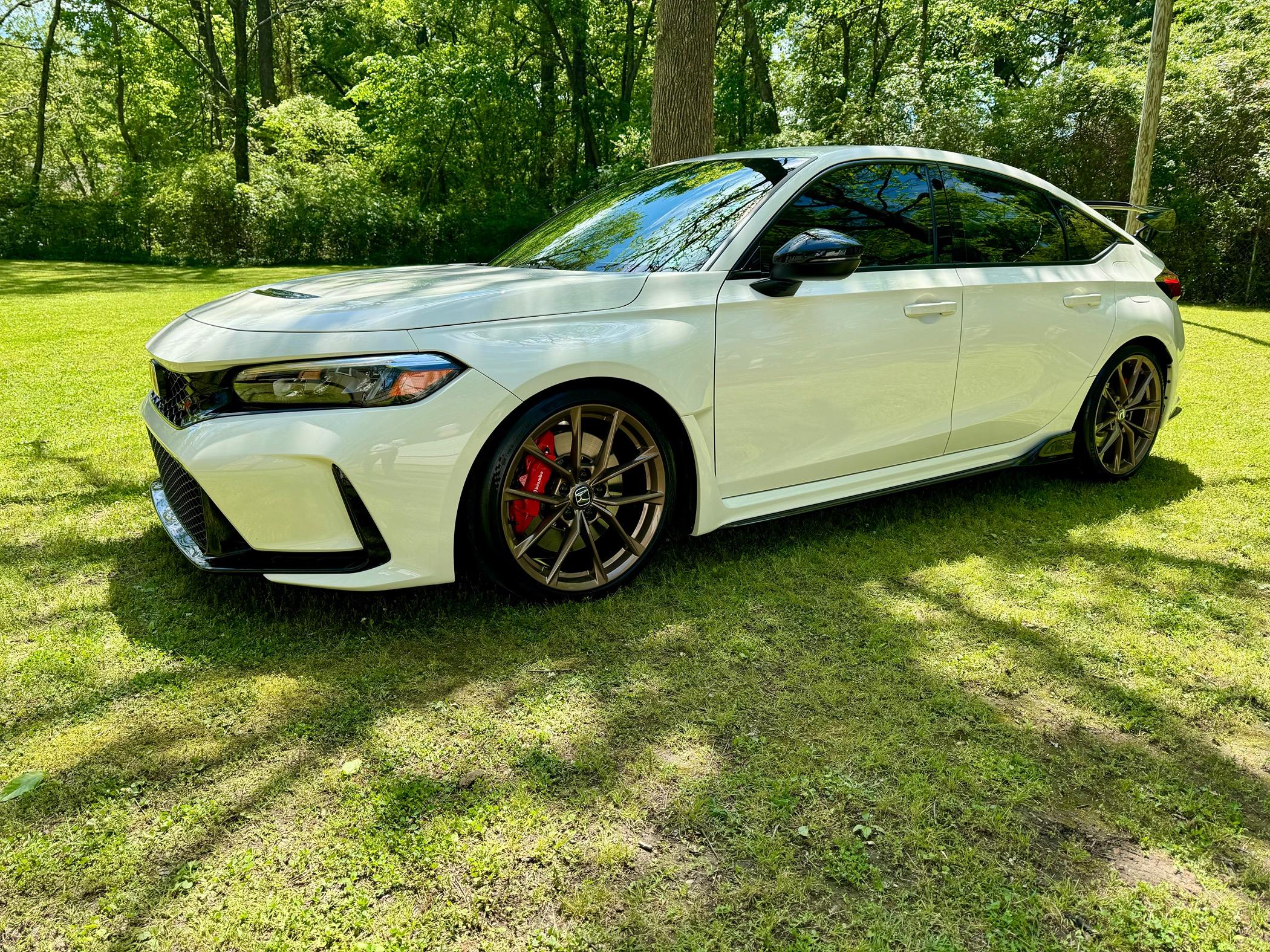

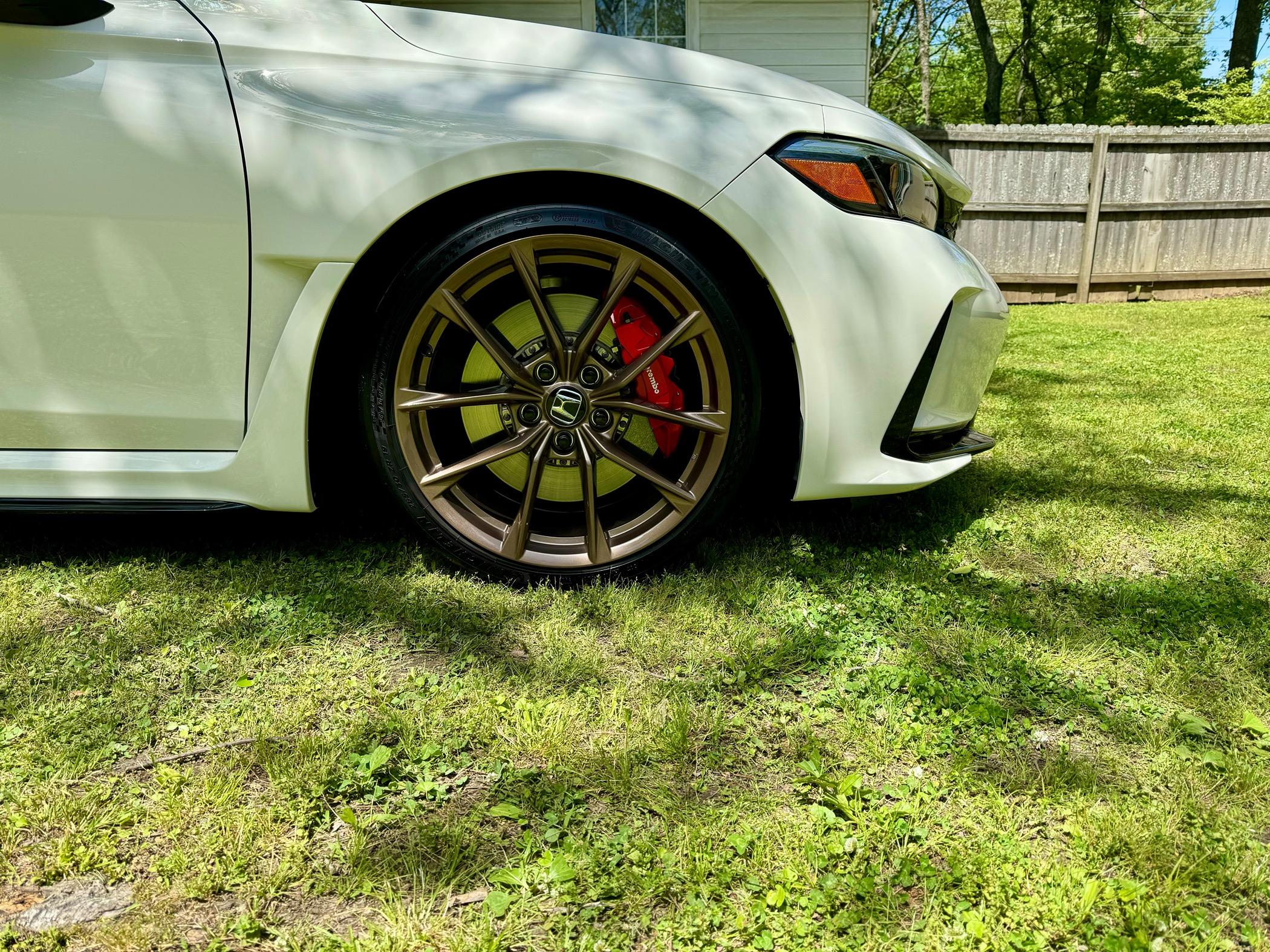

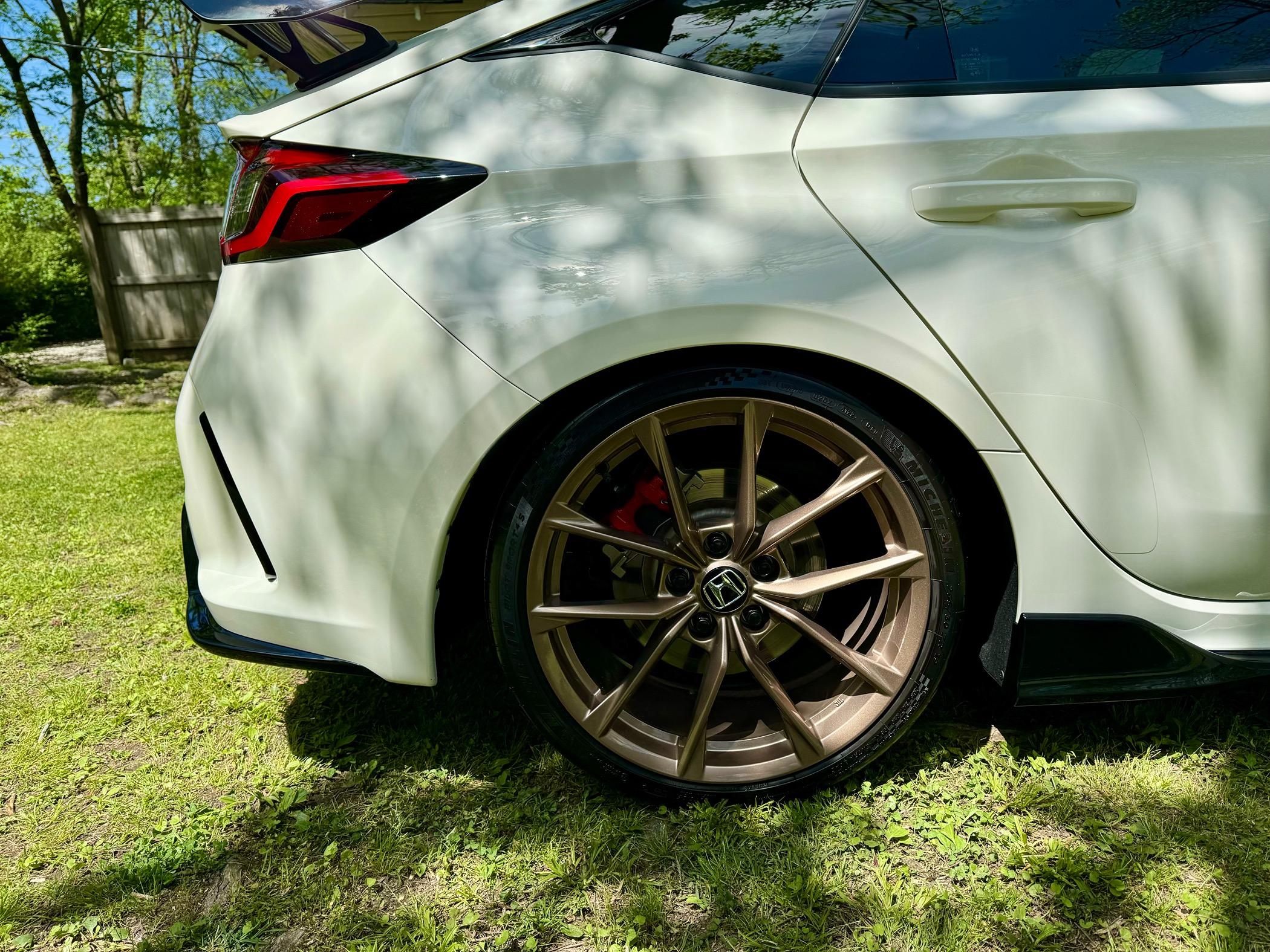

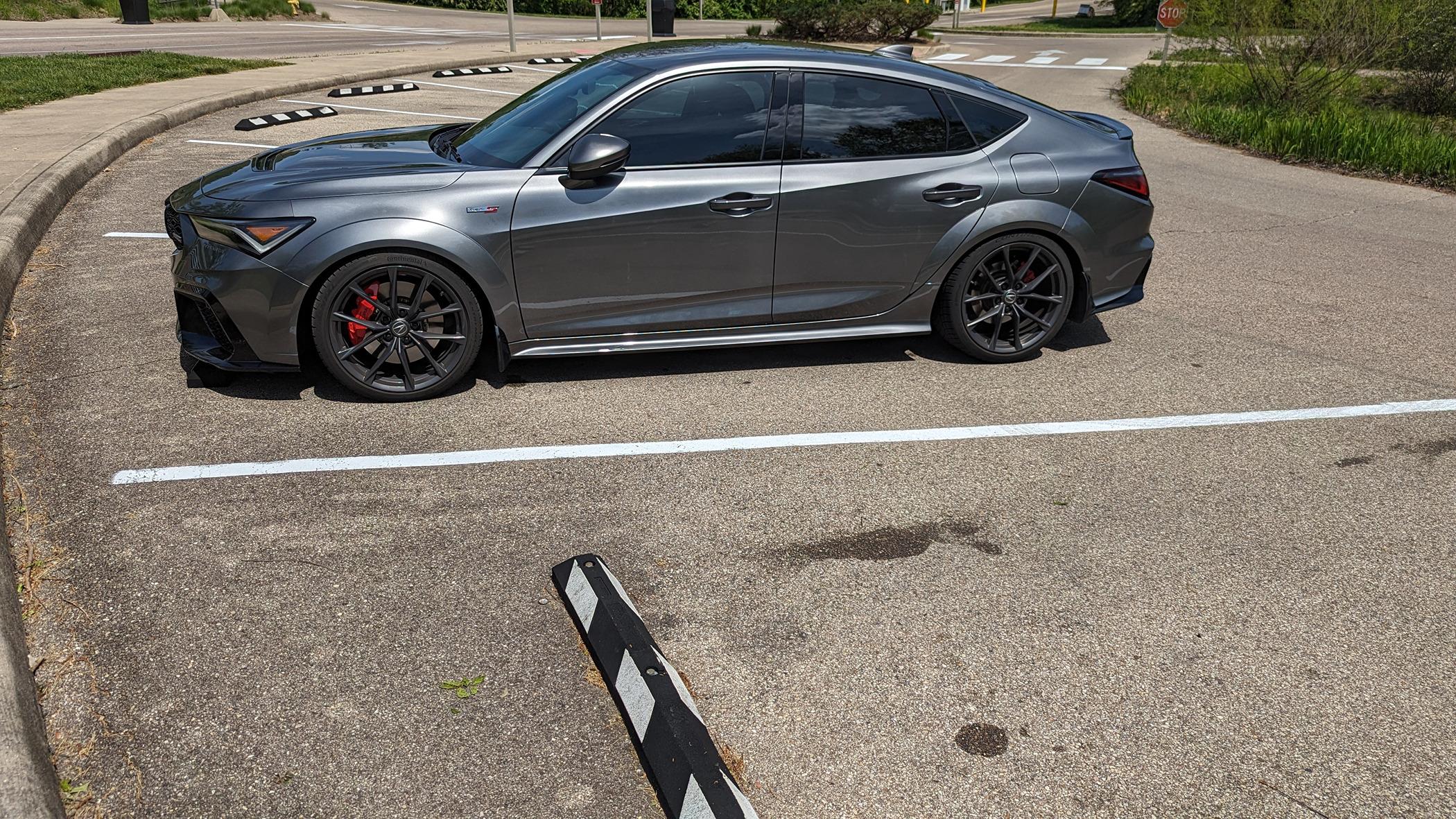

Prokit with Bonos spacers 15/20mm 275/30/19 tires

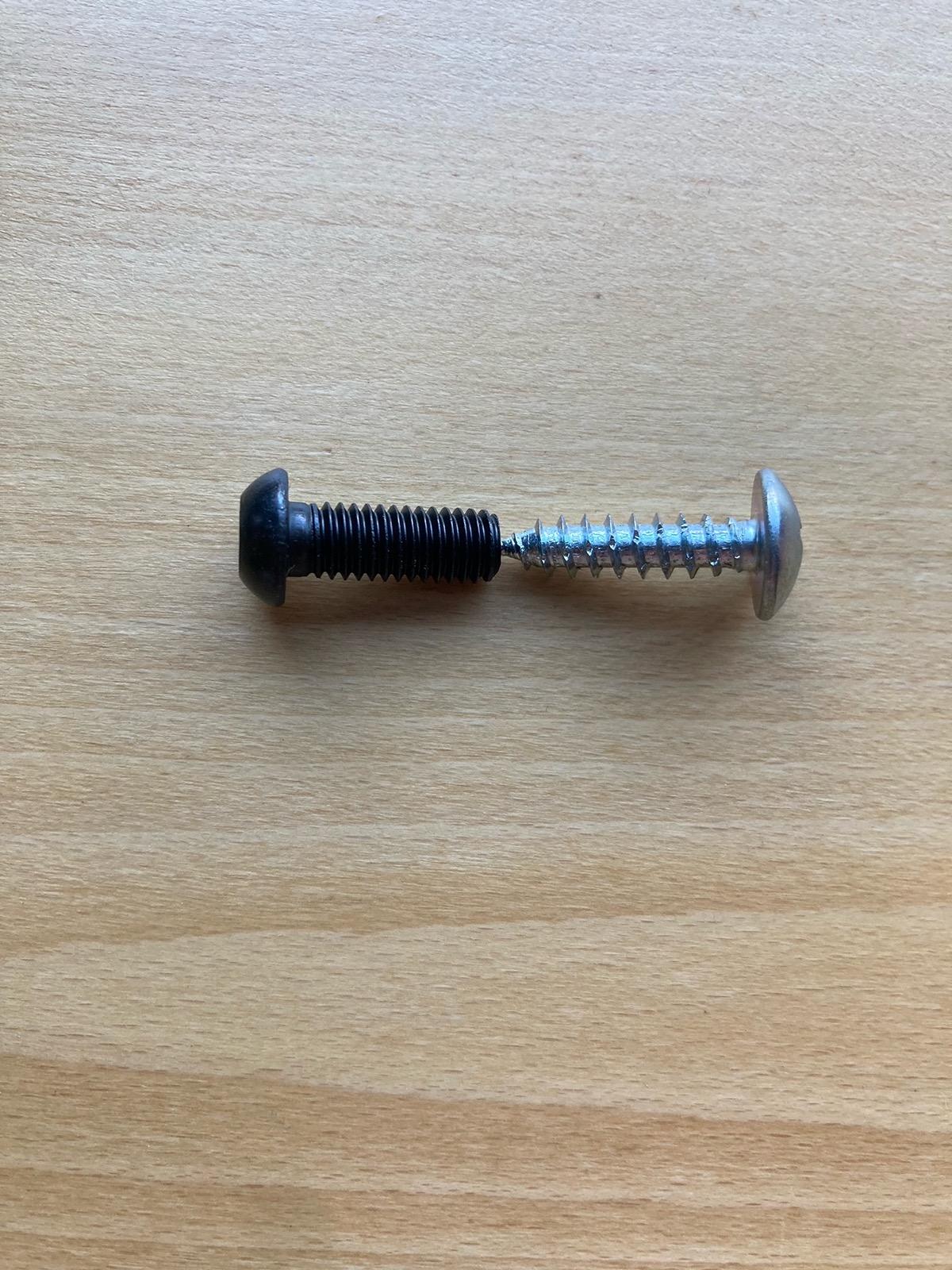

I was hoping that would be true, but I tried your bolts (because I'm waiting for a friend to help me install them on the Wing) and they're a little larger with a slightly different thread size than my license plate screws.
