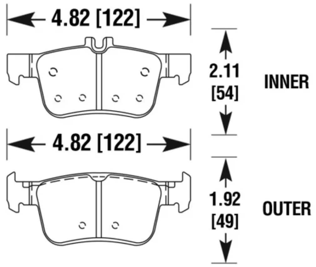

REFERENCE: Standard FK8/FL5 front & rear pad dimensions:
11th Gen Honda Civic Brake Pad Manufacturer/Model Compilation Thread 111340
11th Gen Honda Civic Brake Pad Manufacturer/Model Compilation Thread 111325
*Illustrations from Hawk Performance
