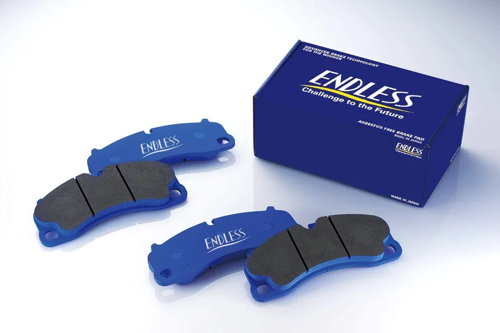

Paragon R5's vs Endless Circuit/Endurance Racing Pads ( Superior ).
I've recently tested my ENDLESS CC43 (N35S) BRAKE PAD FRONT FOR HONDA CIVIC FK8 FL5 (TYPE-R) EP357-CC43-N35S - I ordered them from BlackHawkJapan and it takes 1.5 months to produce and after doing Equivalent of 4 track days at COTA, 20 sessions at 25 min a session this brake pad is SUPERIOR to the Paragon R5's which are just rebranded Winmax brake pads.
We ran my car back to back two drivers advance and intermediate on the same day - totally beat hard on the car, and it's a day and night difference. These braked so consistently, lap over lap, and it did have less bite than the R5's but it was much more consistent, zero change in brake pedal feel, and it was way easier on the rotors and pads.
I would highly recommend ordering these and giving them a try. My mind is blown.

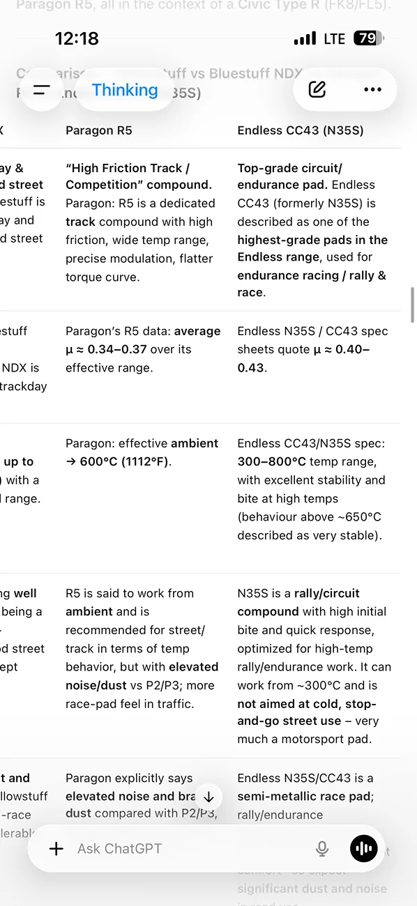

I did run it through some AI to kind of compare it to the Paragon R5's. Those things are way more aggressive and chewed up my stock rotors. So I got new rotors and tried the Endless and have ordered another 2 sets. Probably next time, only need to order the front pads, as the rears seem to be able to last 3-4 times longer, so every 3rd-4th switch out of the front pads, I'll switch out the rears.
Absolutely love them! And only $131.00 ( You will have to pay import tax from Japan but well worth it ) _ I called a local Endless distributor and they tried to charge me like $1000+ bucks
Streatable - no issues after you bed them properly

Both are endless cc43
paragon R5’s lasted very very long as well in rears - stock rear pads dissolve fast on one track day
