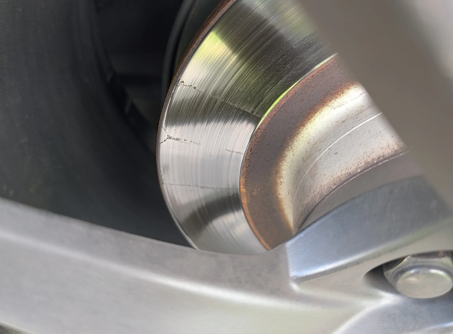

I think I've made it the furthest on the forum for stock rear rotors / pads. This is a picture of mine right now at 35,300 miles.
This might be a few cracks / good example. 🤣

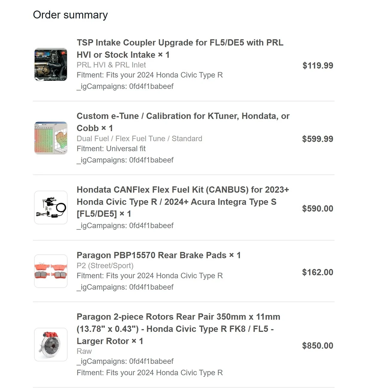

I just ordered the following goodies.

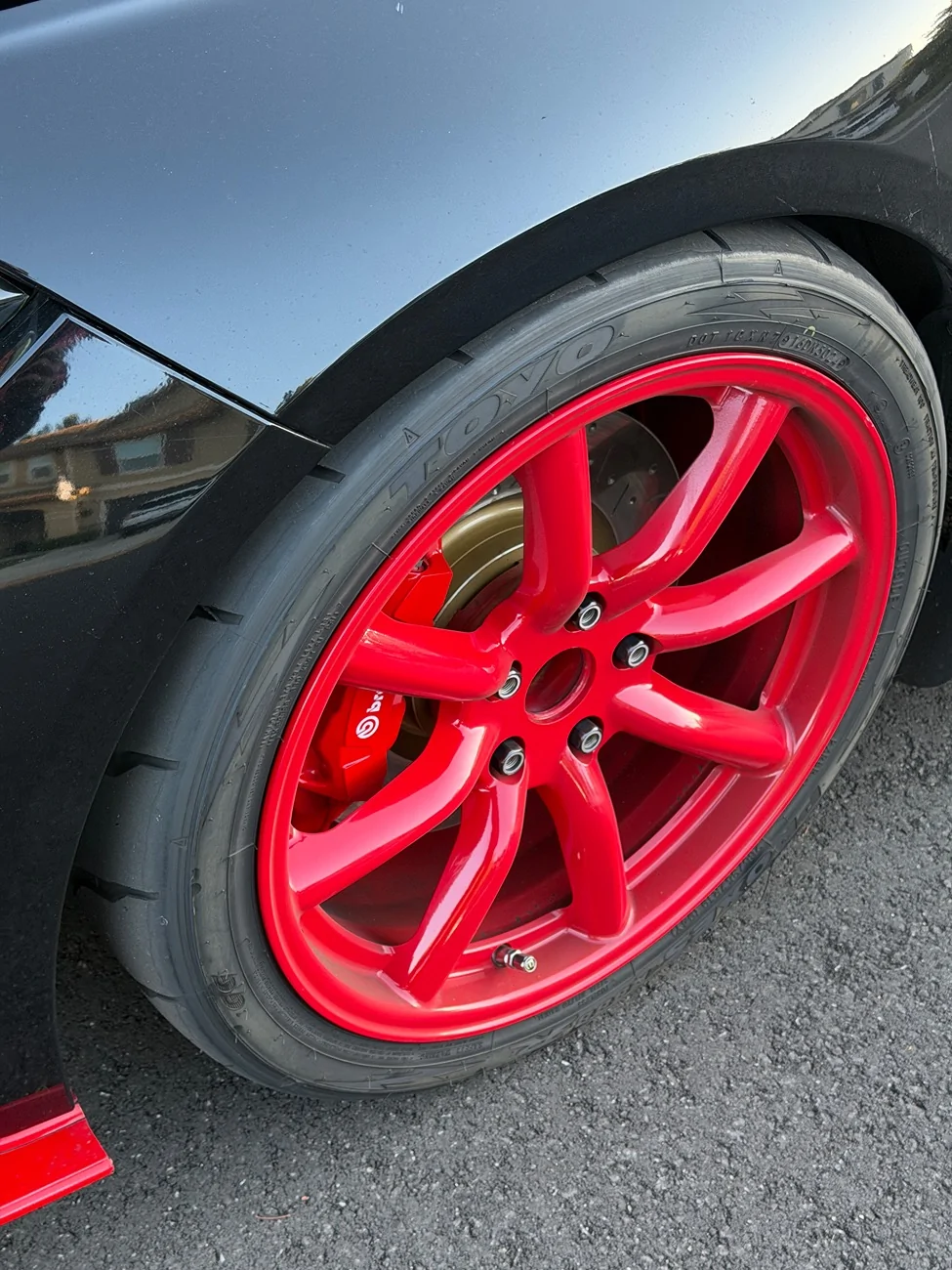

700+ miles in. the new front brake setup is still “solid.” Virtually no brake dust and I’ve been putting them through some serious daily paces. Had them cooking on 3 occasions.
This is a winning budget combo IMO.
