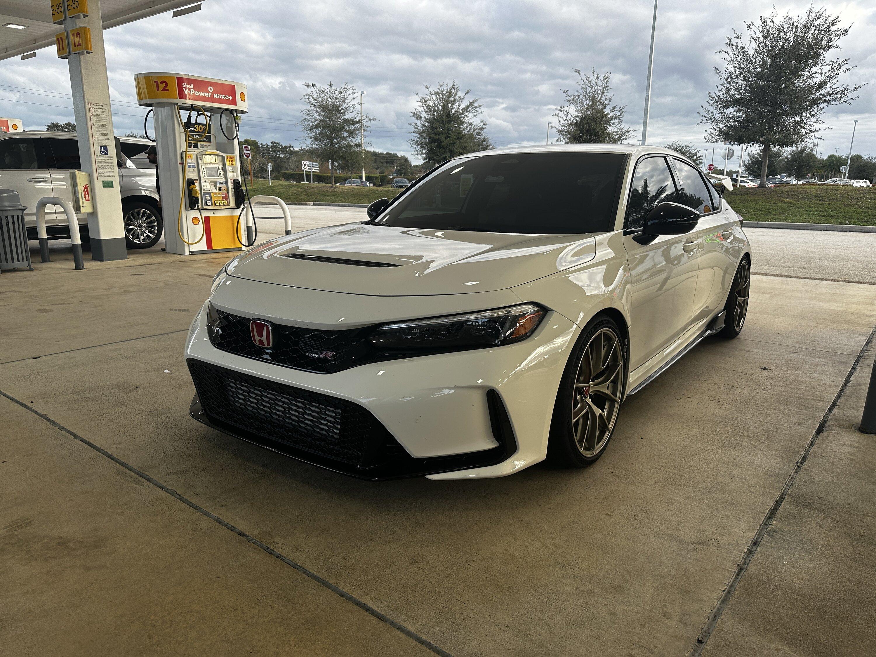

I agree, I went with a + 45 just for a bit of flush fitment.

The offset restraints are due to SCCA class rules legality. Not aesthetics :rolleyes:
I know that dude, I personally did not care for the class offset so decided to go my own way. If I want to compete in BS I can slap the stock wheels back on.

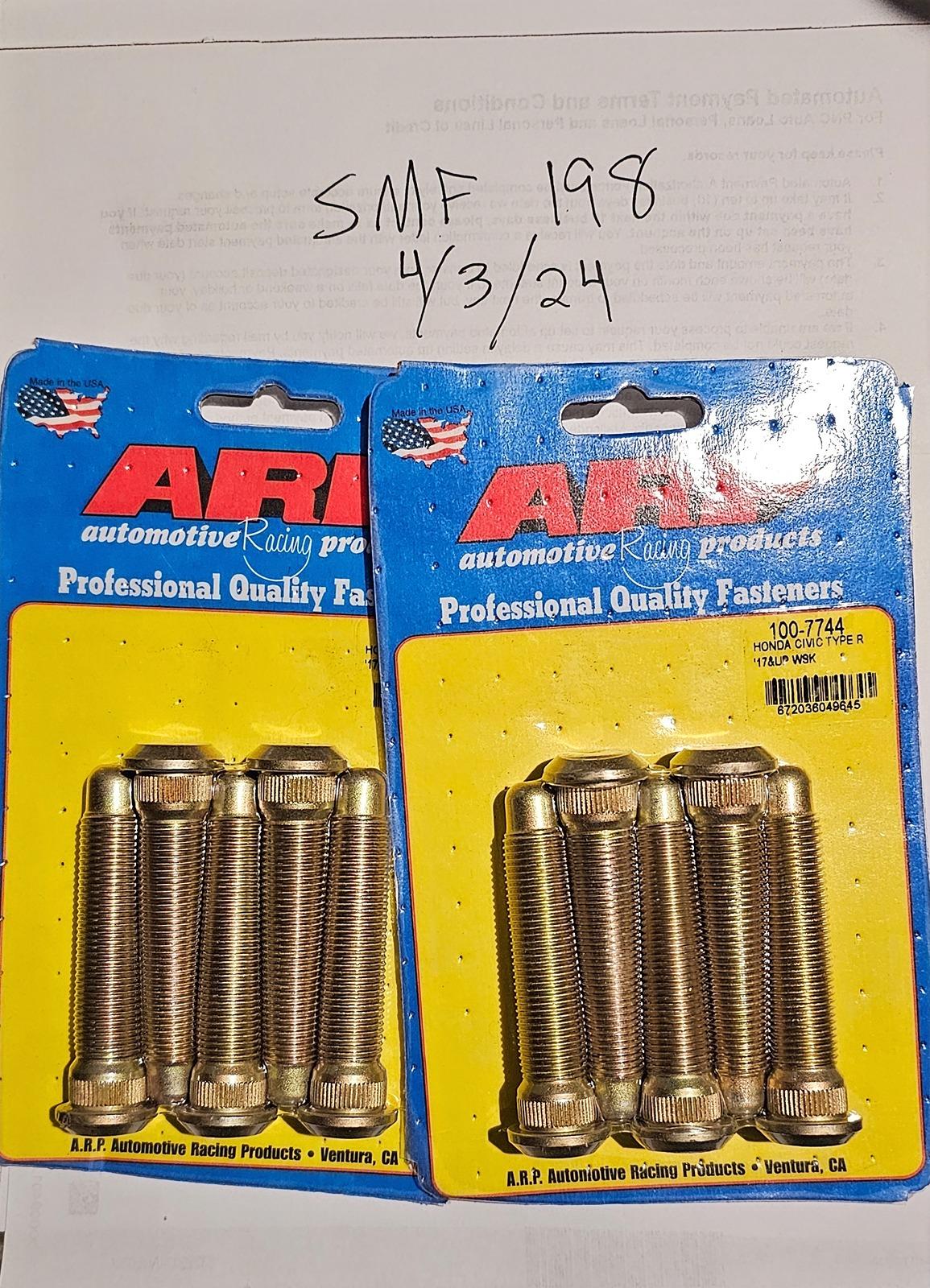

I havent tested that out on my FL5 so I cant say for sure. I think most are running 18x9 +58 or +53. My plan was to run a 5mm spacer up front only and keeping the +58 in the rear.
If you do need longer studs, I have had a change of plans and no longer running BS. I have 10 of the ARP, brand new unopened, that I am getting ready to sell for $100 shipped.
I also have (4) 275/35/18 Nankang CRS V2 for the front and (2) CRS V2 245/40/18 that I was planning to run on the rear. I've had great success with a staggered setup with a slightly wider front track so that was going to be my initial setup. I'm getting ready to list those as well here on Civicx. I already have them listed on Facebook.

I forgot to mention, on the APEX 18X9 +58MM, those definitely require longer studs if a 5mm spacer is used. I don't believe spacers are necessary in the rear but have not confirmed that personally.

Are those the ARP stud PN that you need for this car? I had so much trouble with the stock Honda studs on my FK8 I stopped using impact on my wheels because I think I've broken 7-8 wheels studs in the first year I had that car.

Oops, yes 9.5 width. Yes those ARP are made spexifixally for the 2017+ Type R. I've also heard from a friend that he broke several studs. Nothing worse than breaking a stud at an event without having a back up. 😪
