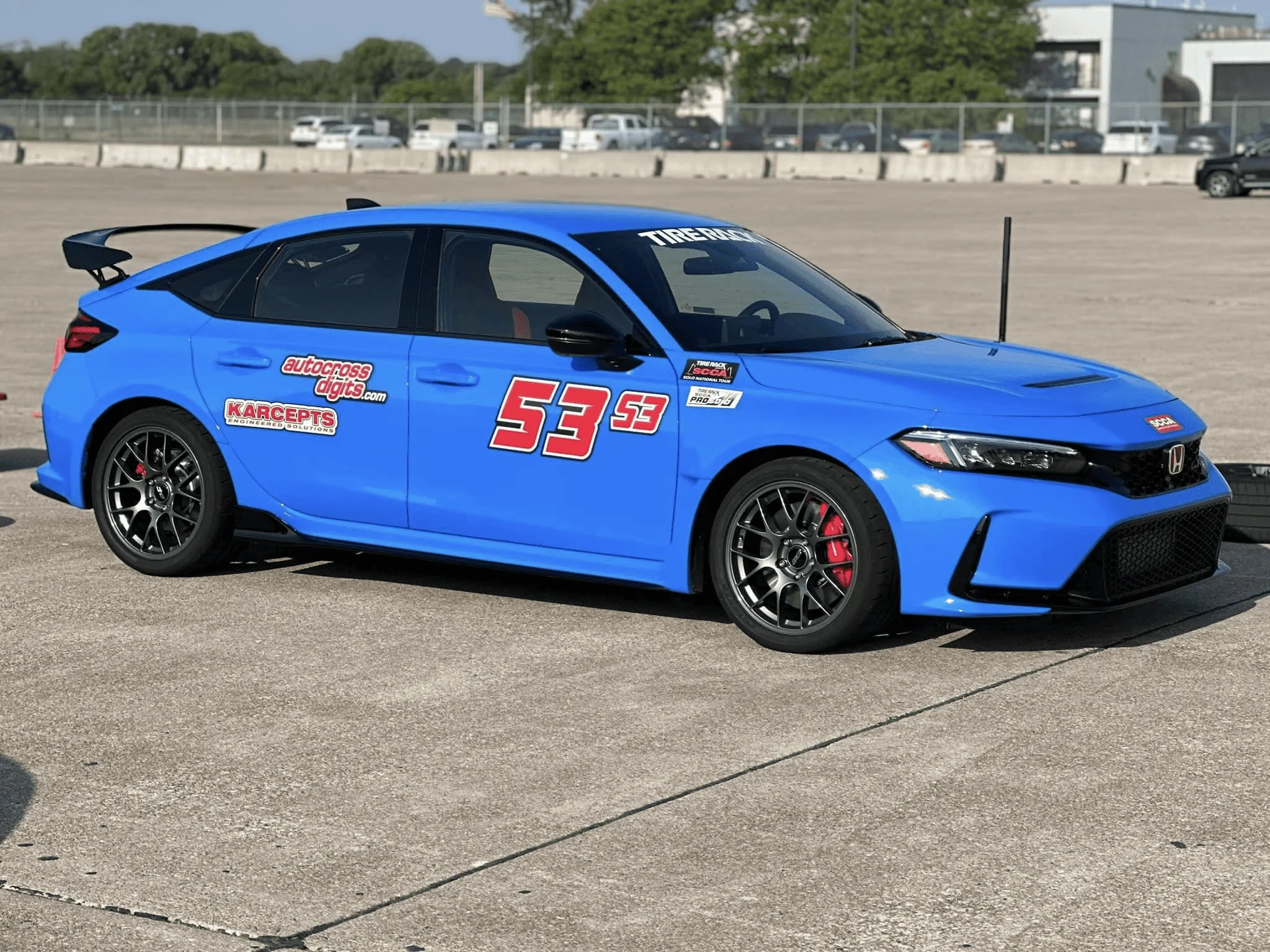

I think the 2 people I know who has ran FL5 nationally are/were using those. I have nothing against Apex EC-7 aside from the look(just not into the BBS style look anymore) and I think they are still currently out of stock(I think). Apex are pretty light for the money and I know a lot of BMW/Camaro people use them(5x120 pattern). Not my pic(or car), Mike Leeder's car from last year.
