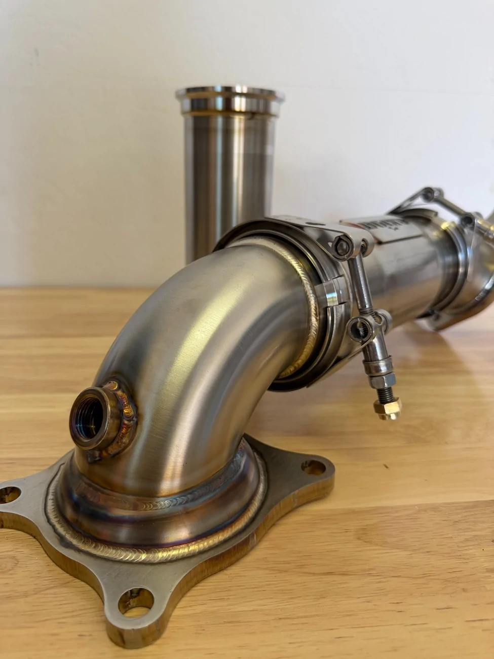

You should look up our Axion Industries 2n1 downpipe, only downpipe on the market that comes catted and can swap to catless in 10 min, perfect for street and track events www.axionperformanceparts.com
The exact one I'm eyeing as well, the ability to go catless that easy and never have a CEL during daily driving is unmatched by anyone else.

We were using the 200cel cats for the last 5 batches we did and work great but the demand with people wanting a 400 cel was hurting us to attract more people. Glad to see people understand our vision on these which was my idea a long time ago and we finally made it a reality

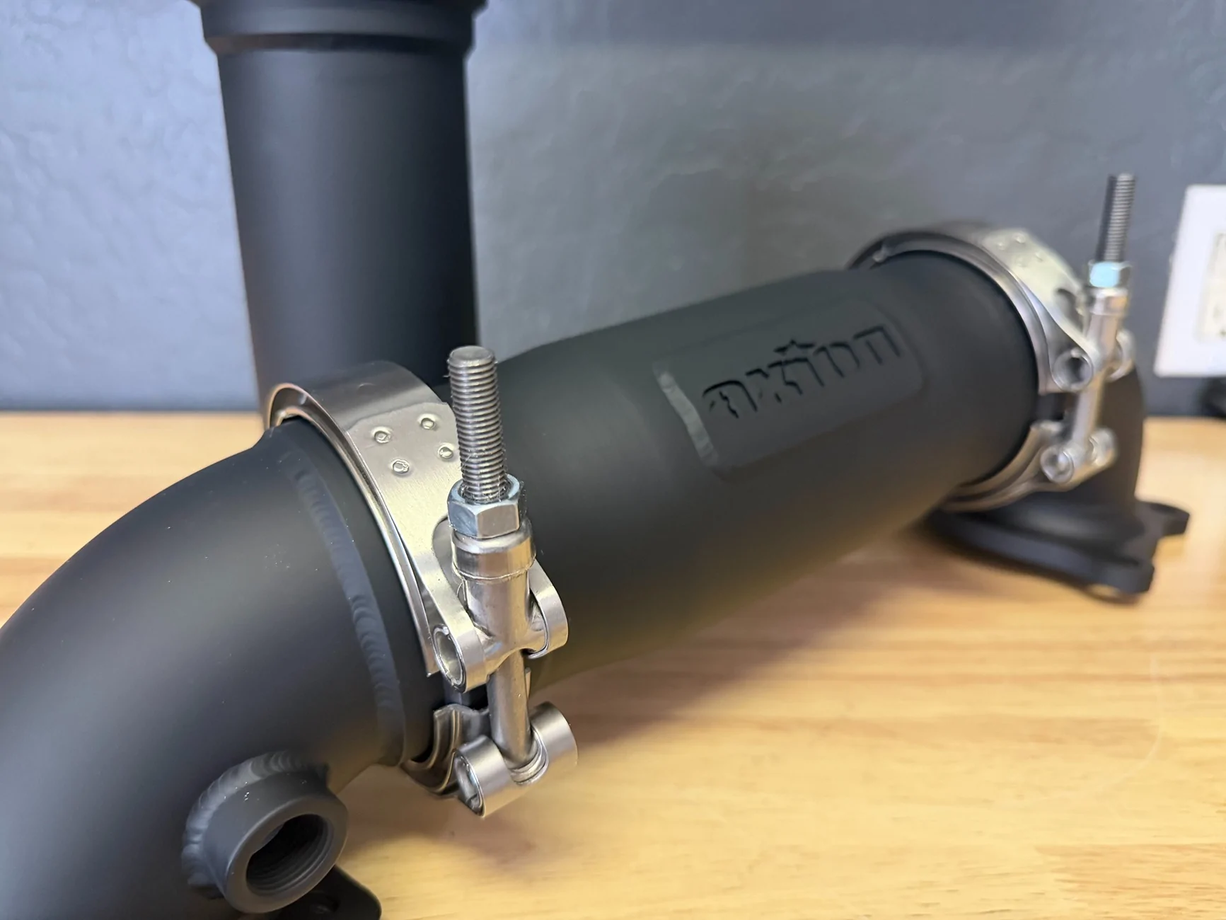

Vband clamps are the best in the industries and will not break or leak
I have over 300 downpipes being used for 1.5t and 2.0t and no warranty claims. These are hand welded in the USA by us in house not robot welded in china like most on the market.
We are going to be offering a cerakote finish and we offer our own downpipe blanket to manage heat.

Well PRL, RV6 and many others only offer catted downpipes. PRL dont even make any downpipes and havent for 3 years now.
Catless will make 5-10whp more over catted but that also depends on the mods you have or oem to larger turbos
