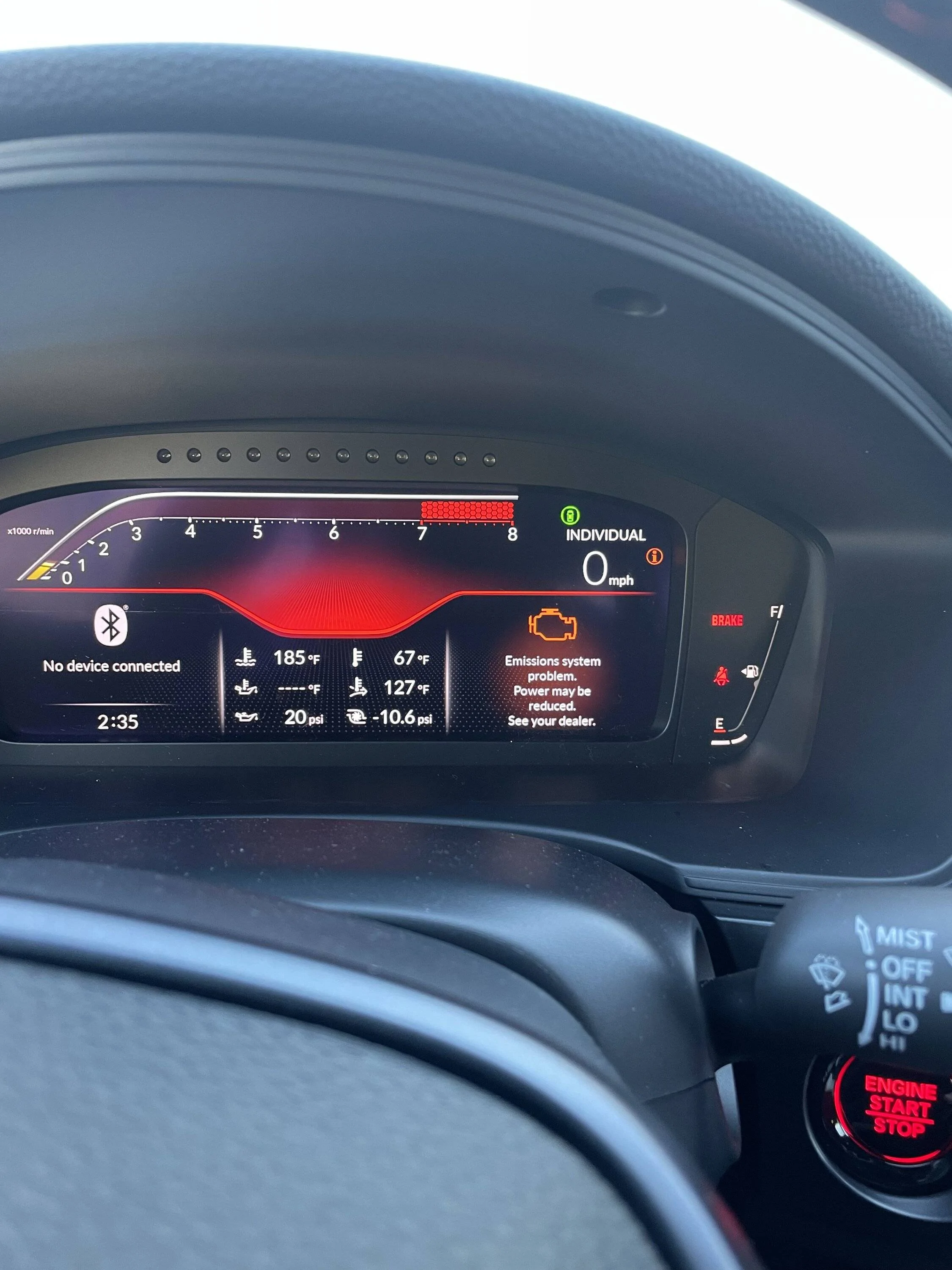

Hey guys... (sad face)
I'm HOPING this issue with the emission problem (CEL) is not affecting all of the early production models but I got my engine check light which states there is an emission problem along with a rev-matching system problem (I heard it comes with it. Rev matching issue disappears when I disable it).
I've done some research and it looks like FK8s are also having these issues and they were able to replace bad harnesses with newer ones to fix it.
Anyway, my car only has been 200 miles (everything stock). Scanned it last night at Autozone to get what code it is and It's code p0011 - 'Camshaft Position Timing Over Advanced or System Performance' (I believe it's a sensor problem?). This might be a different case than fk8s, so I'm planning to go to a dealership tomorrow morning.
Let's see what they say. I will keep it updated!

That sucks man, especially on a car that new. I hope the dealer has some good news for you!
CTR
Dec 3, 2015
634
703
WA
Could be something simple like the harness connector wiggling loose or the contact backing out. Hope so! Please keep us updated.
