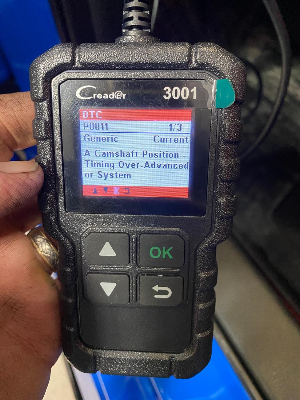

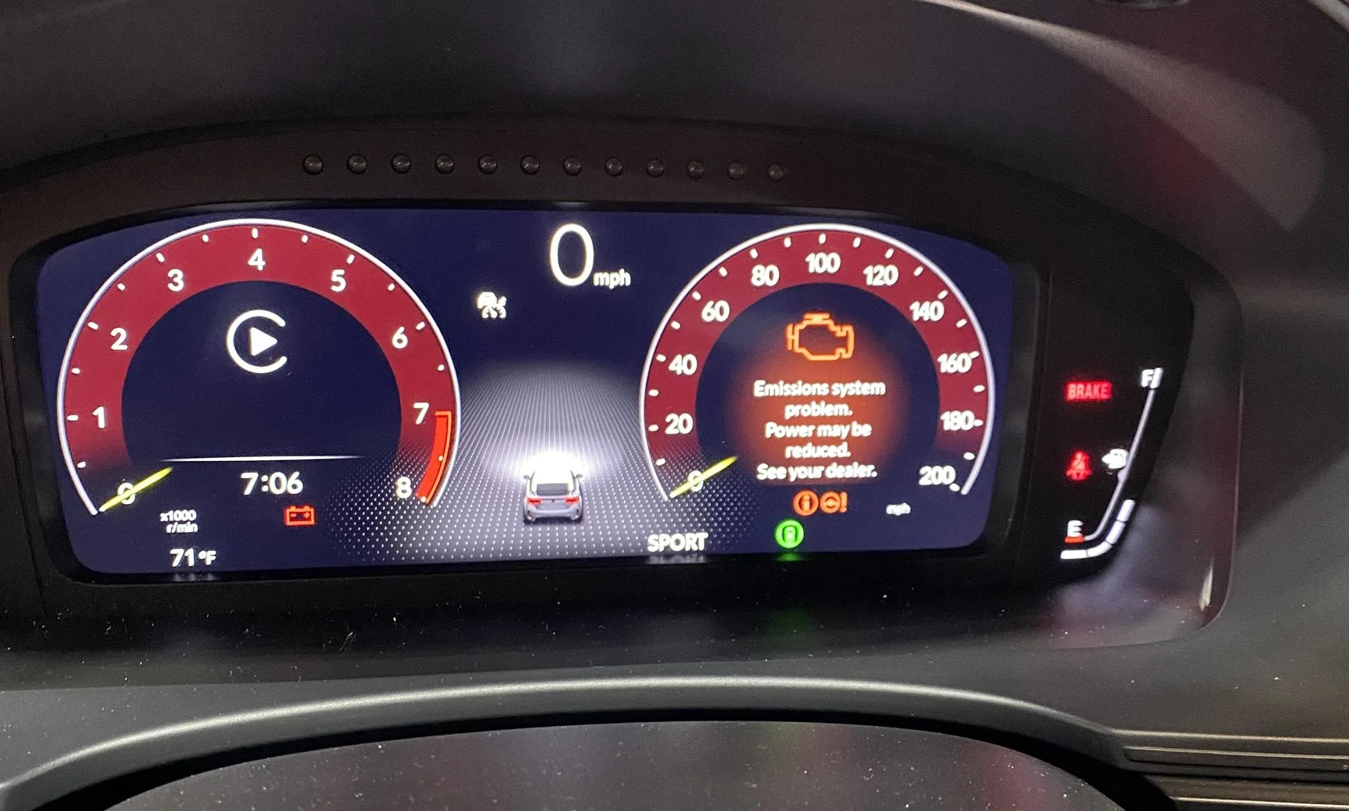

I had this problem pop up. I took the pics shown below, and the fault cleared itself on the way to the dealer...go figure. The dealer looked up the issue and found some TSB and did the fix. The repair took overnight, since the fix included a "hot" cam position sensor calibration, then a "cold" calibration, which of course required the car to be cool.

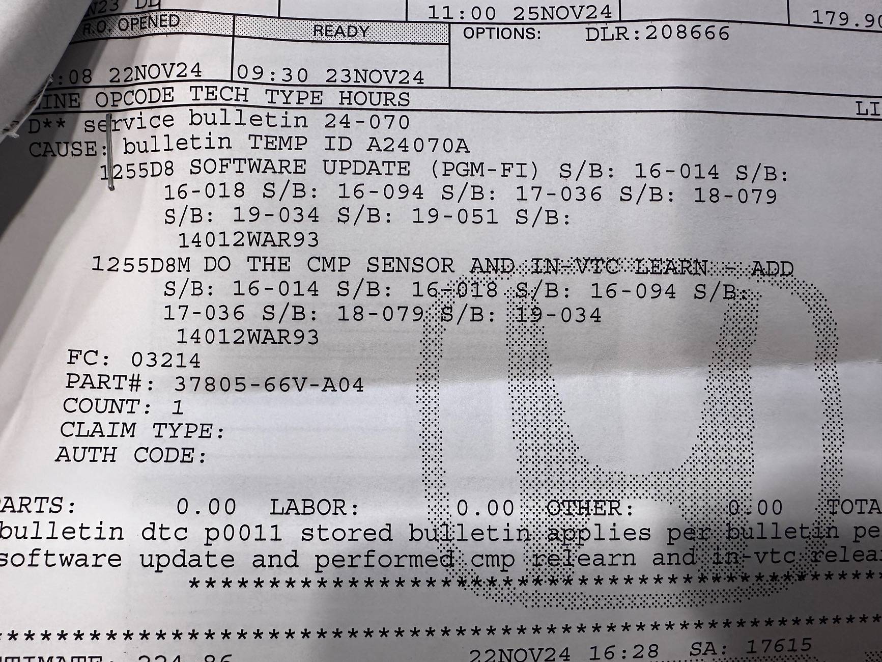

Had the same issue yesterday, less than 5k miles. I just started driving the car on my road after letting it warm up, and the dash lit up like a tree with a loss of power right after.
I could have reset the codes but I took it to the dealer. They kept it overnight and replaced the cmp sensor and did a software update based on the TSB for the P0011 code. Attached the info for anyone that needs it going into the dealer. Also got my steering gearbox recall while it was in.
