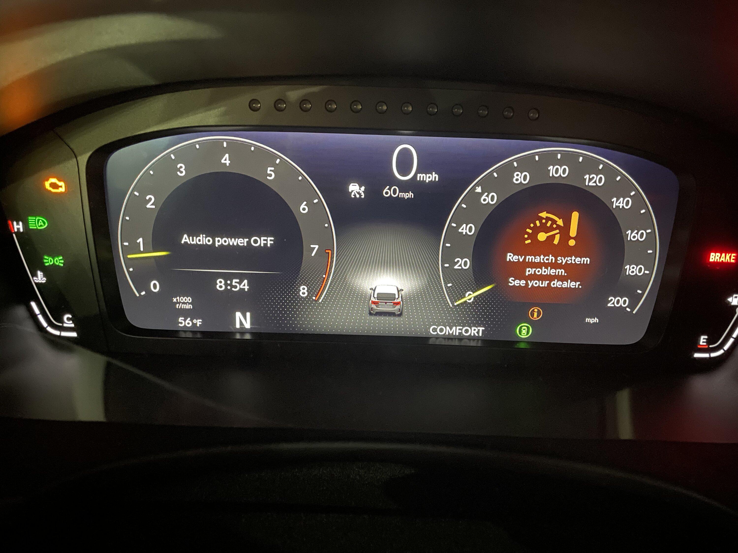

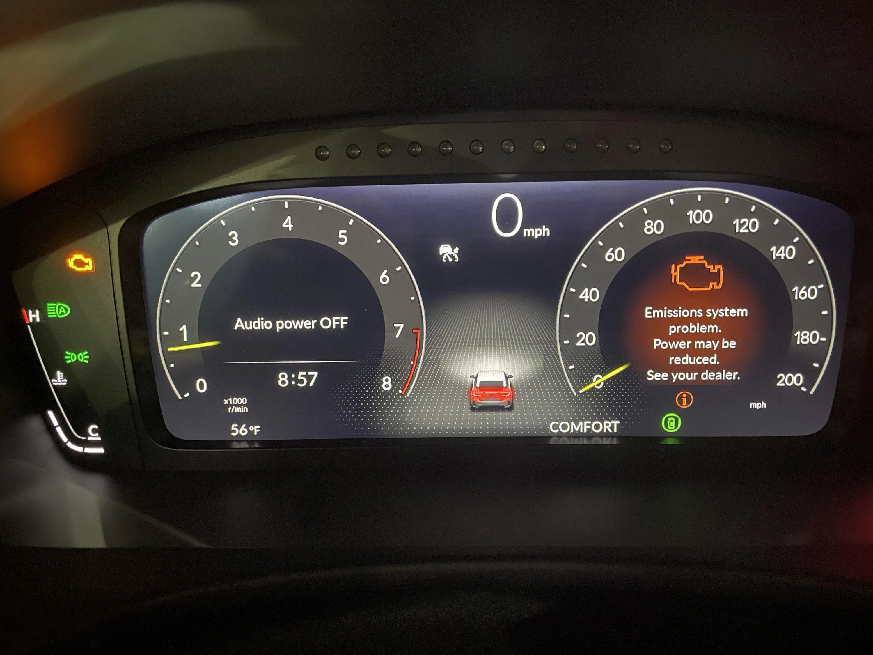

I got the emission and rev match warning message while driving home after the purchase. Not exactly the way I wanted to wrap up my first drive. I picked up the car late in the evening so I was forced to drive home.
Does anyone know of any risks with driving the car, or should it be towed? Car seemed fine on the drive home but there was a smell of plastics getting hot. I’m assuming the smell is from the engine getting hot for the first time?

Wow... It didn't do it to me till after the first fill up. I don't believe there's much danger driving it this way as long as u don't floor it, at least till u get back to the dealership, but I also didn't get the "hot plastic" smell.

@Genevagear Yeah. It’s fine. Just keep your RPM’s below 4k and take it back to the dealership. It’s most likely the solenoid issue that most here, who have gotten the random CEL, have dealt with. Sucks, but don’t let it spoil your experience. It’s totally fixable and under warranty. Agree, the smell is very likely just the engine being warmed up for maybe the first or second time since leaving the factory.

It's taken me a while to respond, but here is an update on the issue I reported above. Dealership recommended not driving the car and had it towed back. Once it arrived they reported DTC P0461 and TEMP CODE P0442. They cleared the codes and performed an evaporator system test and it passed. The evaporator system requires a 12 hour "soak" period after a test. I was instructed to drive the car home let it sit overnight for at least 12 hours and test drive it the next day. I have not had the issue since.
