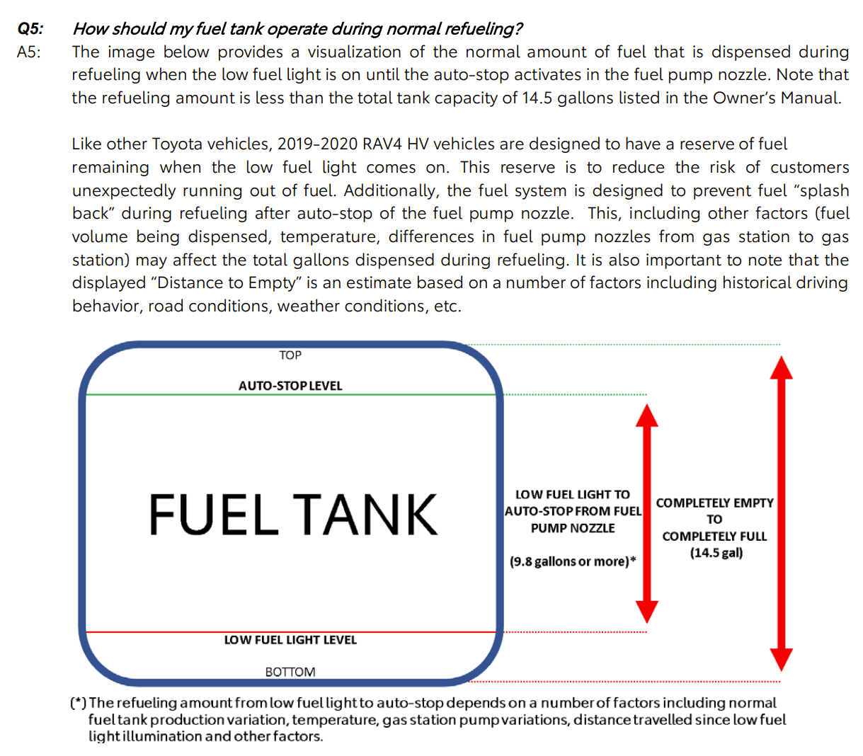

The gas tank for the 2.0/1.5T/K20C1 should all be the same. If this is an actual widespread problem, then there will be a recall for all 11th Gen Civic after enough people complained about it.
An excerpt from the famous early 5th Gen Rav4 Hybrid Gas Tank Recall should give you some insight on why you should never trust Distance-to-Empty 100%.
"It is also important to note that the displayed "Distance to Empty" is an estimate based on a number of factors including historical driving behavior, road conditions, weather conditions, etc"
If you can only pump say 7.5 gallons or less when the low fuel light is lit a couple times a month, then I'd be concerned.
