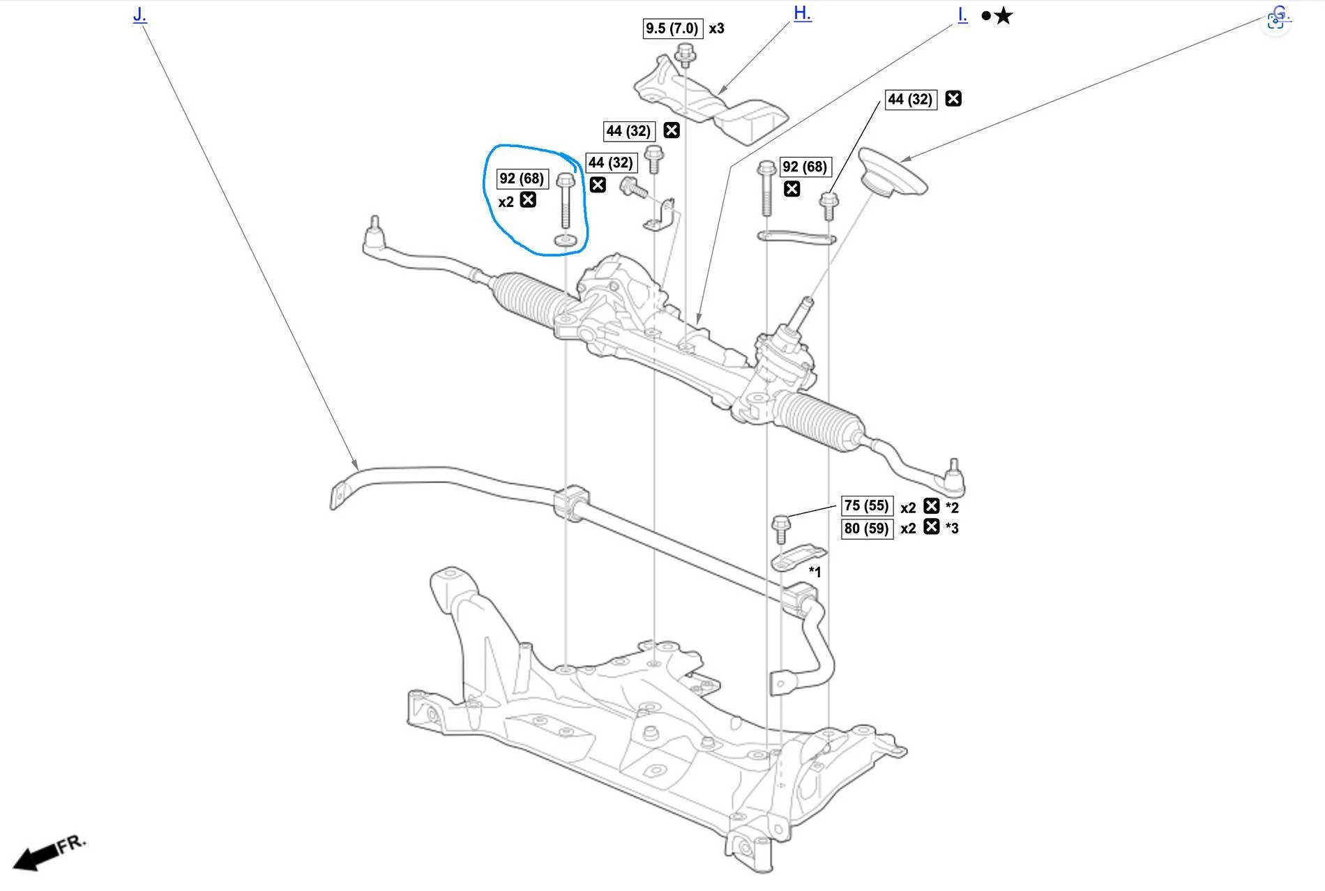

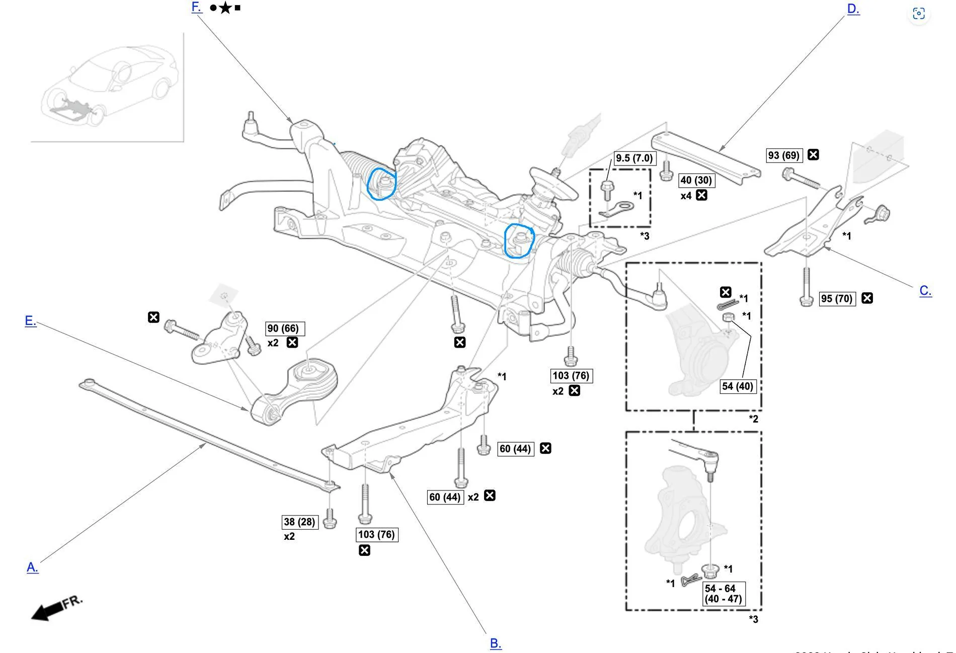

OK, so the bolts you circled fasten the subframe rear stays to the chassis and are torqued to 69 ft-lbs. See item C in the below assembly diagram. I doubt those were loose from the factory.

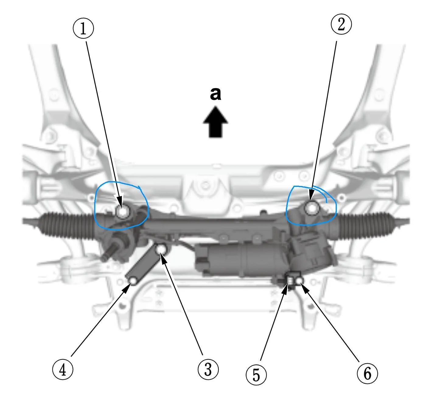

As for the missing bolt, I'm 99% sure that bolt and its left side equivalent are the primary bolts fastening the gearbox to the subframe. I circled them in blue in the above and below images. Note the image below only shows 1 bolt, but says "x2" meaning the same bolt/washer/torque spec applies to both sides.

There's no indication that there are any differences between the bolts in the FL5 vs the regular hatchback. I could be wrong about this - it's kind of hard to see where the bolt holes are with the angle the diagrams are drawn at. Also, even the old recall procedure doesn't involve removing the gearbox from the subframe so even if that procedure was used those bolts wouldn't have been touched. It's not uncommon for service procedures and documentation to show bolts/screws/etc that were later deemed redundant or unecessary and not installed from the factory. The FL5 has been pretty much identical through the '23-'25 model years, so it's possible that bolt was removed in '24 or '25 but that change wasn't reflected in the service documentation. Anyway, I'm not a certified Honda tech, so if the dealer says that bolt isn't on the FL5 I'd be inclined to believe them. It just seems odd to me that one of the beefy gearbox-subframe mounting bolts wouldn't be installed.
I attached a PDF of the full front subframe & gearbox removal/replacement procedure if you want more details.

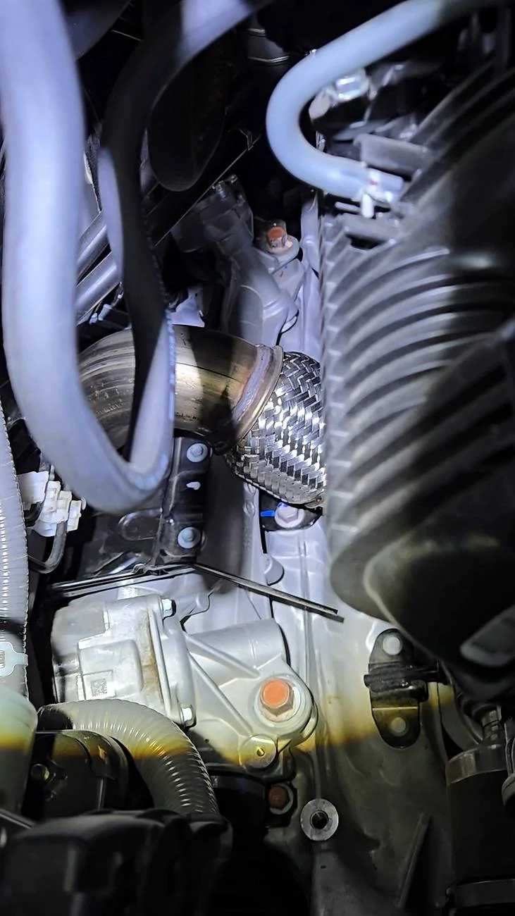

Both bolts are installed for the steering rack so yolo. Do what all honda owners do listen for vibration . Worst case if they missed a bolt i already have record of tyem ins0ecting for loose/missing bolts

would this recall cause the bolts i circled to be about to literally fall out and in the second picture it seems like a bolt is missing on the right.
Regarding that missing bolt - pretty sure that’s normal. I noticed it the other day when under the car for an oil change. Looked at some fl5 underbody pics online after, and they all seem to be missing it.
