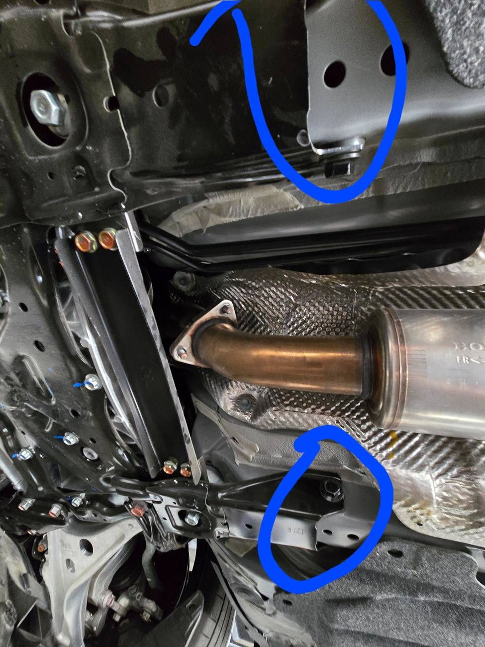

11th Gen Honda Civic FL5 recall (2022-2025 Civic Steering Gearbox Assembly) 1000004186

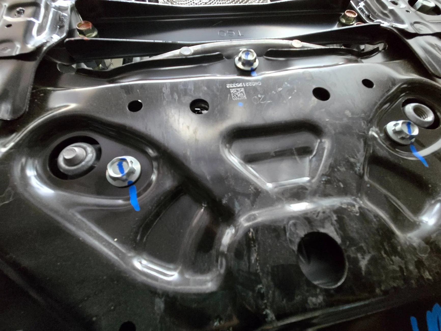

11th Gen Honda Civic FL5 recall (2022-2025 Civic Steering Gearbox Assembly) 1000004188
would this recall cause the bolts i circled to be about to literally fall out and in the second picture it seems like a bolt is missing on the right.
I saw your other thread and this could definitely be the culprit.

Also put the picture here. It's easy to miss behind the splash shield

So i argued with the service advisor and he showed me the entire repair process I guess they don't drop the subframe. But he was like maybe it came loose from factory will look at it right now tho for you ?
When did you have the recall performed? They don't drop the subframe anymore (see my posts earlier in this thread). Did you talk to a service advisor or the service manager? If you didn't talk to the manager, ask to speak with them, then ask to see the job details written by the tech who performed the recall. They should have recorded exactly what they did.
It's possible the tech used the old procedure if they were working off an outdated TSB for whatever reason. Or they started to do it, realized the TSB was updated with a different procedure, went "oh sh*t", rushed to bolt stuff back on, then did it the right way.
I find it unlikely that those bolts were loose from the factory. They would have been torqued to spec during assembly. Plus, the fact that you have multiple loose bolts on the same part sounds to me like a sloppy job done after it left the factory. I would 100% go to the service manager and ask how that could've happened. Specifically mention that you've read the TSBs (I posted them earlier in this thread), know that the recall procedure used to involve dropping the subframe, then express concern that the loose bolts seem to indicate that the old procedure may have been used.
So i asked even said that the procedure has been updated. Theg swear that they never touched the bolt but would re torque all the subframe just in case so ? same result I guess and he said that the fl5 comes with that bolt out
Well at least they'll re-torque everything. I'll see if I can dig through my AllDataDIY database tomorrow and locate the bolts in your pictures. Then I can at least confirm which ones aren't shipped from the factory. Also, keep an eye out for alignment issues if you haven't checked the usual symptoms yet. If the subframe was dropped at some point, it could mess up alignment if it wasn't re-aligned afterwards.
I'd really appreciate that. I do rember that did an alignment after maybe I'll take it to a local. Shop tho amd see what's up drivability seems to bee good tho
