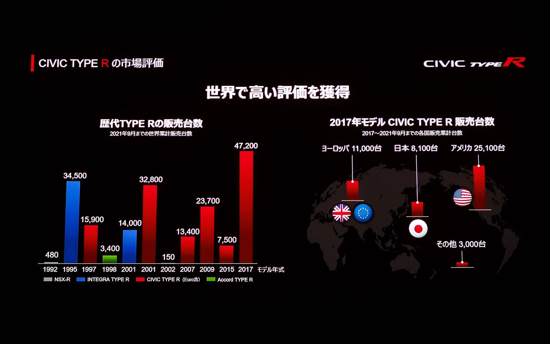

FK8 sold roughly 7,000 units worldwide each year, so 10,000 a year seems reasonable for worldwide, not for just Japan.
Actually, On July unveiling date, there is a FK8 sales figure released by JP media, it should be from Honda Offical PowerPoint for the FL5 release presentation in Honda welcome centre at Aoyama. it stated that the worldwide sales is 47,200 units. US accounted for 25,100 for 5 model years.

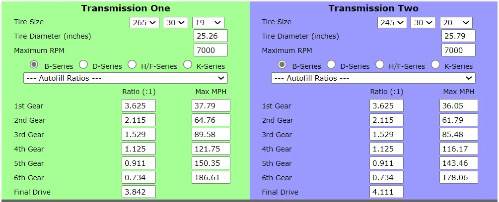

The wheels are significantly smaller btw, so the gear ratios might not make a huge difference with the car overall.
Totally forgot about that. I put in FL5 values on the left and FK8 values on the right, assuming a 7K rev limit:
11th Gen Honda Civic FL5 Type R JDM Spec leaked, +40kg;Reservation skyrocketed in Japan reported by Bestcar 1661813727481
I think the 0-60/MPG theory isn't too far off, even with smaller tires.
There was an Accord Type R in '98?! :oops:
Zavage
Aug 11, 2016
59
Germany
Civic EJ6, Honda Accord CU1( Acura TSX 2nd Gen)
Yes, in Europe and was built in the UK.
With H22A7 212hp 8k redline, 5-gear manual, stiffer chassis (rear seats don't fold down), Xenon headlights, diff lock and double-whisbone front/rear with sportier suspension.
I'm not sure where the info in the graphic relates to, as it doesn't seem to show the ITR DC5 run. The ATR in JDM was actually the 'Euro R' (bizarrely), whereas Europe inc. UK got the Accord Type R powered by the might H22A7 2.2 litre VTEC engine. I'm in the UK and had a 2007 model in nighthawk black:cool:
