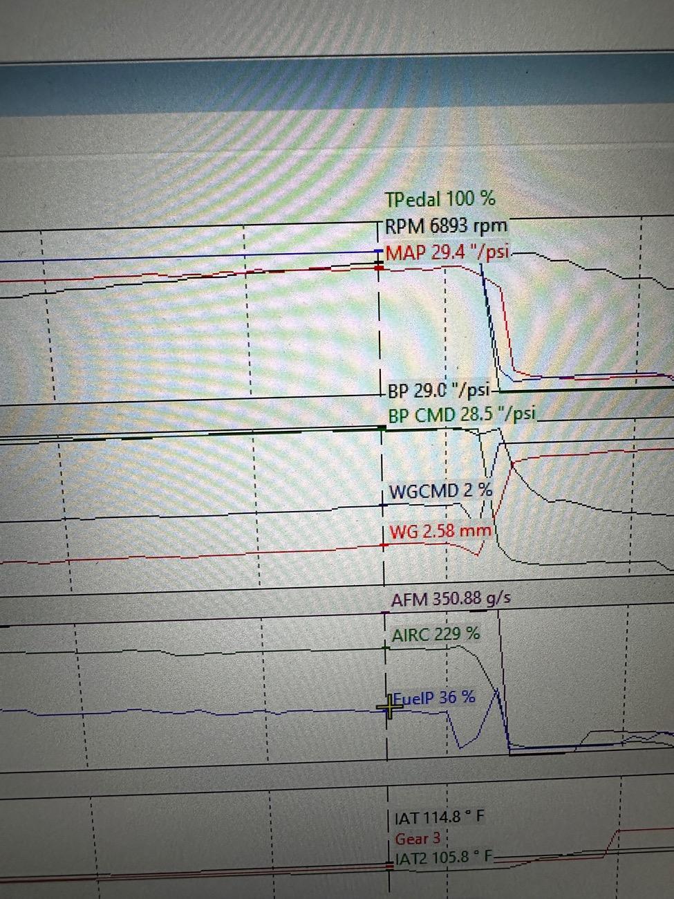

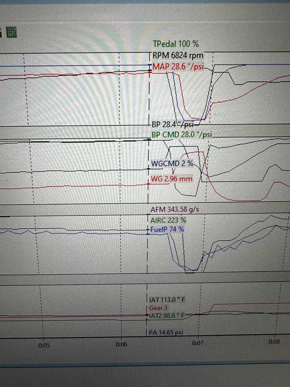

You were not wrong my friend. Posted more detailed data on my thread but just for the fun of it.
XDI with stock line:
11th Gen Honda Civic Full Race fuel system IMG_4281
Full race, even with my secret airflow mods that increased flow and boost a bit. It just laughs at what I’m throwing at it.
11th Gen Honda Civic Full Race fuel system IMG_4276

BY THE BEARD OF ZEUS!

This is a game changer and what I would put on a car if it were me. Sadly some of us early adopters will need to spend a bit more money but some of you guys now have the data.
