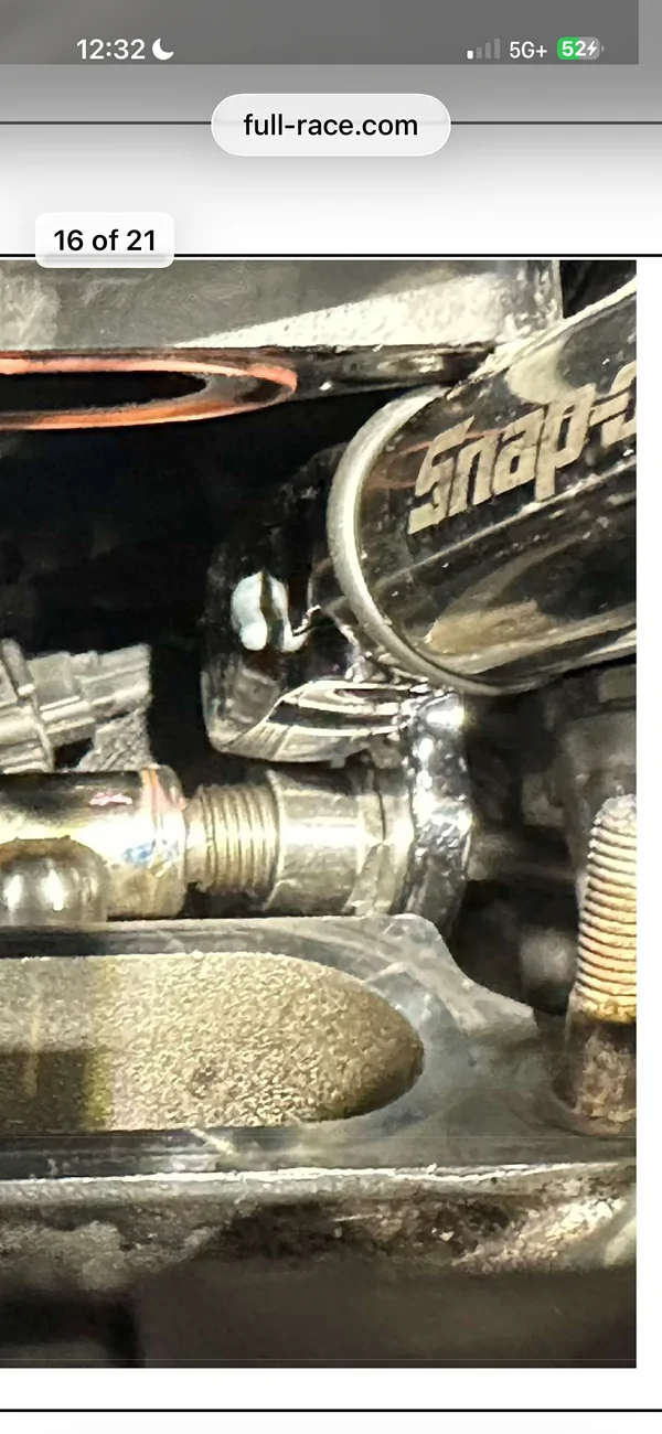

Hello everyone.
I’m all for safety and understand the concerns here. Please note that this line does not need a lot of torque. The factory line can handle being over torqued much better than the full race line. The torque is only 24ft lbs . 99% of people double or even triple that amount out of fear of leaking.

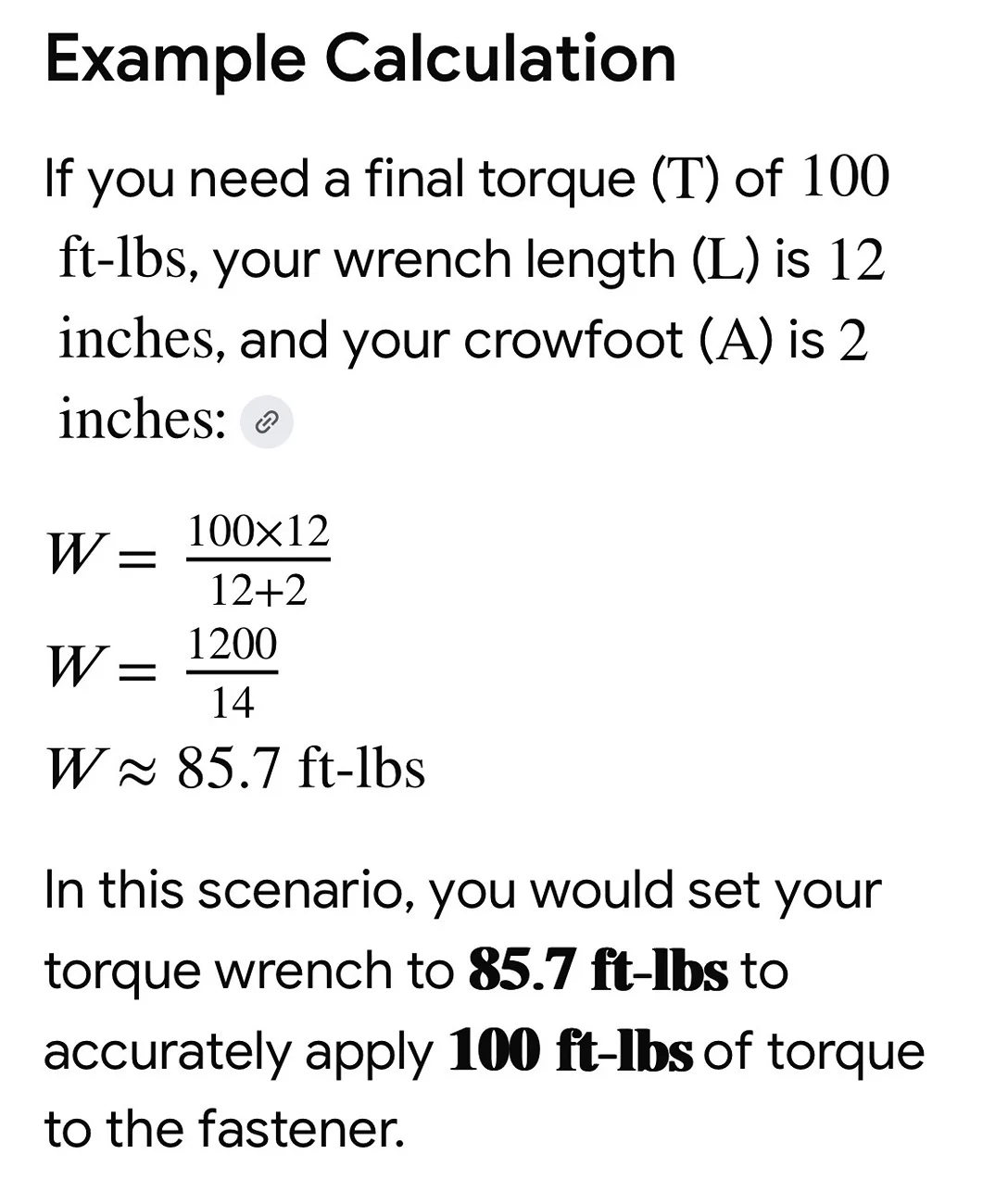

A common mistake acrossed the Automotive industry when using a crows foot on a torque wrench you should be 90° from the torque wrench. If you are not 90 degrees like the picture shown, it will increase the amount of torque on the component.
Having the crows foot in line with the torque wrench adds additional torque.
I know that almost no one actually uses a torque wrench. Please see the picture for the math equation when using a crows foot directly in line. I don’t remember the math for using it at a 45° angle but I know at a 90° angle It is the same as the value on the torque wrench.
I come from both Honda and the world of General Motors vehicles. The late model Chevy Camaro LT one is notorious for the factory line leaking went over tightened. These leak underneath the intake manifold and catch fire. A general motors also uses a ball and style connection.
I am not saying, someone installed something incorrectly here. I am simply pointing out a few things that could be helpful. If you are reusing the line, it is absolutely critical that it goes back in the exact position. The ball end after install has a depression line around it, and the cone ends do not end up with the same depression line. Over tightening will deform the ball end to the point that it will leak.
I am not saying there isn’t a plausible issue, but the vehicles that I’ve installed them on have had no issues even on the original version. Between my personal vehicle and four others, they have accumulated 70,000 miles since the pumps design. 3 of them exceed 700whp.
As far as the factory one breaking that happens because people put the factory line on the XDI pump and then try to bolt the line to the block. This bends it to the point of creating excessive side load stress. It was never meant to be installed that way on an aftermarket pump.
Please don’t think that I’m trying to say everyone is doing something wrong. I am only trying to help guide people to the correct method and help prevent issues. I take safety seriously. I hope the information provided above can help
