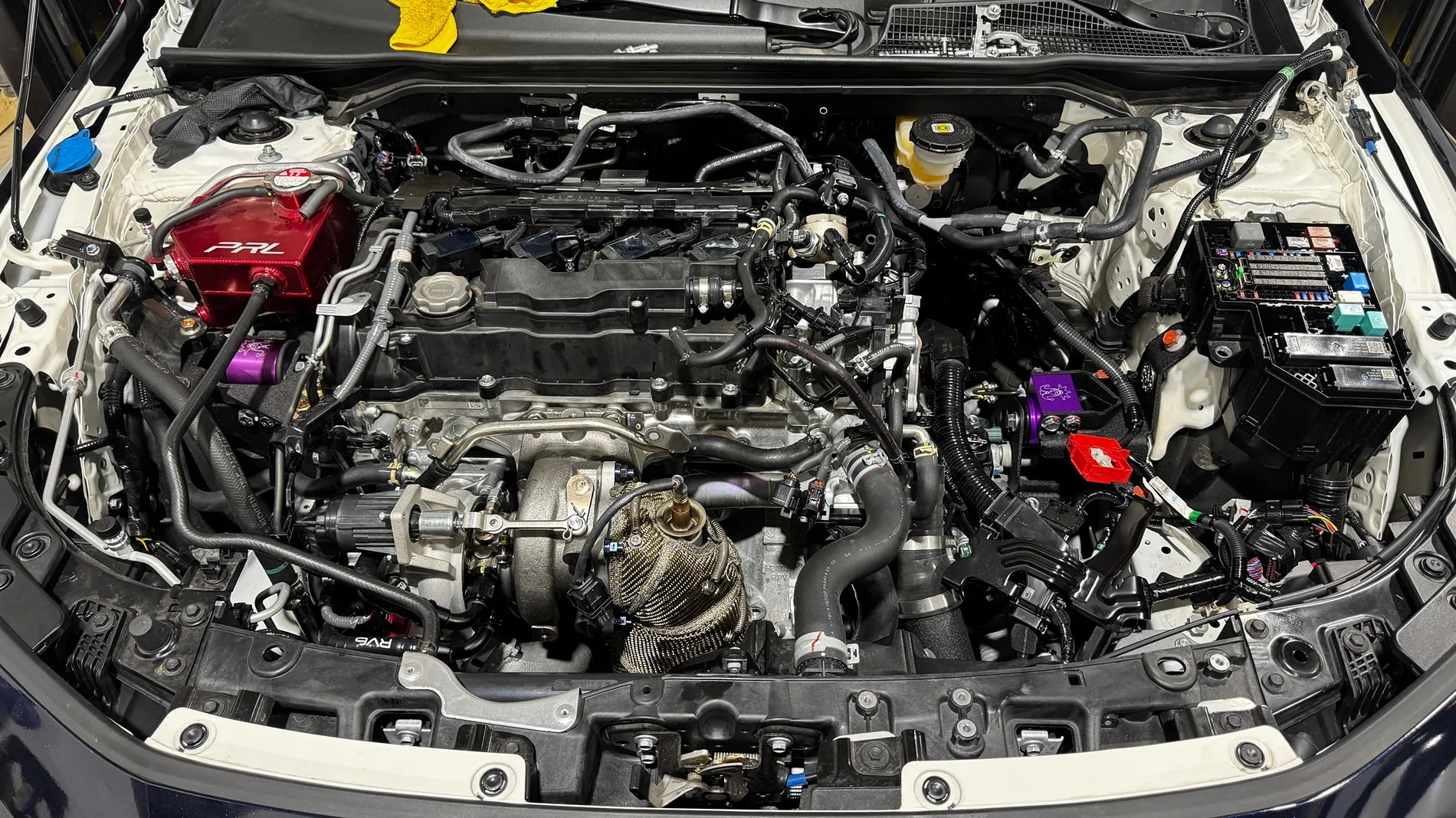

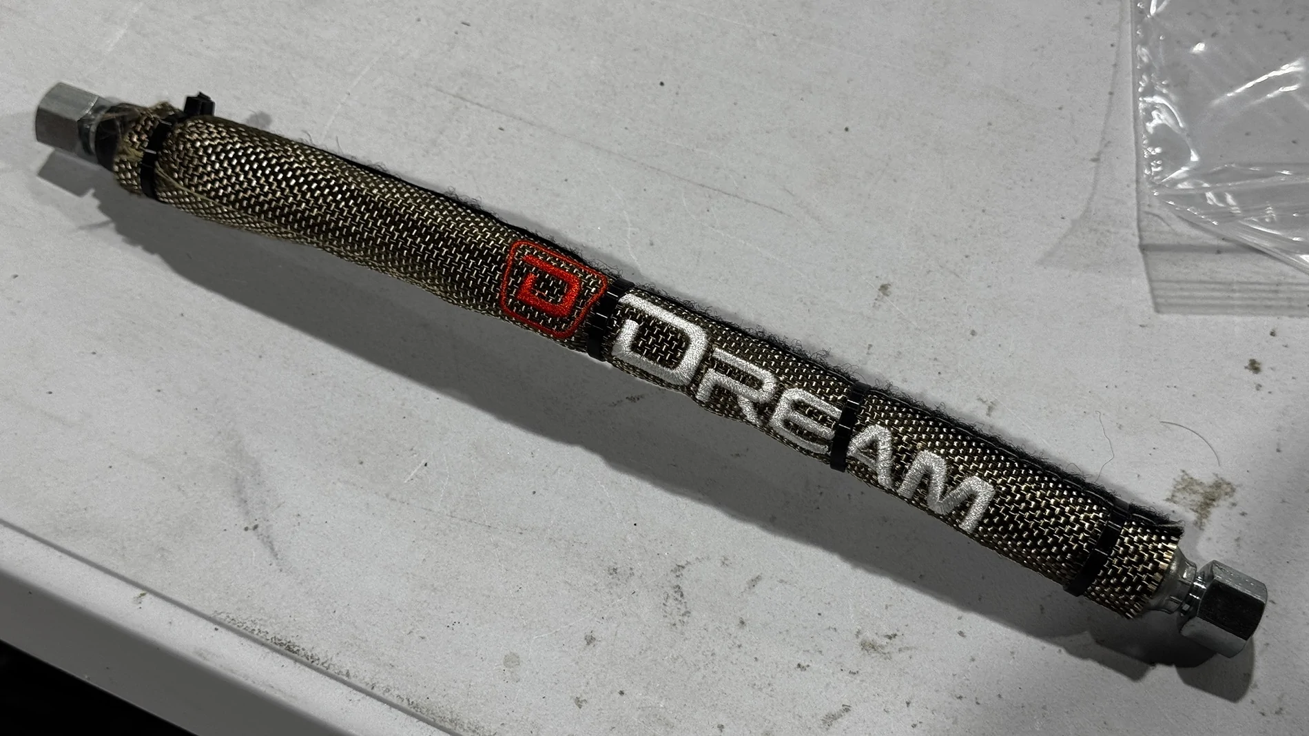

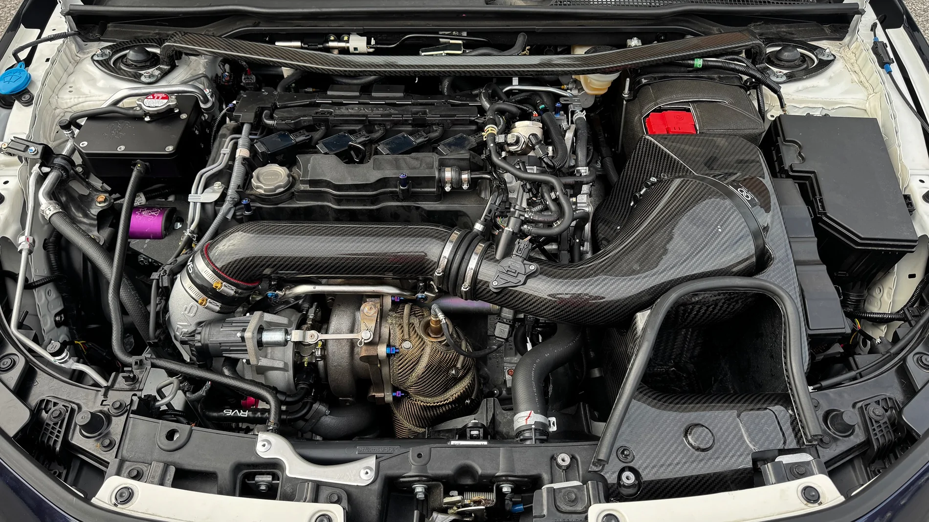

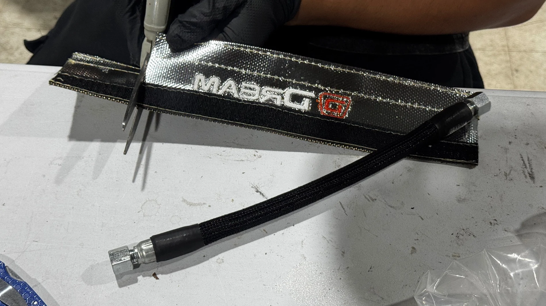

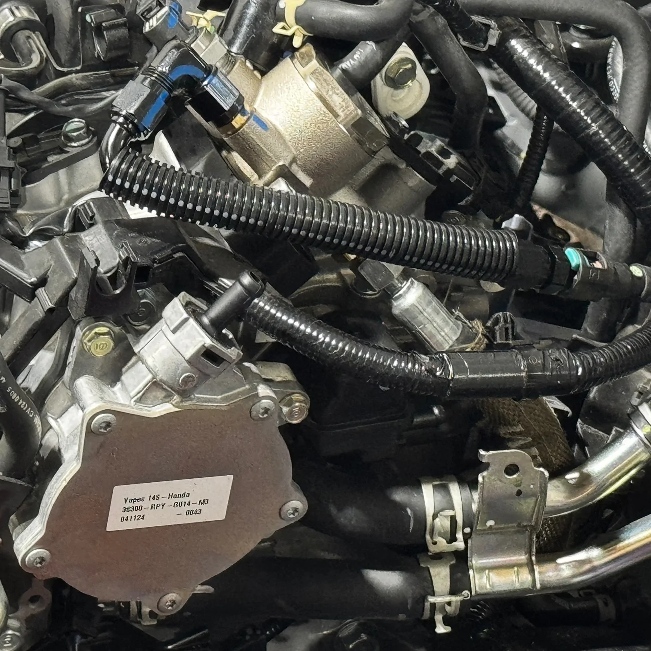

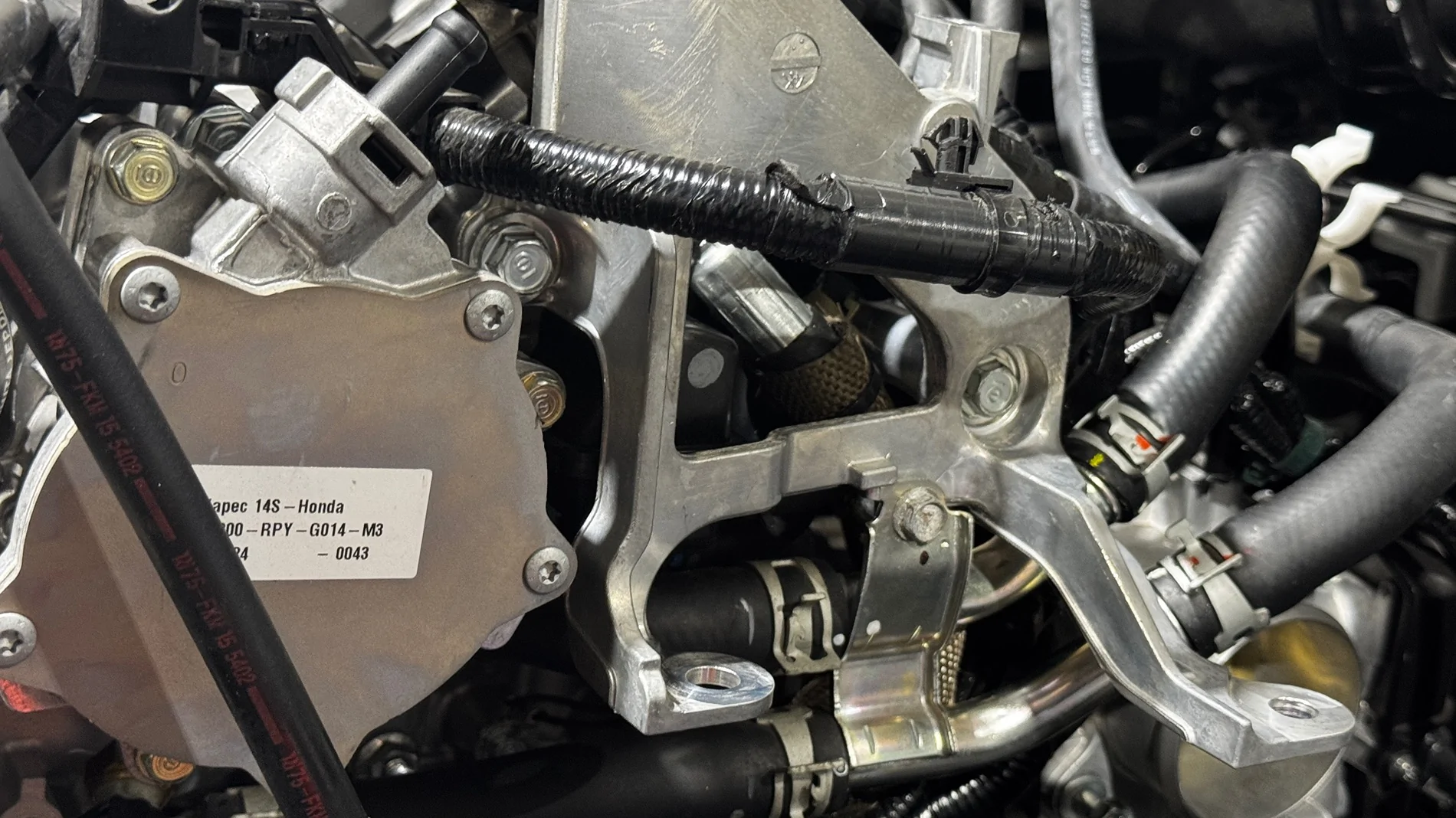

Update on my fuel system install, pasted from another thread. This is the summarized version:
We had a few questions on the XDI HPFP flex line that got answered along the way. Both ends of the line are identical, it's rated across all fuel types (including ethanol, race gas, methanol, even hydrogen in motorsport use, though XDI doesn't publicly advertise fuel compatibility to protect their manufacturer’s IP), and 3 1/2 threads engagement into the fuel rail is normal, hand-snug is really all these need before a final wrench pass.
Install came back together clean, checked every fitting before first start, no leaks at the HPFP, and it settled into a smooth idle after the initial crank cycles as expected. Idled 15 minutes with no codes, then took it for a shakedown drive on the basemap with no inconsistencies.
Logging is now underway for DRob ahead of the dyno. Got a 60-mile drive in with the 15-minute steady cruise and WOT 3rd-gear pull from 2000rpm both logged, still need to recapture the 15-minute stop-and-go (FlashPro missed it twice) and the cold start/idle log (FlashPro missed this as well 😬), planning to grab both tomorrow. Full tune on Shell 93 and Ethanol is expected in the next 1-3 weeks.
