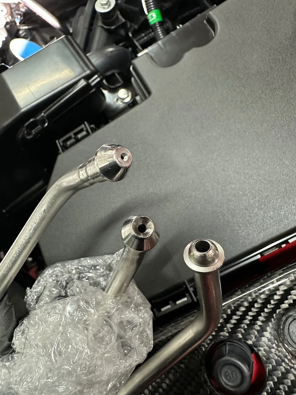

All good. I get the confusion. Yes the FullRace line is significantly larger at the conical seat at the connection point than the stock OE hardline. The middle ground would be a factory OE hardline that has been enlarged such as the JSR line which has all the benefits of the OE hardline mount features and weld/braze at the conical flange with no reported failures.
Picture here is the OE>JSR high flow>Fullrace lines compared for size at the seat.

Thanks for the clarification.

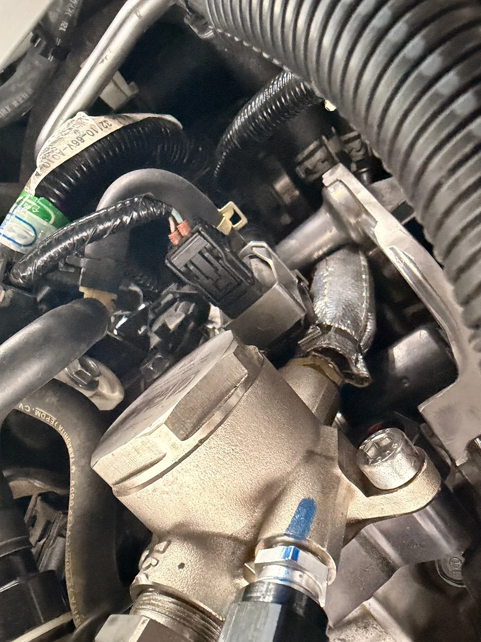

Hi,
Just thought I’d give my two cents here. I have the FULL RACE HPFP and 2 fuel line failed. After being tired of the failure I ordered a fuel line from XDI and installed it on my FULL RACE HPFP and it’s been good so far! The only thing is i had to purchase a heat sleeve to protect the line against a coolant line that can get a little hot.

I have customers that used the 4 piston line and that did not work properly. Is this the same line you are talking about?
