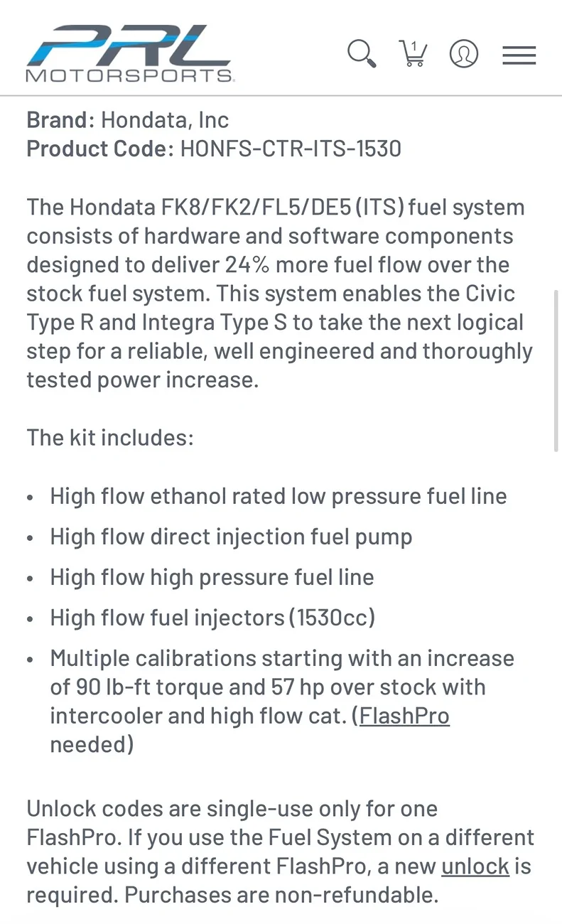

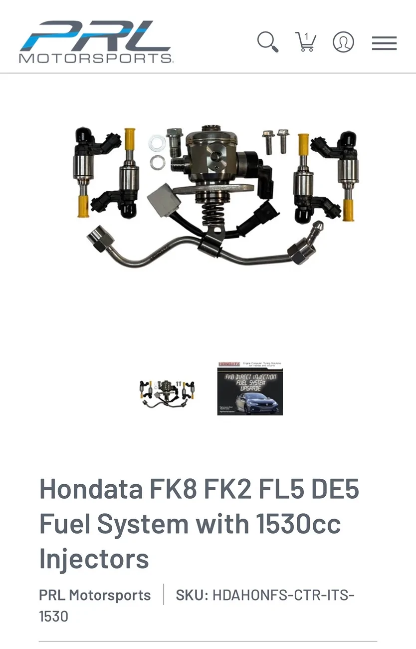

What is the max WHP on the Hondata fuel pump and injector combo?
