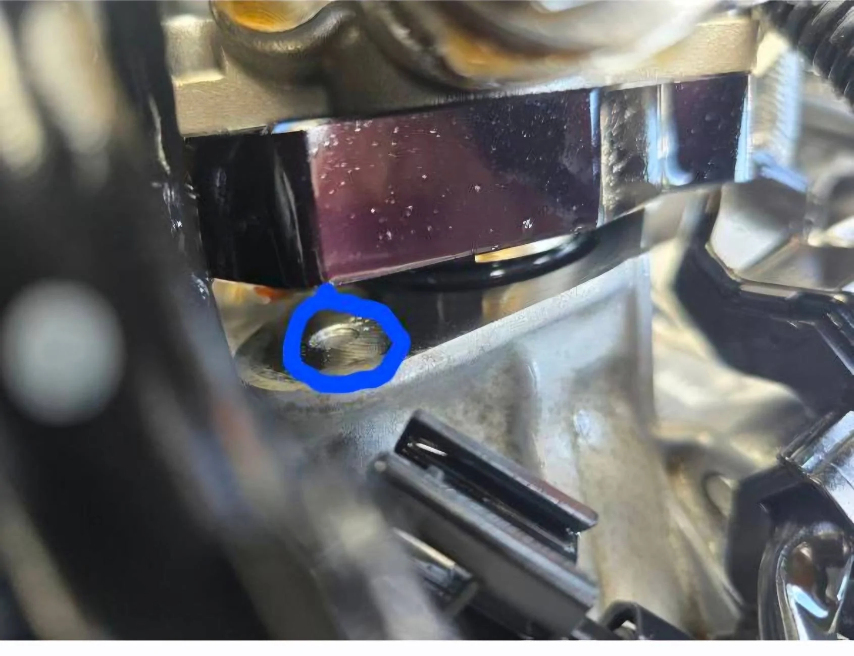

When you do the HPFP bolts and the adapter bolts, be VERY careful. They are very easy to over torque and you absolutely should use a known good torque wrench.

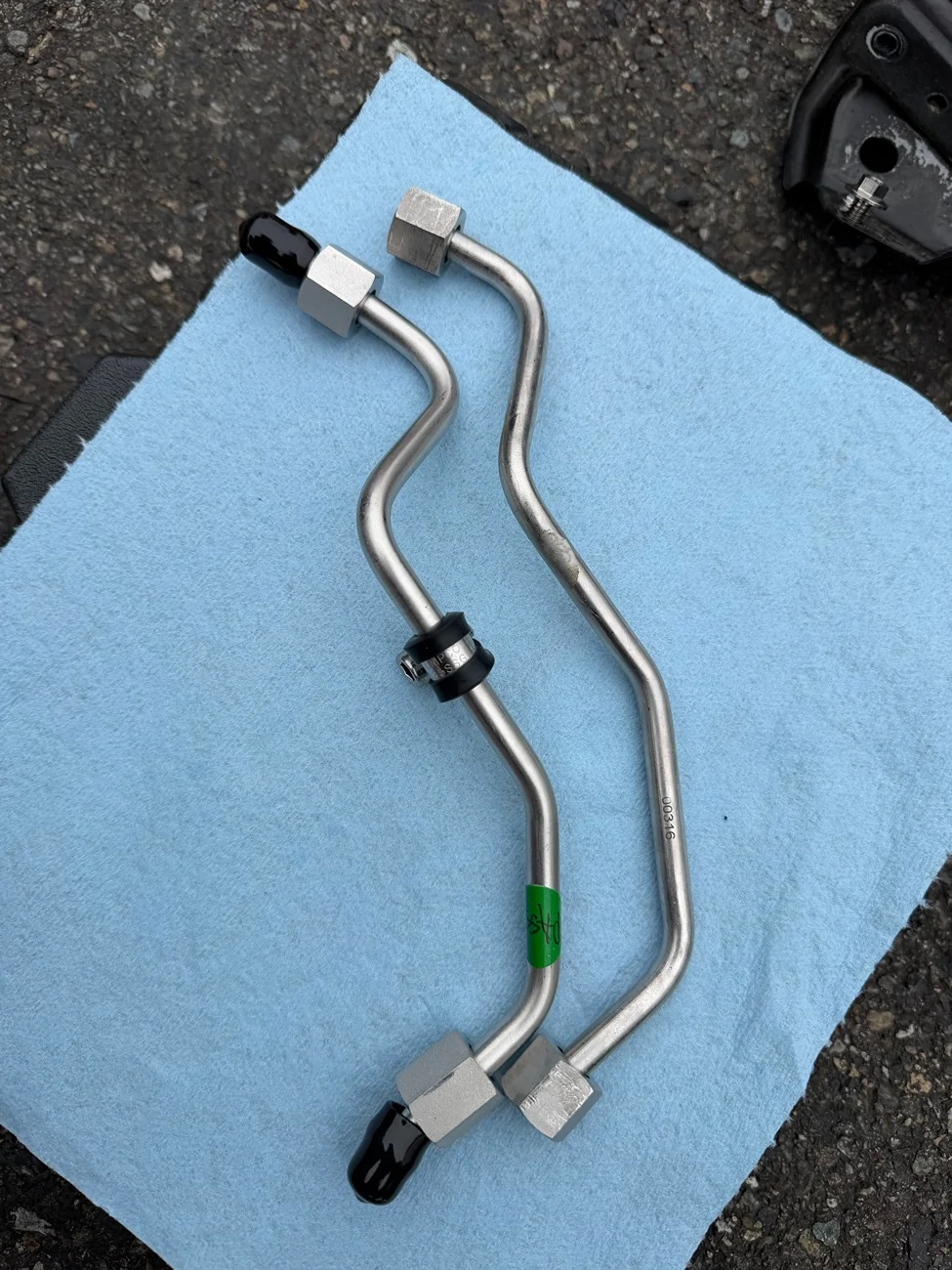

To give some insight into what happens when an issue is reported, we work side by side with Nostrum to perform a full investigation on any claims made. We had a handful of cases involving the fuel line that were caused by user installation error. Specifically, the high pressure line wasn't being positioned correctly prior to seating the compression nut, and further tightening the nut in an attempt to stop a small leak just makes the issue worse. This is a deformative connection by design, as used by many OE's in high pressure fuel applications, and not having this aligned properly will cause irreparable damage to the fitting which requires line replacement. We can determine that was the root issue by examining the witness marks on the line.
One later investigation led Nostrum to identify a failure that was not related to user installation, as mentioned above. This led to a closer look into the manufacturing process, and the investigation summary is that a recent change in the manufacturing process was responsible for the potential issue. To be transparent, the rate of failure has been just under 3%. Because we stand behind our product, we immediately halted shipments of pumps and corrected the process. There are a number of operational countermeasures that have been implemented as a result of the investigation. We then had lines made for every customer who had already purchased our pump before continuing production of new pumps.
Most of you should have received your lines by now, if you haven't, please reach out to the vendor you purchased from so we can get one headed your way. We are very sorry for the inconvenience this has caused, but we want to ensure no stone is left unturned and all risk is reduced, regardless of how small, as our reputation and trust with our customers is our #1 priority. We have been operating in this industry for 22 years, and intend to be around a lot longer.

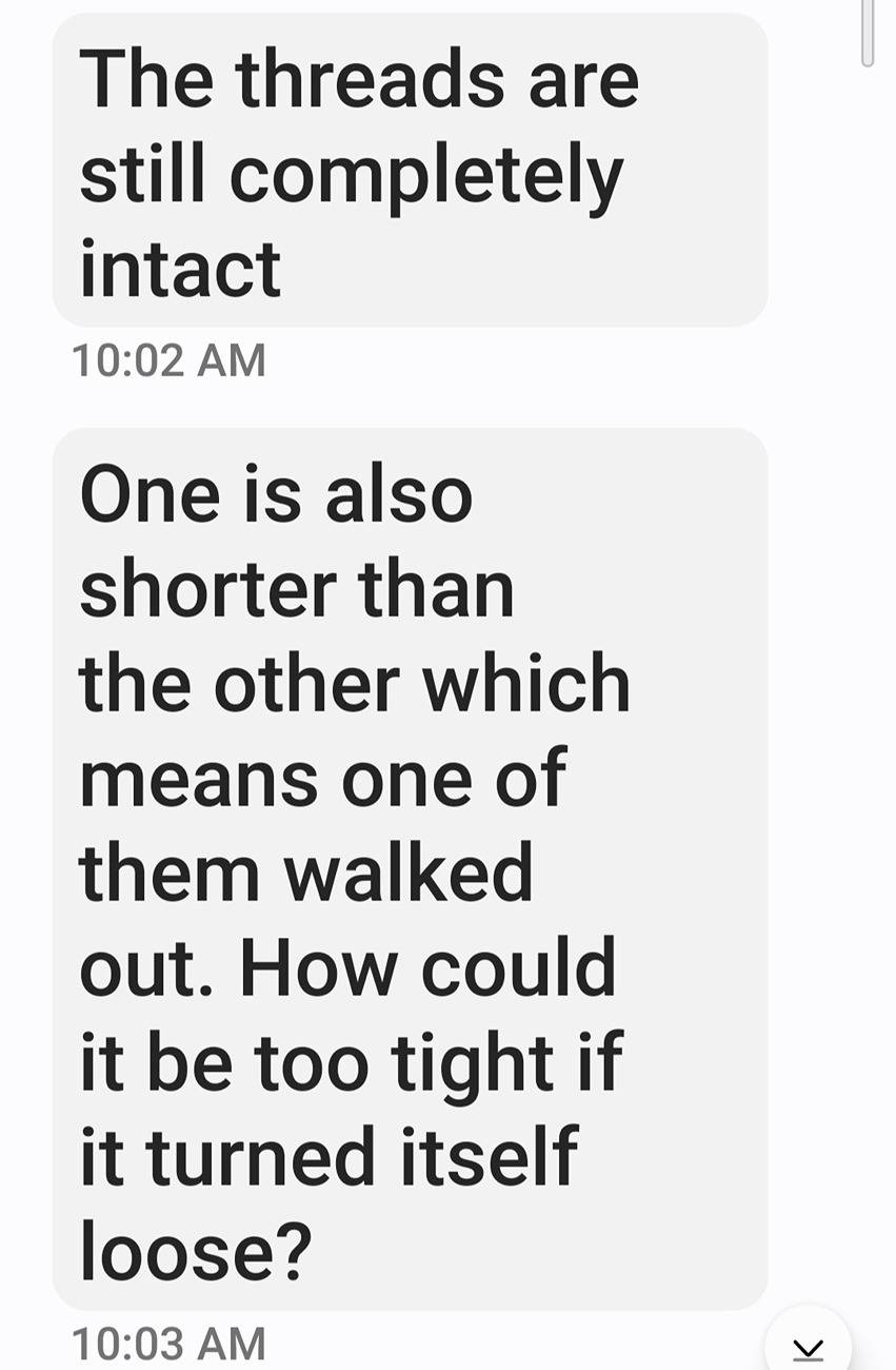

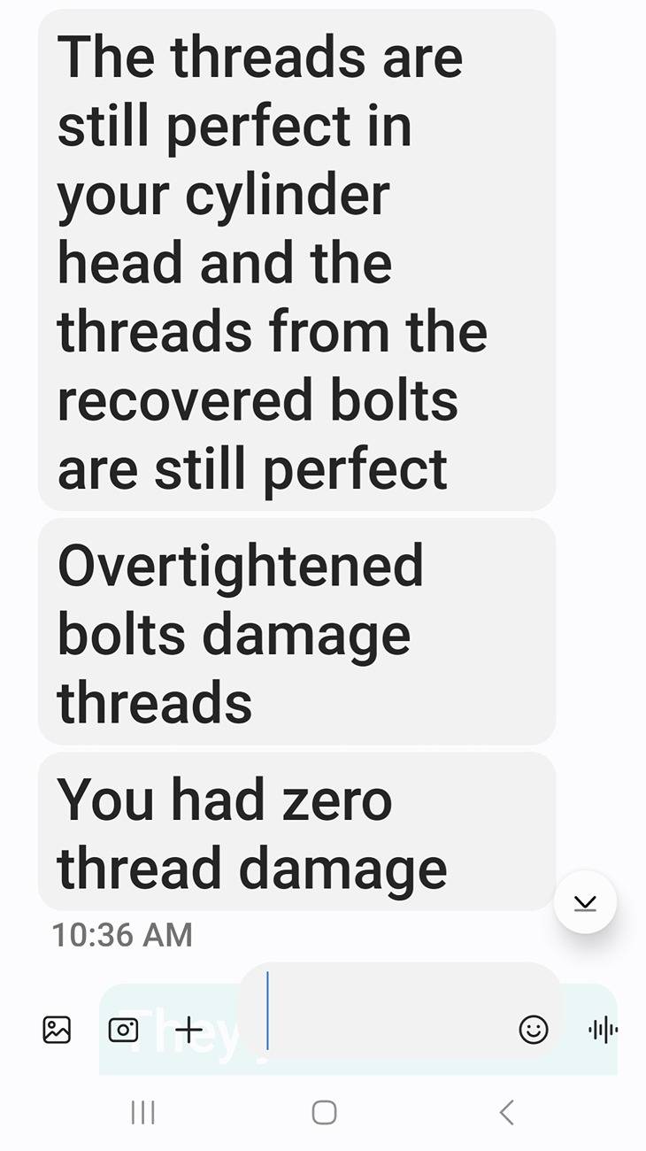

As for Tougefl5’s comments, I believe some context should be added to his posted picture and issue. His leak was not due to anything with the fuel line, but the two bolts holding the HPFP had sheared off. We sent the pictures he provided to Nostrum and it's not something they had seen happen before - or since. We both agreed it was due to over torqueing, the M6 stainless steel hardware is going into aluminum, easy to do as it should only be torqued to 14 Nm (10 ft-lb). We’ve seen his posts saying we use “junk” hardware and wanted to assure our customers that his issue has been a one off, and unrelated to this thread.
This pump has been anything but rushed to market. It has been meticulously designed, developed, and tested to be the best possible high pressure fuel pump solution available. Mistakes unfortunately do happen from time to time, but we hope we can continue to build your trust in our products by taking the correct countermeasures and ensuring you have the best product available in your hands.
