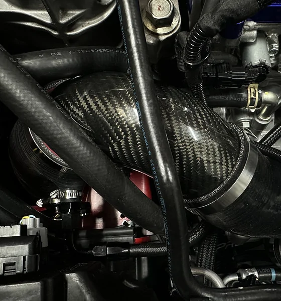

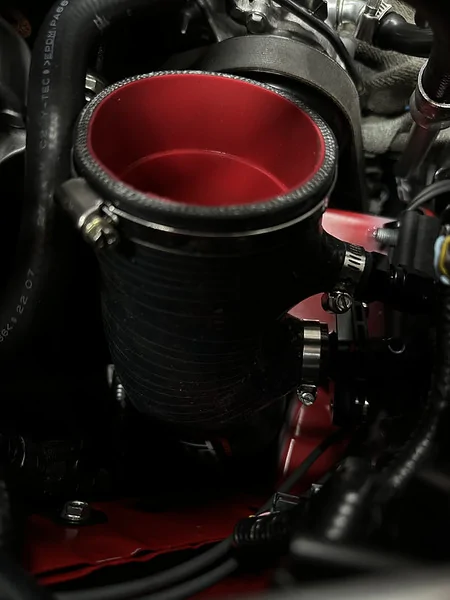

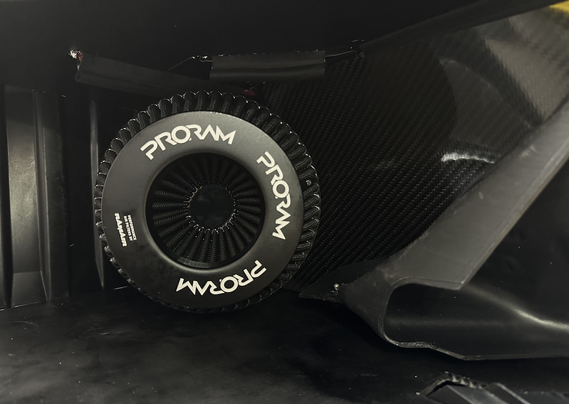

So i have finally reached a good point to share further data on the intake kit. Since the initial development of the kit i have evolved it to a v4.0, which now retains a carbon fibre 90 degree elbow with a TSP silicon hose pipe, matched to the same Pro Ram intake filter with the factory MAF sensor housing cut out of the factory airbox. My v1.1 had a ProRam Maf sensor housing out of their off the shelf kit.
Tuning is still ongoing, hoping to get more track time for more data. So stay tuned.

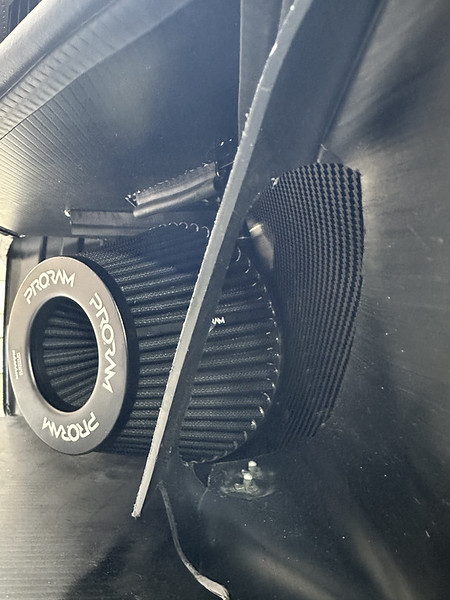

A small refinement to the kit. I decided to use some leftover corflute and carbon sheeting and fully enclose the pod from any water ingestion. Also cut open the brake duct further just to get more air into the pod.
11th Gen Honda Civic Gambit intake kit FL5 i-DTJT9ZW-L
11th Gen Honda Civic Gambit intake kit FL5 i-7mrmPbH-L
Plan is to swap in an Eventuri pod filter with a larger 4" inlet and also add in a bellmouth carbon intake feed to the enclosure duct, to clean up the airflow into the area. Hoping that increases total surface area inlet for more forced air potential.

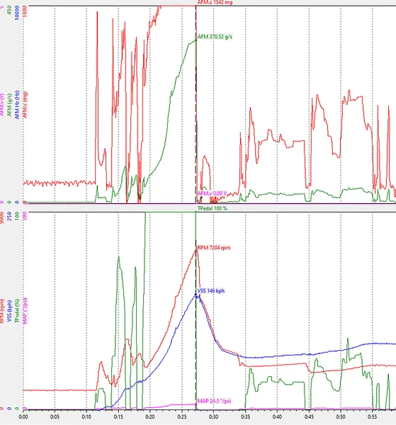

Do you have a giant turbo on your car? I see your AFM is reading 370 g/s at max RPM. Mine maxes out at about 280 g/s on the stock turbo, with both the stock intake or the PRL.
Jester04
2,044
2,690
These are just starting out numbers for airflow. More to come!

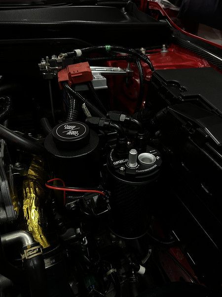

Yep i'm old school and much prefer to make my own stuff. Remember the PVC pipe intake days!
Much more engaging making your own stuff.
Brilliant minds think alike. Really like your idea of making something for the fluid reservoir. In the empty space I installed a universal chasebays water reservoir and a catch can.

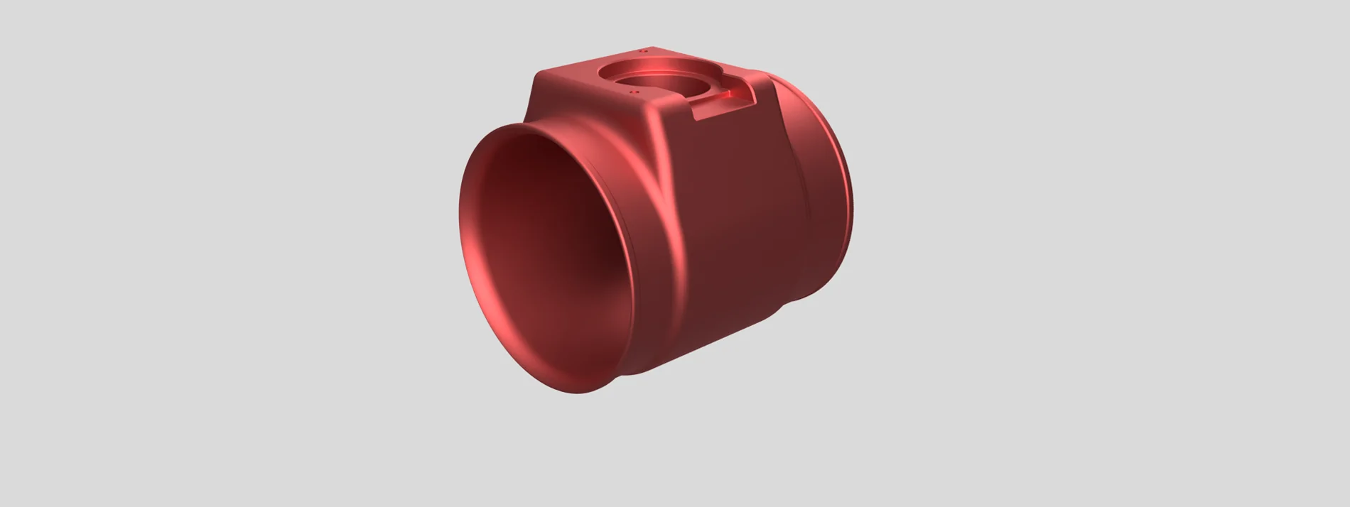

I’m excited to share the latest update. Thanks to the contributions of the community I am about to test out a 3D printed MAF housing that replicates the 77mm ID of the factory MAF with a bellmouth inlet and an 89mm OD for 3.5” silicon to pod intake plus internal air guides to help smooth out airflow to the MAF sensor. Stay tuned.
