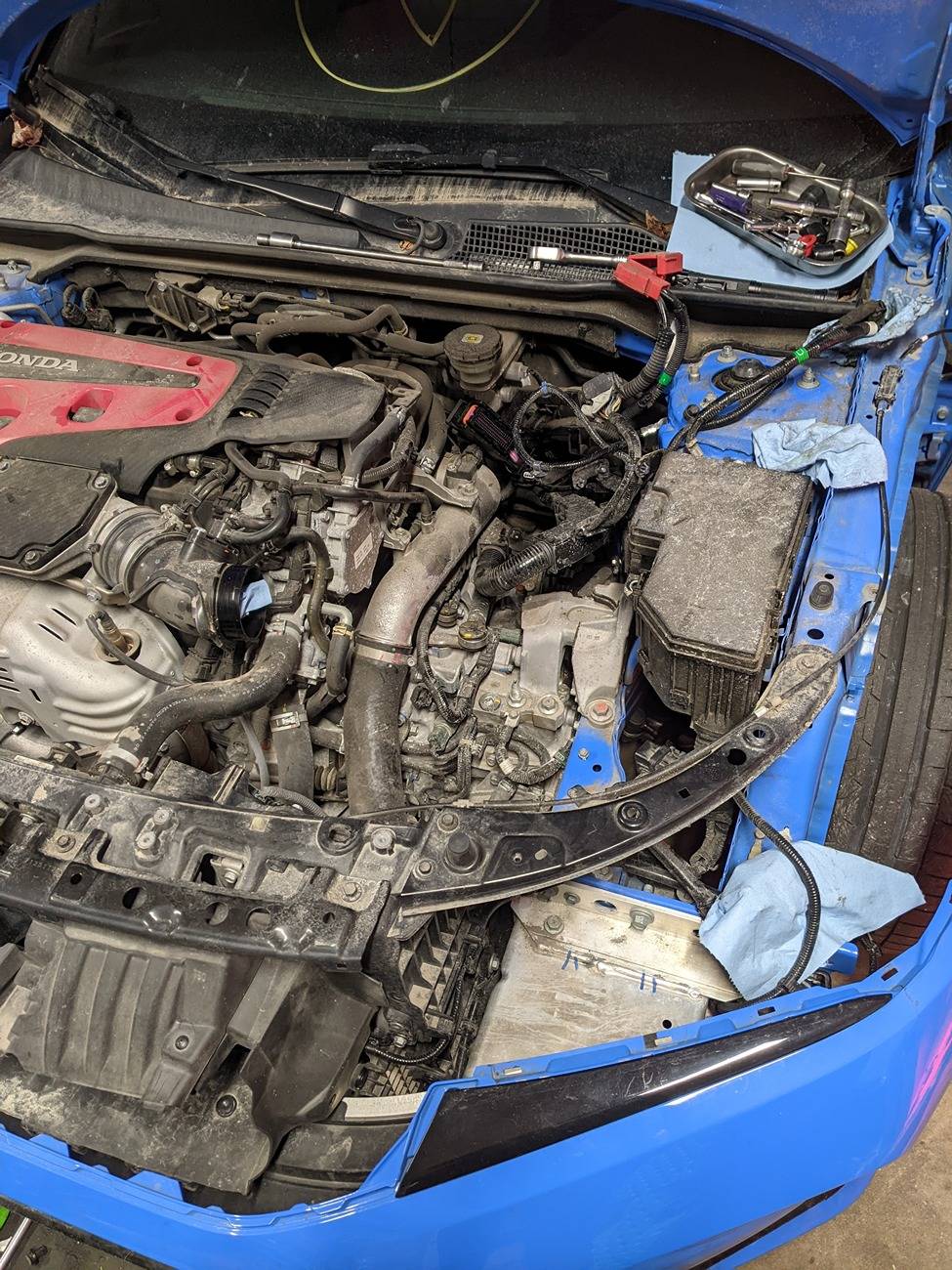

As far as firewall, massage it back into place the best I can, weld it up to make sure it is strong and safe, maybe pay a body shop if I am not happy with what I can do. Still trying to figure it out as I go really...

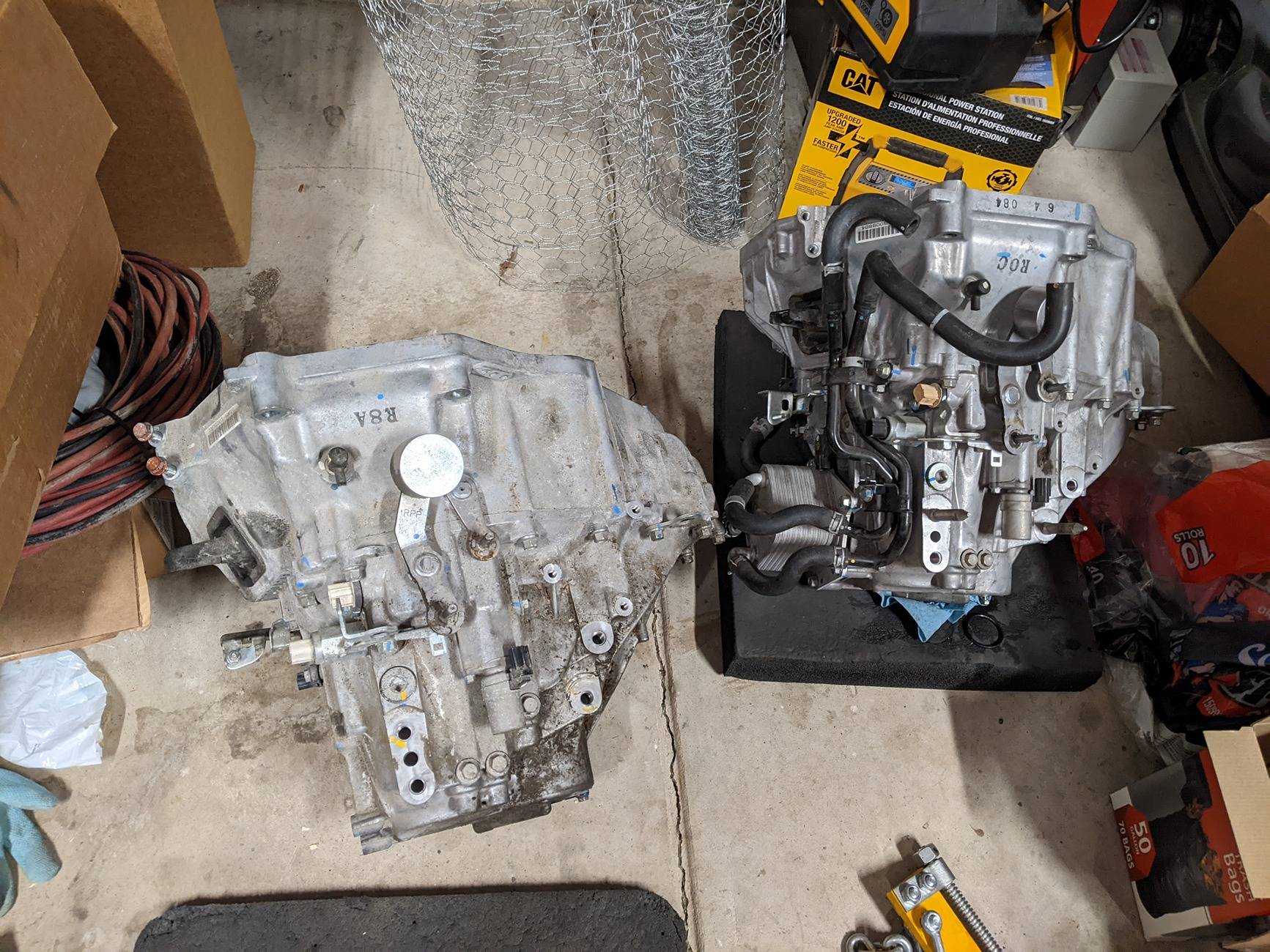

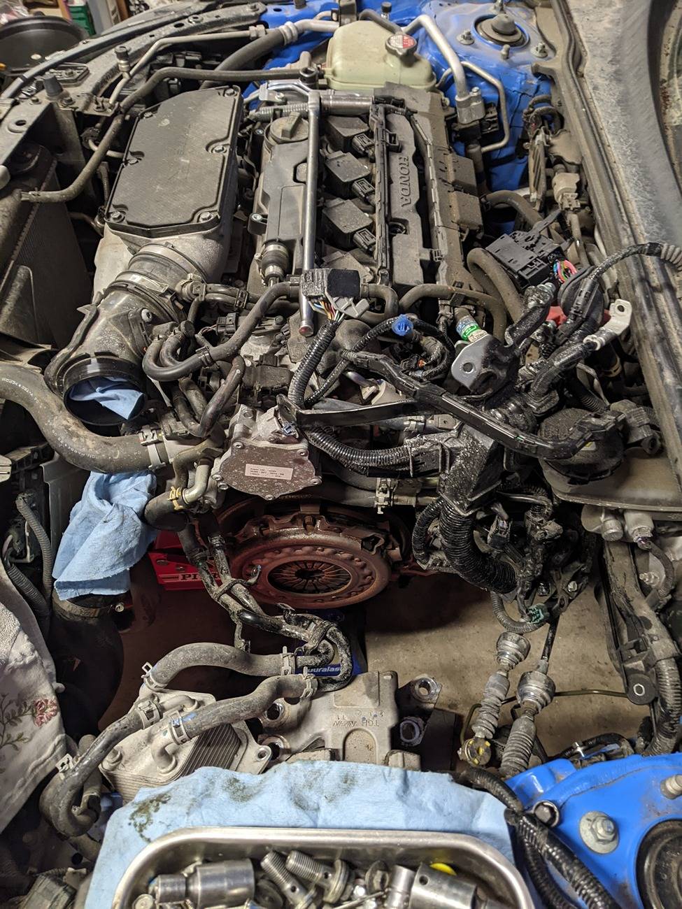

Well I got the car in the garage to pull the trans. Went to change the LCA and realized I would be dropping the subframe so Im swapping the outer tabs case off the FK8 trans I bought. Side by side everything looks identical so far. Fingers crossed. I may end up buying the spoon or PRL subframe collar kit...I will be working on and off to try and get everything back together in the next week or so. At least as far as trans and suspension.
Too bad the engine bay is so dirty, still a cool pic by my EF8. Which unfortunately will be sold due to my FL5 purchase...

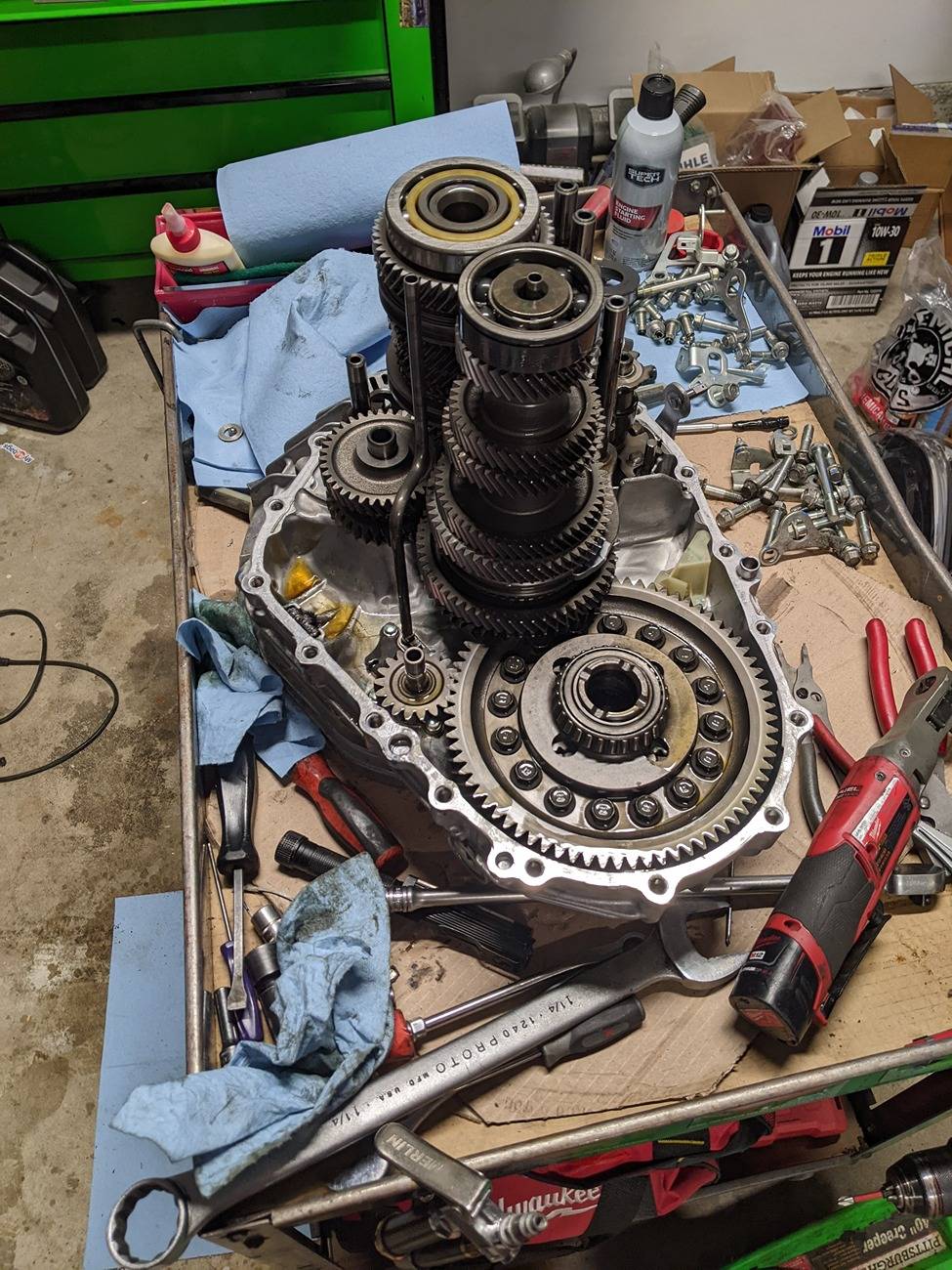

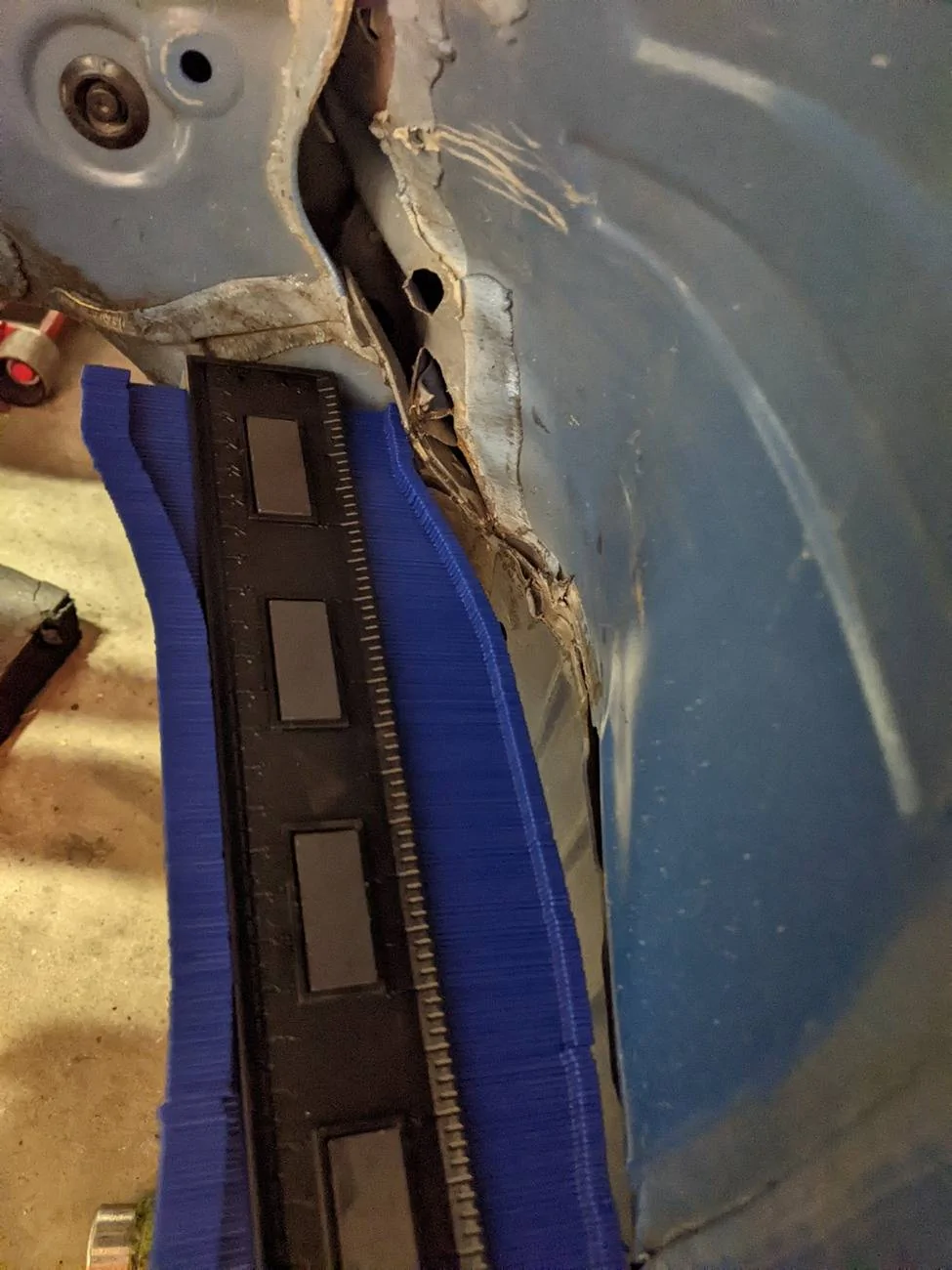

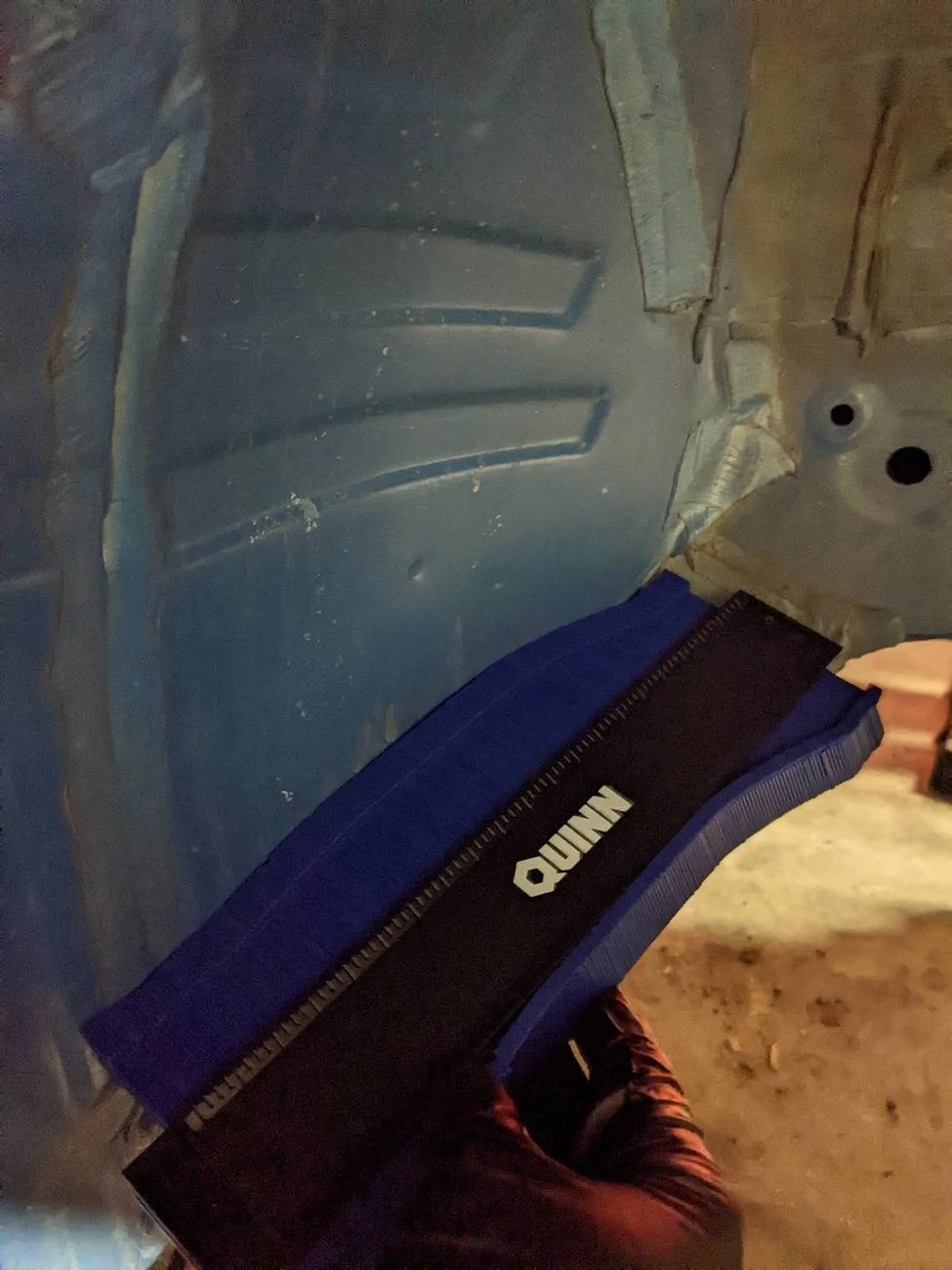

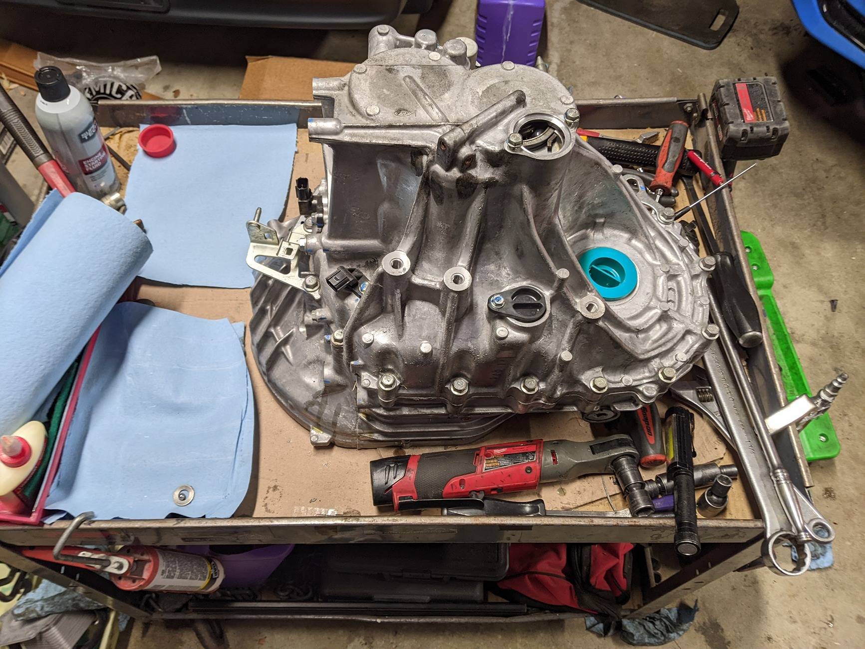

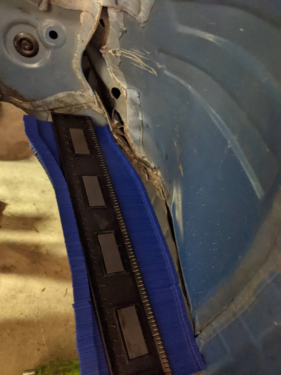

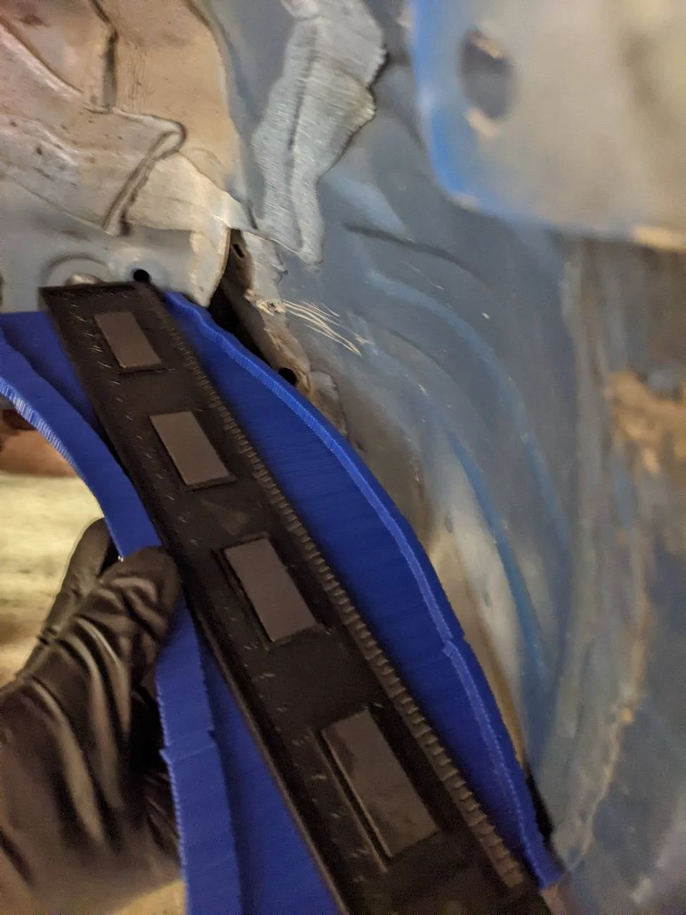

Project is in full swing now. Got both of the trans cases opened up this morning. Confirmed the fl5 and FK8 share the same case. I was pretty sure...but you know. All of the bearing shims were the exact same so that was also good. I am going to try and reassemble tonight so I can start putting the trans back in tomorrow. I got some wheels from another member here so that was good. Also measured the damaged firewall based on the passenger side. This thing is moving along ok. Always more work than you think...and everything takes longer than I expect. Having fun though, excited to daily this bad boy. Here are some progress pics!

I like your strategy on the wood trim shaping tool as a side by side comparison of how the inner fender is dented. Will you attempt to pull it out? May have to get a shop to do this on a frame rack.
