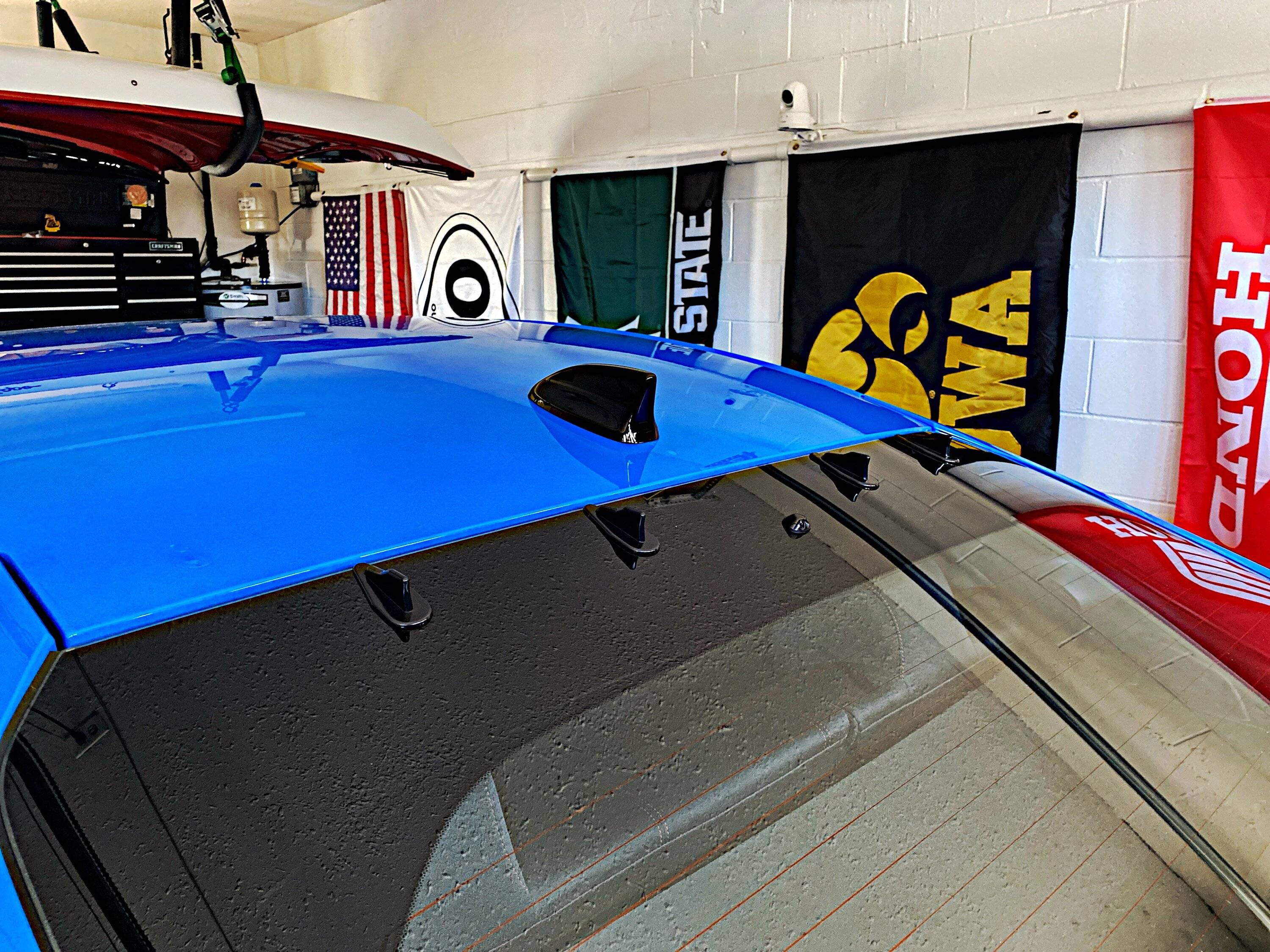

I’ve often wondered about vortex generators as seen on early Mitsubishi Lancer EVOs (circa Gen VIII MR or earlier), Subaru WRX STIs, and most recently on the underside of the Type R carbon wings. Virtually every vehicle uses them in some form or another on side mirrors, tail lights, and even small ridges on FL5 door handles. The idea of disrupting a vehicle’s aerodynamic surface layer is the same as those used on airplanes. When I saw a set of 10 very inexpensive, gloss black VGs with 3M adhesive, I decided to place some on the rear roofline of my FL5 just for grins. After several runs with between all 10 and just 4, I discovered that the best placement was 4 equally spaced VGs at the top edge of the hatch’s blacked-out glass. There, they seemed to reduce wind noise the most based upon highly subjective listening, but I still wasn’t convinced that they provided anything significant in terms of altering the boundary layer, until I drive through a brief rain storm. Compared to driving in the rain without the VGs, the rear glass cleared itself of rain much faster (didn’t even need the wiper) and was significantly cleaner afterwards. I know that’s not a scientific test, but it does seem to suggest an effect on the aerodynamics. Whether or not it’s significant (e.g., lift/drag ratio) is undetermined, but because they’re so easy to remove (with dental floss), I may leave them on although they do look a bit out of place.

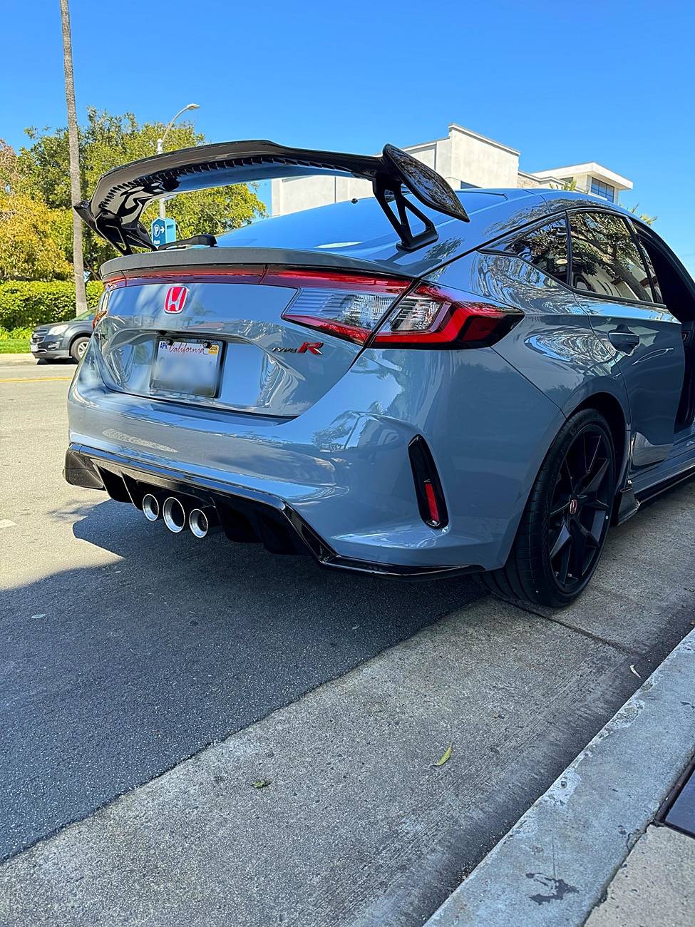

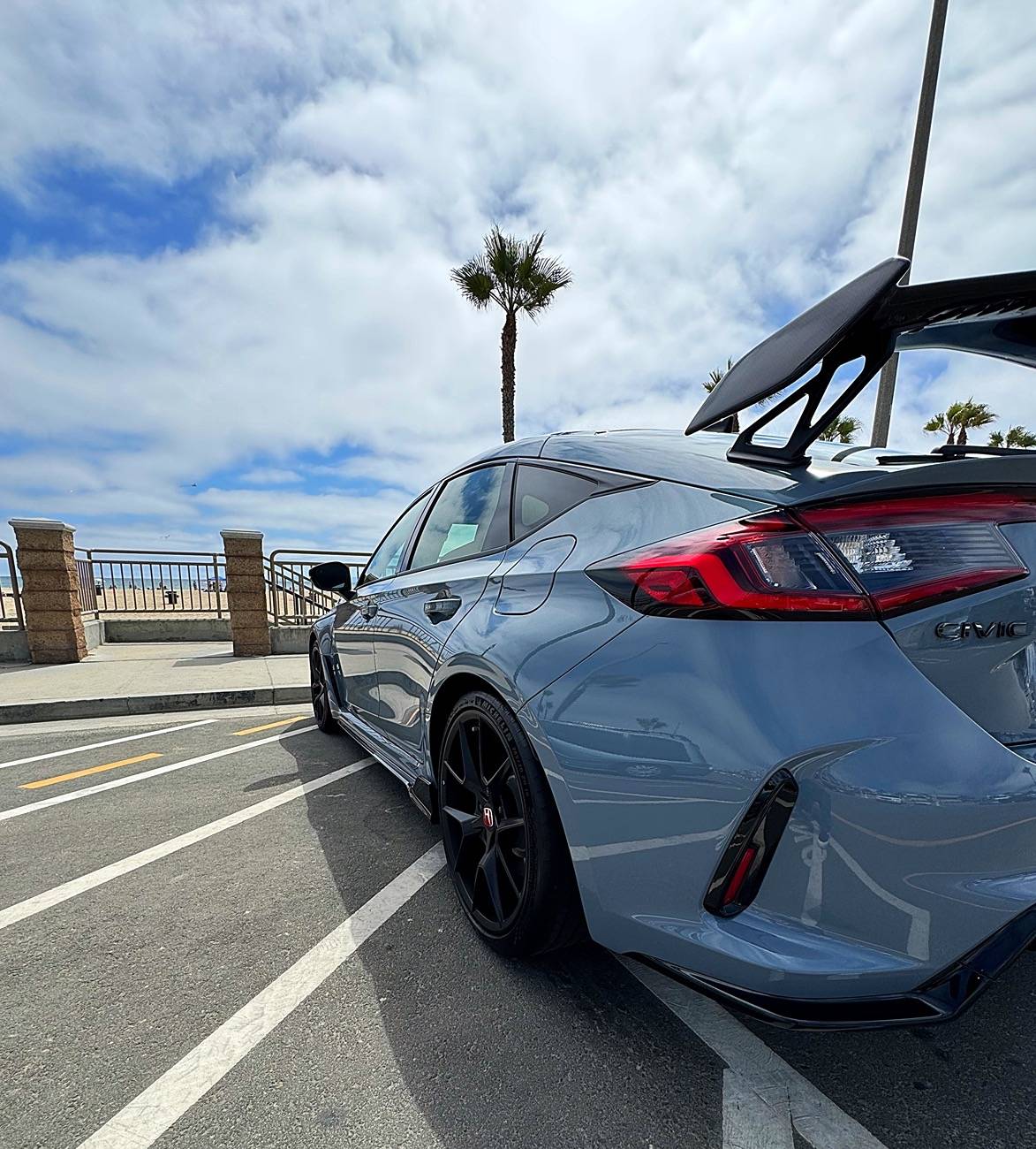

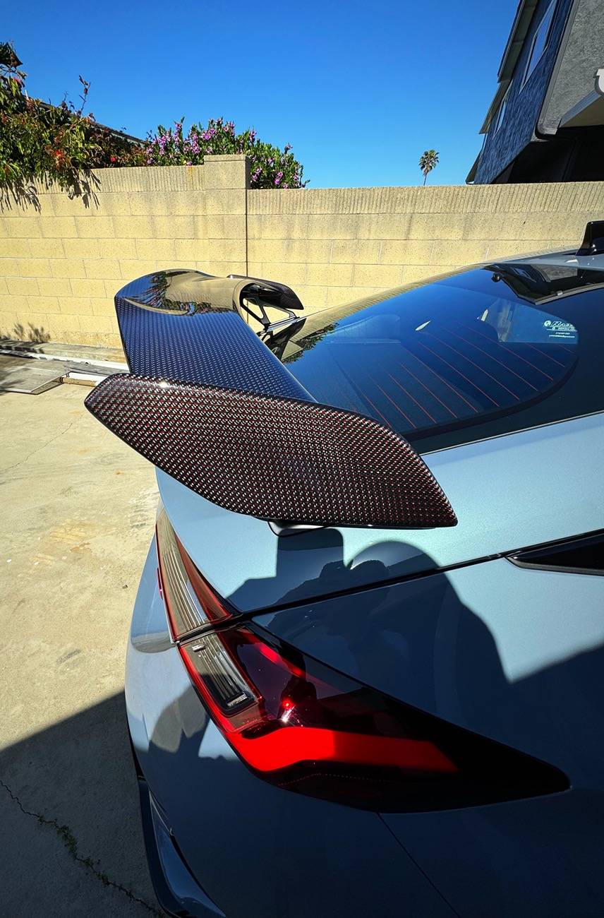

Bump ! Love my Oem CF wing it’s the frosting on the cake looks so nice and get many compliments. Found this thread for torques specs since when I got mine I just did it by feel . So figured I’d better check even though I used a little blue loctite just to be safe . Anyway just checked with a recently acquired torque wrench they still were tight and probably about 4 ft pounds until I went to the recommended 6.5.
Sexy wing and I like waxing it almost as much as I do looking at it ?
