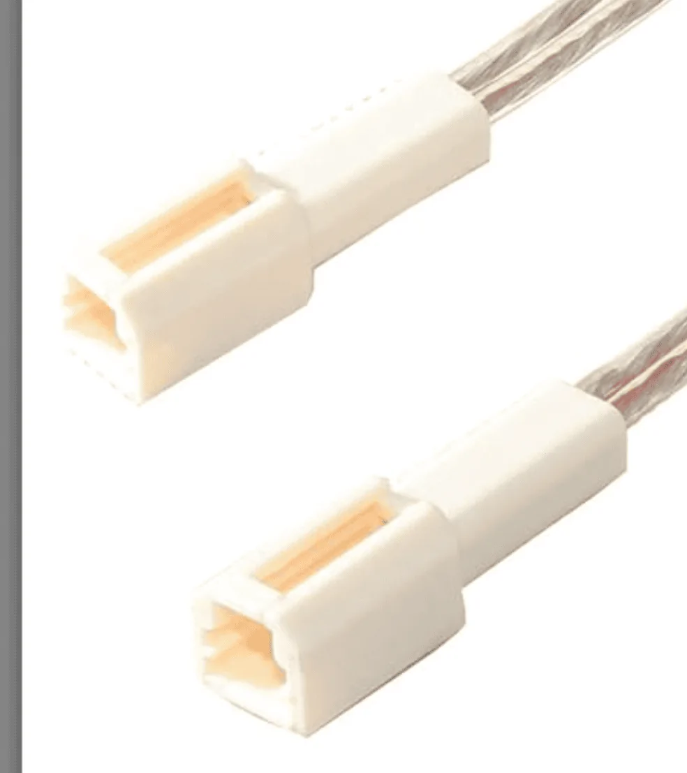

The tweeter/center harness adapters I bought are incorrect, off to Amazon again to try and find the right ones along with an adapter ring for the 5.25"s. Will post once I, eventually, get the right stuff. The 5.25"s use the same harness as previously used for the front 6.5"s.

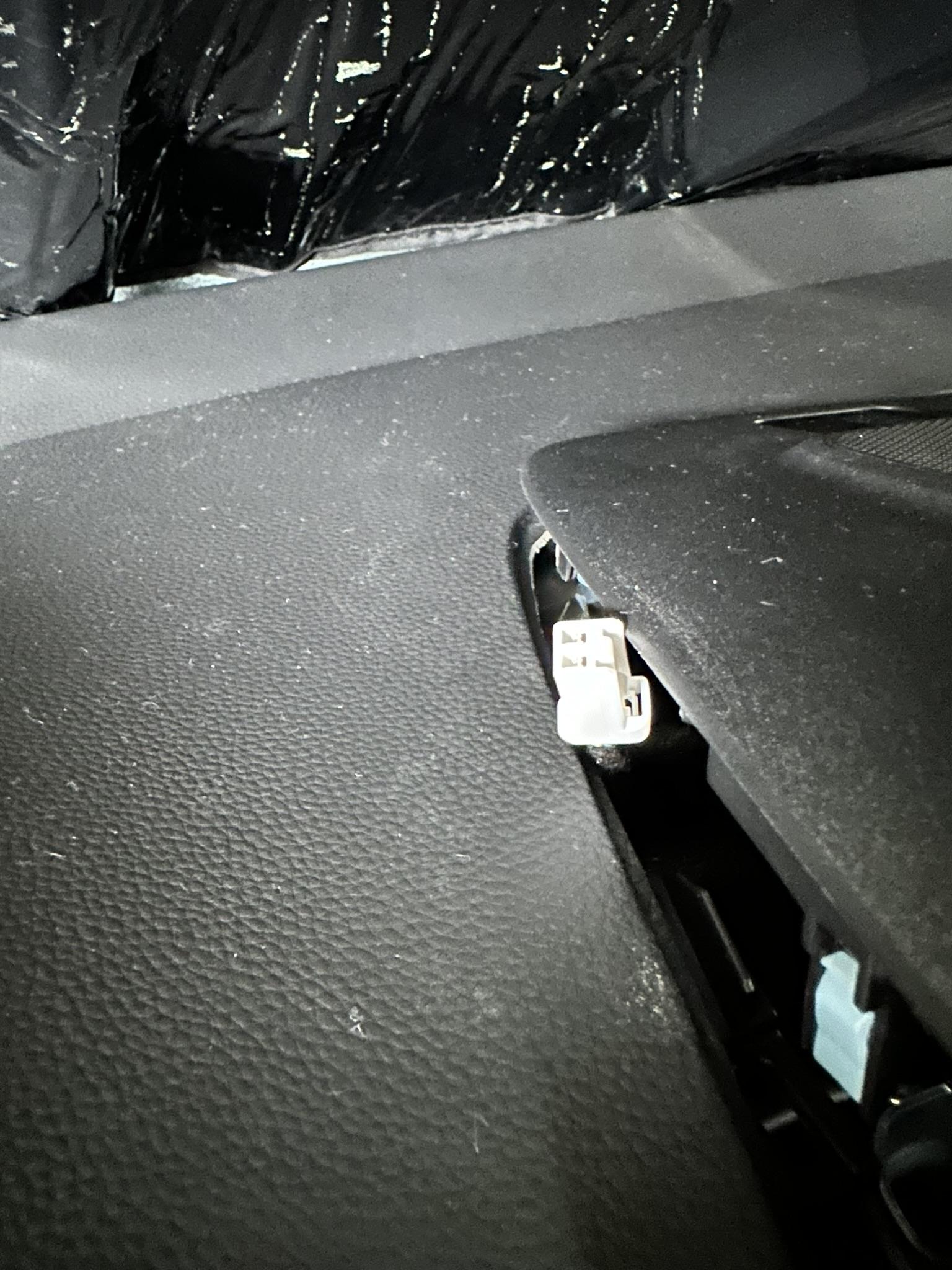

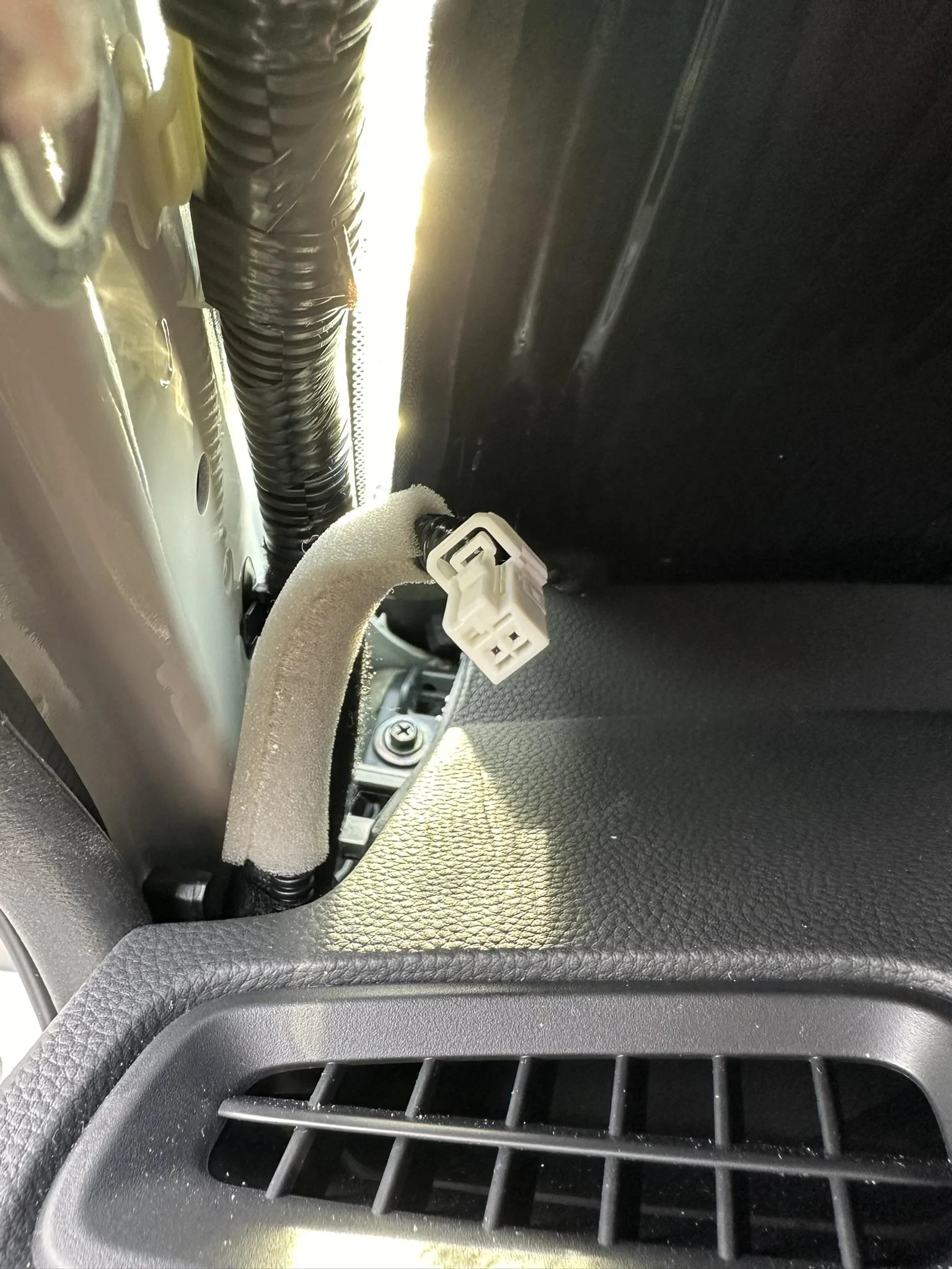

Anyone know what the heck the tweeters and center use? They're different too.
11th Gen Honda Civic Icehawk's "OEM+" speaker upgrade Center connector
11th Gen Honda Civic Icehawk's "OEM+" speaker upgrade Tweeter connector

:hmm: The adaptors are incorrect?
Maybe the sent the wrong ones.?
Did you take a picture of them… would be interesting to see which ones they send.
Icehawk
Icehawk
Mar 19, 2022
691
852
Miami
2023 CTR #3177 (stolen)
Doesn't fit anything in our car.
11th Gen Honda Civic Icehawk's "OEM+" speaker upgrade 1697991912221
Truth be told I'm not going to worry about it - let my installer deal with this. If I sell the car at some point I'm not going to bother swapping back to the OEM drivers so retaining the harnesses isn't something I should worry about.

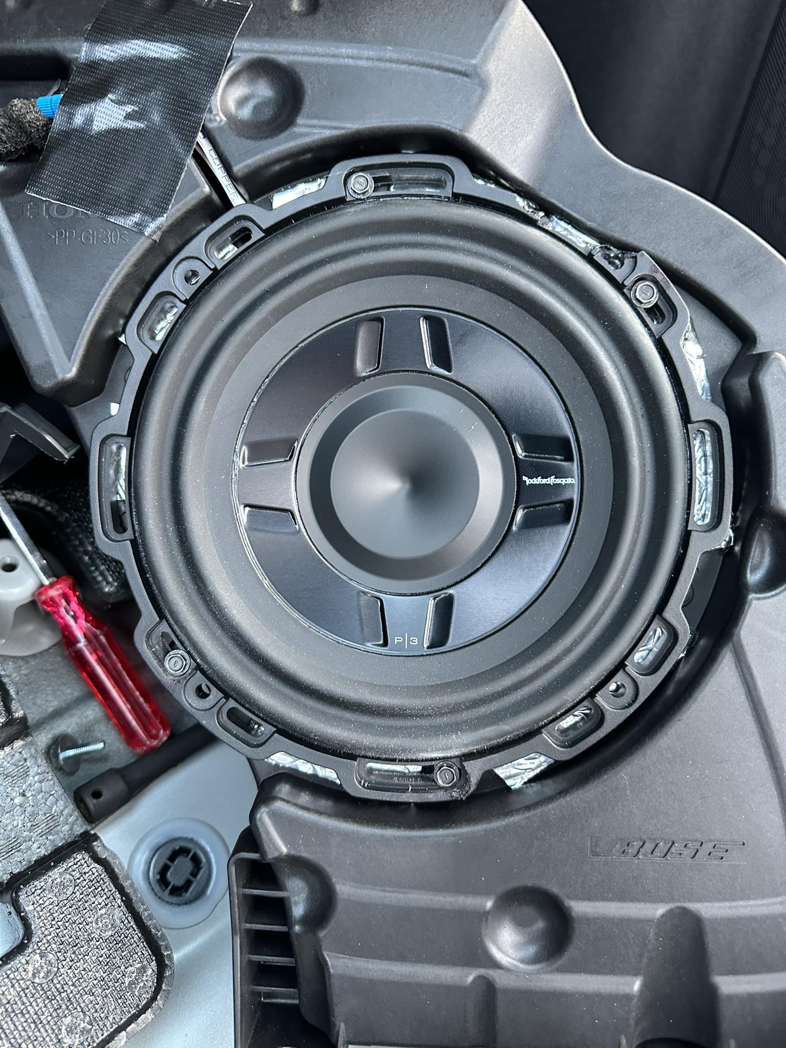

Installed the sub today, a Rockford Fosgate PS3D4-8 which was recommended in a bunch of FK8 threads I researched, I figured it was more than I wanted to spend ($180 delivered) but it would save me having to buy several and fiddle. It did require cutting off one of the mounting ears and hogging them out a bit so I could fit 4 mounting bolts, the "box" had two small mounting locators (plastic pegs) that I snapped off too. I need a new dremel!
I used posi-connectors to pigtail from the OEM plug to the driver, you can see the blue peeking out from under the gorilla tape. Driver is wired to 2ohm, I measured the OEM driver at about 1.4ohm.
11th Gen Honda Civic Icehawk's "OEM+" speaker upgrade IMG_4135
It is better... but like the FK8 pioneers before me I'd probably recommend not bothering, or if so getting the cheapest driver that fits or just flat-out going amp & custom. I know my guy could do a custom enclosure in that space. One thing to keep in mind is this is an 8" driver with not a lot of power so it just doesn't go low, its sweet spot is 120hz+. Still, I can hear a difference and wow my car is unbalanced as hell right now! Can't wait to finish this up in a month or two once my guy is available.

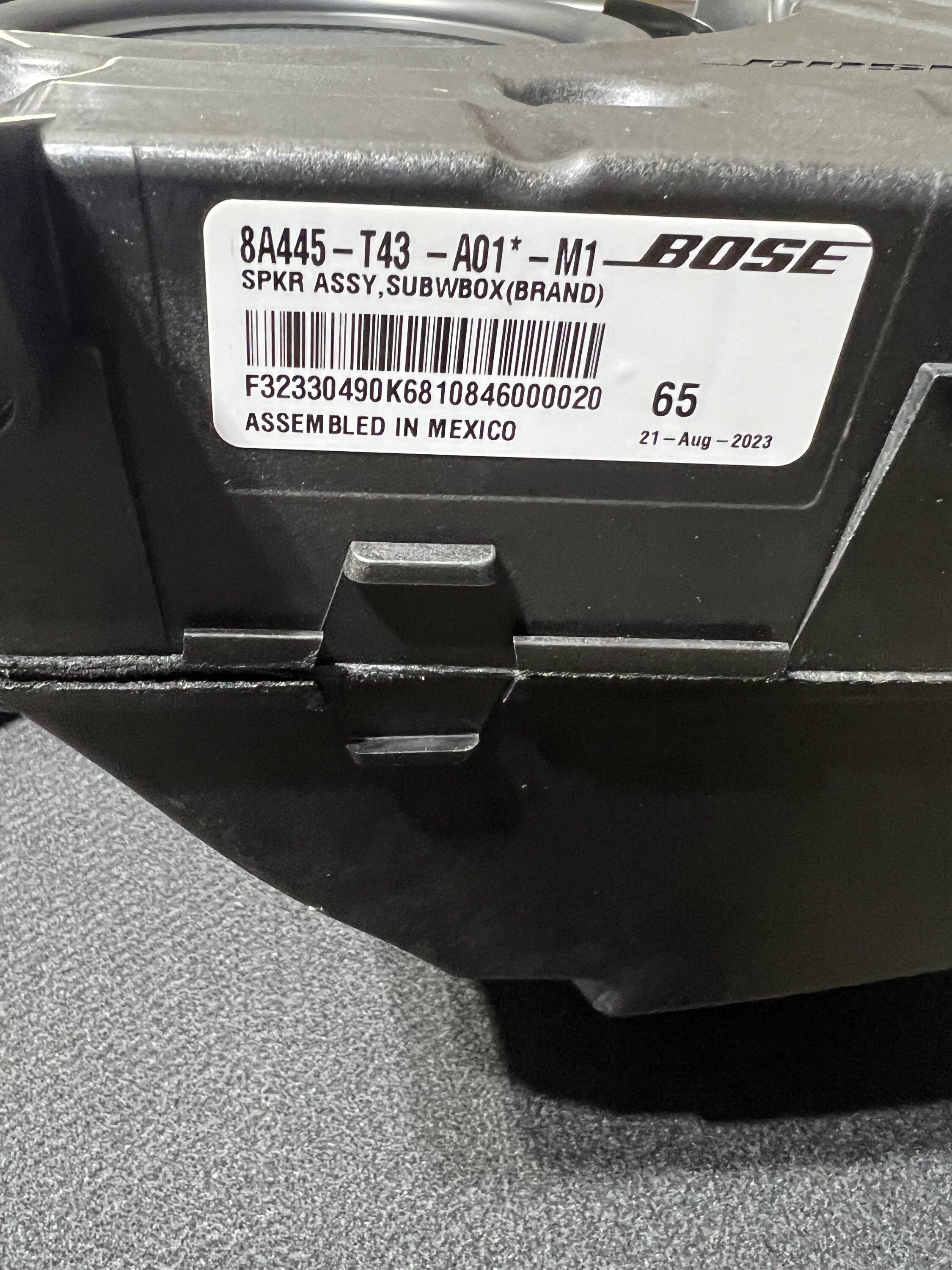

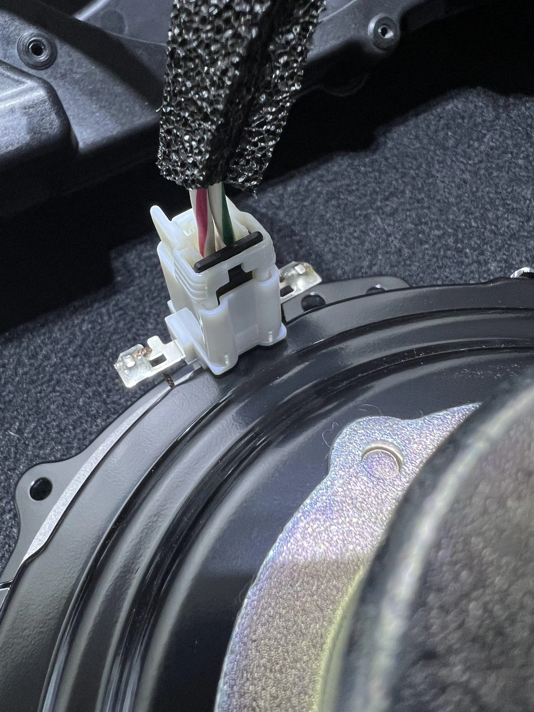

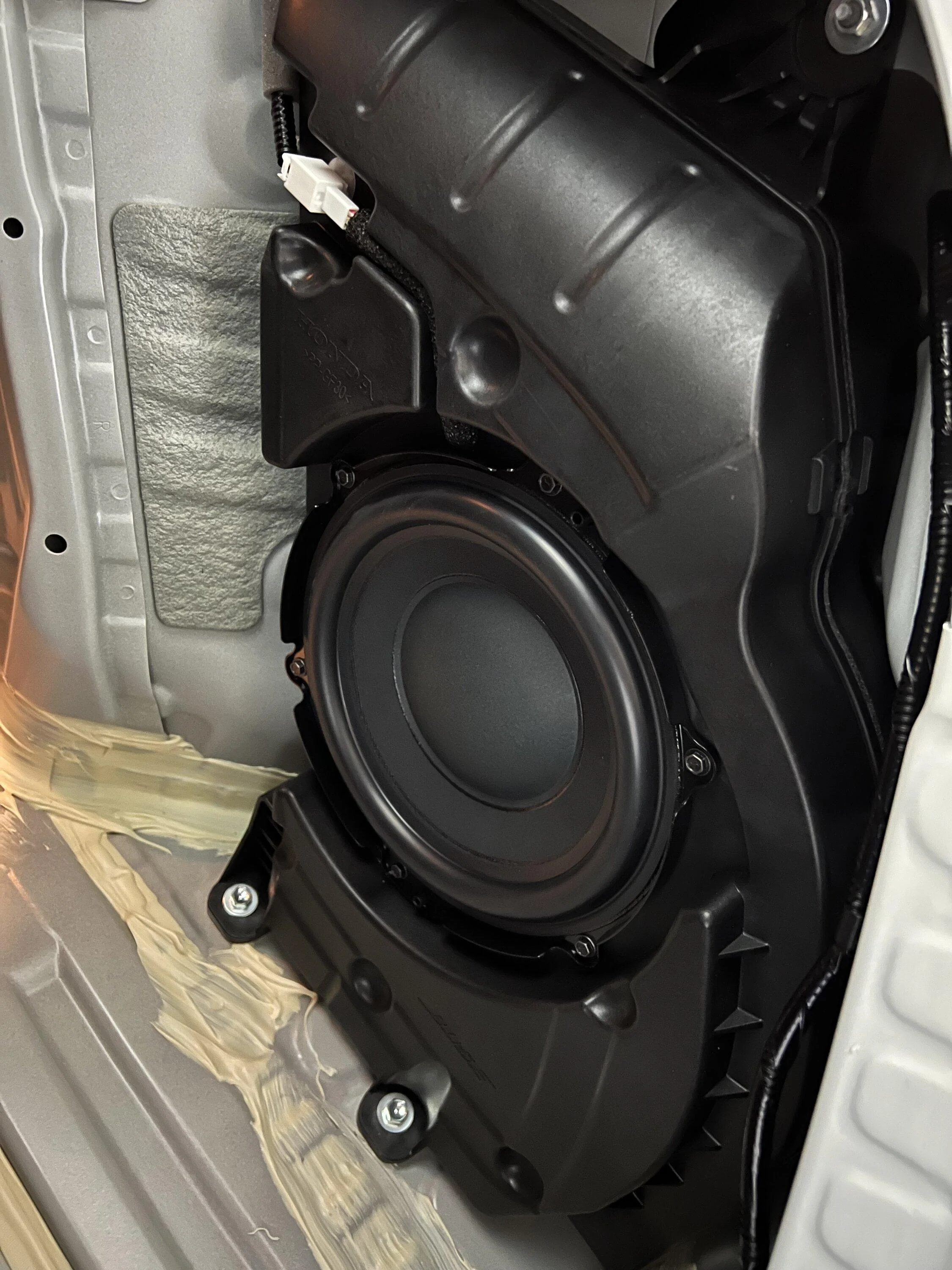

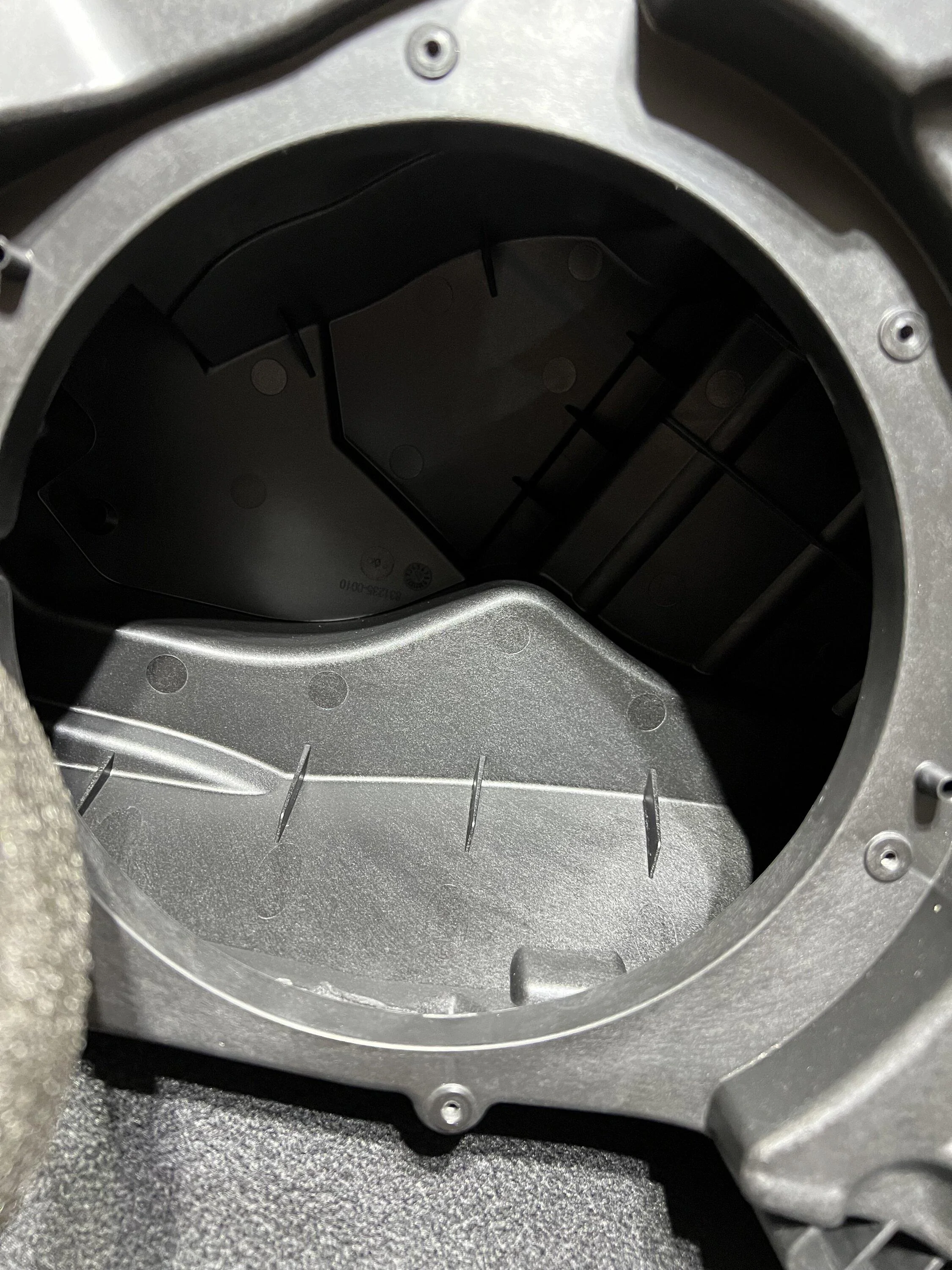

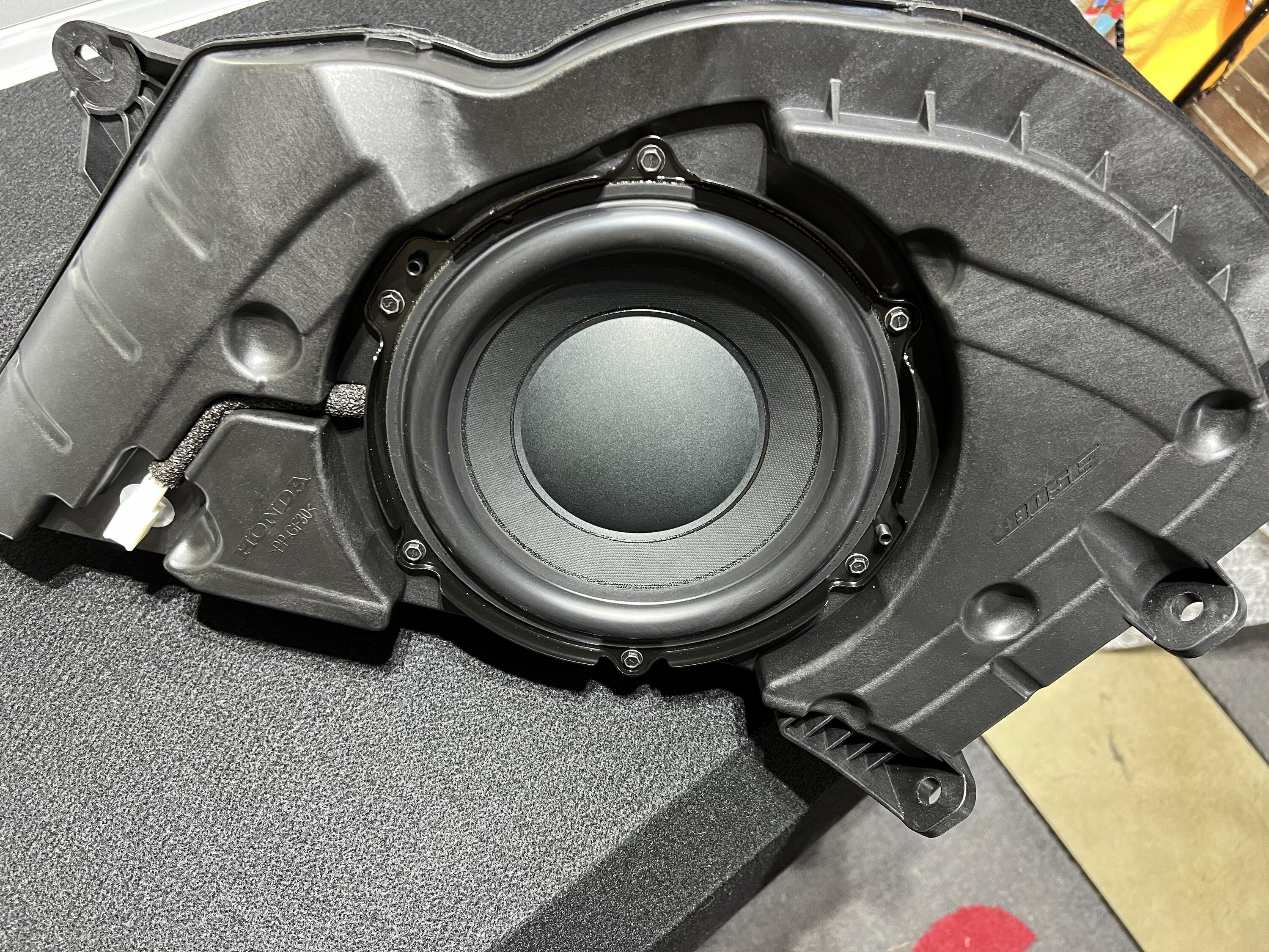

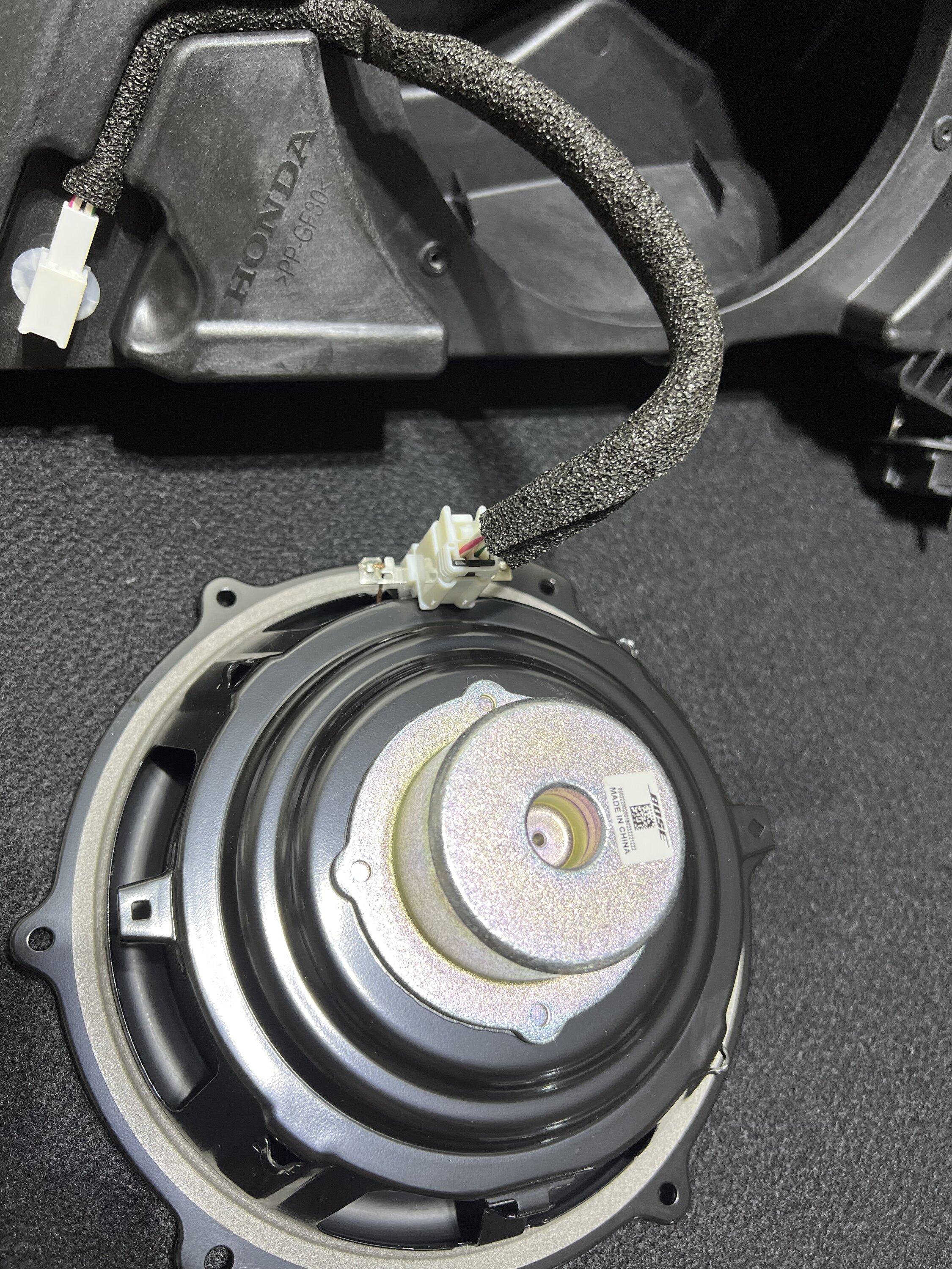

all of the information you’ve posted has been absolutely wonderful. I cannot thank you enough but I still had some questions about what’s going on with this car and the factory subwoofer. I took delivery of my car a few days ago and this is what I found so far. I’m sure someone was smarter than me can figure out what’s going on here with the wiring and the coloring.
11th Gen Honda Civic Icehawk's "OEM+" speaker upgrade IMG_7187
11th Gen Honda Civic Icehawk's "OEM+" speaker upgrade IMG_7191
11th Gen Honda Civic Icehawk's "OEM+" speaker upgrade IMG_7192
11th Gen Honda Civic Icehawk's "OEM+" speaker upgrade IMG_7193
11th Gen Honda Civic Icehawk's "OEM+" speaker upgrade IMG_7194
11th Gen Honda Civic Icehawk's "OEM+" speaker upgrade IMG_7195
when I tell you the factory sub is cheap wow. It’s like nothing. The box has a surprising amount of room as seen in the photos.

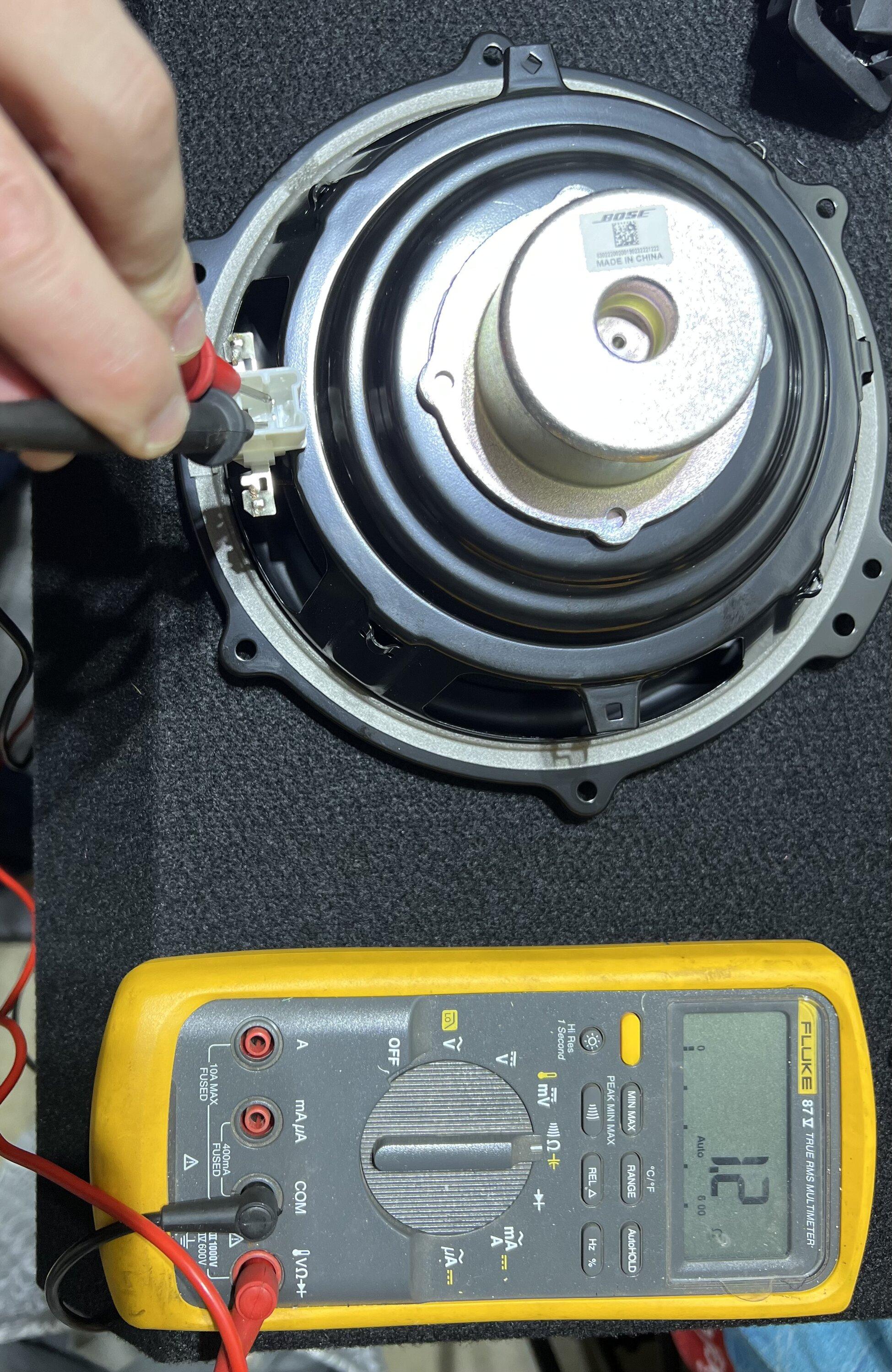

One more thing. The know the man here also measured his OEM sub at sub 2ohm. This is what mine shows. She with this information could you buy a 2ohm DVC and run it in parallel?
11th Gen Honda Civic Icehawk's "OEM+" speaker upgrade IMG_7197
