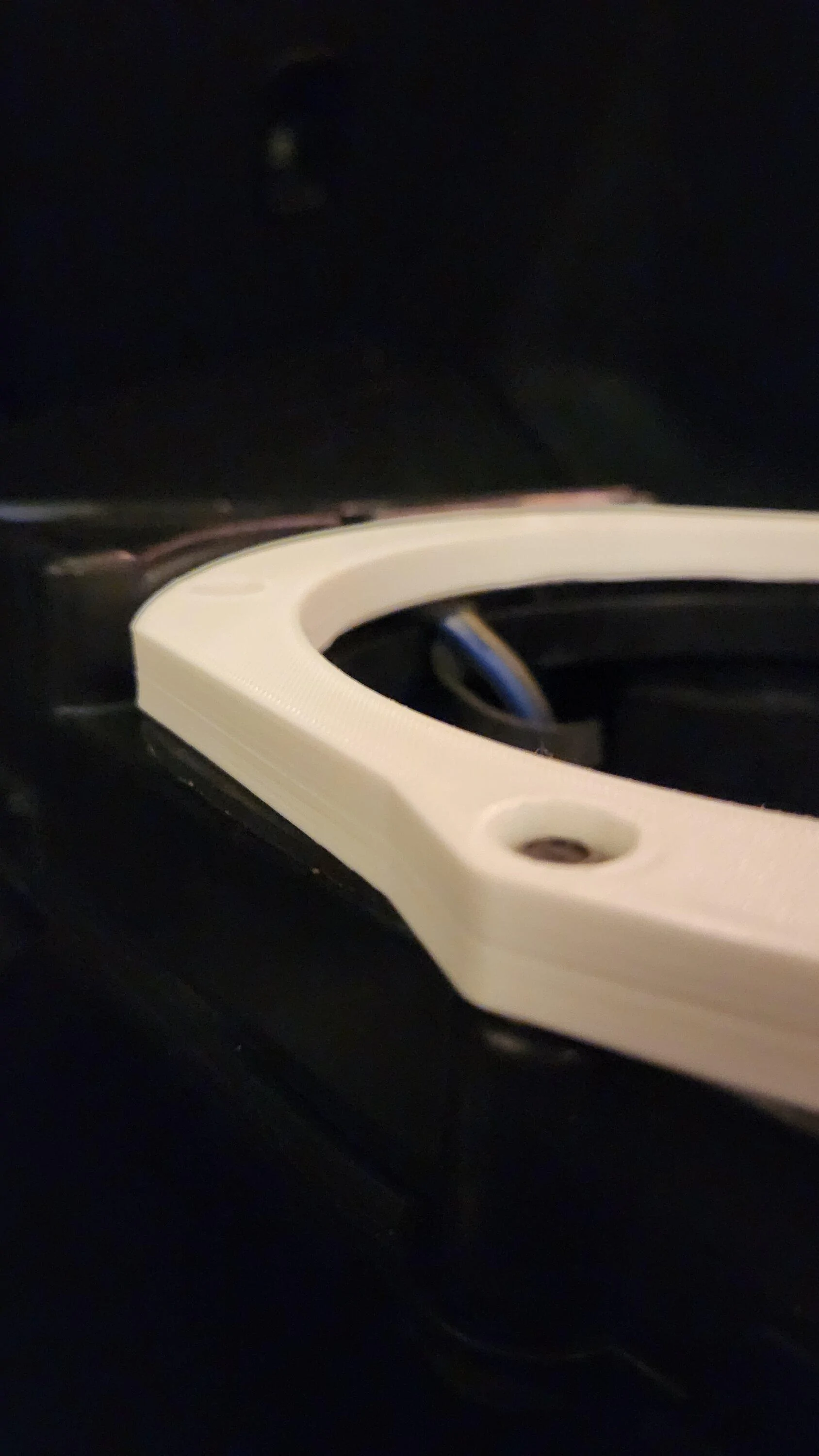

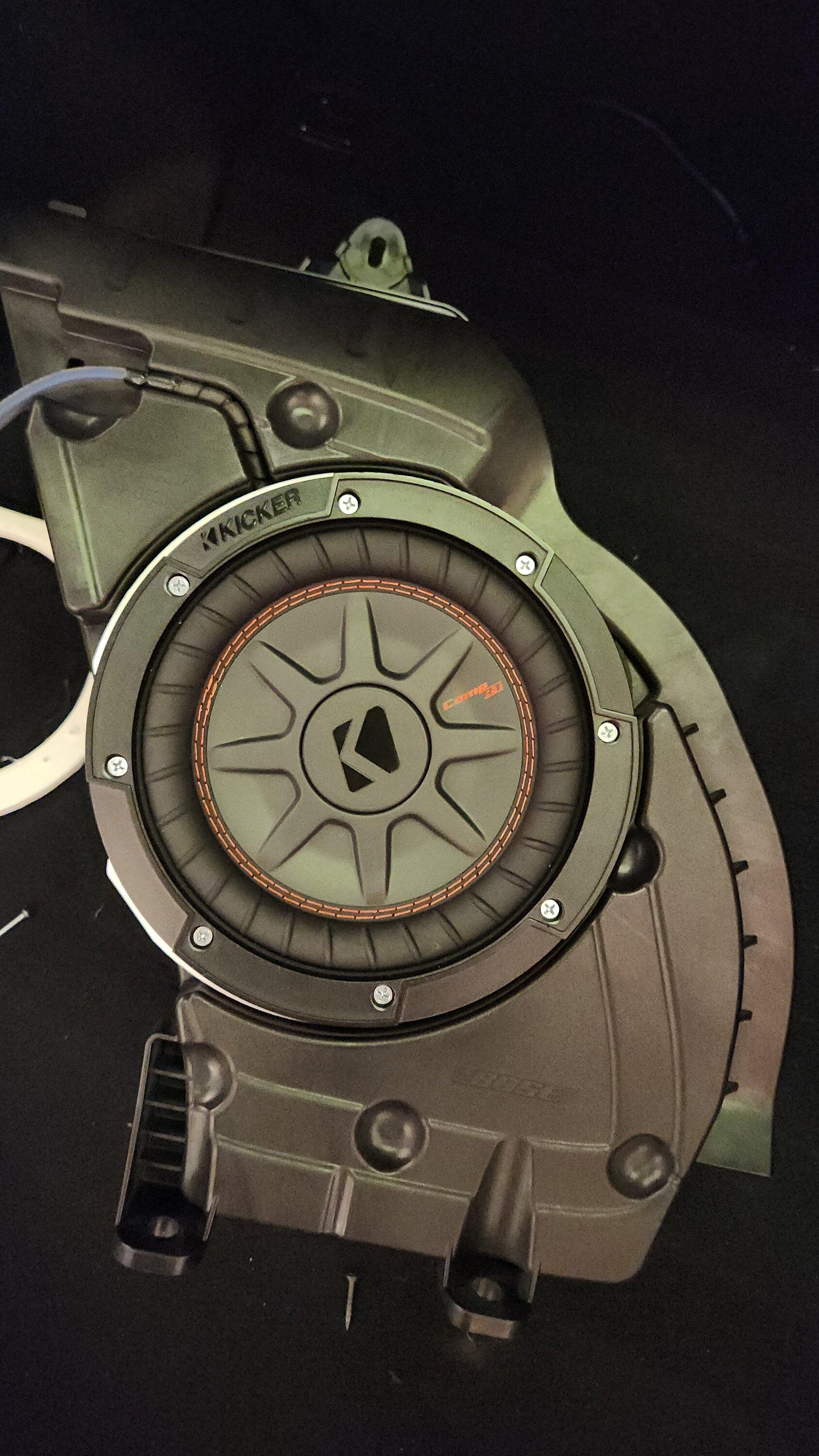

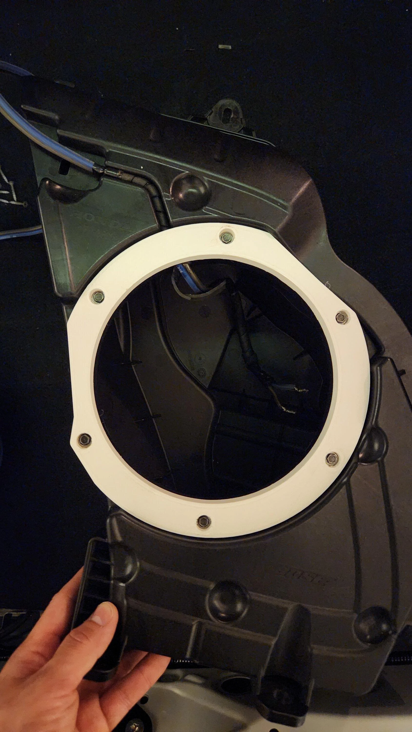

Revised spacer with recessed OEM mounting holes to allow OEM screws to thread perfectly and creates a flat surface to mount new sub for a perfect seal.
Fantastic design!! would love to get one of these!! :thumbsup:
