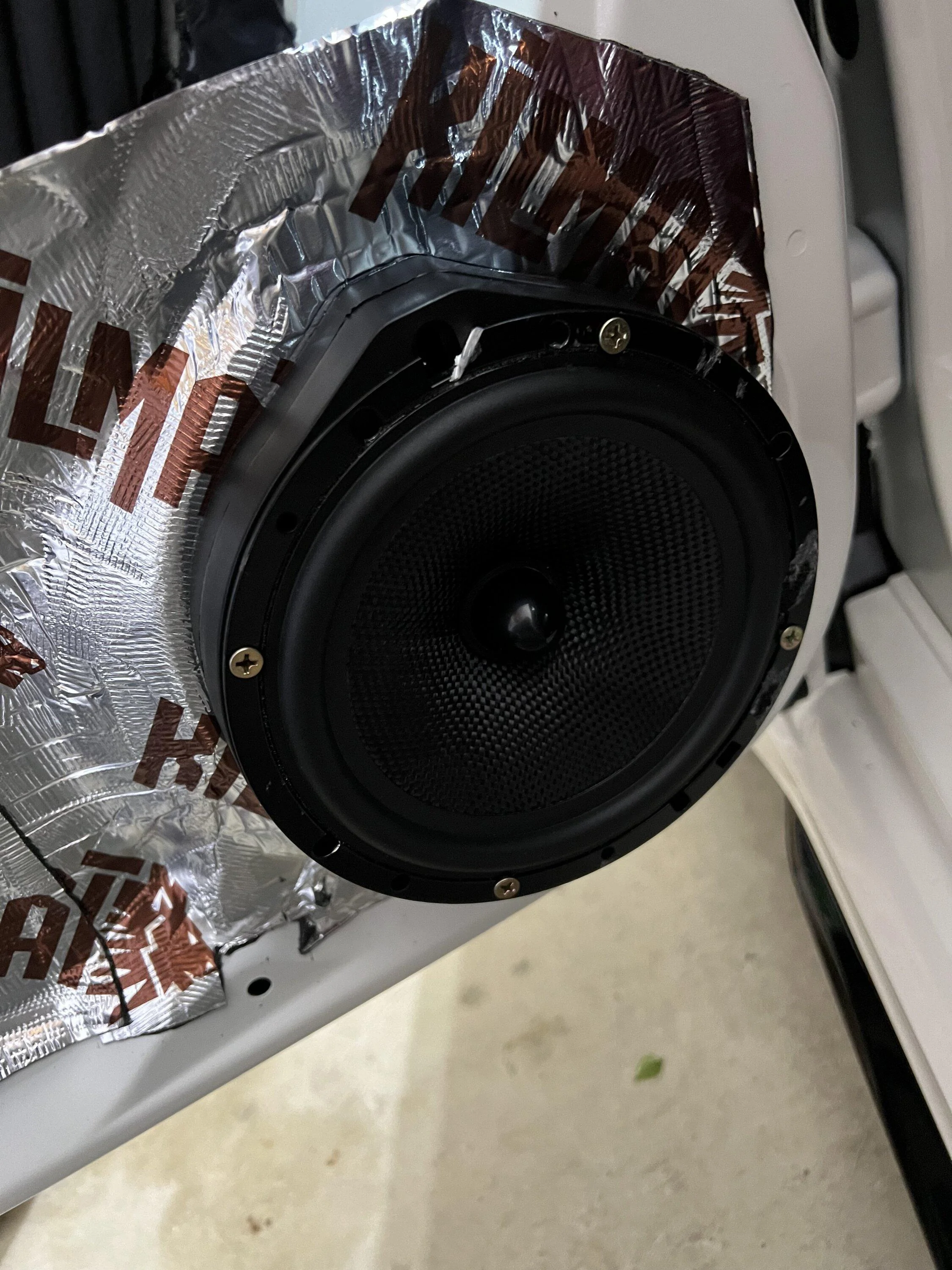

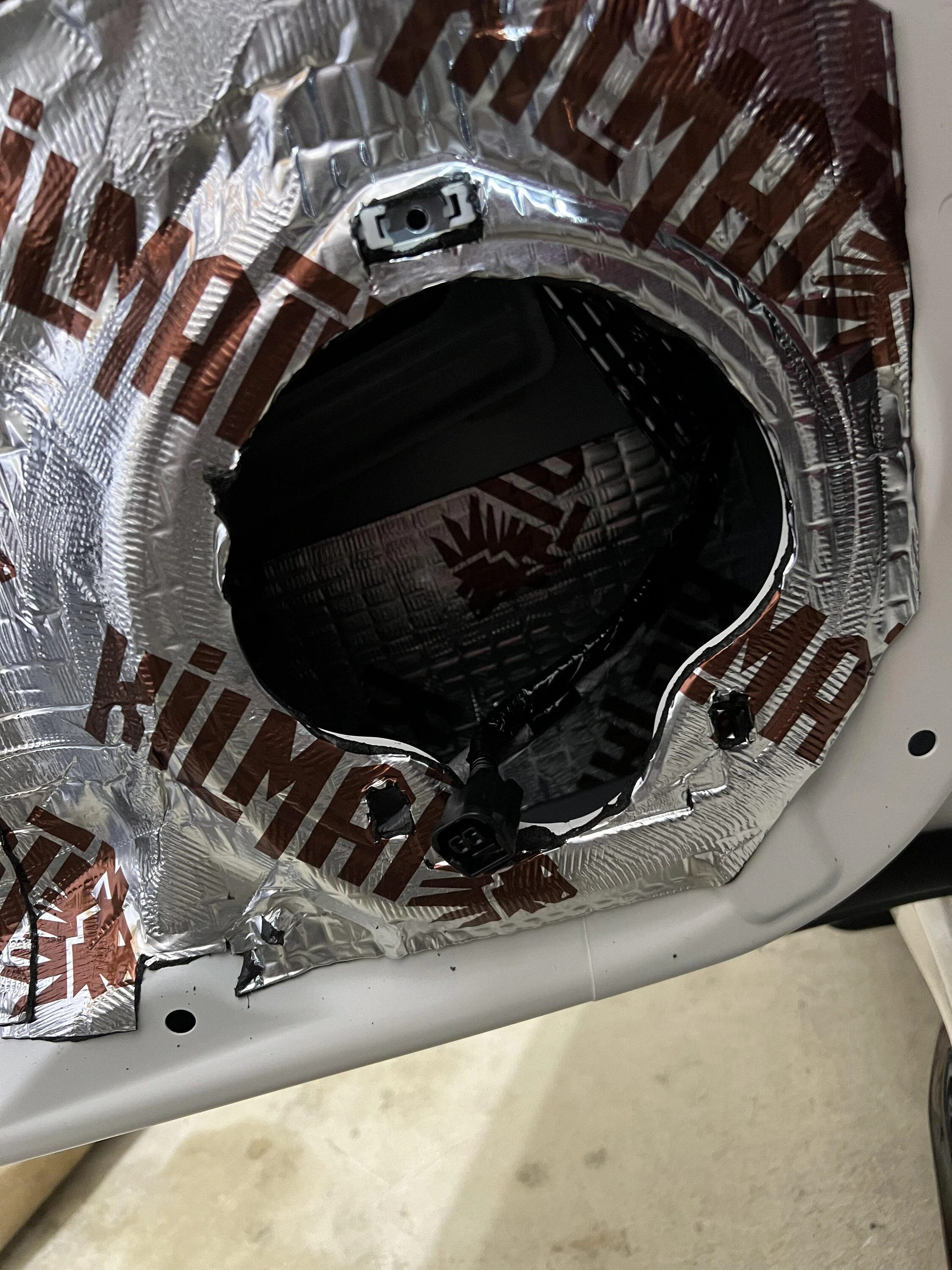

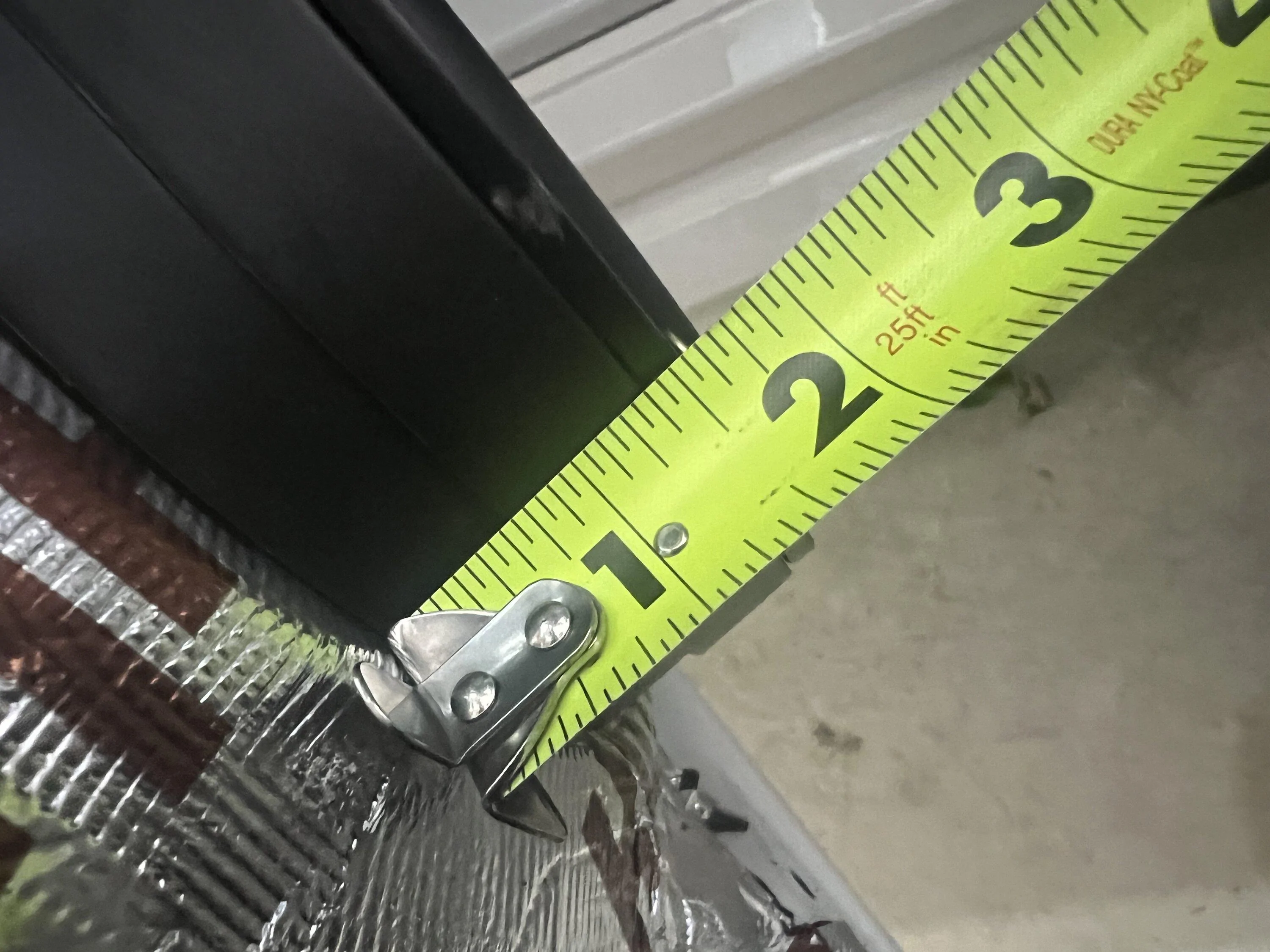

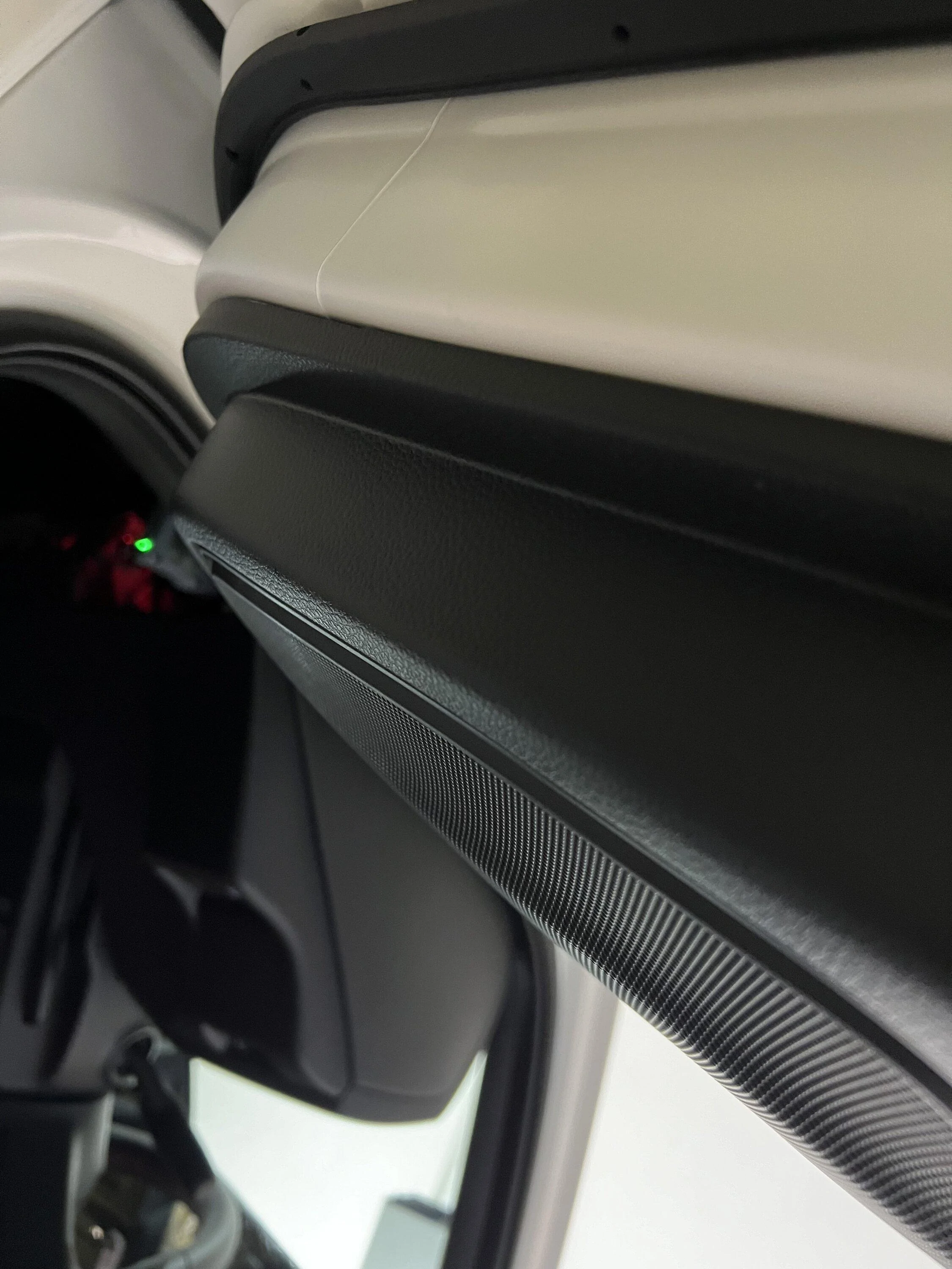

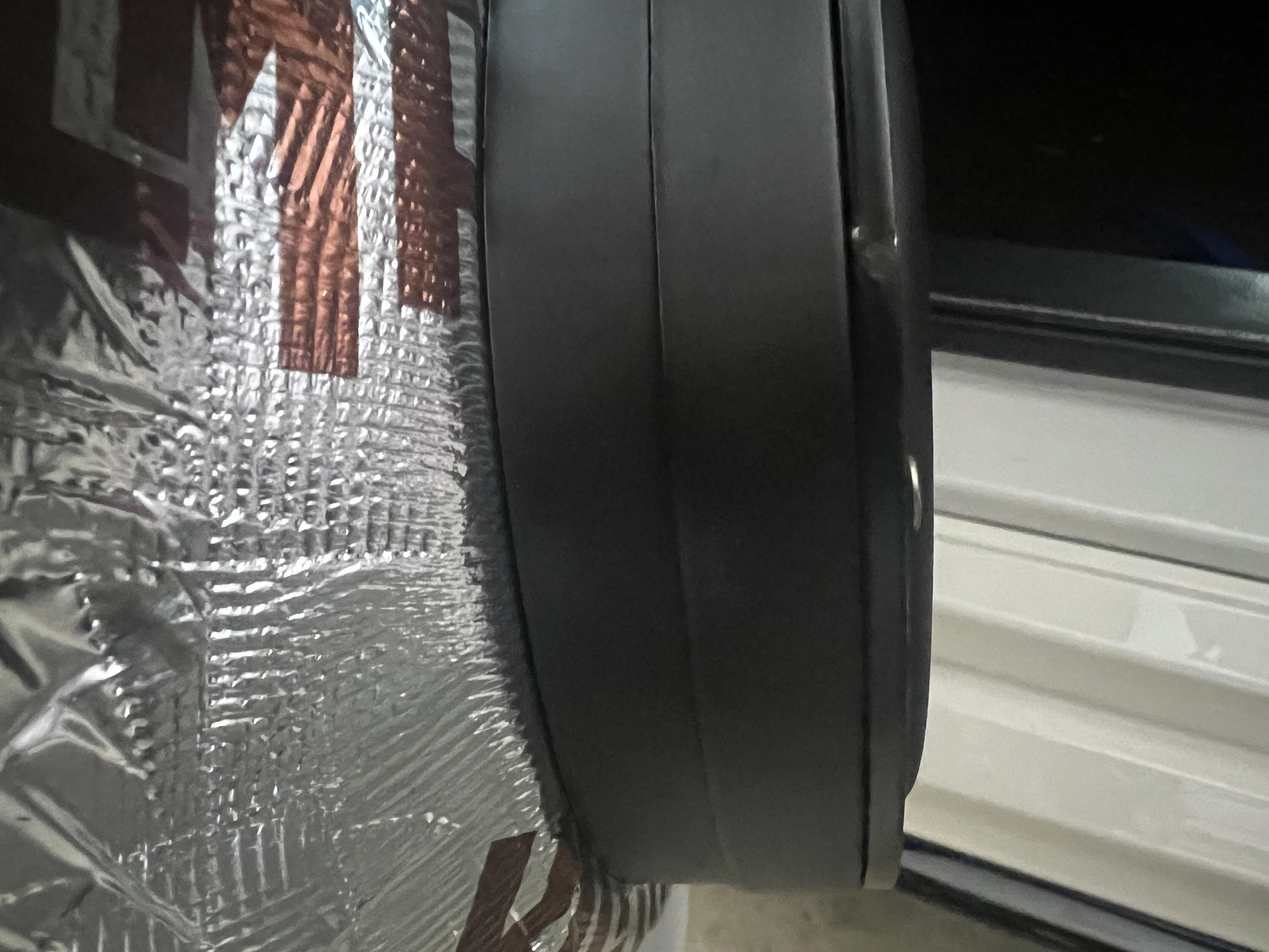

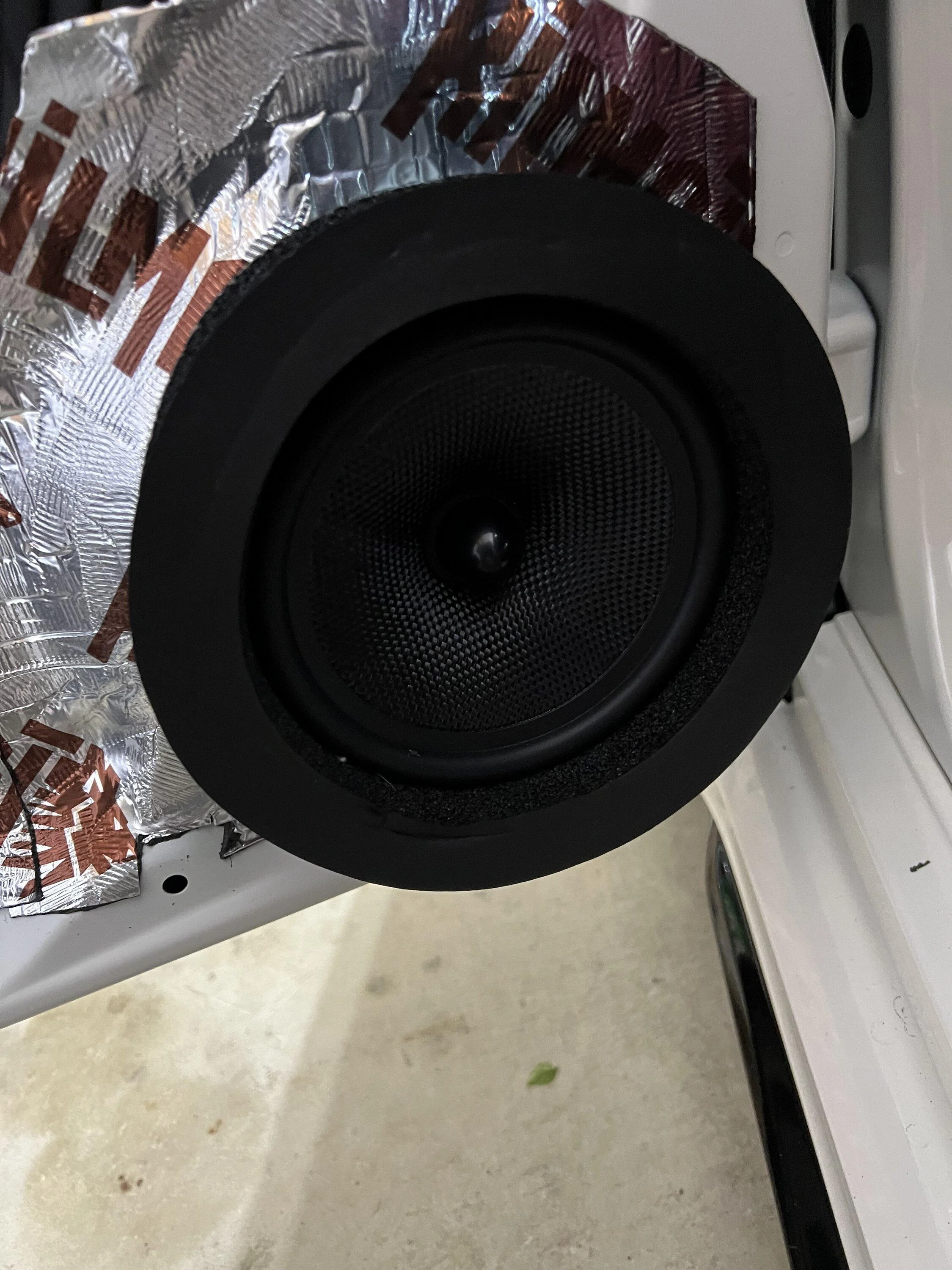

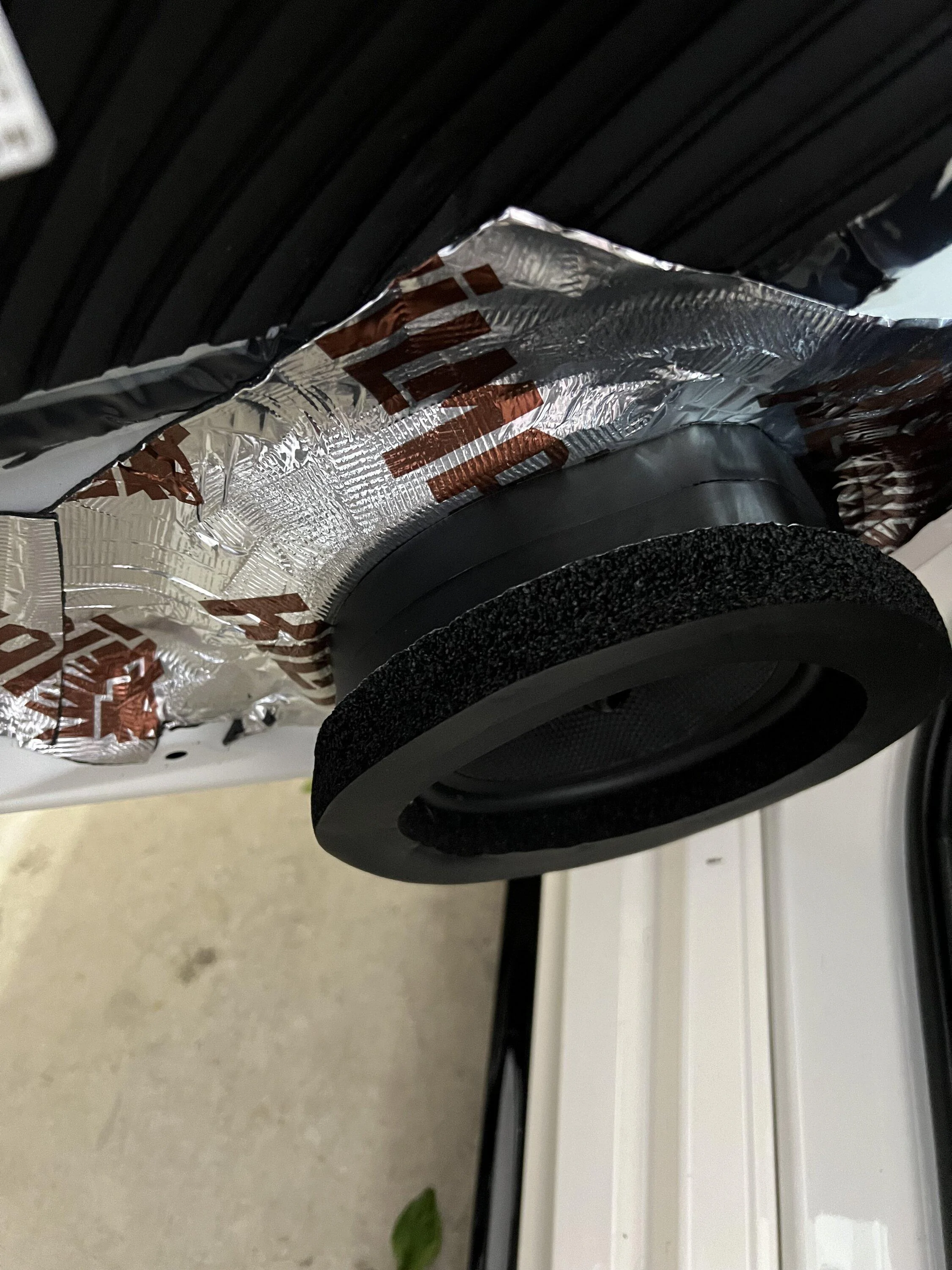

OK its time to discuss front door fitment. THe door speakers as you know have a shape that is not round at the bottom. This creates an issue with installing new speakers that have larger magnets doe the the frame of the speaker and how it is designed and the size of the magnet can allow for the speaker not to fit into the hole of the door. this is addressed by the speaker rings that you have around your speaker. Now for the part that has been the bane of my week, in order for me to install the speakers i had to have over 1 inch adaptors. the 1 inch ones would contact the the speaker woofer housing, so I picked up 1/2 inch ones to add the 1 inch ones. this worked except even with removing all of the ring to the interior of the door card the door card was contacting the speaker not allowing the card to snap back into place. after buying more ring i removed the backs of 1 set where it clips into the door frame and had them doubled up in thickness. This was the only way to get the depth i needed. Below is the final measurements of what does fit when you are willing to remove the plastic ring from inside the door card. The sound is so much better than the OEM speakers. I will link the speaker clips and the rings I used. the rings do come with pigtails. They are useless.

The ES6.2 fit perfectly with the trim ring I linked previously.

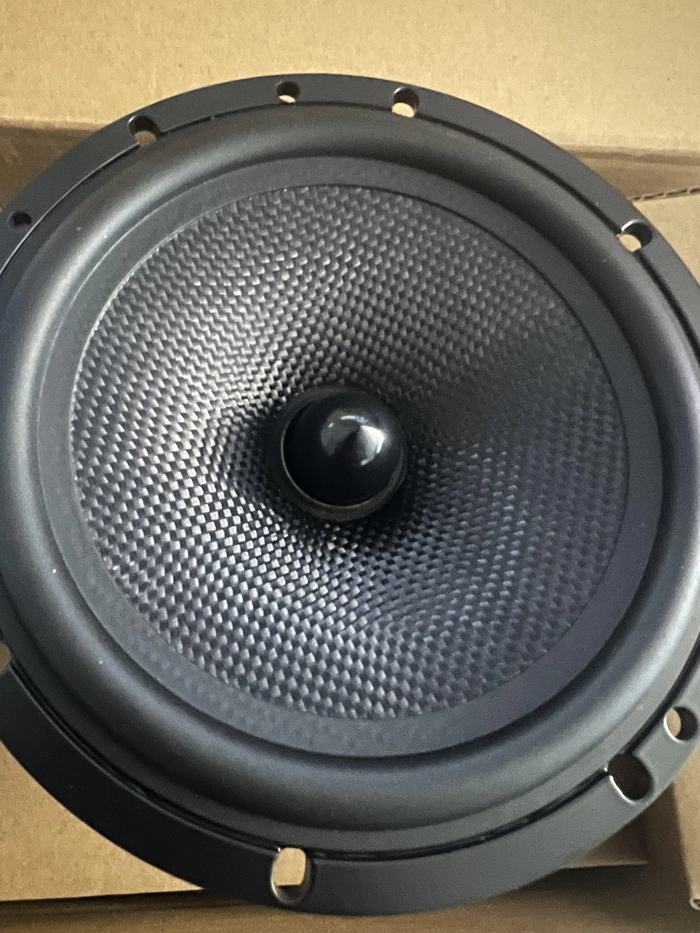

I went with the CL line and the frame between the mounting ring and the magnet was pretty thick that was the whole issue with the size
CL-E62 Set
6.5” Cast 2-way Carbon Fiber Component System
  • CL-E6 6.5” Cast carbon fiber mid-woofer
  • TW-26 1” soft dome tweeter
  • EX-530 2-way 24dB Elliptic crossver
  • Power handling: 160 Watt / HPF 120Hz
  • Frequency response: 55-20kHz
  • Sensitivity: 91.6 dB
  • Nominal impedance : 2 Ohms

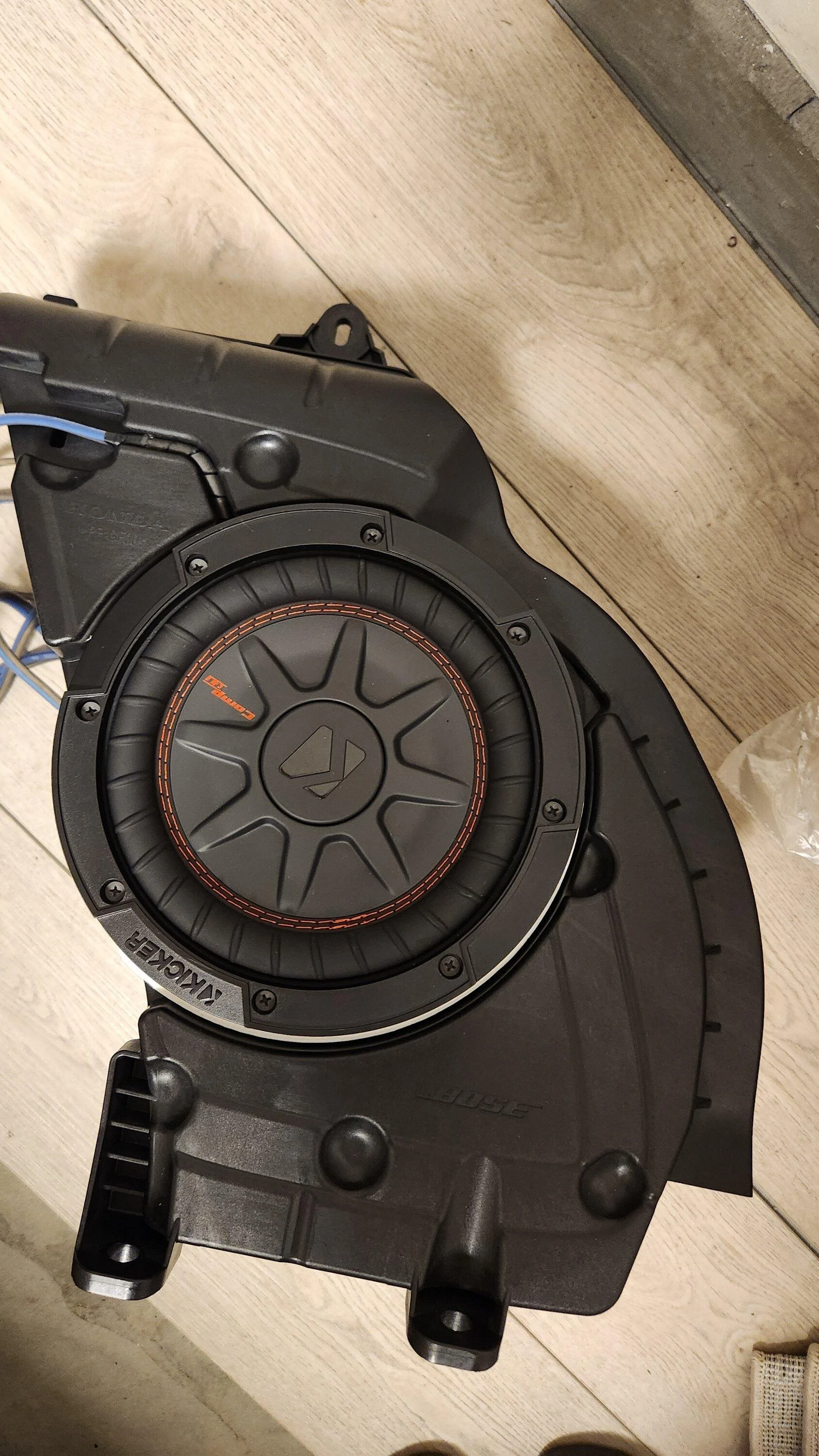

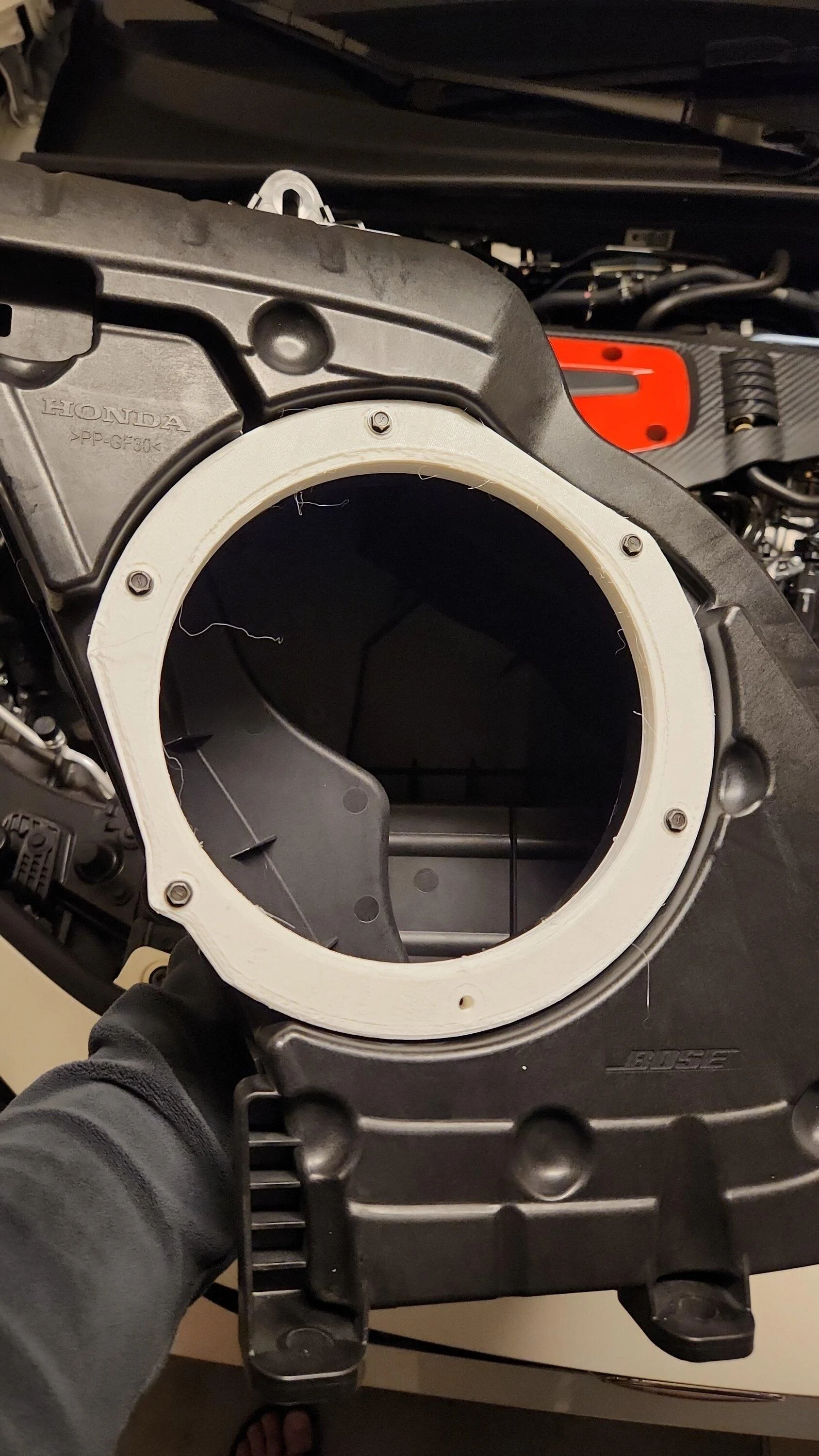

LOL...in my opinion The company selling the sub speaker ring adapter and grill is way too expensive.
I 3D printed my plastic 1/2 in sub spacer and used the OEM hardware too. It's perfect and it cost me next to nothing compared to buying the $400 kit. If you guys are interested, I can put some feelers out to see if other people want to buy them. Going to make a 1 in version next and test it out.
I've also ran the power wire to the hatch. I'm still not exactly sure where I want to mount the small mono Kicker amp. Ground wire is ready to go too. Likely going to run the bass knob up and going to locate a good remote wire to tap into depending on how the amp reads the bass signal and turns on. Don't want a sub pop when it turns on.
this is wonderful! Does it hit the factory mesh speaker cover when the sub is bumping away?
Fl5ap
Anthony
May 15, 2023
42
55
Los Angeles, CA
Yeah no clearance issues at all. Box is sealed really well too. I used a rubber adhesive padd around the ring between the sub and speaker spacer to ensure a tight seal. I'll make a couple extra 1/2 in spacers and 1in spacers. If you guys want to try them out let me know. Shoot me a dm.
