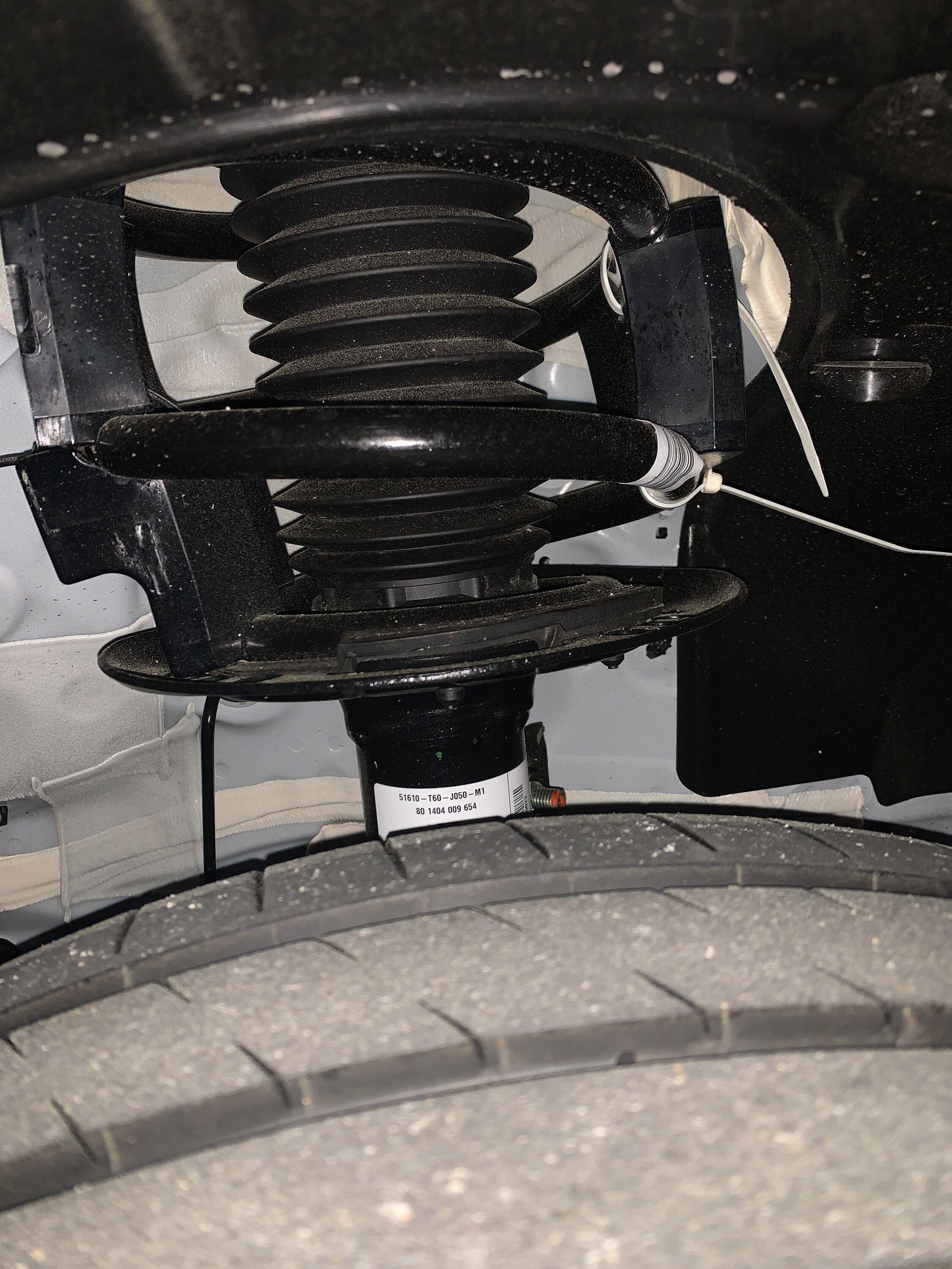

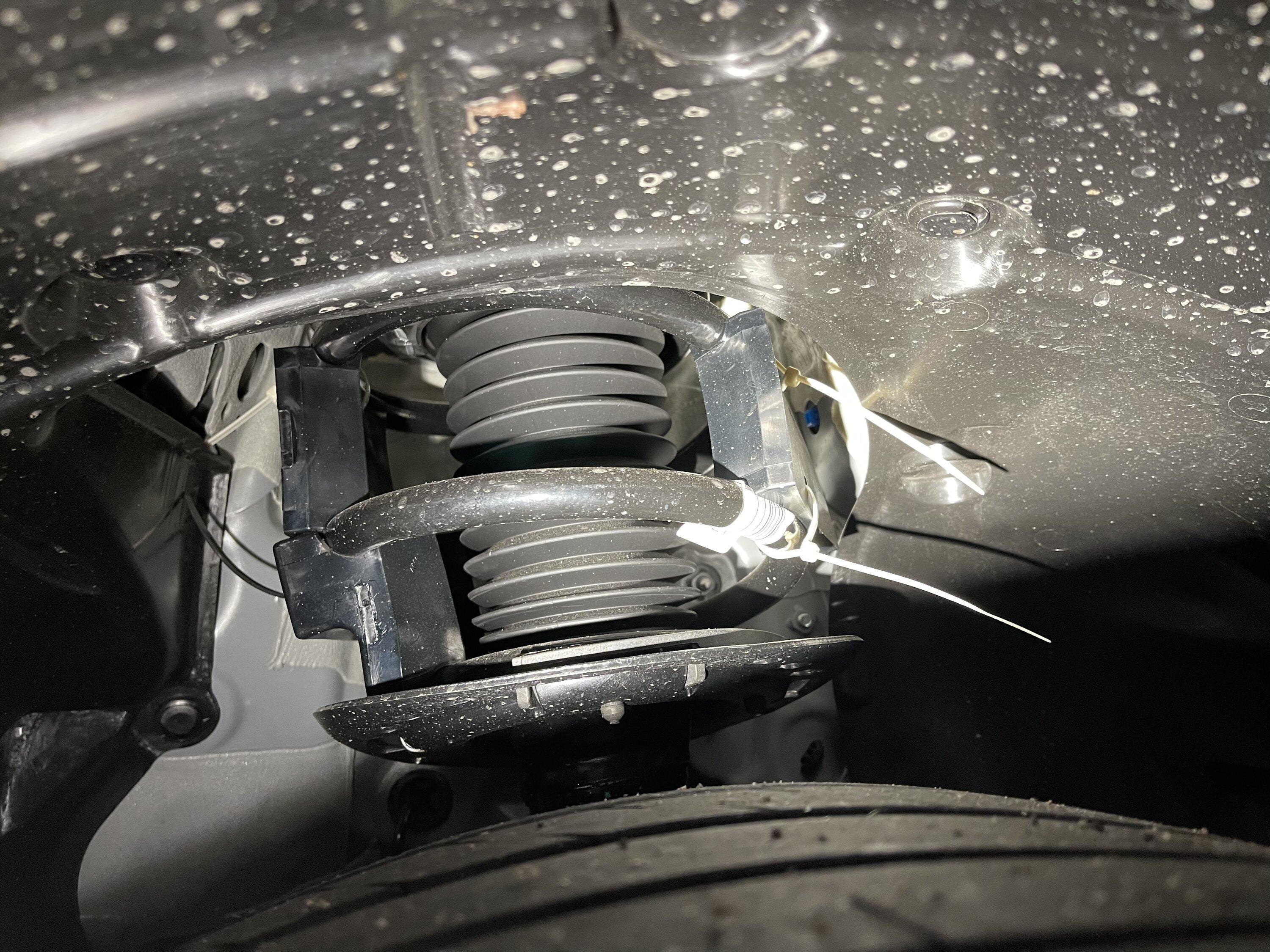

Make sure they took the transport blocks off of your civic. They had left mine on which made it a little bit stiffer than I expected. Once I took them off and drove around in comfort mode it felt almost exactly like my SI from a suspension point of view.
Iā€™m glad I stumbled across your post @spacetimeglitch. I just picked up my new FL5 today and thought the ride was unexpected stiff in comfort mode. Read your comment, ran out to check and sure enough, dealer failed to remove the transport blocks on the front springs. I checked the rears and didnā€™t see anything that looked like it needed to be removed. Did you only have transport blocks on the front?

Only on the front. I asked to keep my blocks so that I knew the dealer removed all of them during the PDI!
Okay, thanks.! Dealer is local, so Iā€™ll take the car back and let them finish the PDI. I didnā€™t even look over the PDI checklist, but Iā€™ll do that this morning. I wonder what else was overlooked.?

Hey me too. Getting it removed soon. Is there any damage if it was left there? Havenā€™t driven much
I had the blocks removed by the dealer at 59 miles. I hit some rough roads, railroad tracks, etc beforehand. Thereā€™s no damage I can notice. I believe itā€™s possible thereā€™s damage that will lead to premature upper shock mount failure, but itā€™s not likely. Iā€™m not worried about it. The salesman apologized and offered a detail and tank of gas. I accepted his apology but nothing else. I think itā€™s the service manager that should be making concessions. But the massive torque steer and teeth rattling ride is all gone now. Im happy and plan to just enjoy driving the car.
