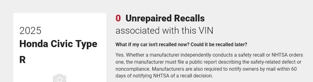

And this is my friend’s car
Cueyo
Nov 3, 2023
1,088
867
2025 Civic Type R
I started having a sticky steering problem at 6,000 miles. The dealership said my car wasn't affected and they didn't do anything. After another 3,000 miles, the sticky steering improved, but the steering became hard to the left after driving about 25 miles. Recently, it has also started making this noise.
I've said this on a few threads, but everything I can see tells me the sound may be unrelated to the actual problem (ie just normal play in the u joints). If it is related then it's likely just a symptom of a bigger problem.
