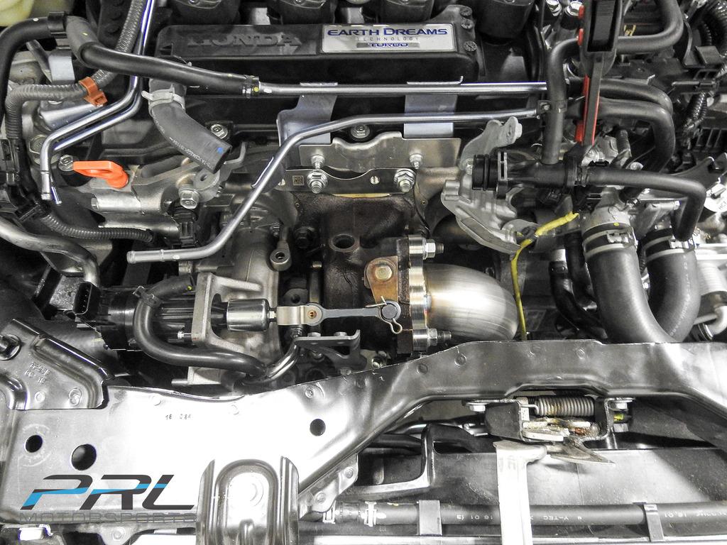

Based on the pictures, it appears that these arms are made with loose tolerances that wear as they are used with basically a pin in hole style connection. This was likely to prevent binding and allow for tolerances to tighten with thermal expansion.
If my assumption that these only move along 2 directional planes is incorrect, my idea would never work. I have not witnessed the actuation of the wastegate in person.
If we are talking movement that is in no more than 2 planar directions, a new connector arm could be designed and made to fit a set of small radial ceramic ball bearings (assuming they are available in the necessary size) and could hold a tight tolerance on either end eliminating any vibration and noise. Machining costs are still pretty volatile but based on similar parts I've had made I would guess the arm would be ~$150 to make and knowing ceramic bearings are expensive I am guessing those would run ~$45-$75/ea (2 total).
Or you could just ignore my thoughts and try that $4 spring. I would not try the spring method, personally.
I havent heard any rattling from my 1.5T so I have no inclination to try anything myself. I just stumbled upon this thread and fell down the internet rabbit hole and had an idea for improvement.
If somebody else is truly as annoyed by this as some of the posts I've seen, I am willing to invest some free time to help. I just want to be clear that it would involve rather expensive parts for just a little actuator arm. Again, this is all theoretical in my head at this point and if there is any movement in a third direction my long winded post is worth nothing.
