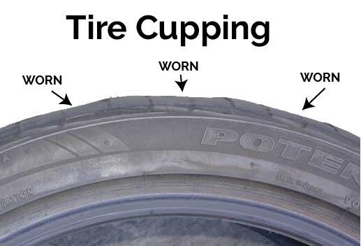

As the steering rack was failing it could have thrown the front end slightly out of alignment.
Did you check to see if the tires had any abnormal wear or slight cupping starting?
That can cause a slight vibration in the wheel at certain speeds while everything else seems normal.
This is an extreme example but you can rub your hand around the outer edge diameter and feel any sort of waviness in the tread.

The two tires in question did not feel like they were cupped. If that is the case, I should be able to hear more road noises.

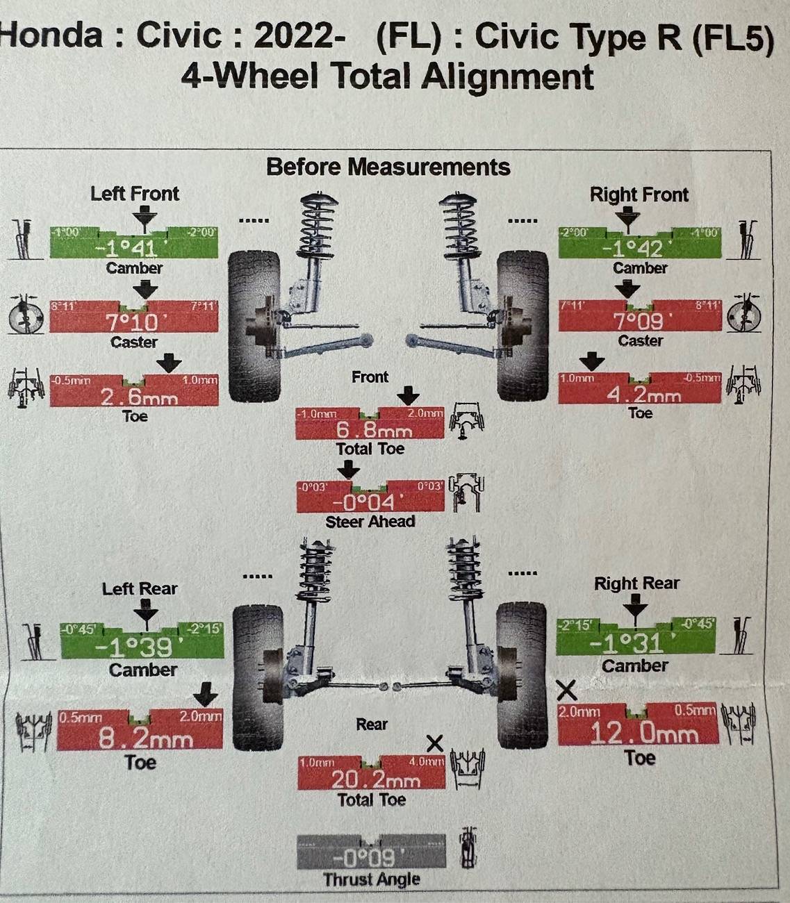

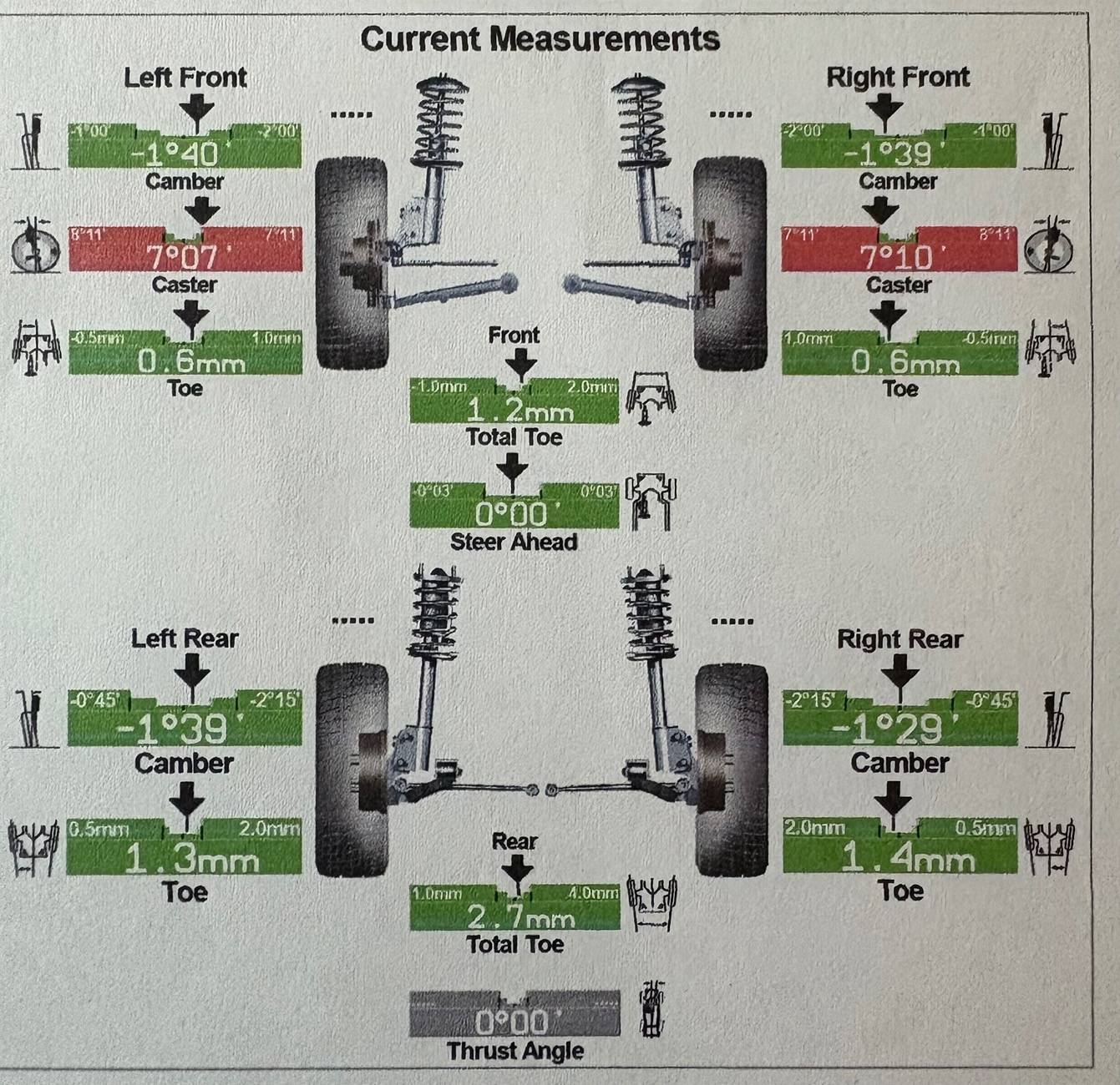

So I just got a wheel alignment from a reputable place. Look how much the toe was out just 2 months after the steering rack recall and supposed dealer alignment. No way they did an alignment and this explains the vibration.
I've had/having a similar issue after the recall. Did more research and realized the alignment was off from after the recall, since then no tyre shop can get my rear camber any better but for now the toe is sorted out. I still need to test but car felt awful around bends... Couldn't plant it and just felt skittish at speed.

If toe-in alignment was way off, you may need to get a windshield camera recalibration as well. You'll know soon enough if lane keeping isn't right.
I had a similar experience.. I bought my '24 right when the '25s hit the dealers and when the stop sale was going on.. My dealer got the kit to fix the steering rack before the quick fix came out and I had my car aligned by my tire shop not long after buying it (I had all seasons put onto stock wheels - I already had some summers on 18s sitting around from my FK8) and found the toe to be way out as well. So much for them doing the alignment at the dealer after.
