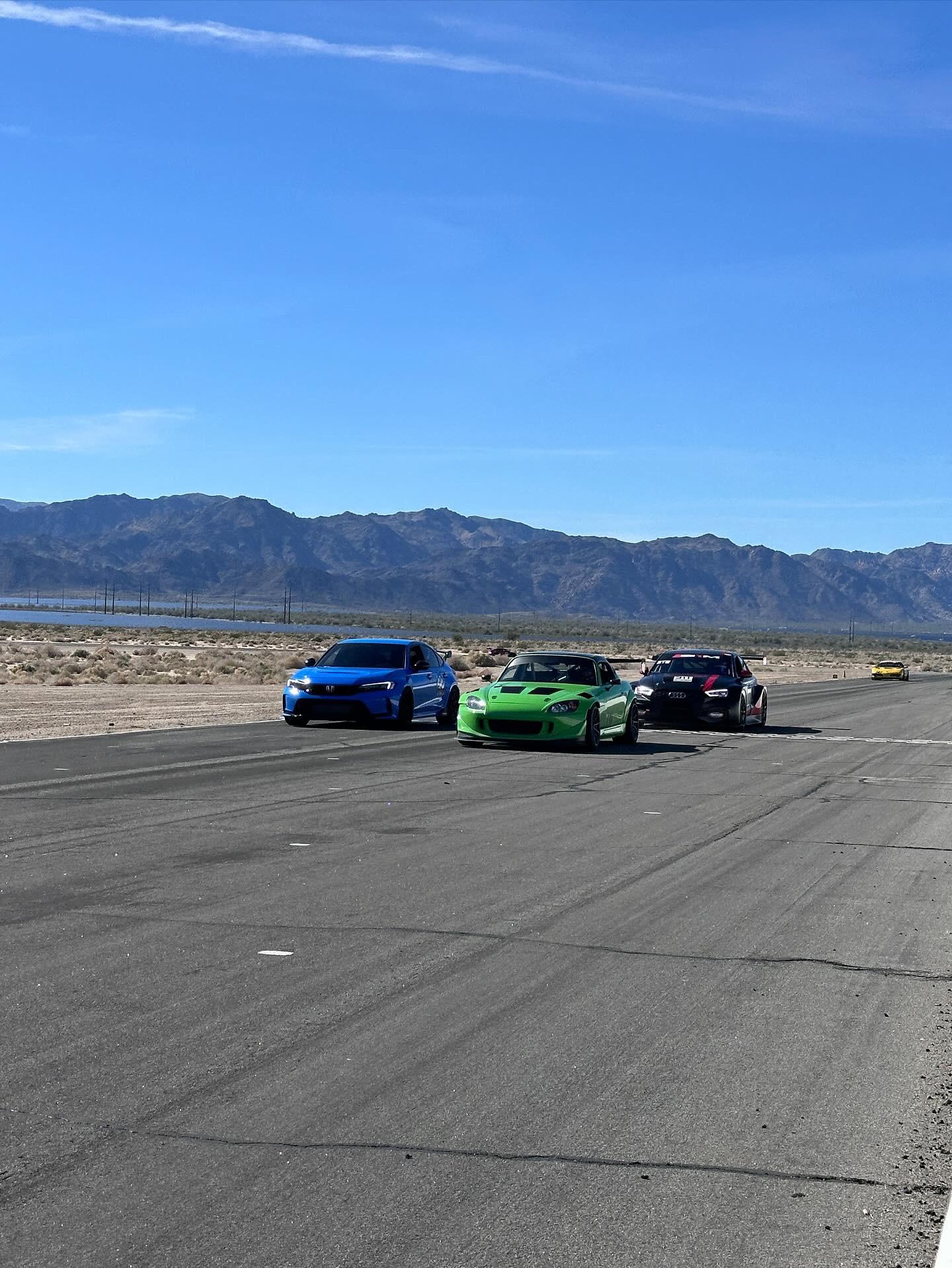

Did my first track day at Chuckwalla last week and had some issues. The "brake system" light came on on lap 2 of the first session and would come on for each session. I never lost braking power and I do have RBF660 fluid in there.
3rd session, the car went into limp mode. I got a check engine light, emission system problem warning, and rev match system warning. I figured my day was done and packed up. After an hour of the car cooling off all the lights and warnings disappeared. It was a cool day low 70s.
Is this normal for this car? Any suggestions how to avoid this on my next track day?
Only mods I have are swift springs, wheels, tires, and Remark exhaust. Other than that the car is really fun to track and very capable.
