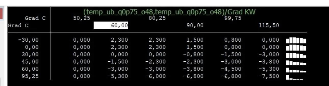

And I understand most people don’t consider overheating until a warning light comes up. If that were the case then the car technically does not overheat. But also take into consideration most automakers put these warning lights in the car as a failsafe since most people don’t really care about this stuff. It’s just to prevent engine damage and letting you know to stop the car.
Now from a performance standpoint the car overheats quickly and starts to not perform as advertised. This is a table that @Vito.FL5 was able to get using his software so credit to him we just talk a lot on the side away from the forum.
X axis: Engine coolant temps ECT 1 the one that shows up on Log R
Y axis: IAT’s
Z axis: timing adjustments
11th Gen Honda Civic Limp Mode on first track day IMG_3729
The reason I recommend cooling mods to answer @optronix question better is to keep power consistent to keep lap times as consistent as possible.

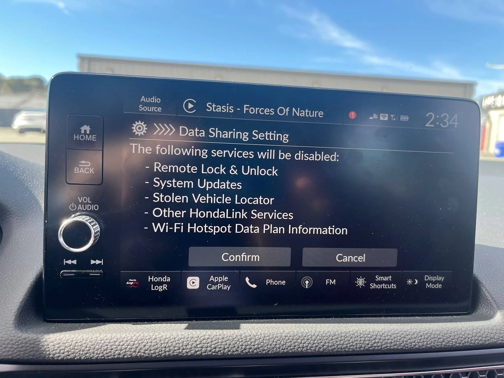

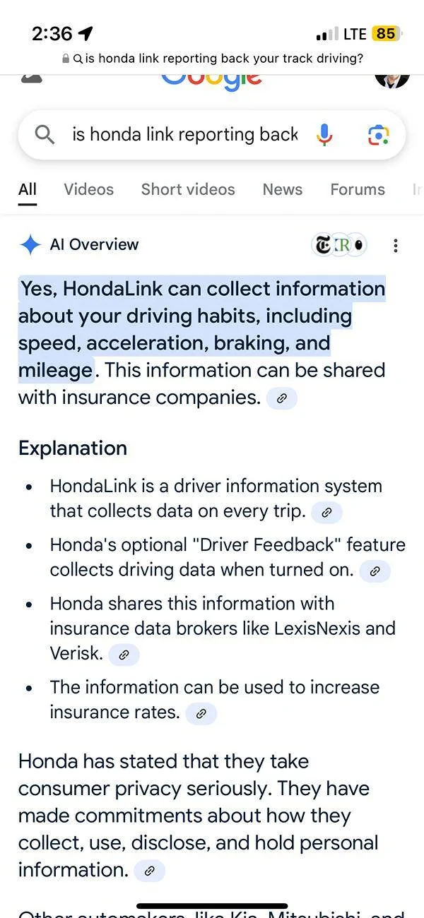

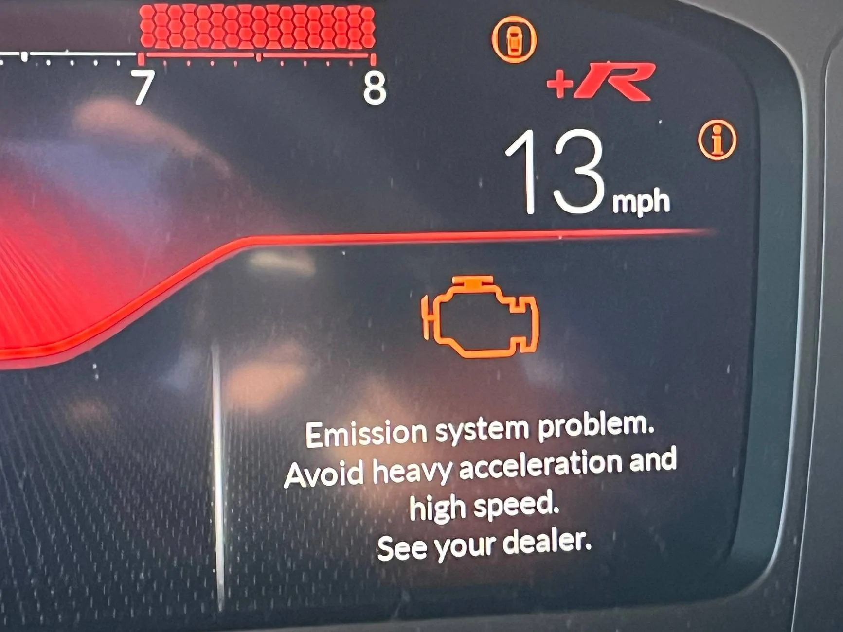

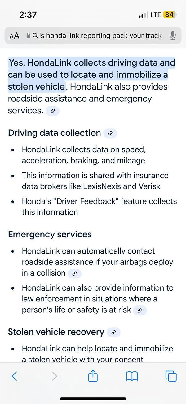

Very odd day at Laguna Seca 4 type rs my tank was full and we all got same errors today and its never happened to us…. Twice in row… after 9 min all of us
wtf ?…. Is it supposed to happen with a full tank to everyone at once or someone had a conspiracy theory that may be Honda is shutting us all down so I disabled the Honda data tracking? What’s the solution to this fuel problem ? Even with a full tank!? Why today and everyone….including 1 fk8
11th Gen Honda Civic Limp Mode on first track day IMG_4898
11th Gen Honda Civic Limp Mode on first track day IMG_4906
11th Gen Honda Civic Limp Mode on first track day IMG_4907
11th Gen Honda Civic Limp Mode on first track day IMG_4905
TypeRD
Jan 20, 2023
1,819
1,914
I don’t see how Honda could remotely “disable” your cars, but it is very strange. And yeah, F the HondaLink BS. I never signed up for it nor activated it, despite it having some useful features. I figure my phone tracks me enough. I don’t need my car doing it too.
PointByPatrol
Ben
Jul 28, 2023
2,022
3,206
What was the code? All four cars pulled the same code?
johnloov
John
Jul 9, 2024
484
552
Exact same code -
Fuel rail/system pressure - too low bank
To be precise it was me in FL5 ( stock engine no mods ), another FL5 ( stock engine no mods ), 2020 FK8 ( stock engine no mods ) and Zygrene car journalist Type S with Cobb tuning.
11th Gen Honda Civic Limp Mode on first track day 1740425820027-1y
Then I turned off this Honda Tracking, full tank, nothing, and the next day full day, nothing happened.
I think the conspiracy theory of Honda shutting down the cars, seems legally maybe dangerous thing for them to do, so I am leaning on the side of, they didn't do that?? But the car does have a way to disable it remotely. I'll run more track days with the data sharing off.
Buy yeah, it was very weird... And everyone had a full tank, and on the same exact session..
Unless there is something to do with the exact temperature on track at that session that maybe triggered something..
We have no idea
