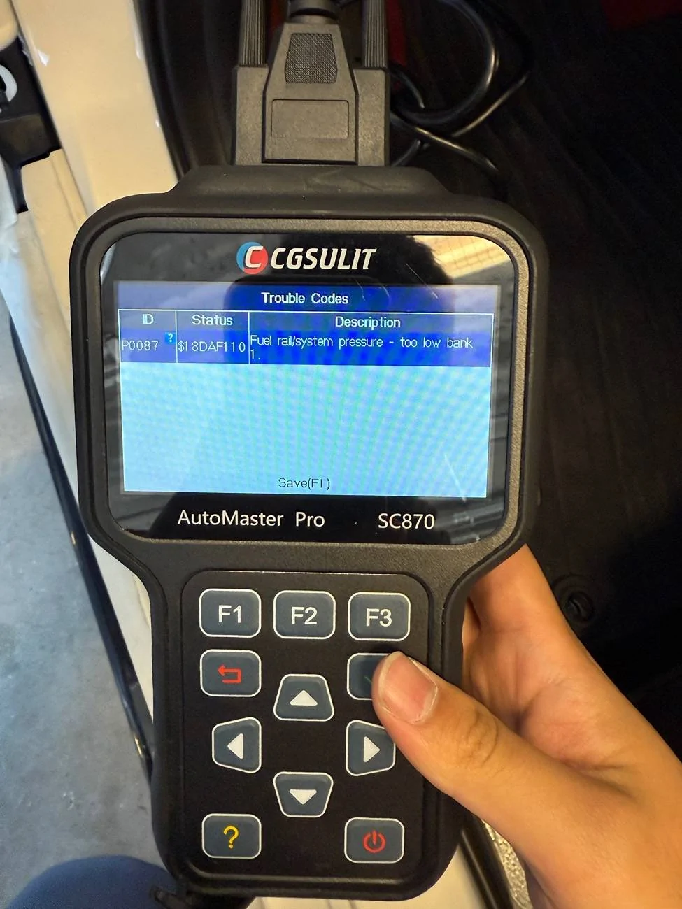

I was at Watkins Glen a week or 2 ago and at the end of my first session (which I started with a full tank of 93), got the same warnings on the back straight. Car went into limp mode/lost all power and was limited to 35mph. Luckily they threw the checker right after so I wasn't that much in the way. I put the scan tool on and it was the same P0087 low fuel rail pressure. I figured because it was down to about half a tank by the end of the session that maybe it was fuel starvation. Topped up the tank, went back out and for my second session and Lap 2, same spot on the back straight, car goes into limp mode again.

I've read every thread I can find on the topic. Most people have just gone out on track without enough fuel, some people get their HPFP replaced under warranty. Whats the consensus on the issue? I'd rather not take the car to the dealer if there is actually no problem and the stock fuel pumps just can't keep up. But I also don't want to get stuck out on track again going 35mph.
