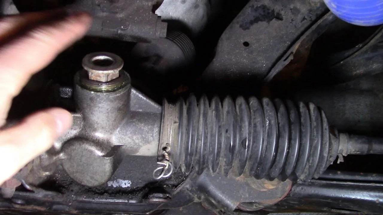

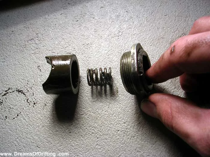

there's a screw to adjust rack preload, service manual says "do not adjust".
if anyone has excessive slop in their rack, would be interesting to try tightening it up before you replace it. same type of adjuster as hydraulic racks.
11th Gen Honda Civic Looking for opinions after recent rack replacement. Pre and post op owners! 1772657029863-n
11th Gen Honda Civic Looking for opinions after recent rack replacement. Pre and post op owners! 1772657045761-lv
these pics aren't from our cars, but same basic design.
