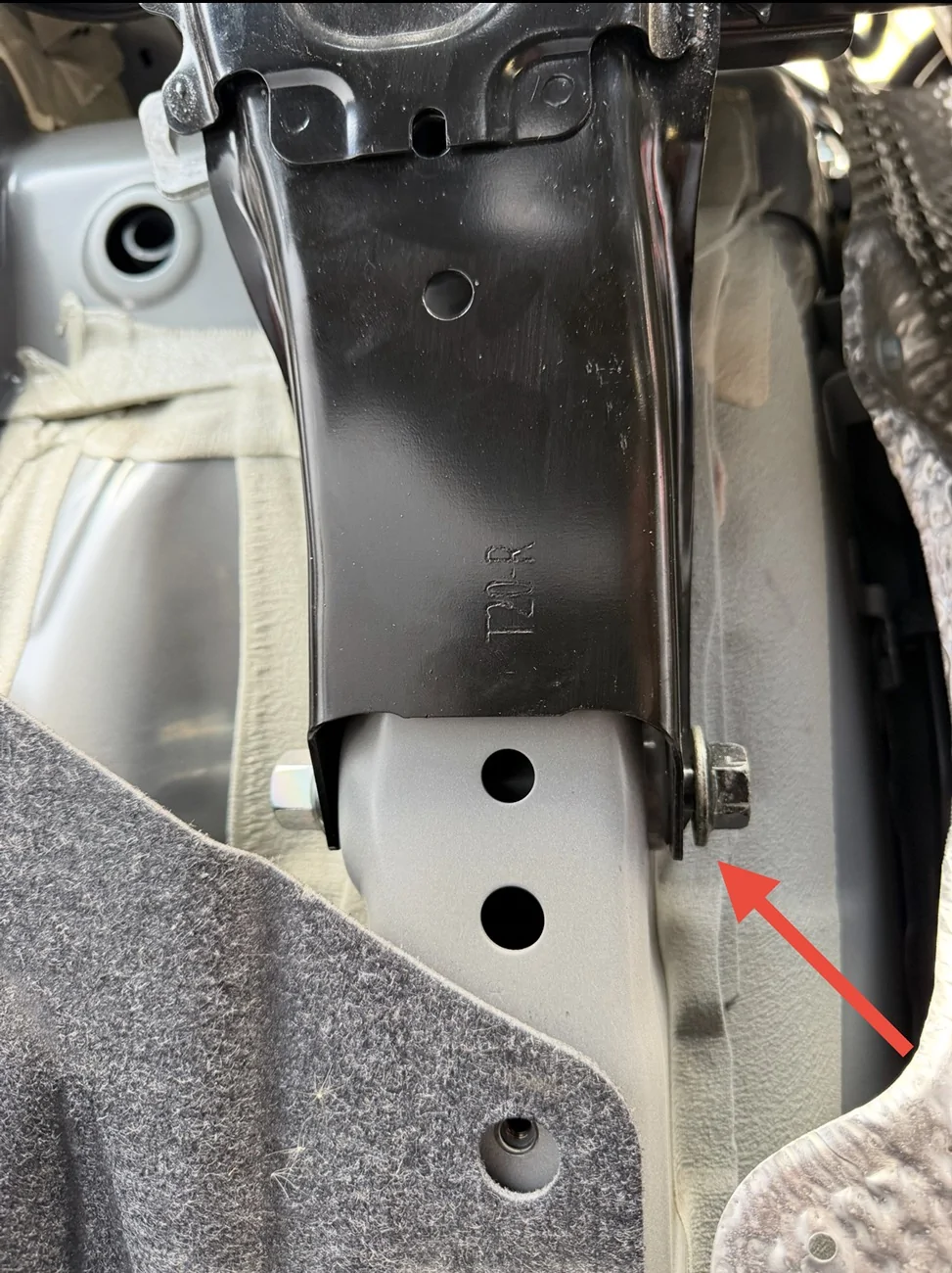

Good call, do you know the torque specs off hand?
toomanyhondas
Apr 25, 2025
FL5, CRX, EK
I don’t. Based on that size bolt, probably in the 60s. The interesting part about this location is that the nut has a bracket that notches into the subframe to keep it from spinning. I would like to assume it was torqued from factory. Maybe the dealer messed with it based on the existing wear marks on the bolt heads. The car had 15 miles on it when I bought it new. It also had that steering recall already done.
