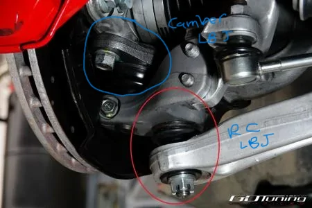

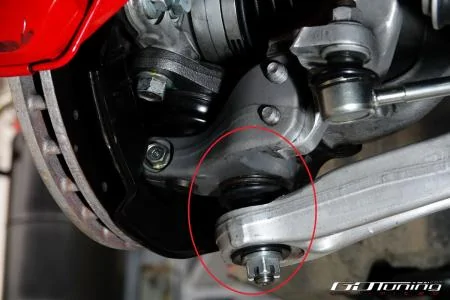

Are you talking about the RC/ bump steer ball joint like the Spoon/whiteline?
If so, that goes on the LCA to knuckle (circled). The camber LBJ is a different part and that goes from knuckle (or rather the "wishbone" part of dual-axis design to the hub (its got a huge plate on it above it in this pic). The other civic platforms is not a dual-axis suspension design (I believe its a 3-bolt balljoint to the LCA there).

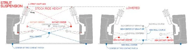

I don't know the actual math formulas behind RC off-hand, but I do know it's based on things like the following:
1. Suspension (overall shock/strut length, even motion ratios - because it's not always you have a .5" shorter spring and it equates to a .5" drop and motion rates play the biggest part in choosing spring rates)
2. Track width
3. Links/Arms/Ball joint pivot/connection points
4. Hub/Spindle height
5. Wheel+Tire diameter height
etc
Which all goes to the +Xmm amount. Though, in theory, the longer the new ball joint is, you should be able to lower it even more than the shorter ones without throwing the RC out of stock specs again. But keep in mind, you don't always want to "fix" the RC back to factory/stock/OEM. It completely depends on your uses. Generally, a good rule of thumb here is:
Roll Center Guidelines
ApplicationFront RC HeightRear RC HeightCharacteristics
Street/Daily2-4 inches4-6 inchesComfort, stability
Sport/Performance1-3 inches3-5 inchesReduced body roll
Off-Road/Trail3-6 inches5-8 inchesArticulation, traction
Rock Crawling4-8 inches6-10 inchesMaximum flex
Racing/Autocross0-2 inches2-4 inchesMinimal roll, quick response
Take a look at the chart above, notice that racing is LESS roll center than street/daily. That is what I meant by you don't always want to "fix" it, unless you are trying to get back to as factory driving characteristics as you can. Adding a longer ball joint will then push the LCA back down and the hub/spindle back up. That is also why in track/racing, lowering the car and introducing a lower RC height is not a bad thing, in reality, it is welcomed. Bump steer is also personal preference and use case, and you can effectively "tune" that with alignment if you want. I will say using the camber LBJ will cause more noticeable affects of bump steer, tramlining, and darting characteristics because you are changing the angle where the hub, spindle and links pivot/attach (it even adds in a touch of track width too) especially compared to using camber plates and/or the top shock tower mounts holes (since they are slotted/ovaled) but can be minimized (or exacerbated if you want) by alignment settings.
Again, if it were me, I want to see a motorsport style design for the tie rod ends - clamp design (not just a nut), heim/rose joints and misalignment bushings. That can help with bump steer as much as tie rod articulation throughout the whole suspension cycle because we all know greased ball joints will be limited in articulation compared to heim/rose joints. But of course will introduce NVH and additional maintenance.

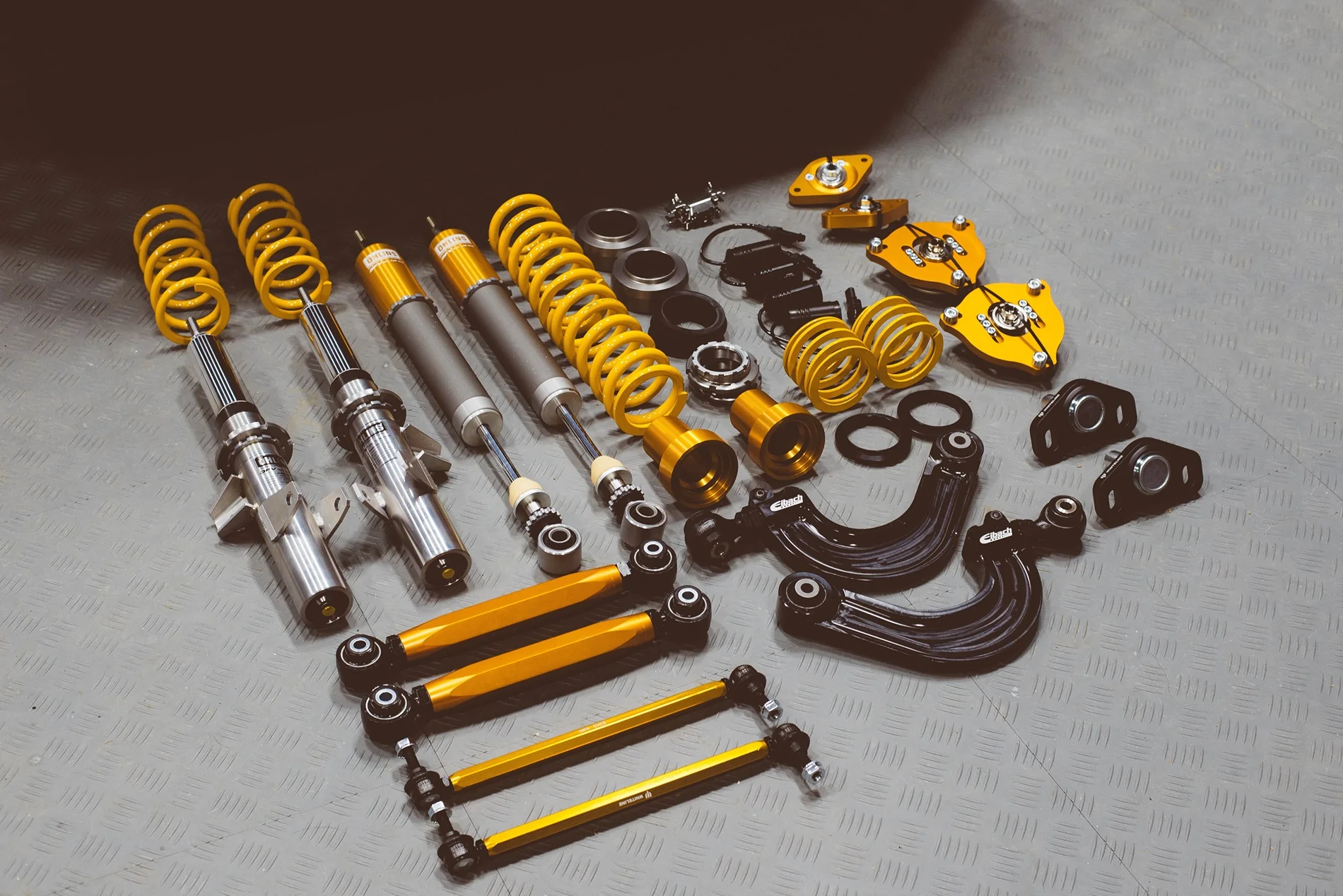

Any FK8 version will work with FL5. They are the same chassis (effectively). MFGs/vendors are not always very good at updating their websites.
Also hope this helps further:
11th Gen Honda Civic To Lower or Not to Lower? 1775240304600-jl
And let me know if/when you decide on any particular parts. I'm happy to ship over to you!
