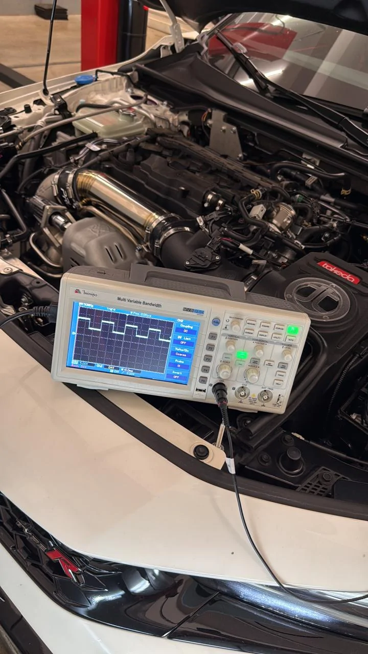

It worked like a charm on the first try.
I tested the output between 10 and 100 Hz and the signal was clean, so I decided to go ahead with the project.

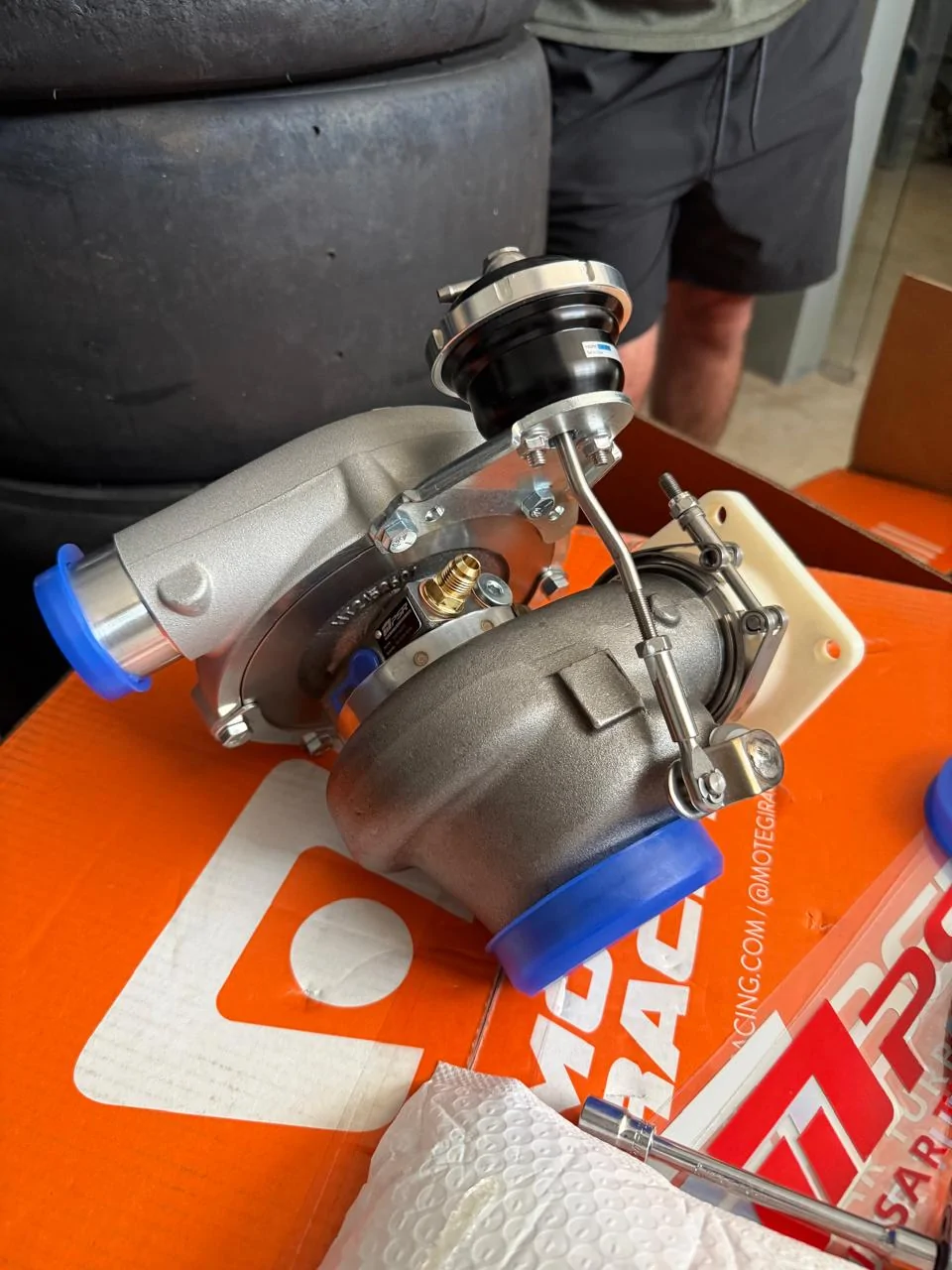

I 3D printed some parts for test fitting and installed the Chinese turbo.
I hate counterfeit stuff, and honestly I assumed the turbo would be garbage. The idea was just to use it to prove that the whole system worked. If it didn't, I could shelve the project, put the stock turbo back on, and move on.
I was wrong, BTW. The turbo actually works pretty well.

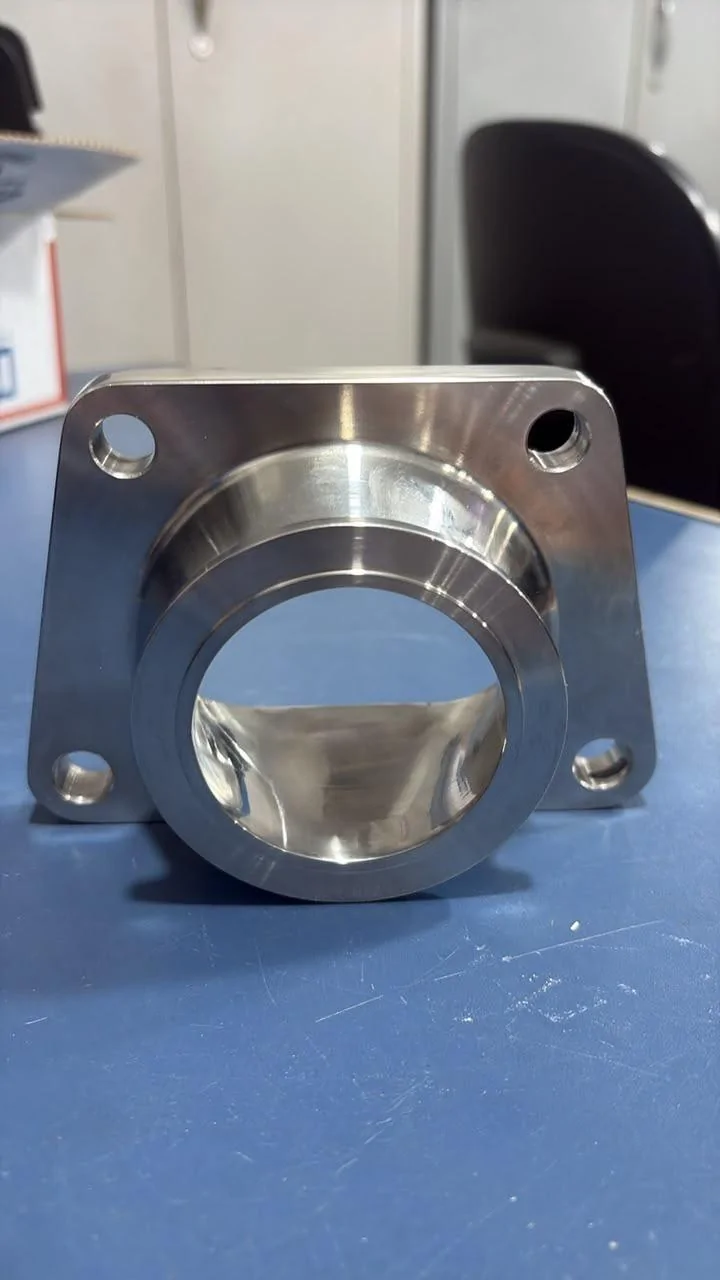

Once I knew everything fit, I moved on to machining the final part out of 304 stainless:

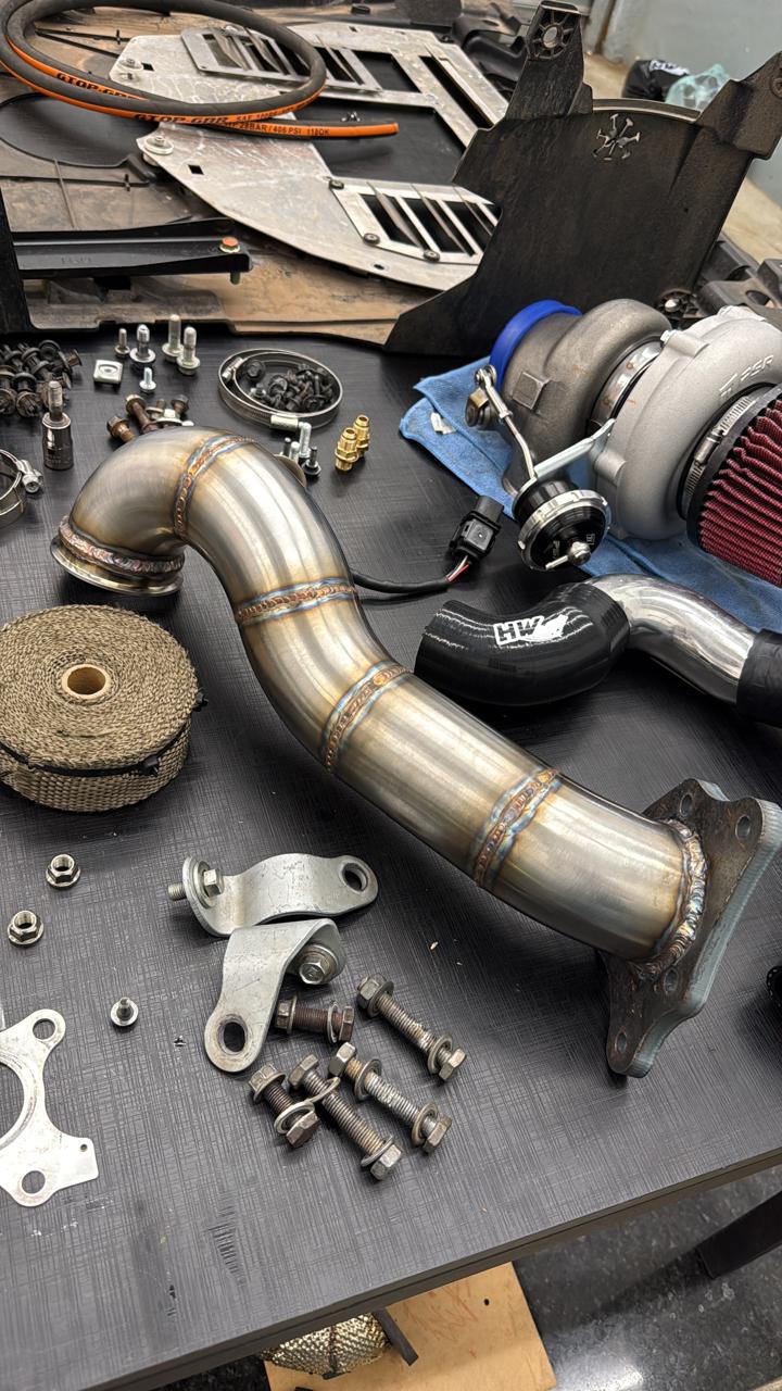

Then I "hackjobbed" a downpipe:

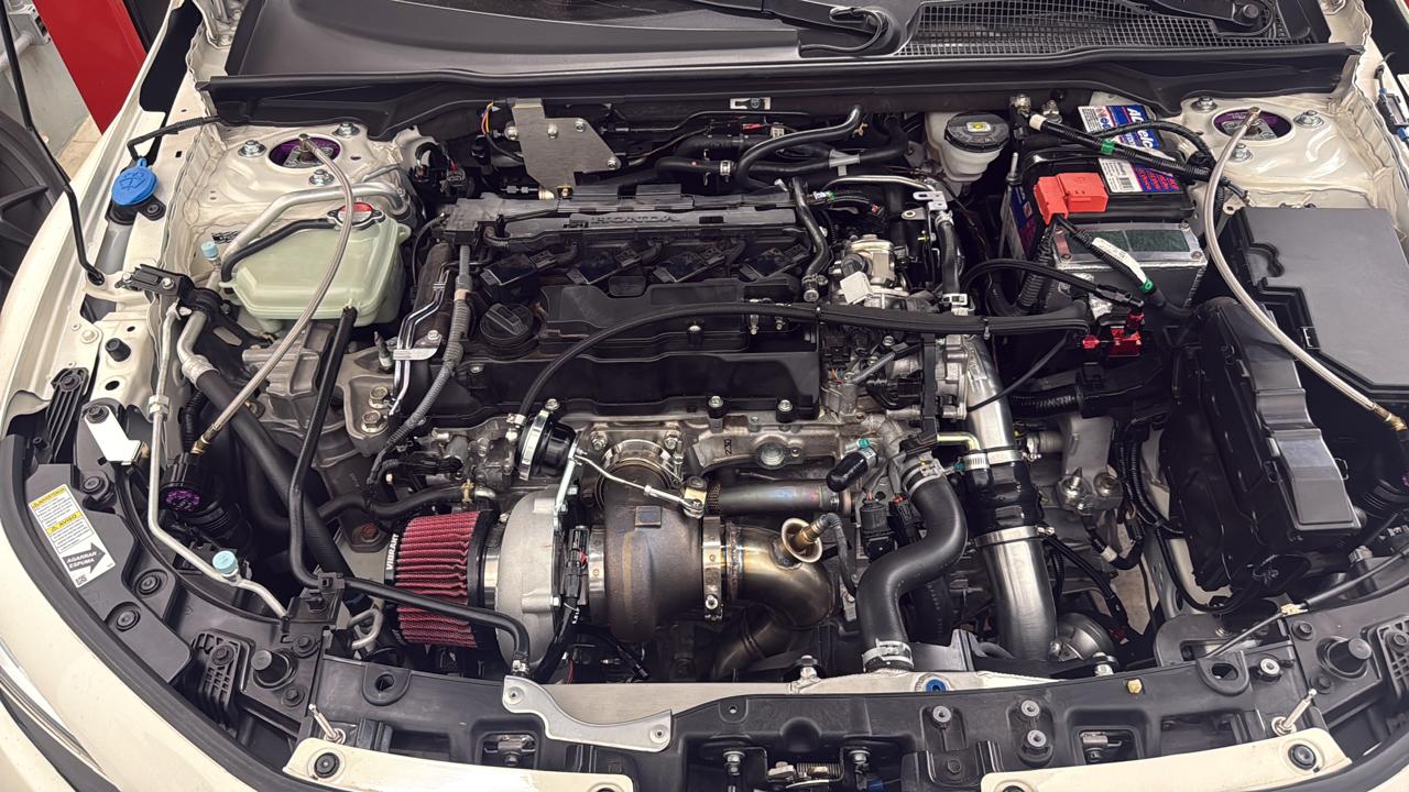

And finally put everything together...
six hours before the event started. lol.

11th Gen Honda Civic Mafless + PWG G30-770 on stock ECU WhatsApp Image 2026-09-07 at 22.24.00

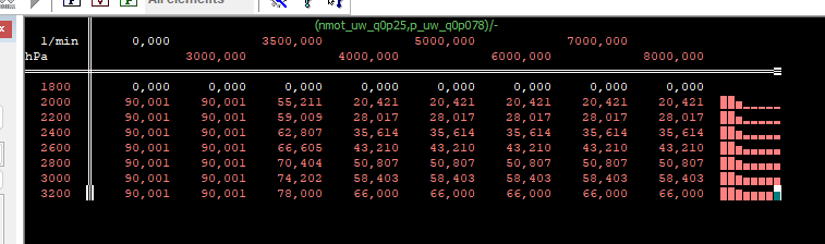

Tuning-wise, since there wasn't much time left, I patched the ECU to output a given wastegate duty cycle based on boost target.
That way I could control boost through my custom map switch instead of having a single fixed boost setting.
I basically used the first day of the event to tweak the duty cycle table, and it worked out surprisingly well.
