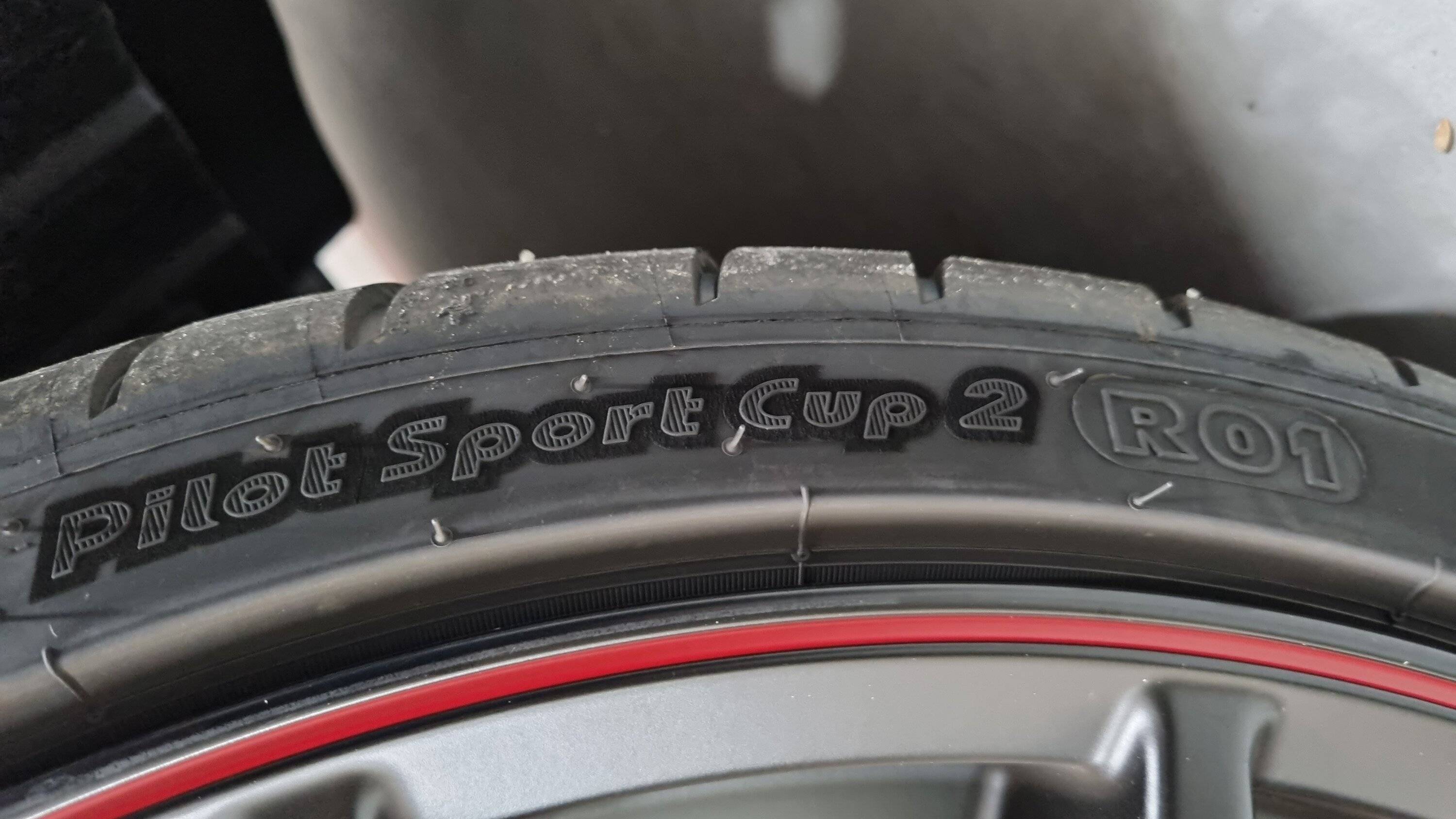

FYI these are the ones fitted to my LE. They're the R01 variant with a treadwear rating of 180.
I suspect the H0 Honda version of the Cup 2 Connect will have different compound to the normal Cup 2 Connect but probably the same 240 treadwear rating.
In the interview the Michelin guy said that for the 265 specific tire size, this was the first FF car they were providing OEM tires for, so they modified the carcass to be more optimized for turning and drive forces simultaneously. I don't remember if he mentioned compounds.

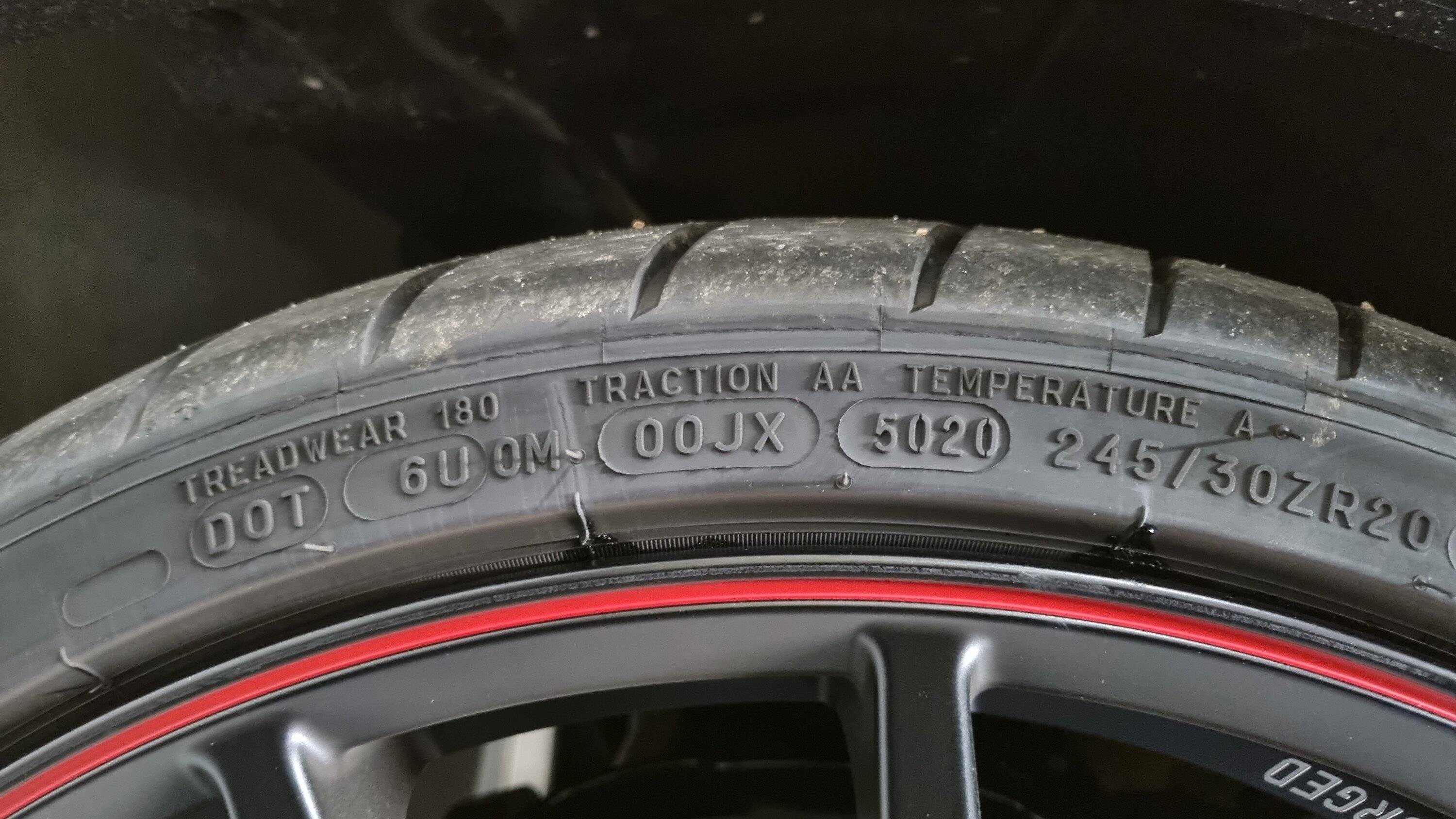

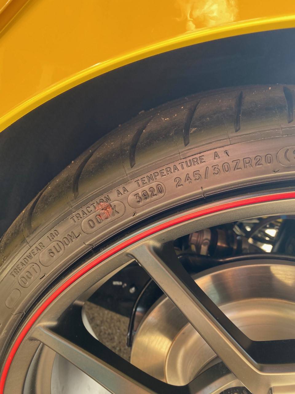

With your tires being produced during late December 2020 I am guessing that your 2021 LE was assembled in Swindon sometime in the early Spring of 2021 and wondering what your chassis number is?
As you can see my Cup 2 tires were produced in September 2020 with my vehicle being built in November, 2020 therefore a relatively early build.
Looking to purchase a very late 2021 LE build and believe that the last production timeline for the U.S. LE vehicles was May, 2021.
Of course Chassis # "USA-001" was built in August 2020 therefore suggest that suggest that the 600 examples for the U.S. were produced over a 10 month period at Swindon.
If you have production information for the European/Japanese market that would be great!

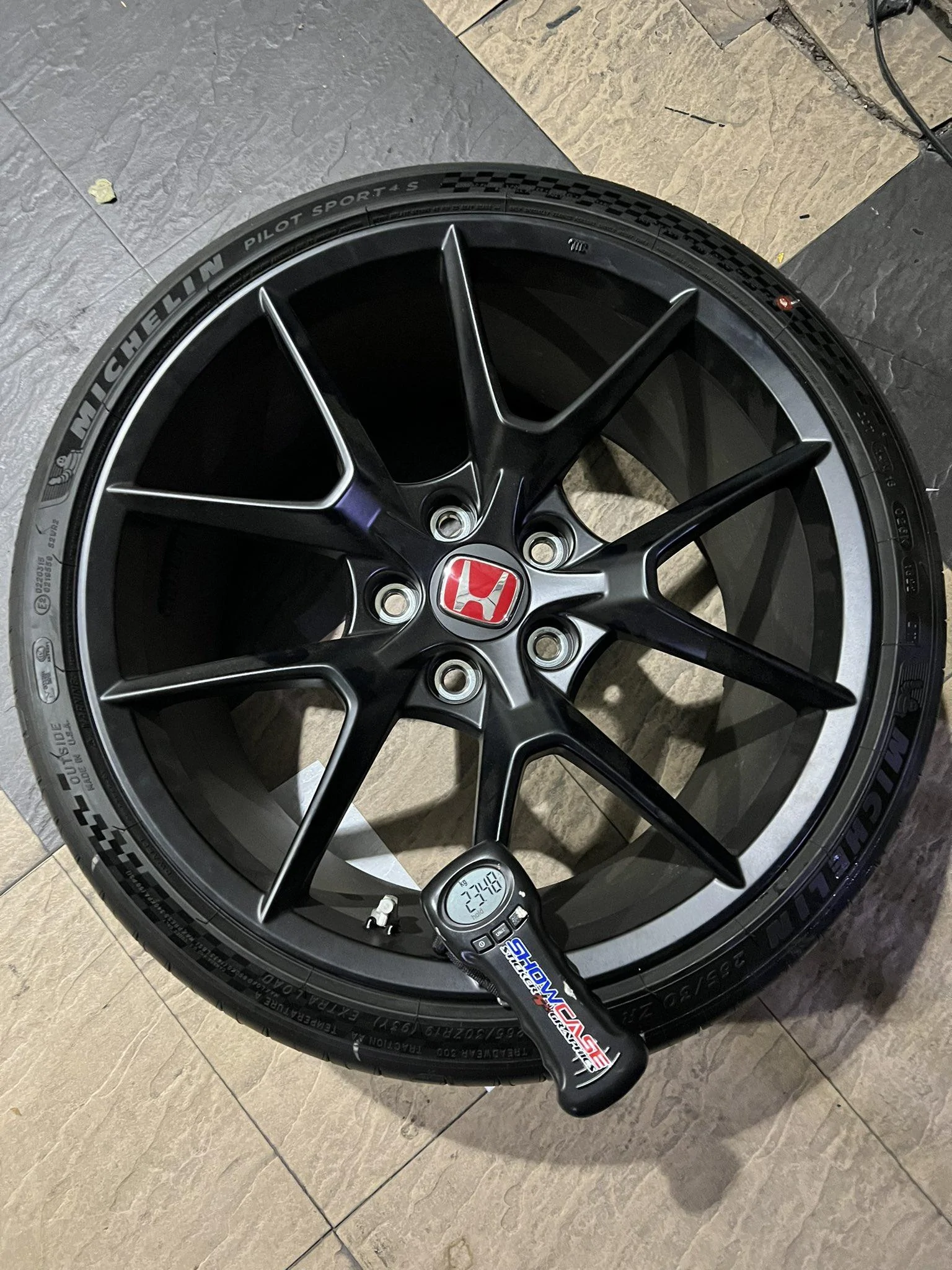

The OEM tires are not Cup 2. They're Pilot Sport 4s. I thought I read somewhere the Cup 2 was an option? The Cup 2 isn't on the Type R build page either.

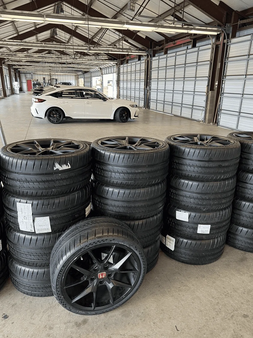

Also it's interesting Honda brought full sets of Cup 2 to the press events. Maybe @savagegeese can provide some insight into this. I'm guessing the press cars came with 4s and the Cup 2 was mounted for the Sonoma track event. Why not run the 4s on track? That's more of a true showroom stock car.
The Cup 2's are supposed to be an option, but I didn't see it on the site (it might be available at the dealer). I'm chalking it up as not being readily available yet. I would not have optioned them anyway as I'm getting something else in that class of tire for the track. I'd still consider the FL5 on Cup 2's as a showroom stock car since it's an option you can check, much like the Performance Package option for the Mustang. If it was something offered thru HPD after-the-fact (like the Ford Performance supercharger for the Mustang), then it would be a modification rather than an option.
Personally, I'm glad they tested the PS4S on the street and the Cup 2's on the track as that's the configuration I would use it: PS4's to get to the track and swap over to stickier wheels/tires at the event. You get to see the car's manners for both situations.

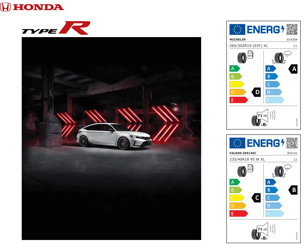

Can you take a photo of the Cup2 originally equipped? I want to take a close look on the tire wall to check if there is a specific mark on that tire, or if it can be just an aftermarket Cup2 that the tire shops usually sell. The PS4s have the latest side wall too.
I'm 100% sure the OE tire should be bespoke PS4s DT1 in all markets, I can confirm US/CA/China/JP/Australia/SA/Southeast Asia market is equipped with bespoke PS4s according to each market's brochure or Press Release as shown below. For Europe markets like UK/DE/FR, the OE tire is bespoke PS4s and Falken ZIEX ZE914 According to the EU Tyre label; however, I never saw an EU FL5 equip that Falken tire tho, all PS4s.
