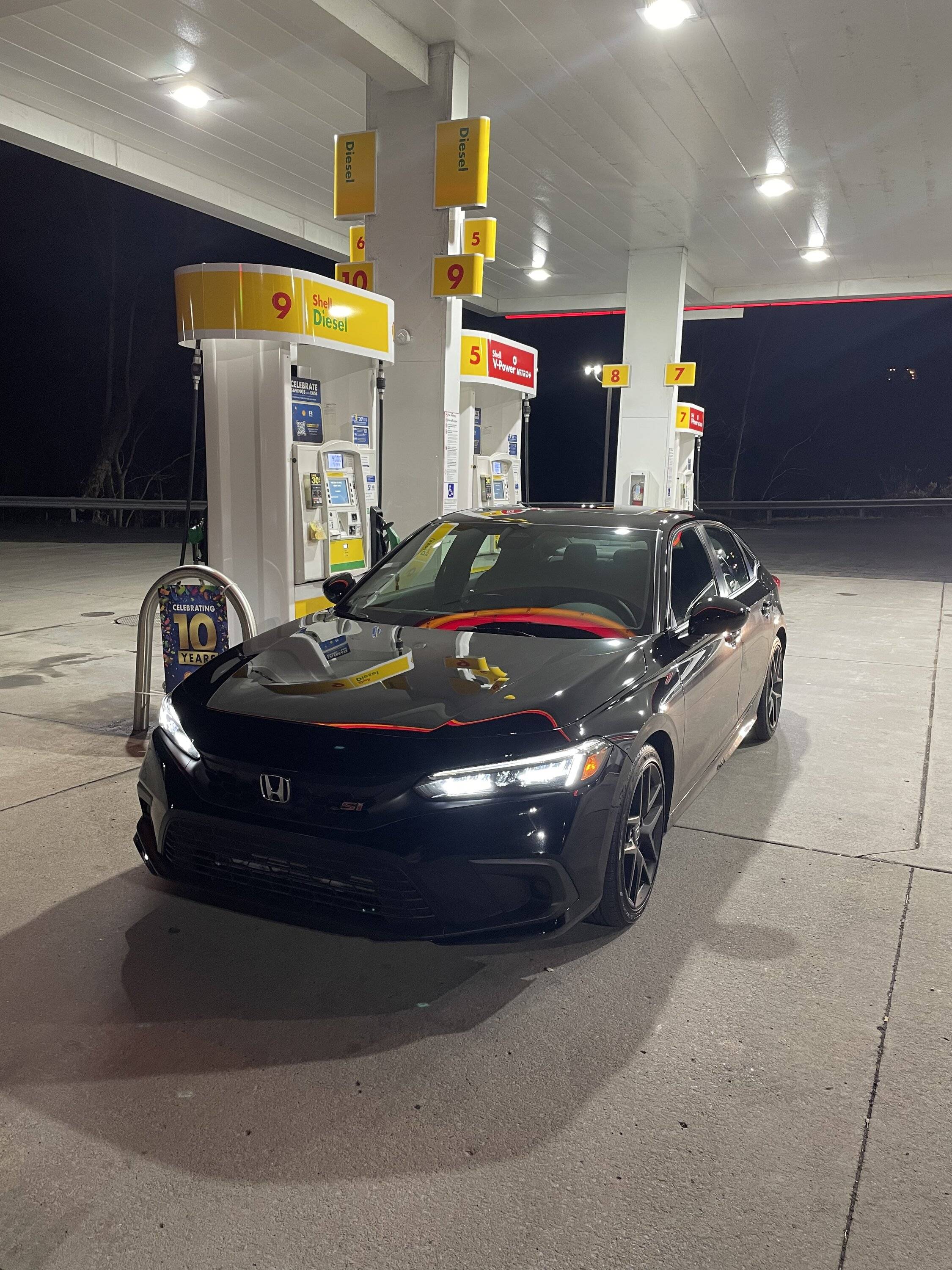

about 6000 rpm in 4th, went for 5th and somehow put in in 3rd… I had the auto rev match on at the time. when I released the clutch in 3rd it hit redline and engine braked hard. I grabbed the clutch as soon as I realized. No lights no warnings nothing when it happed and everything seems completely fine since. Should I be worried about problems to come ? Thanks
11th Gen Honda Civic Money Shift. Should I be worried? 7E1AB77C-DC95-498A-A216-97F321A5BB1B
