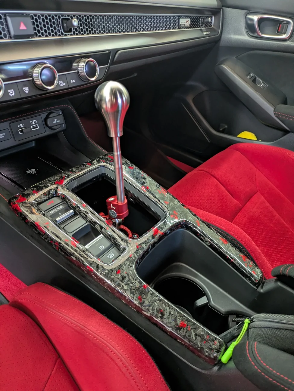

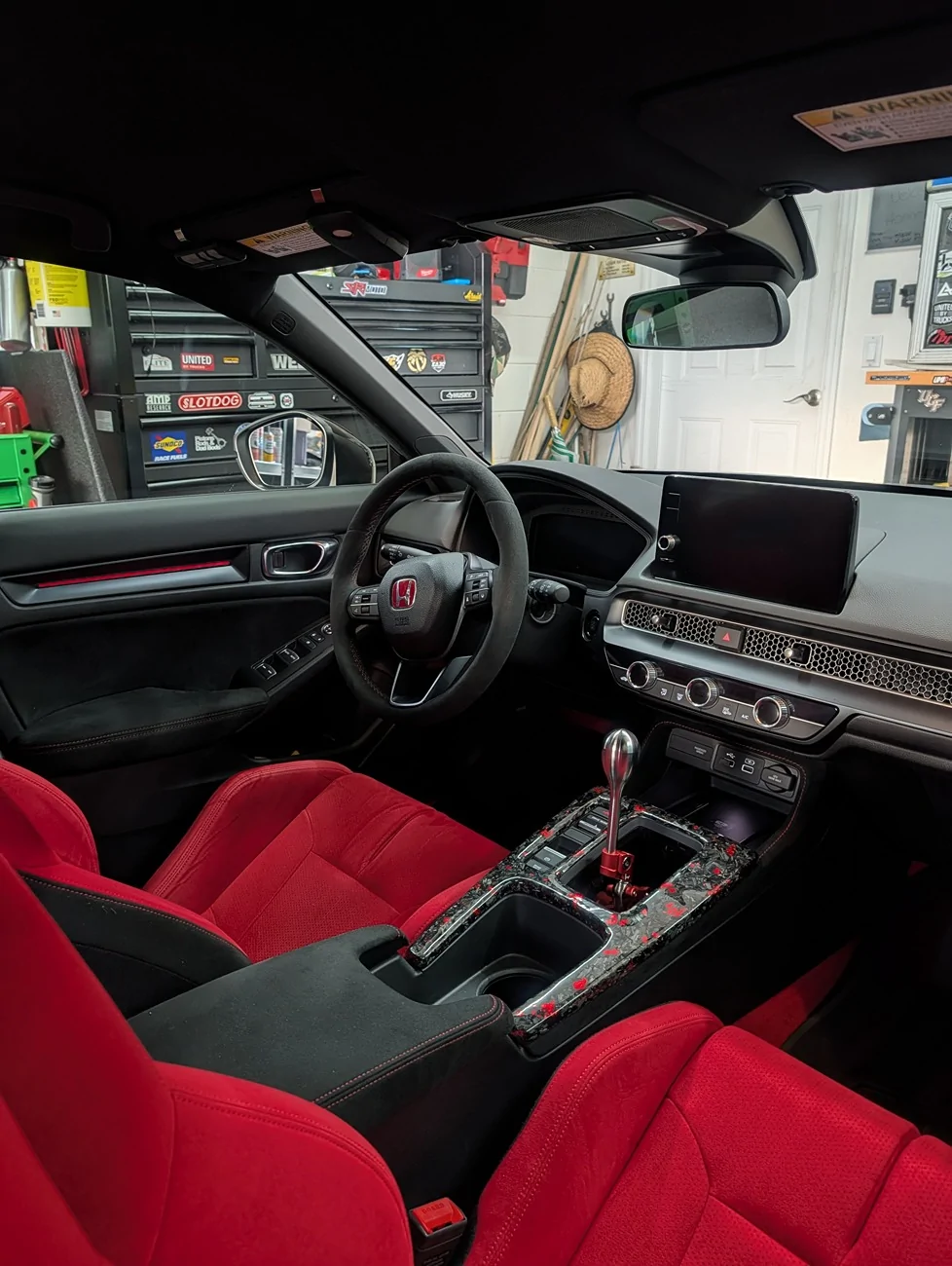

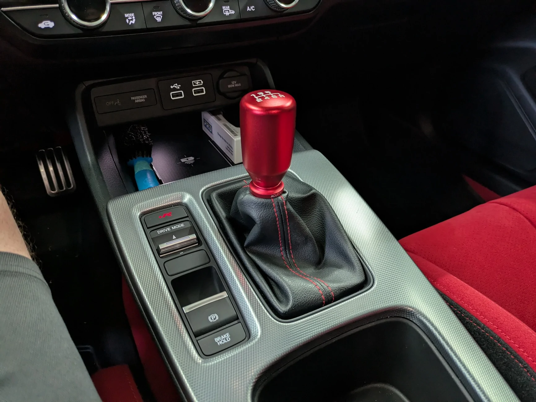

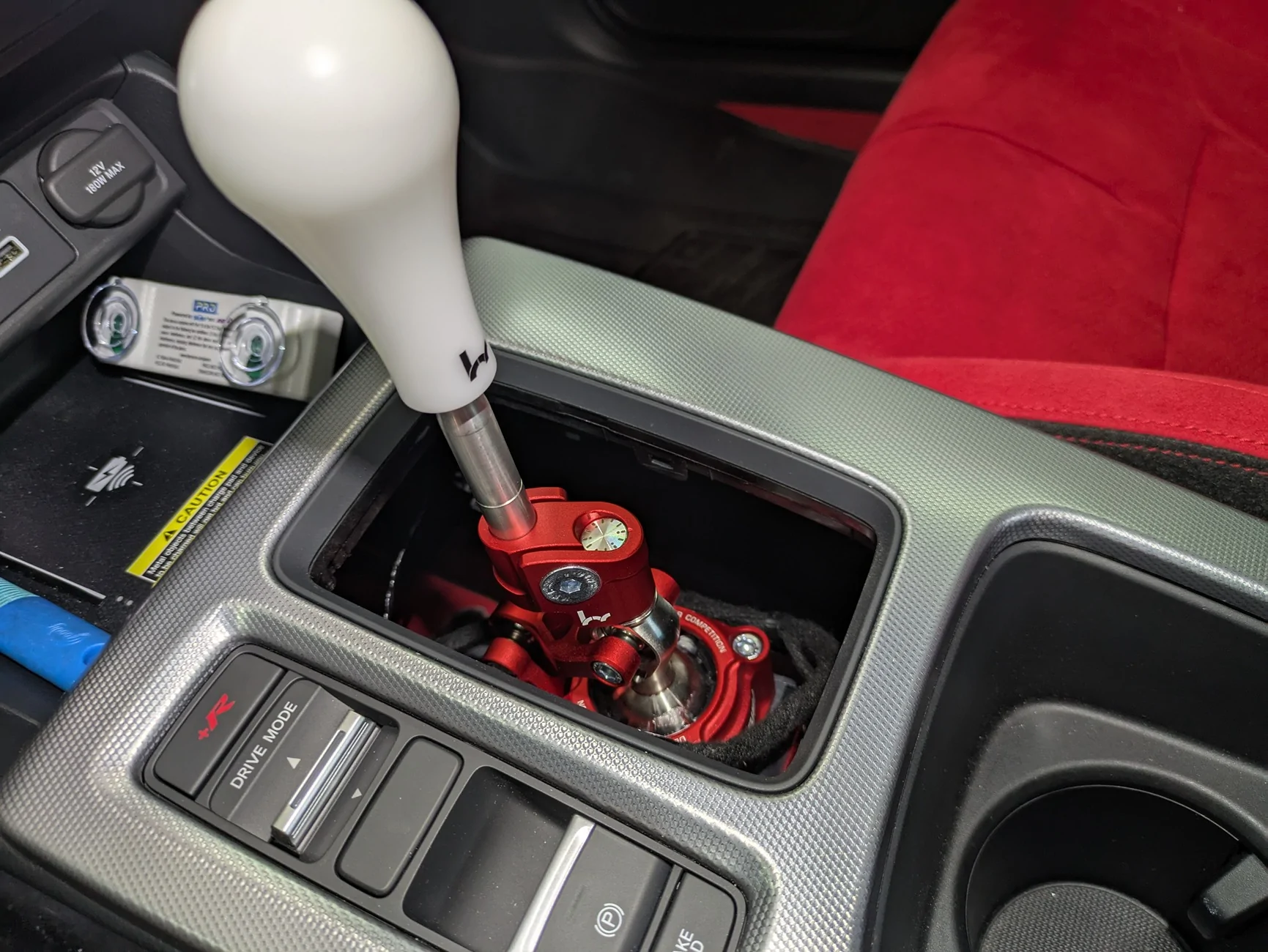

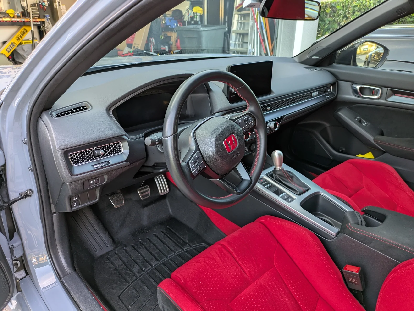

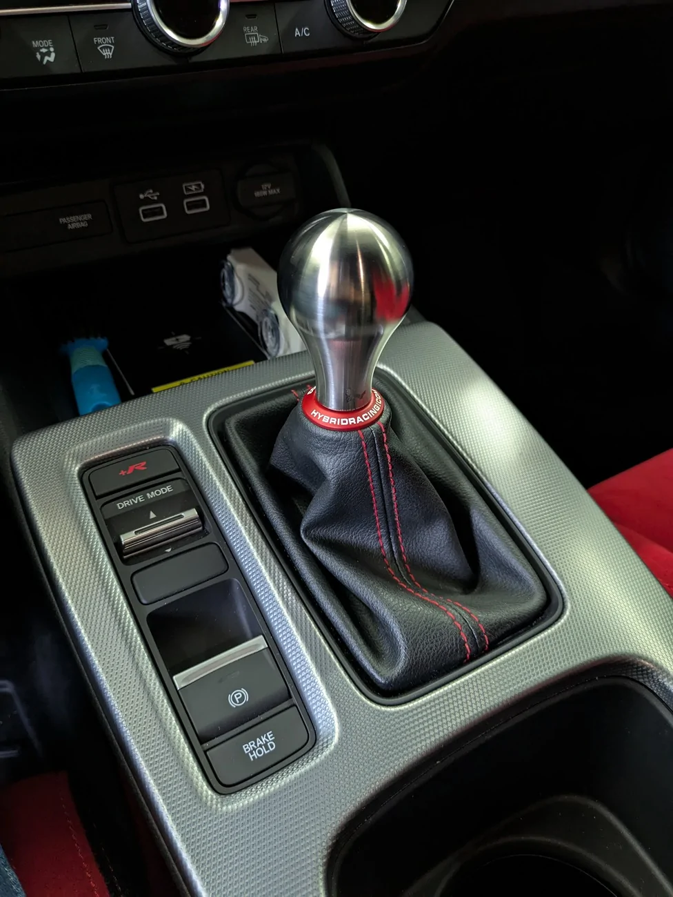

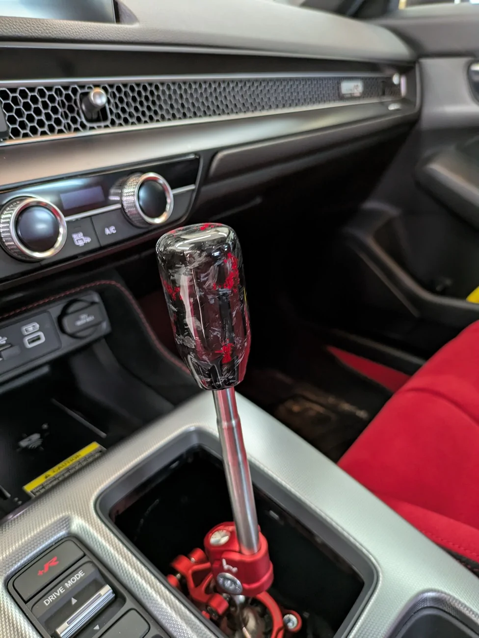

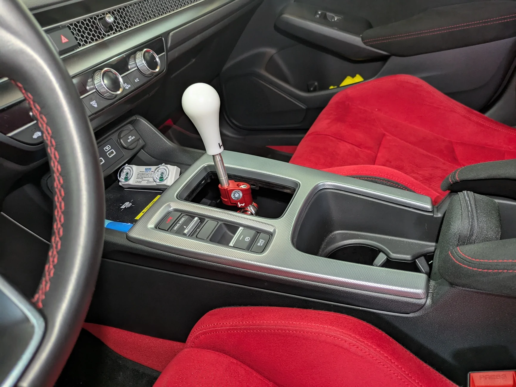

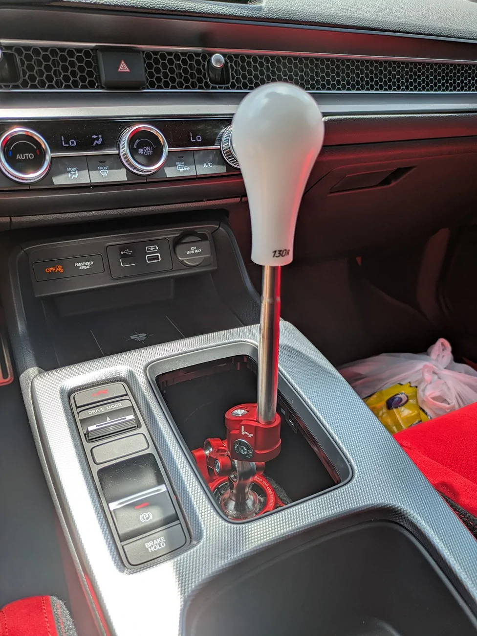

I have gone through a pretty wide variety of shifter knobs, rod lengths and overall shifting components. Thought I would share some pictures.
Current set up is the Hybrid Racing Competition Rod, Hybrid Racing Shifter, Hybrid Racing shifter cable bushings, Hybrid Racing HD detent springs, Spoon braided clutch line, Siri Moto Damper delete, and Clutch Delay Valve delete on the slave cylinder, along with Castrol SRF Fluid (no perceptible change from fluid). I do also run the Acuity gas pedal spacer in space B. This is purely personal preference. I have also adjusted the plunger rod on the clutch pedal.
I have every rod length offered by Hybrid Racing including the Competition Rod.
Longest- 170 mm
Middle- 140 mm
Shortest- 110 mm (this comes standard on the shifter)
Competition rod- 170 mm total height

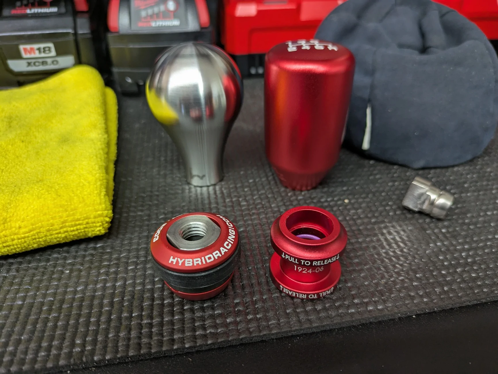

Shift knob weights:

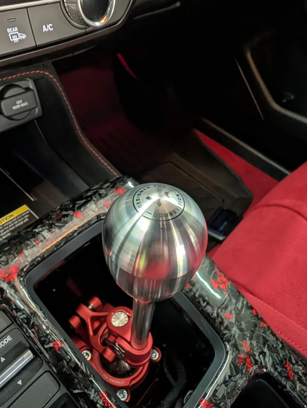

Maxim Stainless Knob- 474 g
Competition Rod Stainless- 607 g
130R Delrin Knob- 103 g
Acuity Esco T6 Knob- 185 g
eBay forged carbon knob- 114 g

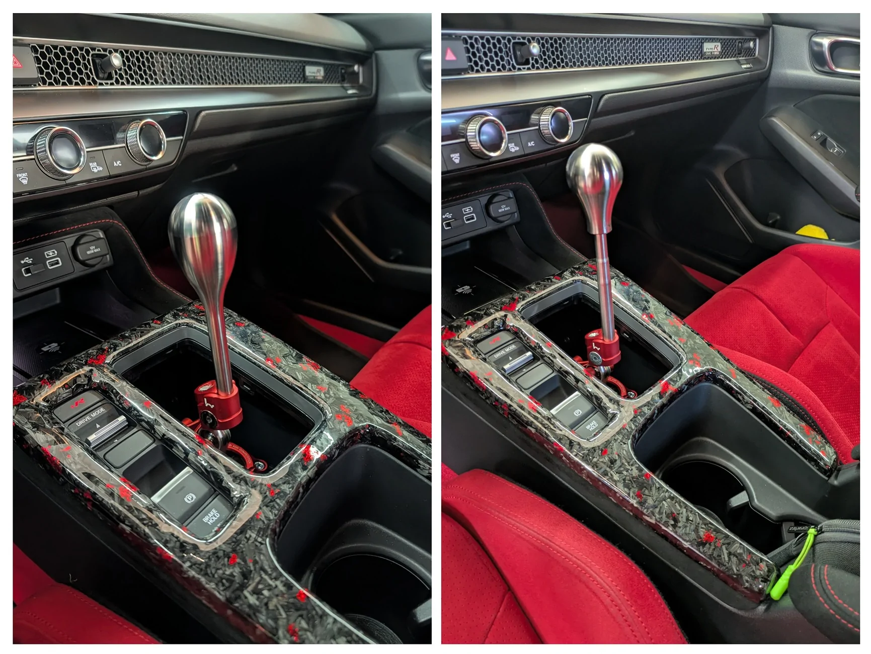

I do like the overall height of the longest shift rod with the Maxim weighted stainless knob but there was noticeably more play in the gear selector in gear due to the increase height of the weighted knob and the leverage that creates. The competition rod is a good compromise on height and overall feel.

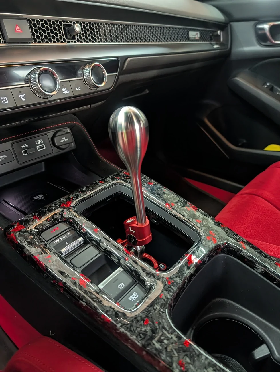

A man on a mission to dial it down. I really like your console. Is that a hydrodip?
I agree with you on the longest rod, but I prefer the lighter shift knob on top.

Its an actual forged carbon fiber overlay piece. I got it through Kplayground. He does alot of other interior and exterior carbon stuff along with cool pull door handles if you wanted to feel all GT3 RS

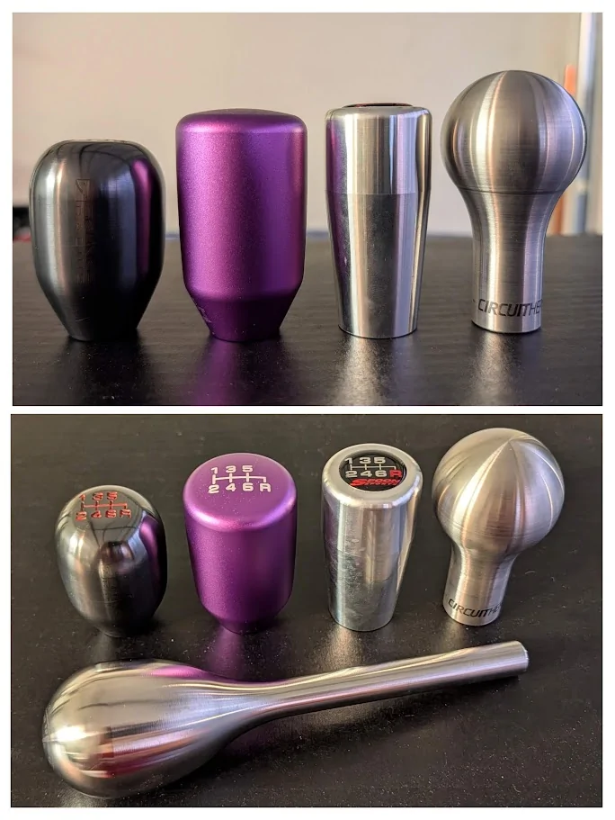

The Competition Rod, Maxim, and Acuity ESCO were all too fat/thick for for my stubby hands. I had a Spoon knob, but it was too skinny. I feel like Goldilocks. 👧 After I sold most of them, I cycle between Skunk2, Circuit Hero Type B, and HawkDown (BattleCraft copy).
Shift Knobs are the funnest thing to buy and try out on a car. Such a small thing can make all the difference.
I have always wanted the Circuit Hero B. I always had an eye on the Likewise stuff also.

I like the Circuit Hero Type B. Generally I don't like ball-shaped knobs, but the Type B's tapered neck makes it comfortable. The Circuit Hero looks taller, but it is countersunk 15mm. The others are not.
