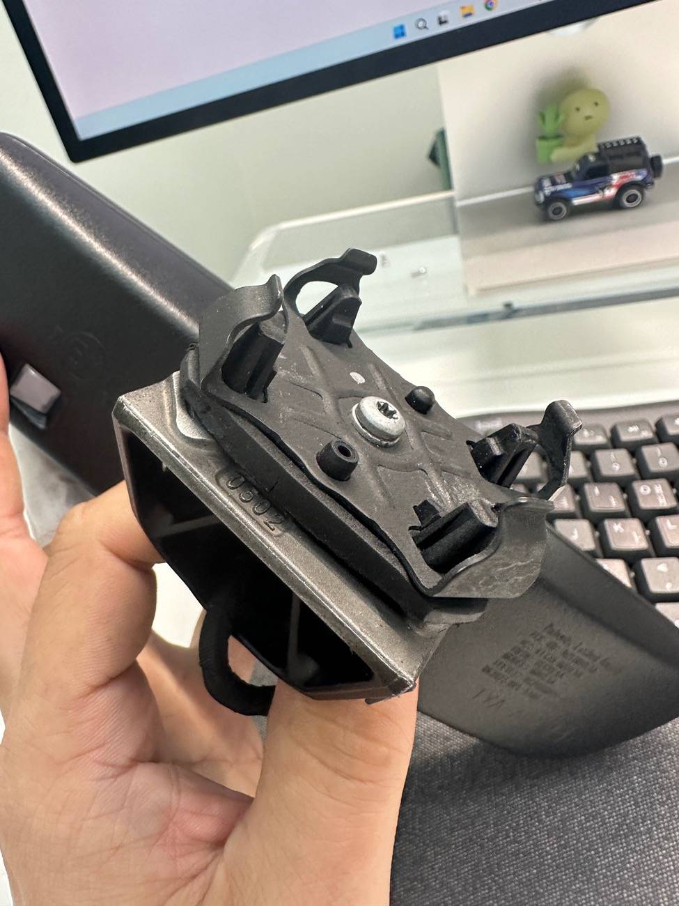

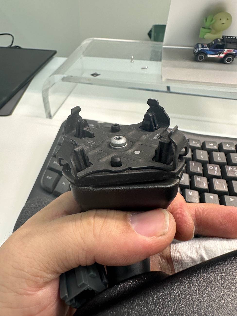

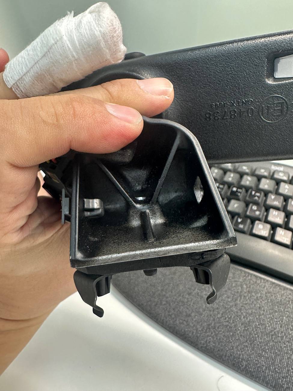

sorry to hear that. I tried driving around with just the mirror without all the harnesses installed, and the vibration in the mirror (especially with the new exhaust) is too much for my liking. I'm planning on cutting off the baseplate of the civic mirror, grinding down the accord baseplate, and attaching the two together. I think i'll use epoxy loctite, but I have no clue if it'll work. I'm sure some people might want to see how it turns out, so i'll post pics once it's all said and done.

Just removed the base off the civic mirror. Not the cleanest job but plan on sanding it down so it’s nice and flat
