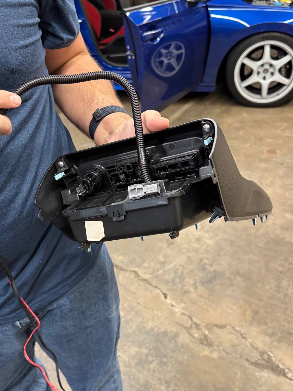

I think it really varies between people.. mine vibrated and wasn’t tight fitting. I DIY’d it and it’s extremely tight now. No vibrations at any rpm, but it was a pain to get done. Basically had to cut the top 1/2” of the top of the original mirror base and put it on the new mirror. But happy with it

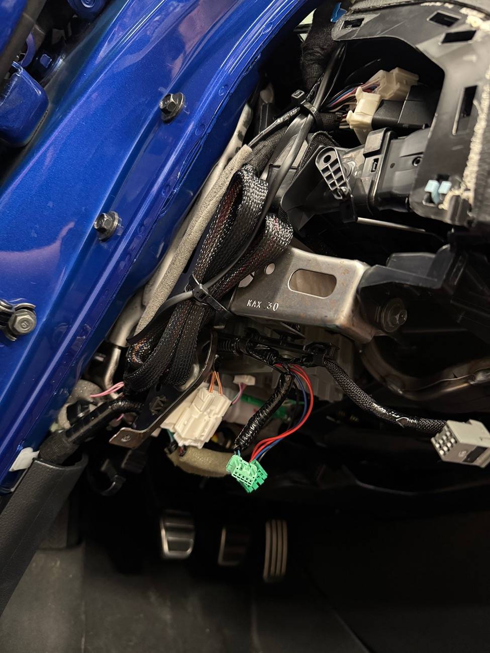

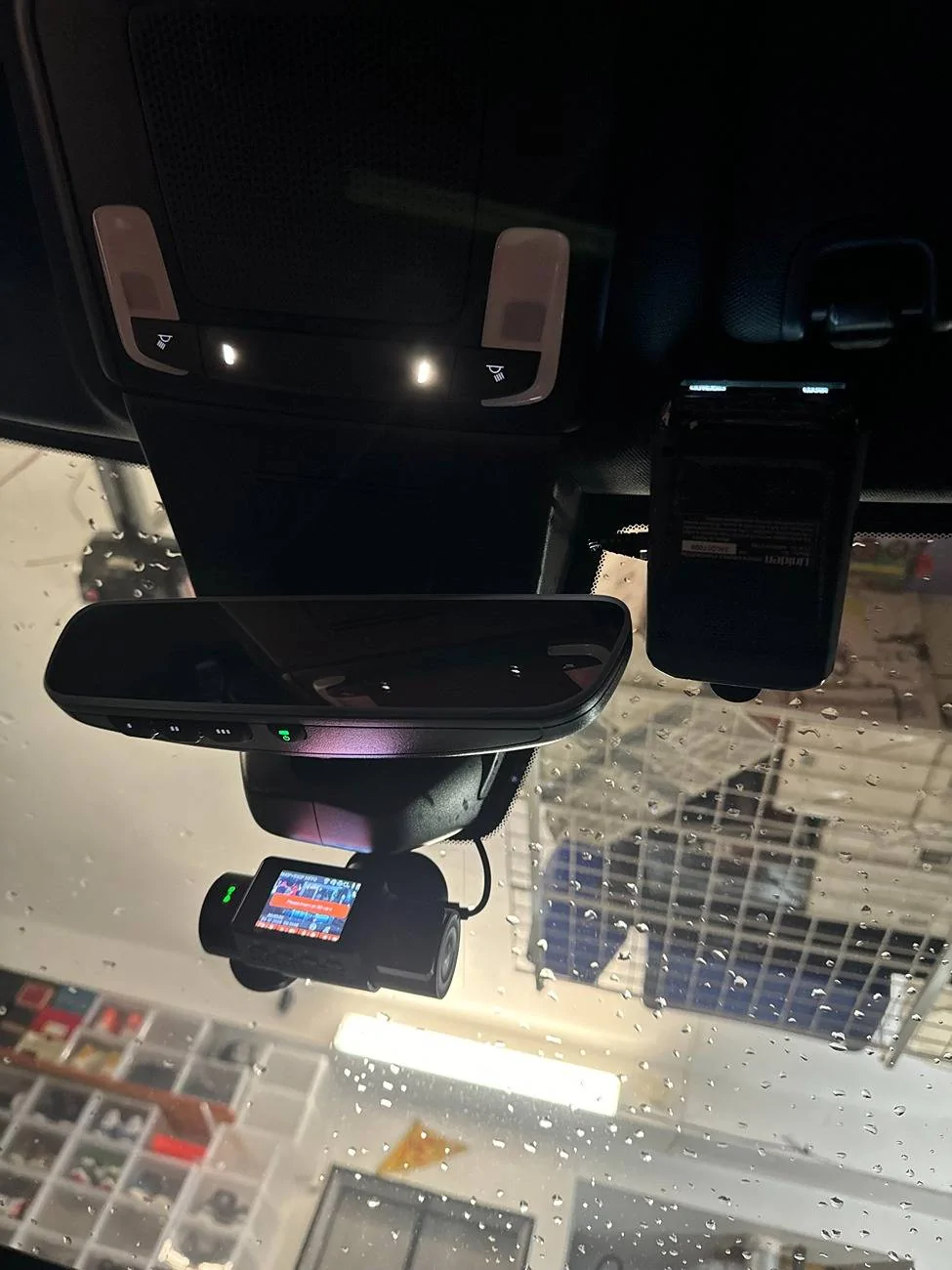

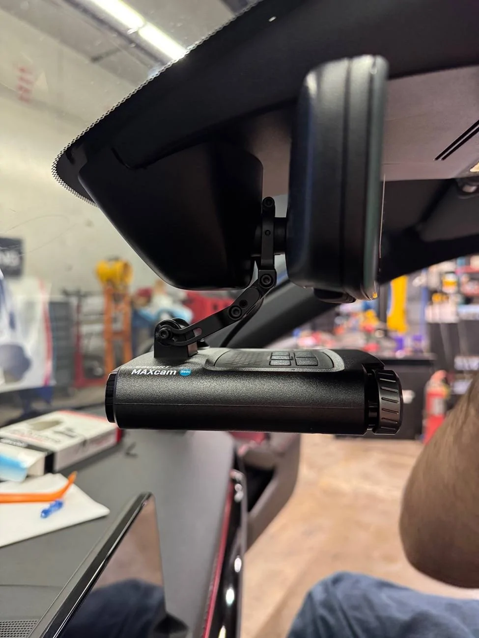

Another confirmation that this kit works for the Civic Si (2023). Love the setup! Went driving last night to test the auto dim/anti glare…totally worth the hassle! Took us ~2.5 hours to complete; I took the car apart and put it back together while I let my s/o handle wiring & cable management (his day job so he is way better and more efficient at that than me, lol).
We took the time to mount & hardwire my Escort Max Cam 360C so it would look cleaner and not fall off my windshield. I had the EZ Mag suction cup before, but he got me a BlendMount, and it looks SO much better. Good fit with the mirror, too.

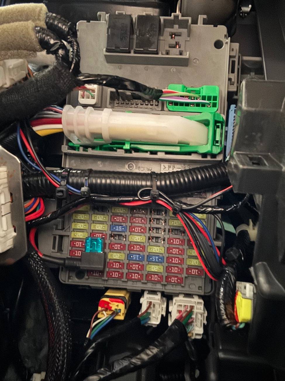

Had an issue with a 20A & 15A fuse not being where it was supposed to be even after referencing the guide provided.. (haven’t touched the fuse box down there since I bought it) so I will include a few photos in case it helps anyone!
That A pillar clip though. My god.

No way! I happen to have that very one sitting in a drawer! Do you happen to remember if you required the nylon bushing or not? I do not have those anymore, but they are only $5.
Talk about luck! Yes, to prevent rattling

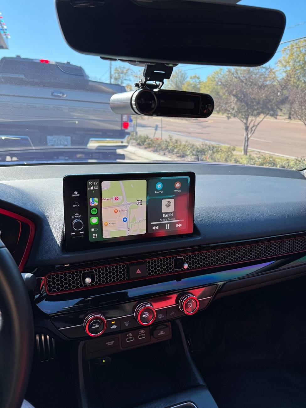

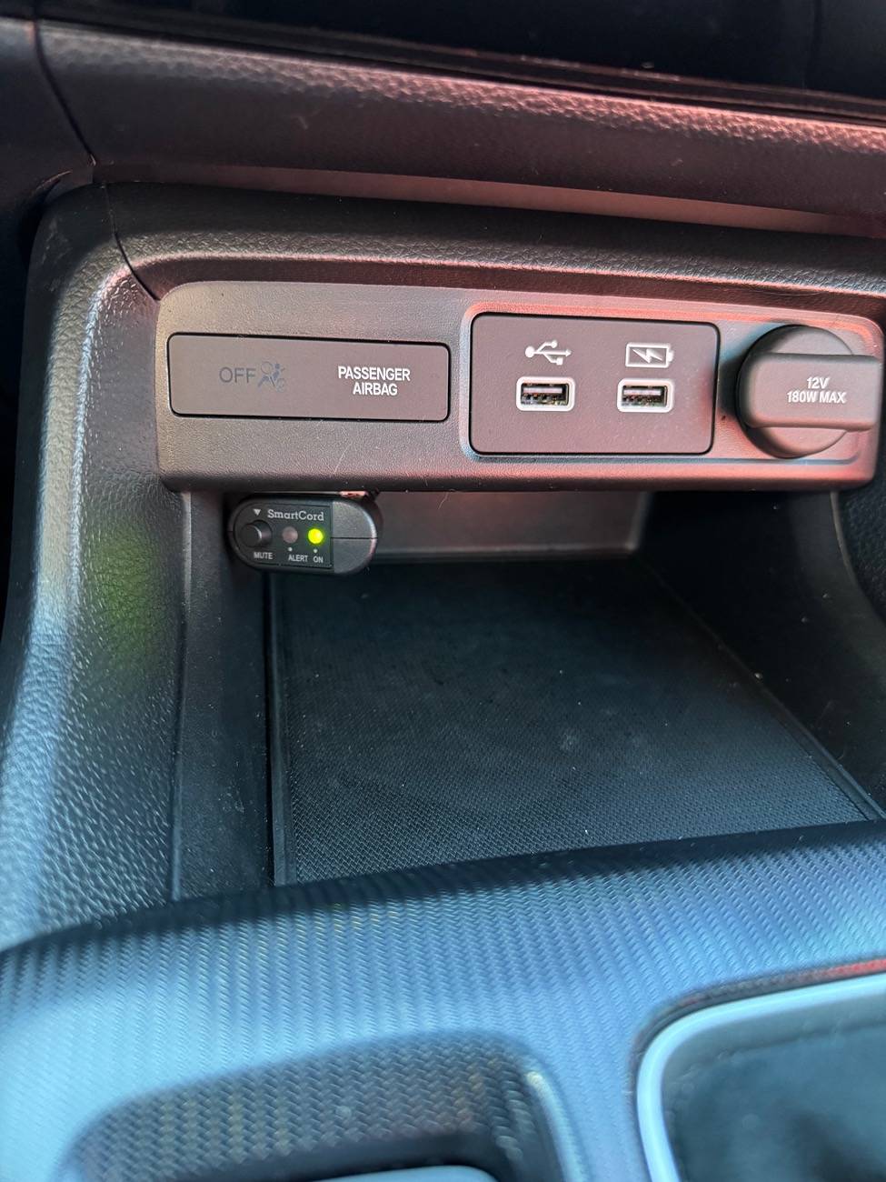

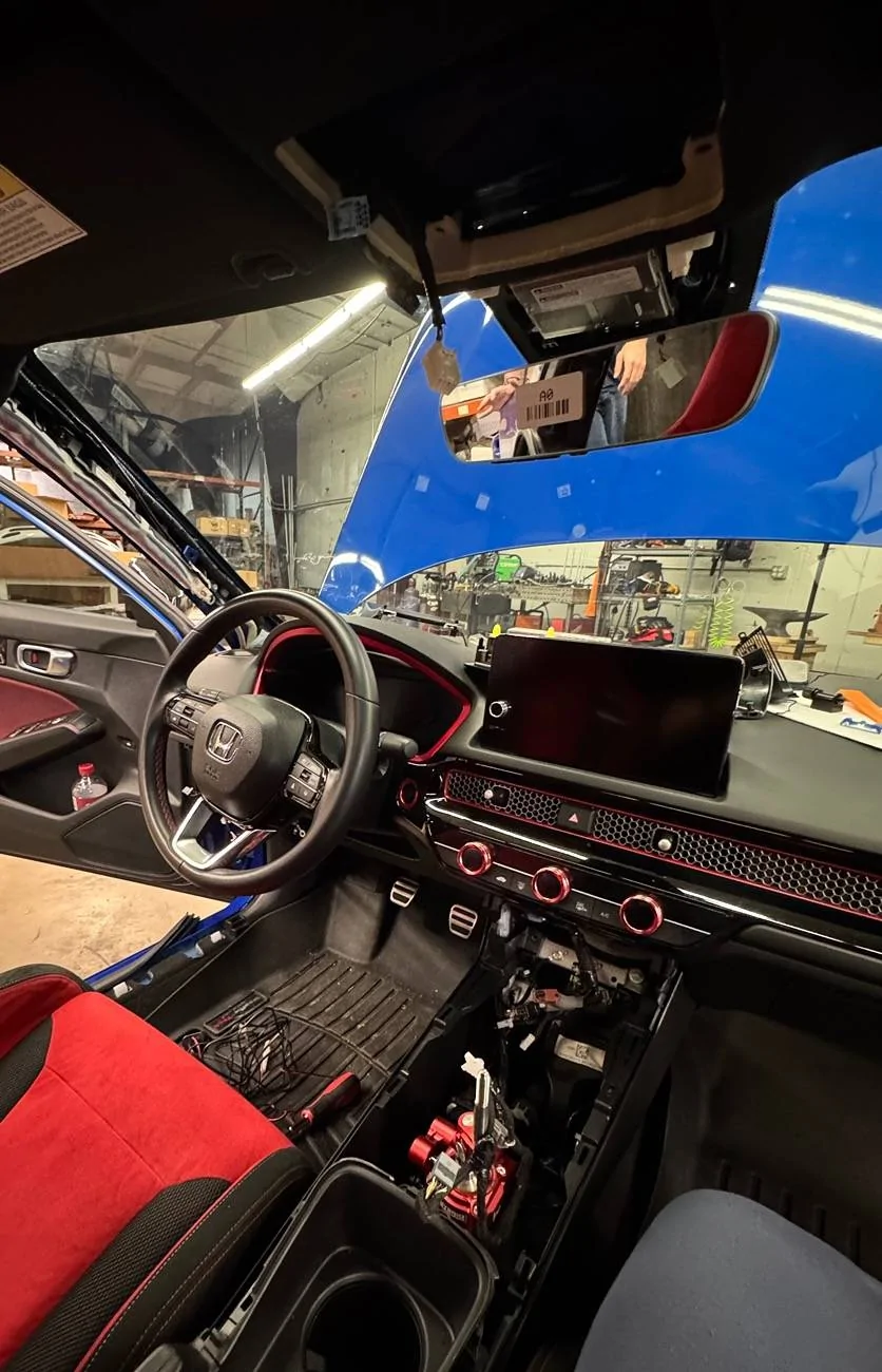

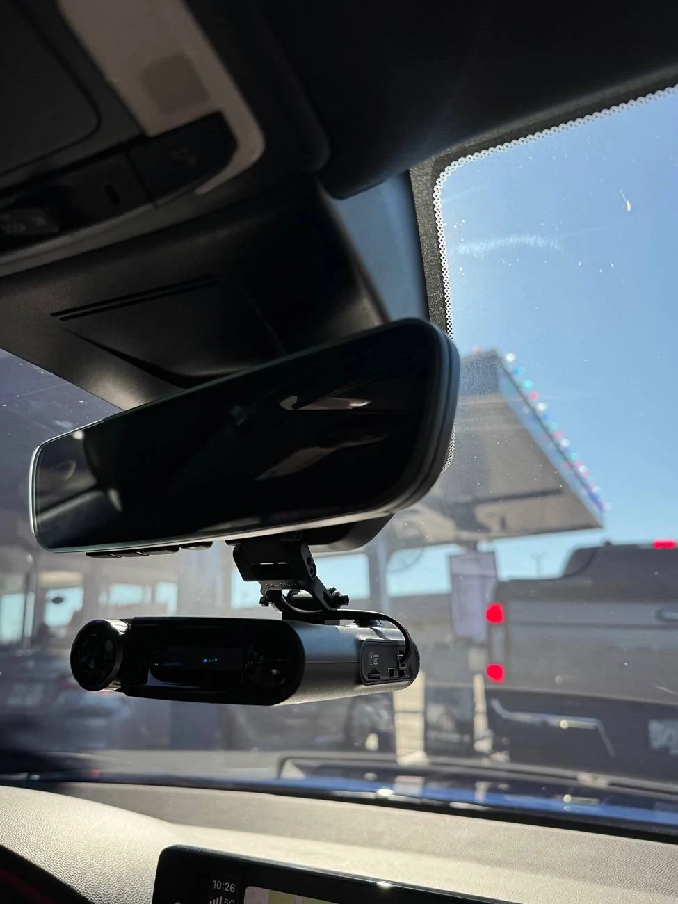

Just finished my install. Took about an hour and a half. I also installed the mirror tap for my radar detector / camera.
First attempt when I tilted the mirror down it popped off. I then bent all of the retaining pins in a bit. Reinstalled and it was much much sturdier. I don’t see it popping off now.
Driving I may get a tiny insignificant amount of wobble. But it’s so minor I doubt I would have noticed unless specifically looking for it.
Trim pieces all came apart easily and popped back without issue.
I did have a minor issue with what appears to be a mfg defect with my door seal. I am going to watch it and will address with Honda if it becomes a problem.
programming was easy, all in all $250 well spent.
