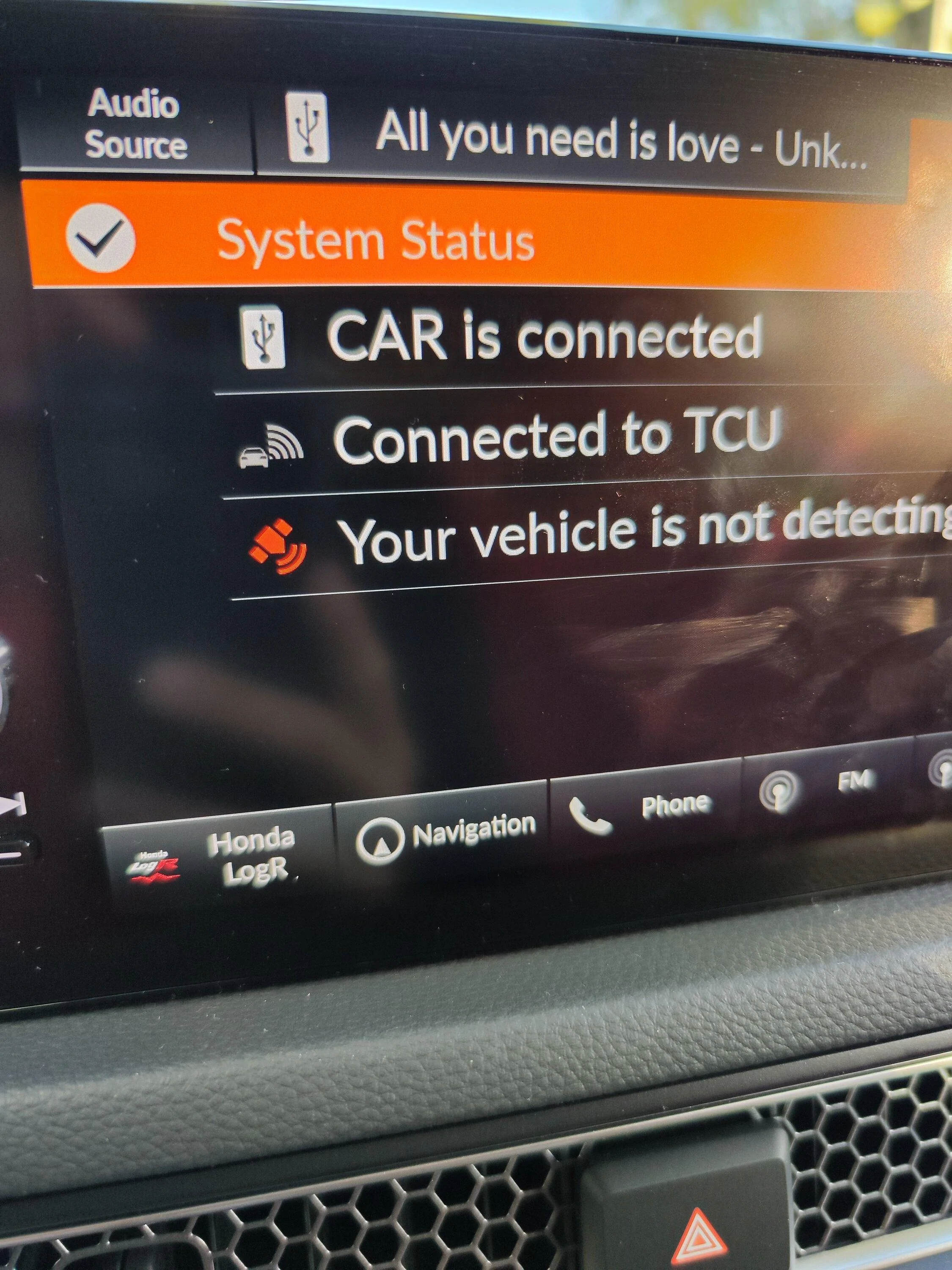

hi man! Here is picture with the TCU connection I meant. I believe the manual specifies that connection must be established for the mobile sync of LogR2.0, but I might be wrong. Hope it helps!
11th Gen Honda Civic Regarding the problem of connecting the logr with the mobile phone, the pin code cannot be displayed IMG_20230713_204251
This status display opens up by clicking on the top right of the screen.

Hi man! I might have made a typo and it is actually TCU. (telematics control unit), it might be related to how the car communicates with the server when enabling the logR. I will capture a snapshot of the user manual and send it, here in Spain the type R gets a dedicated user manual.
Any luck so far?
