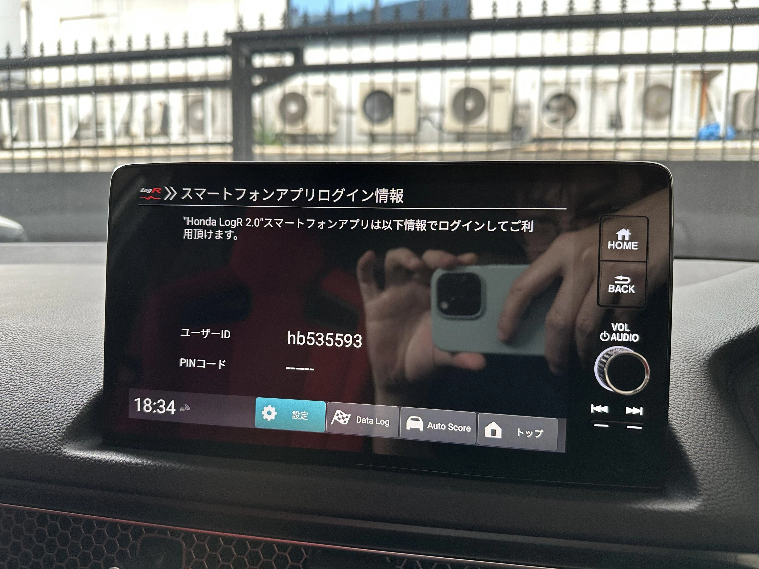

As shown in the picture, the pin code is blank. I don't know how to connect it with a mobile phone. Has anyone successfully connected to LogR through a mobile phone? How to do it?

Update, I have found the problem why the pin code is not displayed, it is necessary for the car system to connect to a Wi-Fi, and then open LogR to display the pin code, but after I use the phone to enter the id and pin code, but still can not connect. How can I solve this problem next?

I've honestly never had this problem. I would just reset the head unit to factory conditions and try again. Idk about the international models, but here in the US it doesn't require a Wi-fi connection
There is this possibility that the logr system in the host is optimized according to the country? Because I'm in Thailand, my car is the native Japanese version, imported over. Not a Thai Honda car.

hi, I am having the same issue. No pin displaying beyond "------". I took t for a drive to make sure car was warm and I had TPU connection and tried using a cable to my android phone and no luck. Is anyone else experience the issue and managed to solve it? Thanks a lot!
In fact, as soon as your car system is connected to wifi, your logr pin code will appear. But the problem is, after the phone entered the id and pin, it keeps showing that it can't connect to the server. I'm confused as to what principle is used to make the car's logr and phone logr connection.

I am not sure I follow when you mention wifi. Are you connecting the car to a wifi network or just ensuring the TCU connection is established? (icon on the top right of the screen). I have performed a factory reset today, I will try it again later.
Can you please describe what you changed to get the pin to be populated? Thanks!

Hi all, I got the app working yesterday and I did some custom lap test on a roundabout. Here are the steps I followed.
1. connect the phone to android auto via usb cable
2. turn on wifi hotspot from smartphone
3. connect infotainment unit to the wifi from smartphone
4. donwload last version of LogR 2.0. Connected via username and pin and volia!
thanks SaVitar for the tips! I was not understanding it the first time you mentioned wifi.

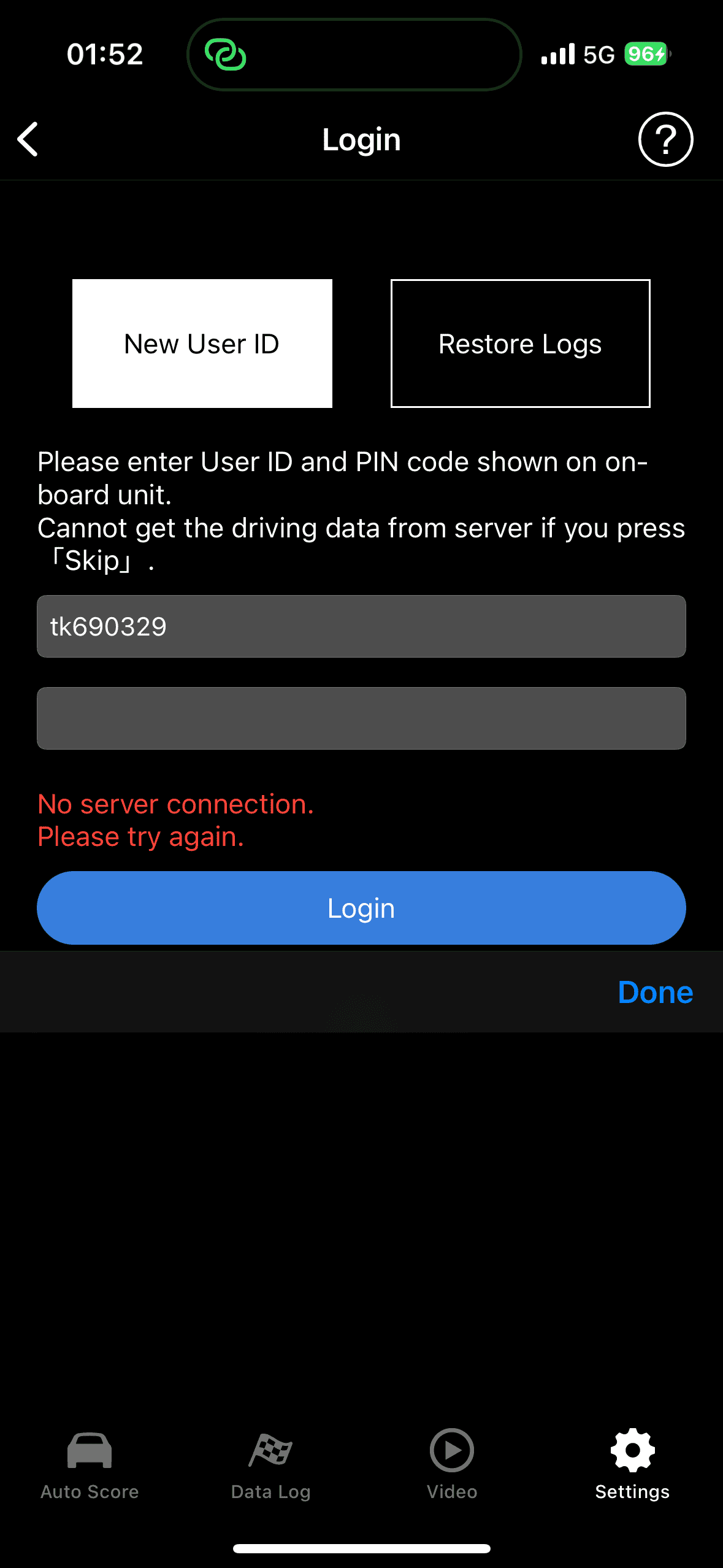

I have followed your steps to the letter, but unfortunately, I still can't connect. I don't know exactly what is wrong.
