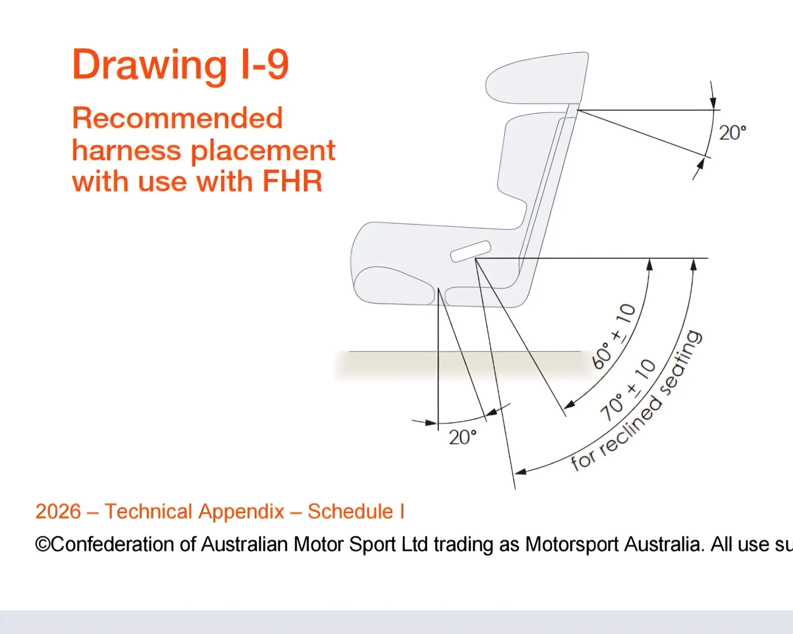

10000% not safe to mount shoulder straps to the floor.
Always refer to FIA standards for harness mounting. It specifies recommended strap angles and method of mounting/anchoring.

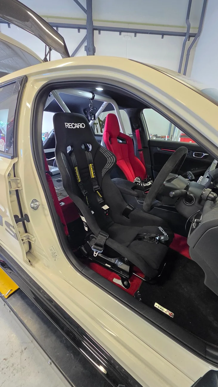

11th Gen Honda Civic Spoon floor brace with mounts for 4 point harness safe? 20260628_144052
11th Gen Honda Civic Spoon floor brace with mounts for 4 point harness safe? Screenshot_20260714_080104_Chrom

I am of the opinion that a full harness is only truly safe if used in conjunction with a frontal head restraint (hans or similar), and be tied in with at least a half cage.
If you're just wanting to be better supported while negotiating lateral forces just run a better fitting seat that matches your build/body shape with the OEM seat belts IMO.
