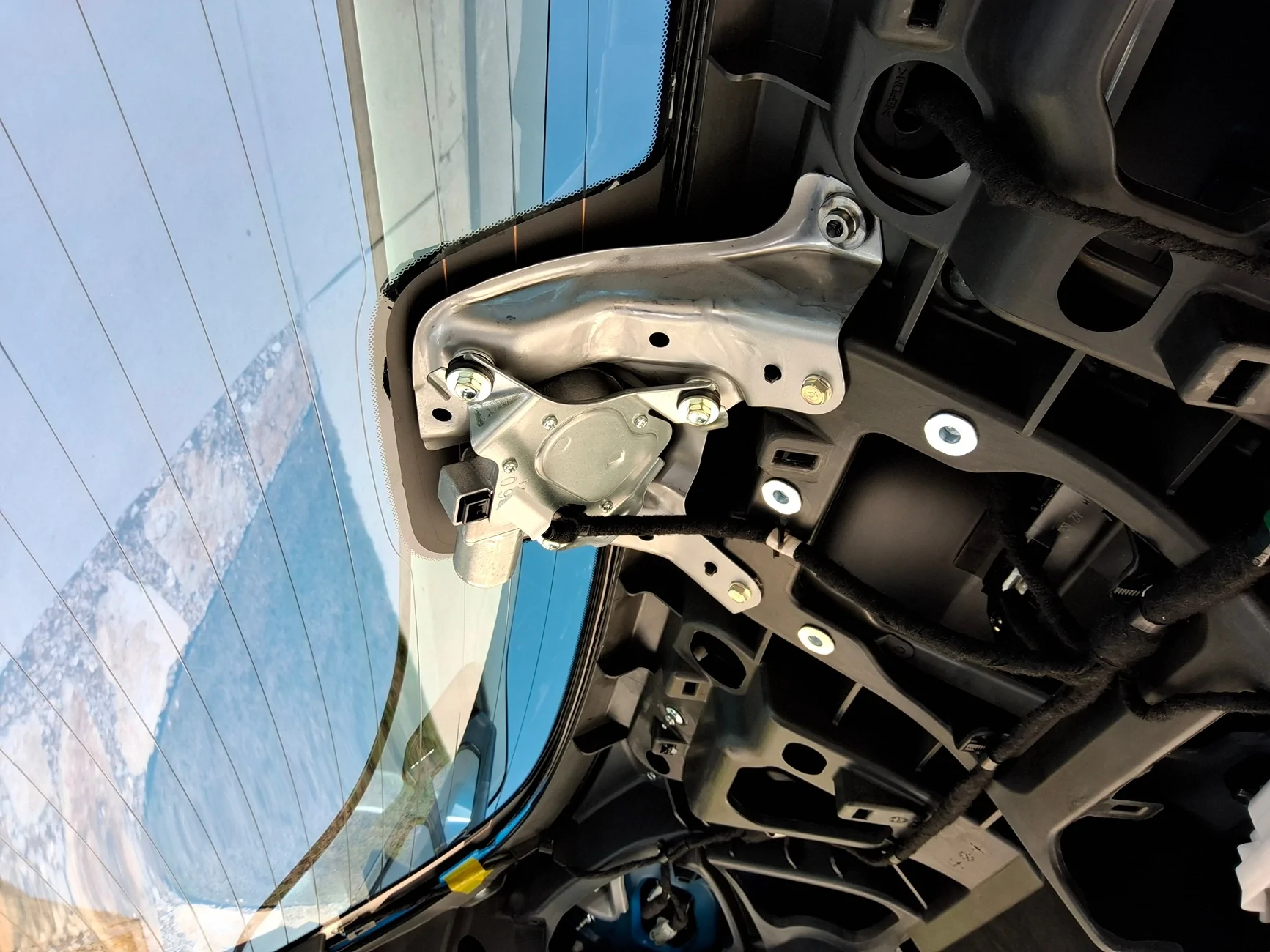

September 2025.

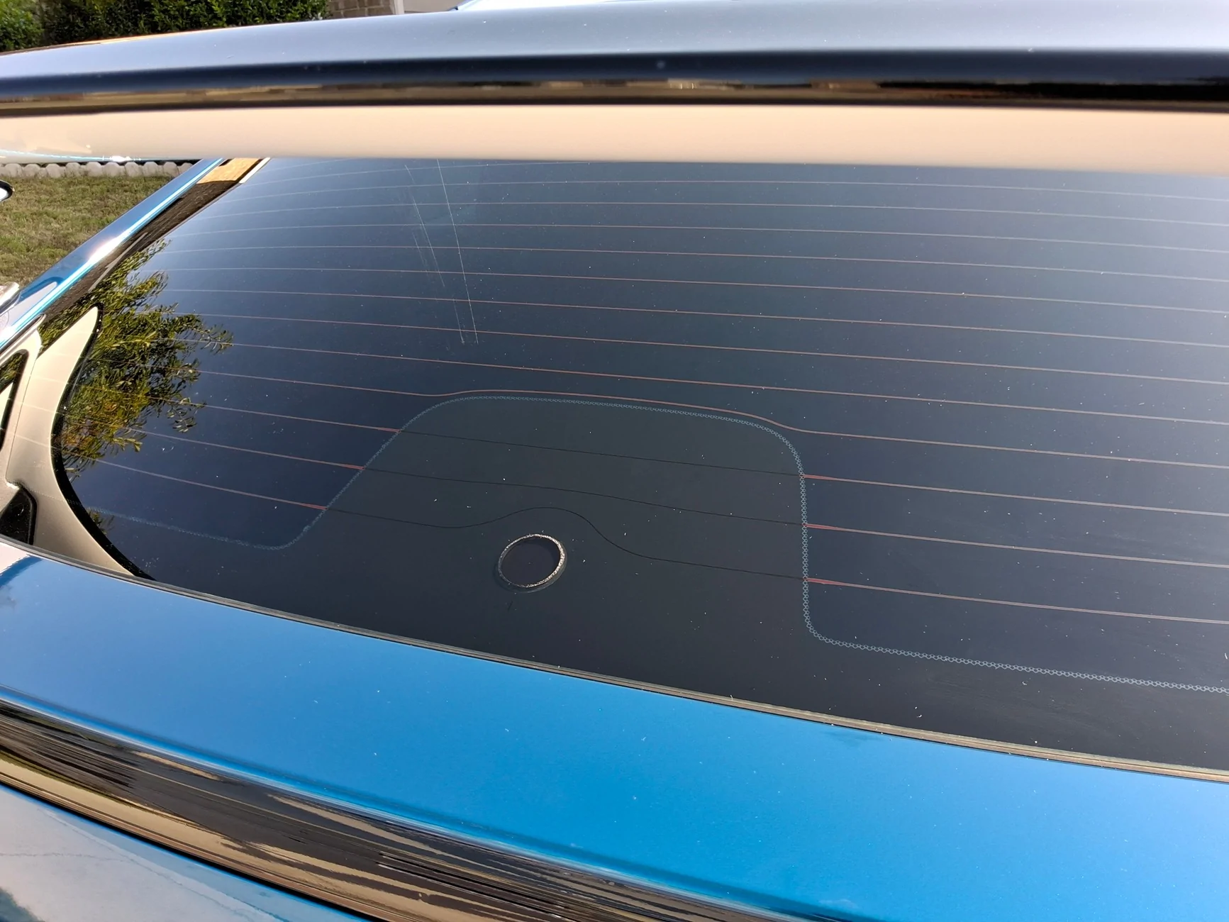

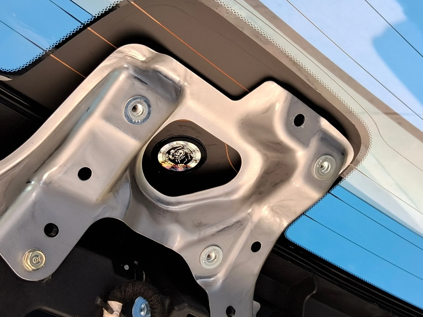

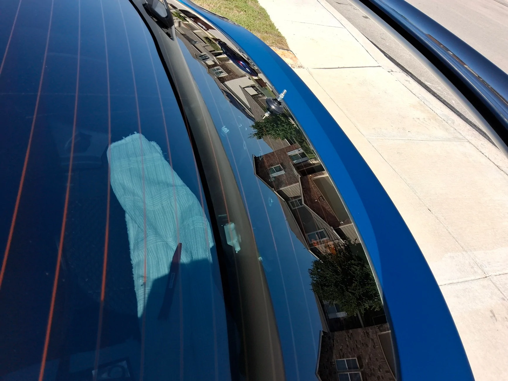

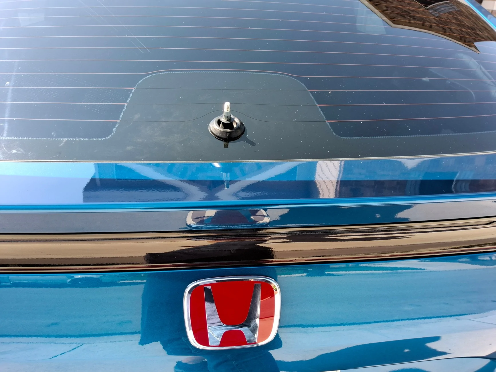

Finally deleted my Rear Wiper!!!
Installed the acrylic Kill All Wipers Rear Wiper Delete Kit. Made in England.
Kit purchased at the Dream Automotive website.
11th Gen Honda Civic Sporky SideGrades Texas FL5 Type R 20250909_115410
11th Gen Honda Civic Sporky SideGrades Texas FL5 Type R 20250909_115423
11th Gen Honda Civic Sporky SideGrades Texas FL5 Type R 20250909_115433
11th Gen Honda Civic Sporky SideGrades Texas FL5 Type R 20250909_173920

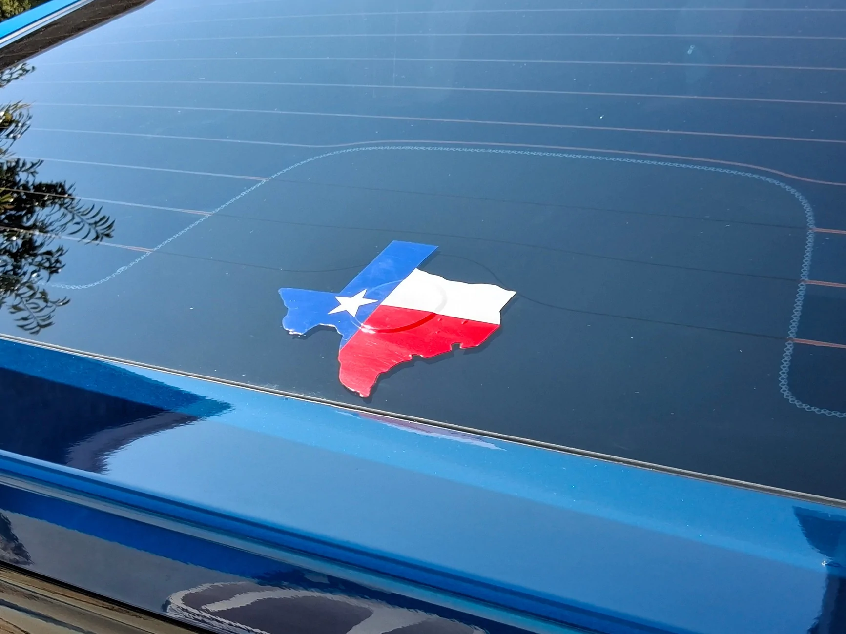

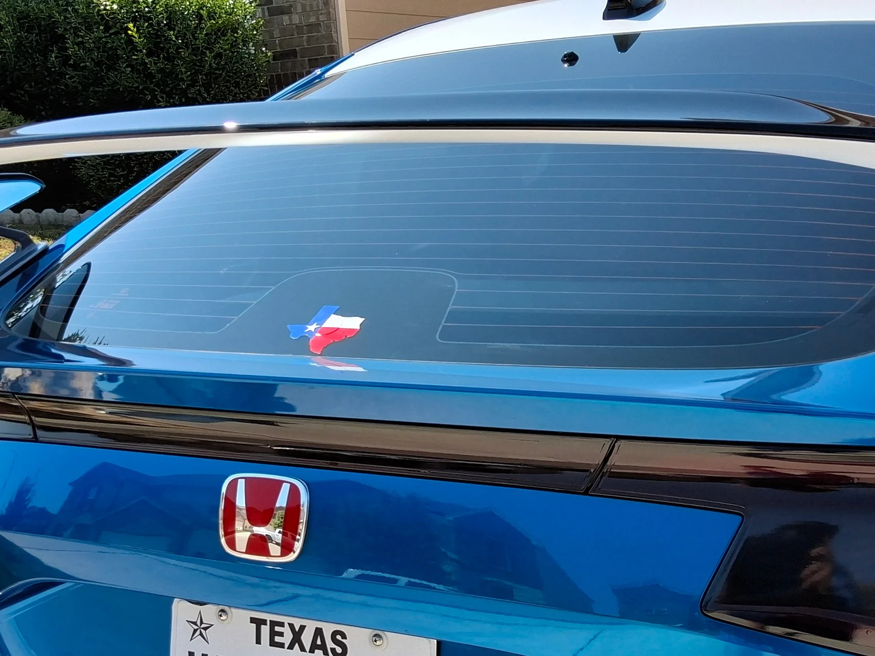

My cleanup work was a bit sloppy...
11th Gen Honda Civic Sporky SideGrades Texas FL5 Type R 20250909_173953
... so I slapped a vinyl Texas sticker over the delete plug.
Up close, you can see that the plug is not 100% flush, and is about 1 or 2 mm higher than the glass.
Also, I went a bit heavy on the bubble squeegee, and ended up tearing off the Southern tip of Big Bend National Park.
Whoops!
(In my defense, the sticker is super thin and ripped with just a bit of stretching. I may replace in the future.)

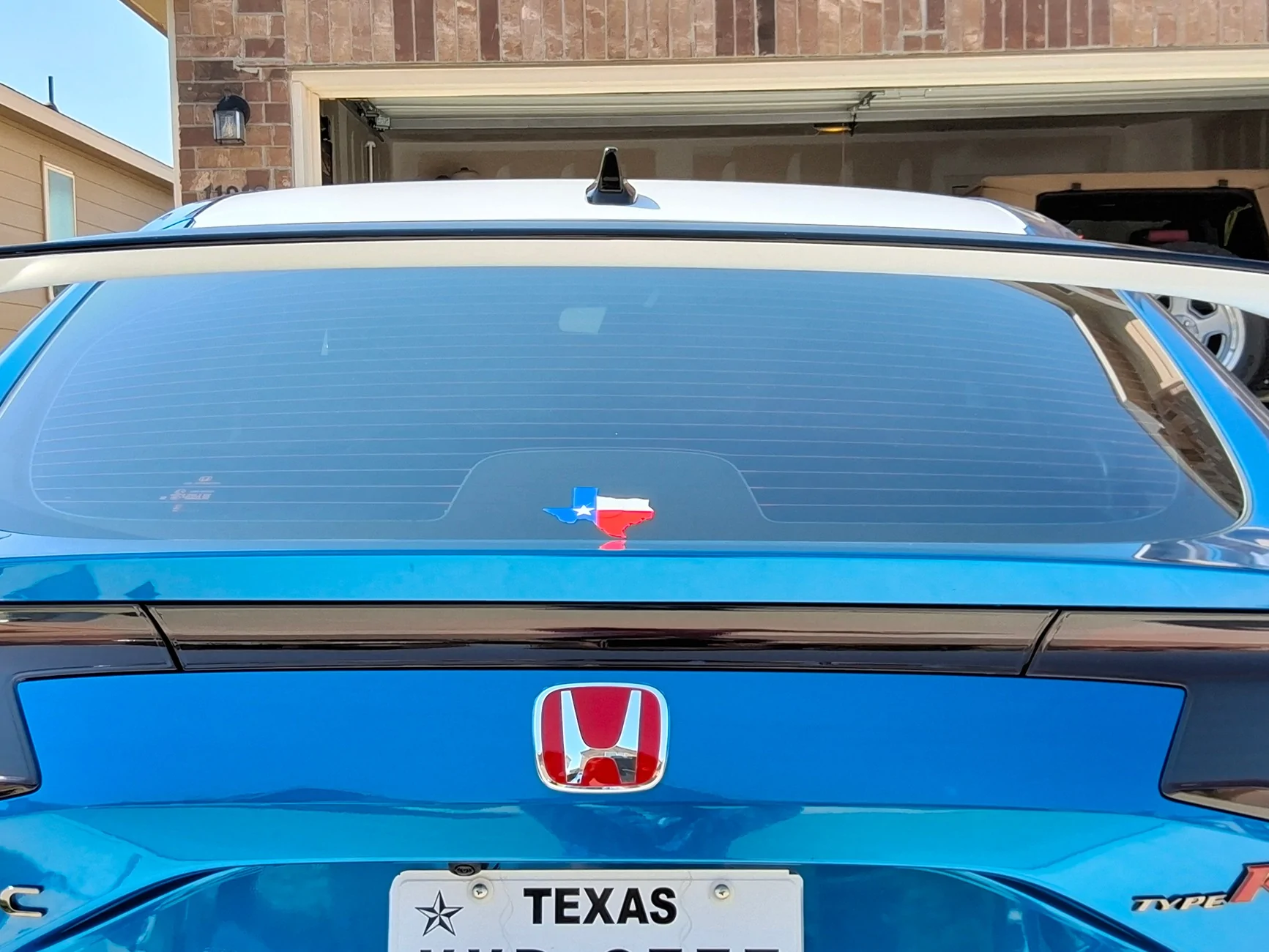

At a distance, I think the Kill All Wipers delete plug covered with a sticker looks pretty nice.
11th Gen Honda Civic Sporky SideGrades Texas FL5 Type R 20250910_114010
No more pesky rear wiper for me.

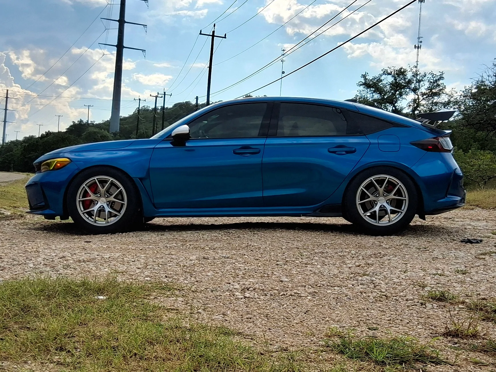

December 2025

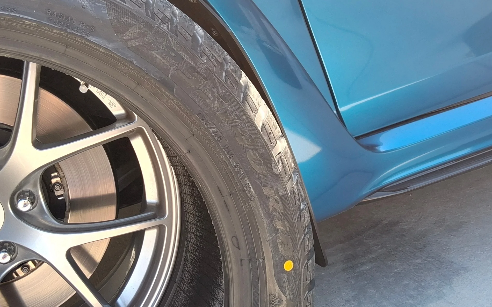

"Winter" wheels and tires.
Because Arctic and glacial Texas is buried under snow and ice for 3 months straight every year.
I want to give a shout out to @SeanMcc23 for giving me the idea to install Honda Pilot wheels in the first place. What's up, Sean!
Check out Sean's thread here:
Installed 18X8.0" , ET+50 Honda Pilot Matte Bronze HPD wheels, over Eibach 20mm spacers, wrapped in Pirelli Winter Sottozero 3 tires, size 255/40 R18.

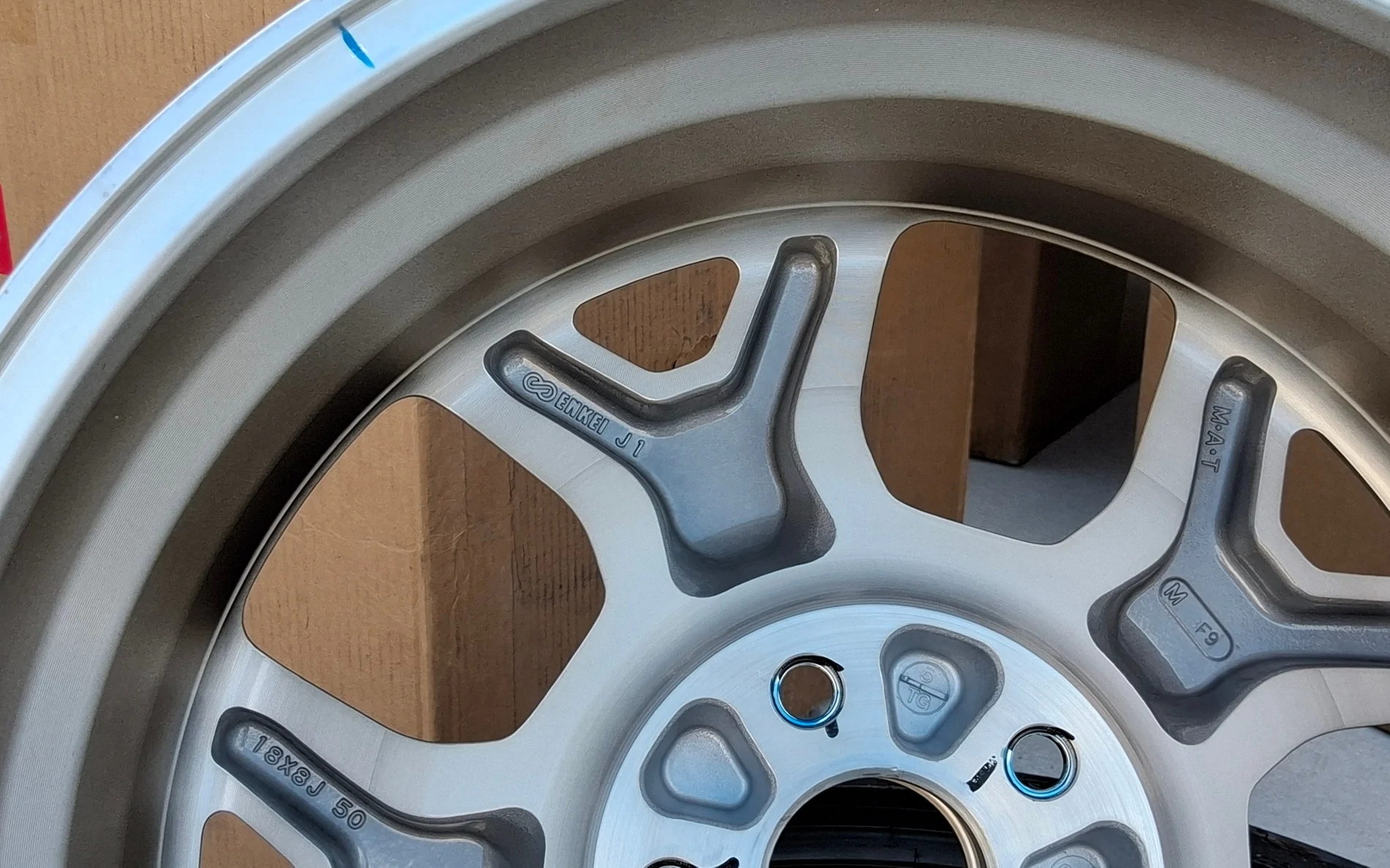

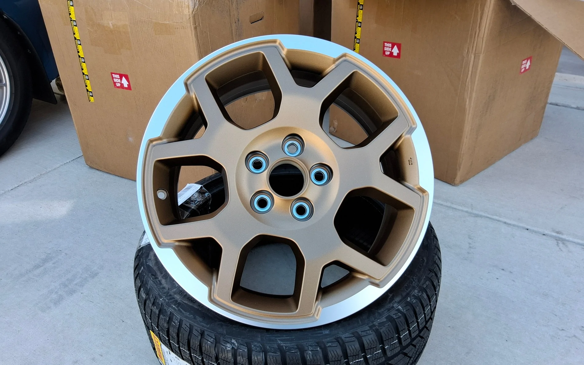

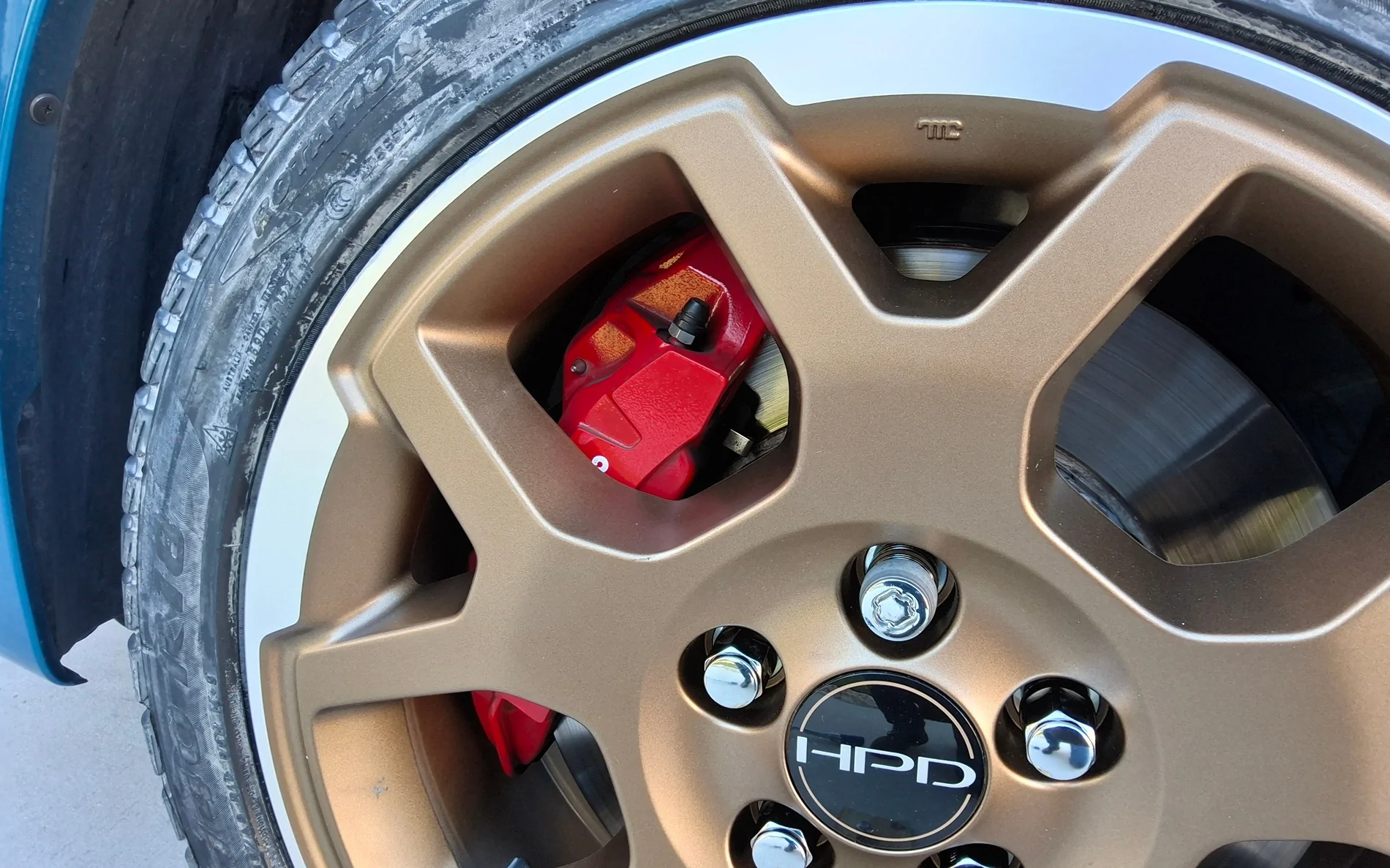

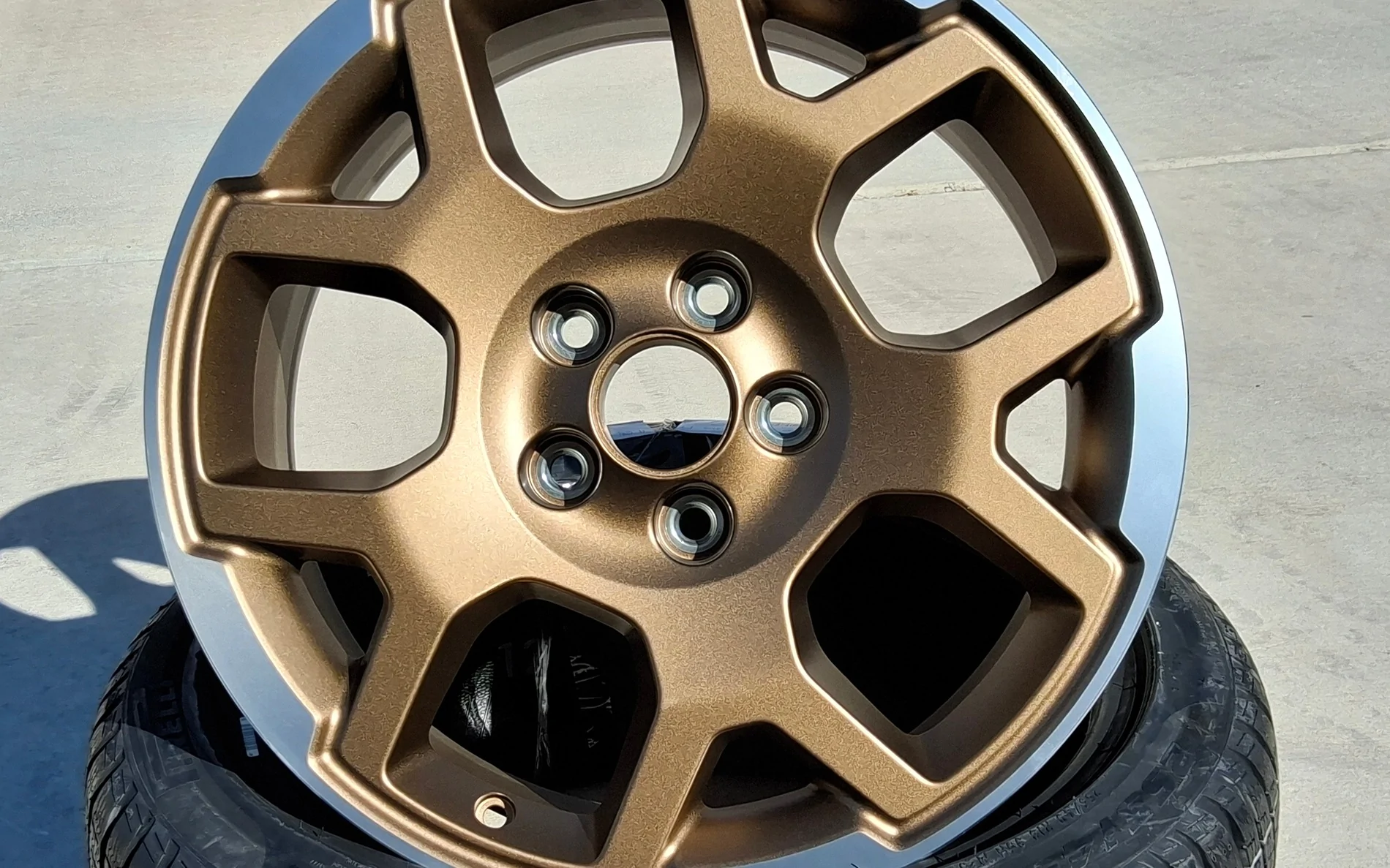

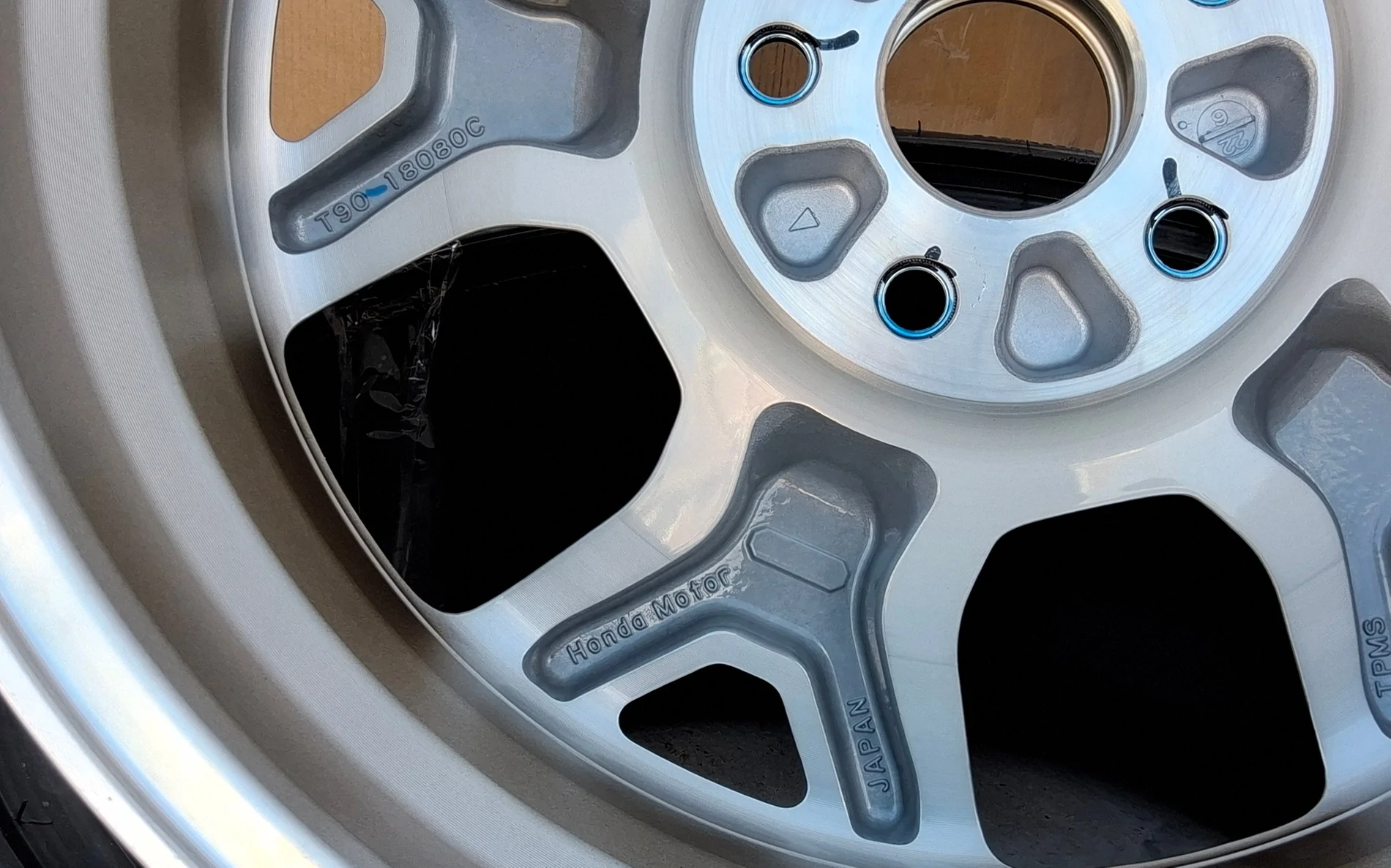

The wheels.
These Honda HPD wheels are actually made by Enkei.
11th Gen Honda Civic Sporky SideGrades Texas FL5 Type R 20251114_114447
11th Gen Honda Civic Sporky SideGrades Texas FL5 Type R 20251114_114549
11th Gen Honda Civic Sporky SideGrades Texas FL5 Type R 20251114_114540
11th Gen Honda Civic Sporky SideGrades Texas FL5 Type R 20251114_114829

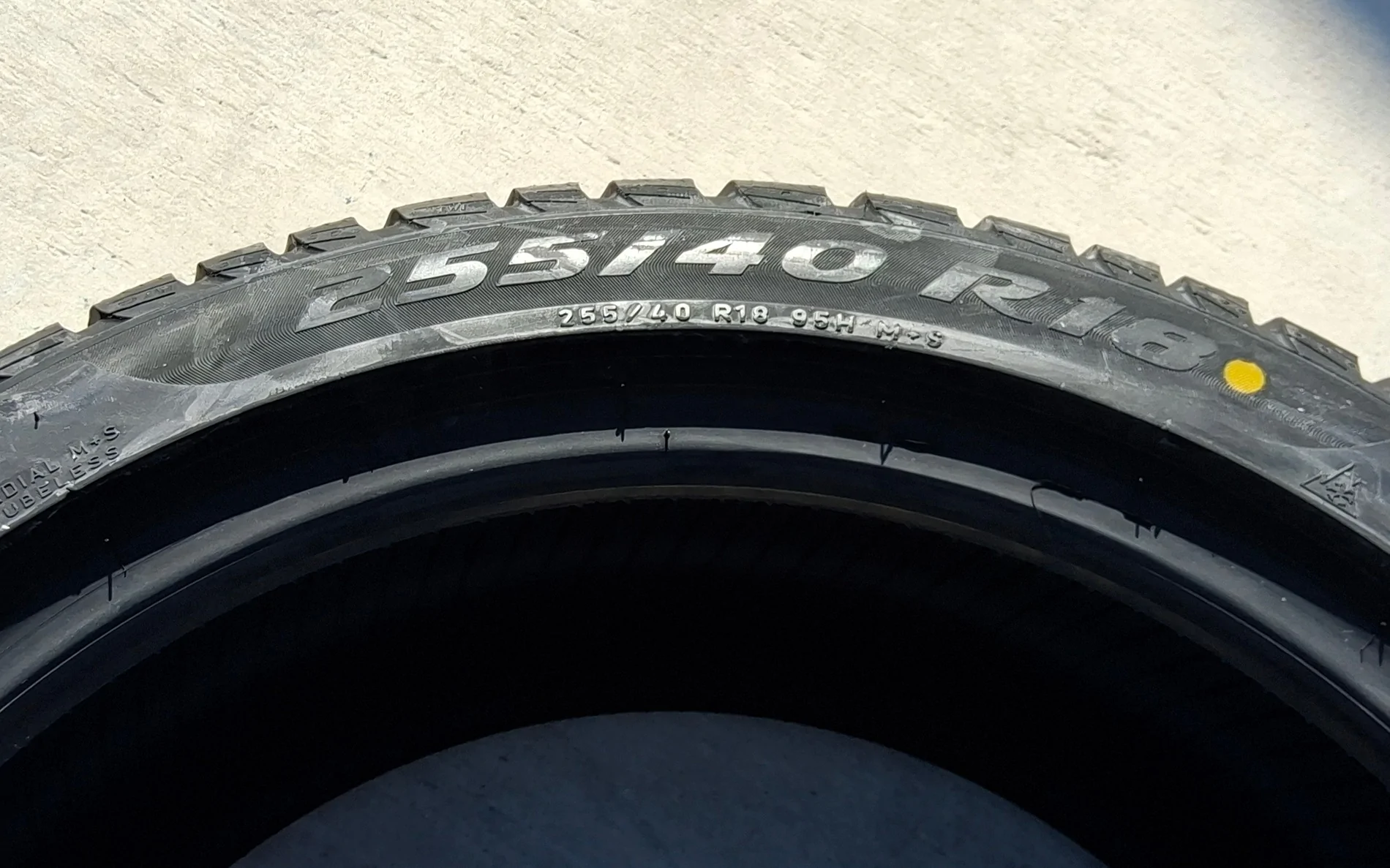

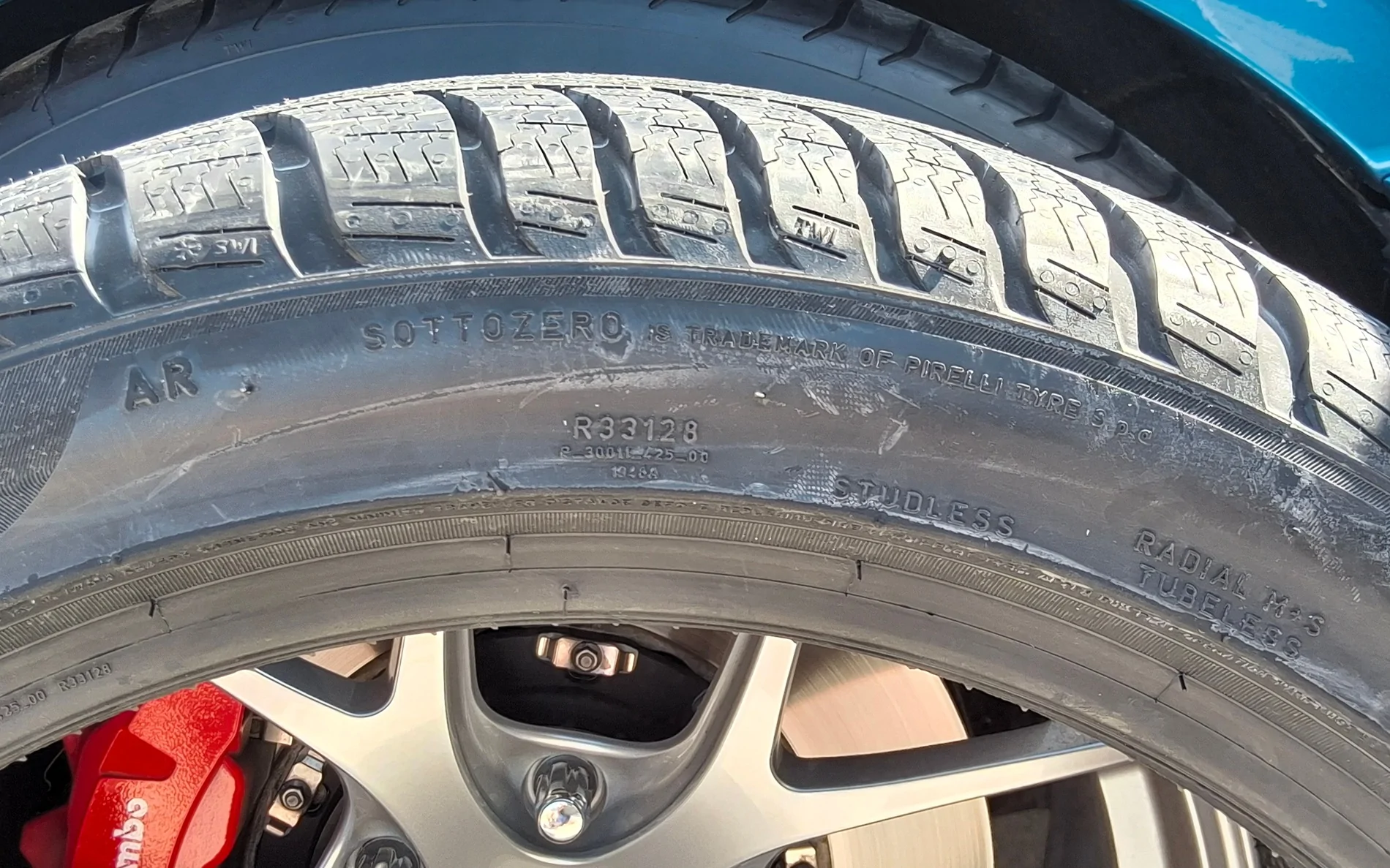

The tires.
I got a good deal. These tires were on Clearance at TireRack.
11th Gen Honda Civic Sporky SideGrades Texas FL5 Type R 20251114_114923
11th Gen Honda Civic Sporky SideGrades Texas FL5 Type R 20251114_120249
11th Gen Honda Civic Sporky SideGrades Texas FL5 Type R 20251114_120321

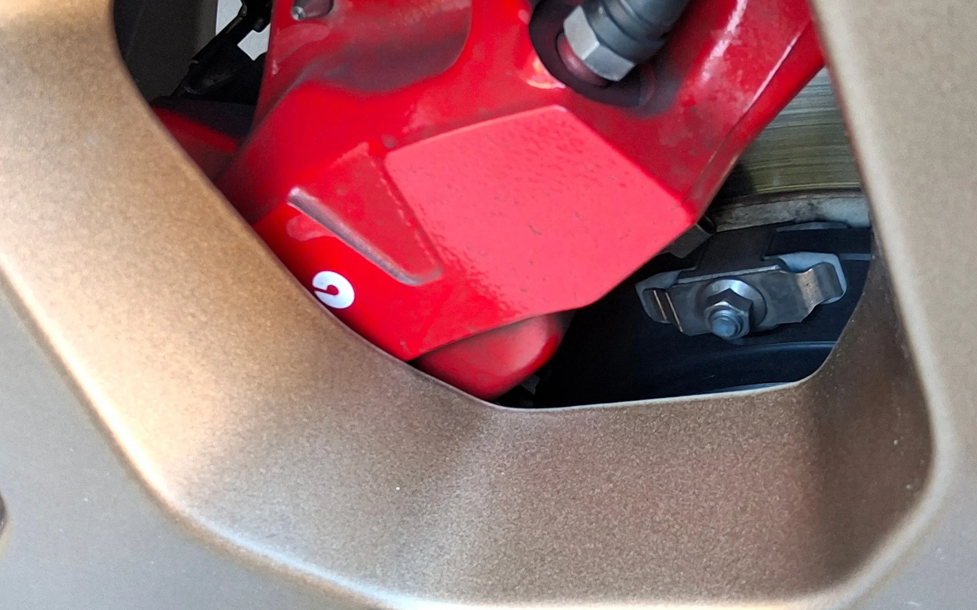

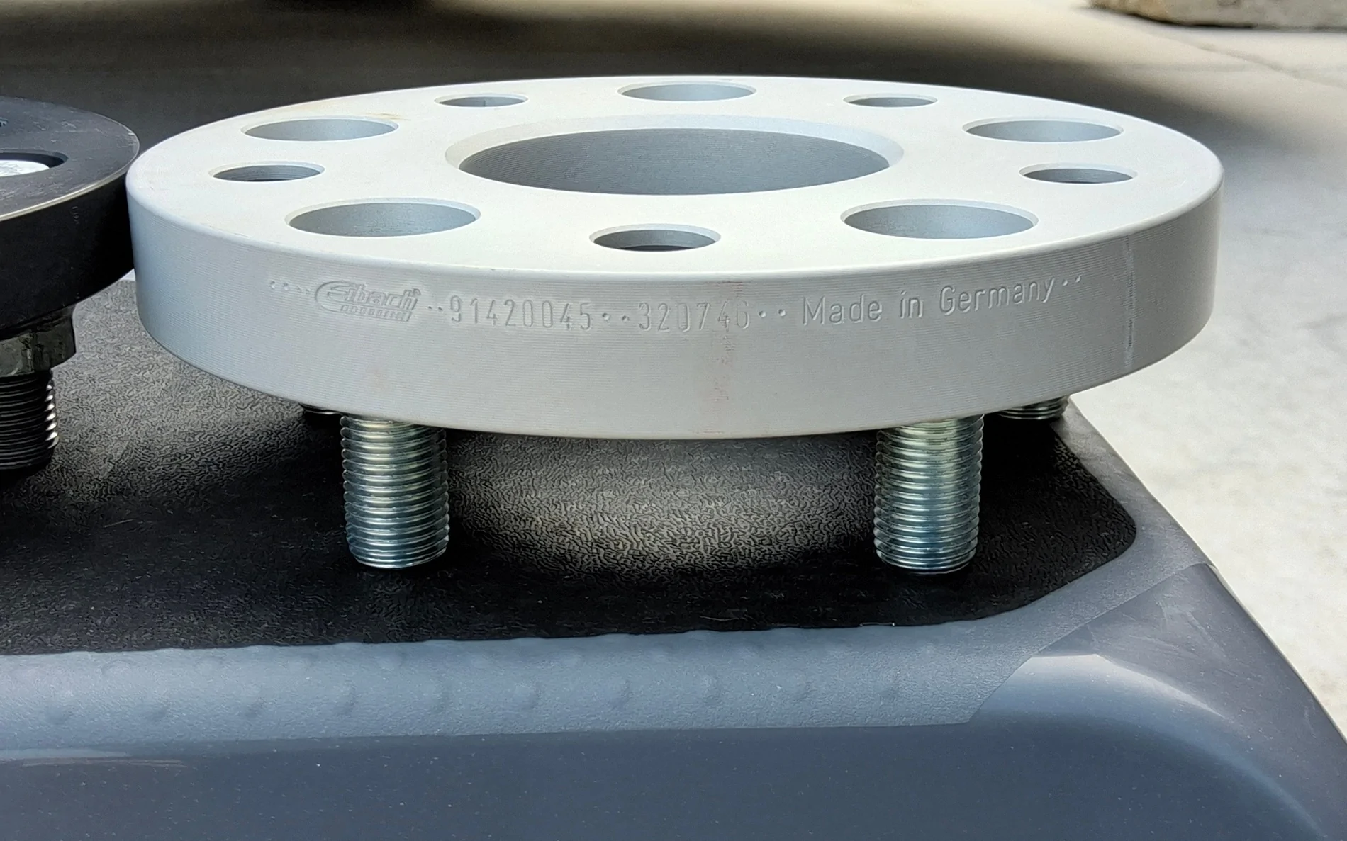

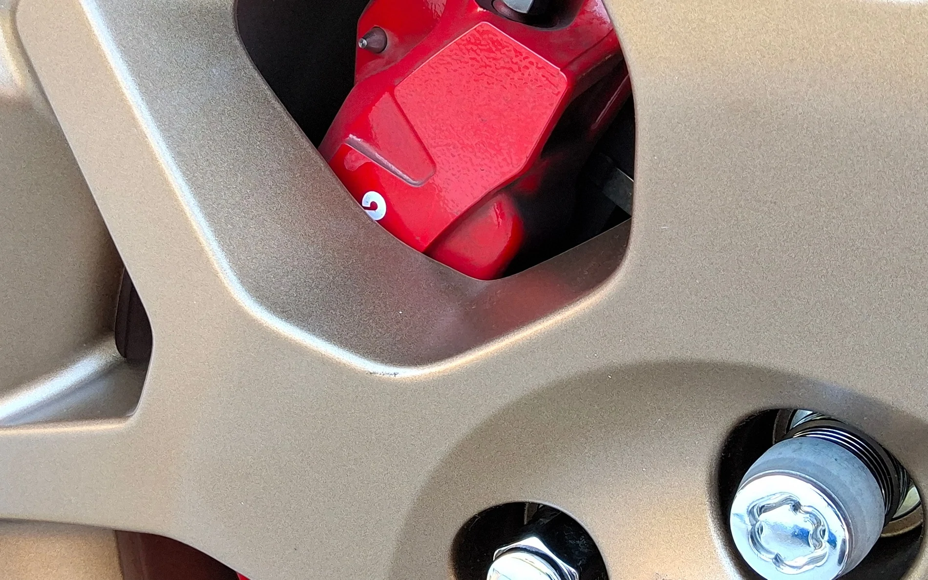

Originally, I was going to just use my H&R 15mm spacers, until I got one of the Pilot HPD wheels around a front Brembo caliper.
11th Gen Honda Civic Sporky SideGrades Texas FL5 Type R 20251209_144046
11th Gen Honda Civic Sporky SideGrades Texas FL5 Type R 20251209_144057
11th Gen Honda Civic Sporky SideGrades Texas FL5 Type R 20251209_144105

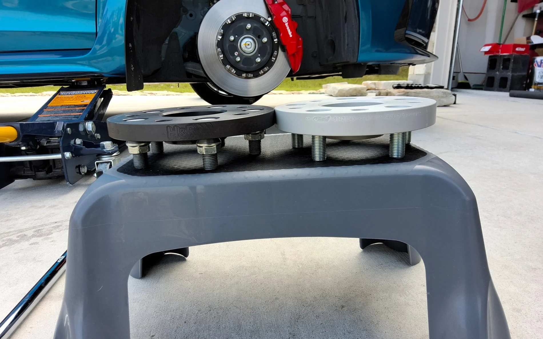

Yeah. This.
These wheels are pretty thiccc. Combine that with near zero backspacing, and that can lead to problems.
15mm spacers Do Not!!! allow for quite enough space to fit around the Brembo front calipers.

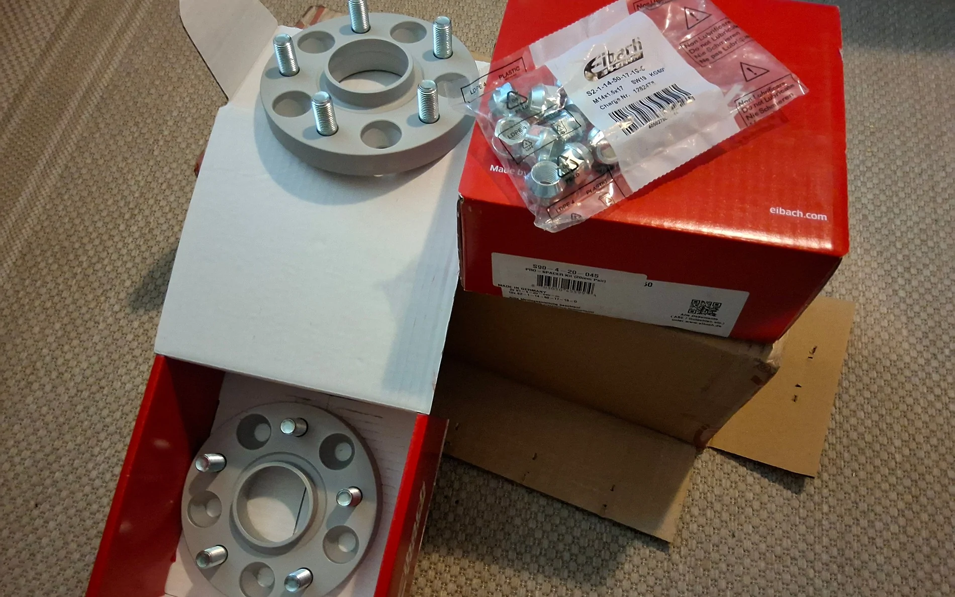

So I got 20mm spacers.
H&R 15mm spacer vs. Eibach 20mm spacer.
11th Gen Honda Civic Sporky SideGrades Texas FL5 Type R 20251214_121954
Eibach 20mm spacer closeup.
11th Gen Honda Civic Sporky SideGrades Texas FL5 Type R 20251214_122009
